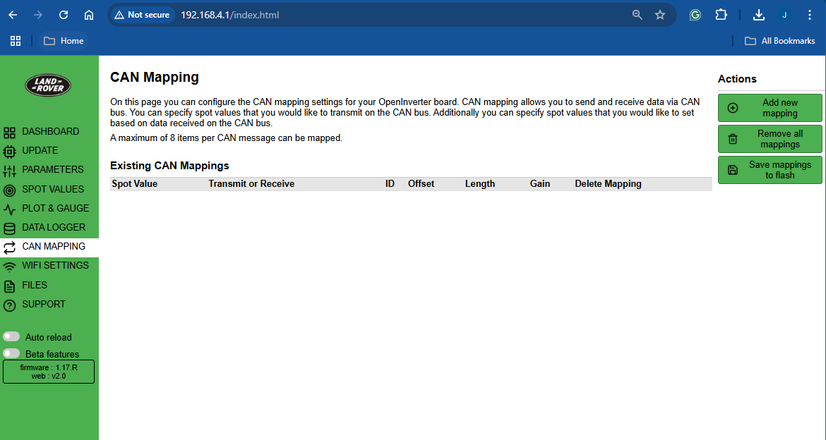

I need help restoring my internal CAN messages for the Tesla Gen 2 charger. I sort of deleted all my CAN messages, and the charger won't work. I am using the new UI, so I cannot find a setting to restore the default CAN messages needed to make the charger work.
tensa
Posts: 37
Joined: Sun Oct 04, 2020 8:22 pm
Has thanked: 14 times
Re: Tesla Charger alternative firmware
Post by tensa »
tensa wrote: Fri Jun 27, 2025 6:33 am I need help restoring my internal CAN messages for the Tesla Gen 2 charger. I sort of deleted all my CAN messages, and the charger won't work. I am using the new UI, so I cannot find a setting to restore the default CAN messages needed to make the charger work.
I solved this by reinstalling the firmware.
