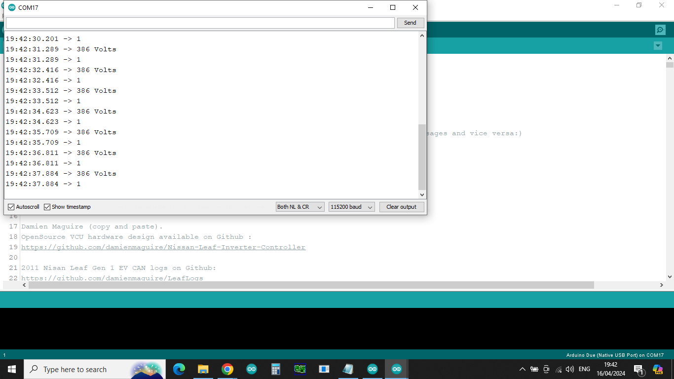

Here is a question for those of you familiar with the IVT shunt and better at coding than me.
I've had my car driving for a few months but have only gotten around to working on the shunt now.
Version 1.5 of the Leaf code includes the ISA shunt but as standard it does not work, as in it does not show voltage and current in the WiFi display. As a temporary solution I made a change to the code so that the voltage being broadcast by the inverter would show in the display and this is great for telling me the state of charge but can't see current so I want to use the shunt.
I spent most of yesterday (thanks to a dodgy Arduino Due) working to get the shunt initialised and it is now broadcasting voltage and current in the test code so I know it is working.
Some time ago james@N52E01 shared his code which I have tried but when I use it I can't drive the car.
With James code I can see voltage and current but the VCU will not trigger the positive contactor.
I went through the changes James made and the line of code (which I think was copied from the ISA Shunt test example) which causes the issue is below.
Sensor.begin(port,datarate); //Start ISA object on CAN 0 at 500 kbps
With this line of code present the inverter voltage is not showing in the serial monitor so it looks like the VCU cannot see the precharge has completed therefore is not turning on the positive contactor..
1.5 version of the code can be found here.
https://github.com/damienmaguire/Nissan ... r/Software
I'm assuming the best option is to use the voltage from the shunt rather than the inverter so I'll have a look to see if I can do that but I'm not good at coding so not confident.

OK so I figured out I can get the VCU to turn on the inverter with this code by checking for the voltage from the shunt rather than the inverter so that bit is working but the motor temp, inverter temp and motor rpm no longer show in the display and the dash so the line of code I mentioned above seems to be preventing the VCU from seeing all CAN messages from the Inverter.
This is the code that works but kills the data coming from the inverter, some of the changes came from James and some myself but I've claimed them all here. :lol:

inv_volts_local==0;
void HV_Con()
  inv_volts_local=(inverter_status.voltage / INVERTER_BITS_PER_VOLT);
if (T15Status && !Pch_Flag)  //if terminal 15 is on and precharge not enabled
  digitalWrite(OUT3, HIGH);  //inverter power on
  if(Sensor.Voltage<200)      //Alibro changed inv_volts_local to Sensor.Voltage
  digitalWrite(OUT1, HIGH);  //precharge on
  Pch_Flag=true;
if (T15Status && !HV_Flag && Pch_Flag)  //using inverter measured hv for initial tests. Will use ISA derived voltage in final version.
  if (Sensor.Voltage>340)     //Alibro changed inv_volts_local to Sensor.Voltage
  digitalWrite(OUT2, HIGH);  //main contactor on
  HV_Flag=true;  //hv on flag
if (!T15Status)
  digitalWrite(OUT1, LOW);  //precharge off
  digitalWrite(OUT2, LOW);  //main contactor off
  digitalWrite(OUT3, LOW);  //inverter power off

      Serial.print(inv_volts_local);
      Serial.print(F(" Volts"));
      Serial.println();
      Serial.println(HV_Flag);

Alibro
Posts: 1112
Location: Northern Ireland
Has thanked: 504 times
Been thanked: 322 times
Re: Leaf Gen 1 Inverter Board
Post by Alibro »
It didn't work. :(
I don't get anything from the ISA Shunt if I comment out the sensor.begin line and if I put it back in I get nothing on the display from the inverter.
The thing that confuses me is that with the sensor.begin line on place the VCU is still controlling the inverter and allowing me to drive the car, so it is only the display and the serial monitor that is not working. Does than mean the ISA shunt is effecting CAN1 and not CAN0? If so does that change anything?
I think I did everything as you suggested.
This is the ISA.h after I changed it

And this is the main sketch
Leaf Gen1 Inverter driver. Alpha software for testing.
Runs on the Arduino Due SAM3X8E MCU. V1 Leaf open source vcu.
Enter torque request on serial window.
As of now only responds to negative torque requests. e.g. -10
Positive torque requests trigger the inverter pwm but do not rotate the motor.
V5 incorporates ISA can shunt on CAN0. Let's hope the leaf inverter doesnt mind the isa messages and vice versa:)
WiFi on Serial2.
Precharge control : out1 = precharge , out2= main contactor
Copyright 2019
Perttu Ahola (all the hard work!)
http://productions.8dromeda.net/c55-leaf-inverter-protocol.html
Damien Maguire (copy and paste).
OpenSource VCU hardware design available on Github :
https://github.com/damienmaguire/Nissan-Leaf-Inverter-Controller
2011 Nisan Leaf Gen 1 EV CAN logs on Github:
https://github.com/damienmaguire/LeafLogs
    This program is free software: you can redistribute it and/or modify
    it under the terms of the GNU General Public License as published by
    the Free Software Foundation, either version 3 of the License, or
    (at your option) any later version.
    This program is distributed in the hope that it will be useful,
    but WITHOUT ANY WARRANTY; without even the implied warranty of
    MERCHANTABILITY or FITNESS FOR A PARTICULAR PURPOSE.  See the
    GNU General Public License for more details.
    You should have received a copy of the GNU General Public License
    along with this program.  If not, see <https://www.gnu.org/licenses/>.
#include <Metro.h>
#include <due_can.h>
#include <due_wire.h>
#include <DueTimer.h>
#include <Wire_EEPROM.h>
#include <ISA.h>  //isa can shunt library
#define Serial SerialUSB
template<class T> inline Print &operator <<(Print &obj, T arg) { obj.print(arg); return obj; }
CAN_FRAME outFrame;  //A structured variable according to due_can library for transmitting CAN data.
CAN_FRAME inFrame;    //structure to keep inbound inFrames
//////timers//////////////////////////////
Metro timer_Frames10 = Metro(10);
Metro timer_Frames100 = Metro(100);
Metro timer_wifi = Metro(1100);
Metro timer_hv = Metro(1000);
int inv_volts_local;
int16_t final_torque_request = 0;
#define INVERTER_BITS_PER_VOLT 2
#define INVERTER_BITS_PER_RPM 2
////////////////////Pin Map////////////////////////////////////////////////////
int led = 13;         //onboard led for diagnosis
#define Throttle1 A0  //Analog throttle channel 1
#define Throttle2 A1  //Analog throttle channel 2
#define Brake 61      //Brake pedal switch. High = brake on
#define IN1 6         //General purpose digital input 1. High =12v
#define IN2 7         //General purpose digital input 2. High =12v
#define OUT1  48      //Low side switched general purpose digital output 1. high = on.
#define OUT2  49      //Low side switched general purpose digital output 2. high = on.
#define OUT3  50      //Low side switched general purpose digital output 3. high = on.
#define HVPreset 340 //voltage at which to enable main contactor
uint16_t ThrotVal =0; //analog value of throttle position.
uint16_t outRPM;      //calculated value of rpm for e46 ike
static int16_t MaxTrq=2000;  //max torque request
struct InverterStatus {
  uint16_t voltage = 0;
  int16_t speed = 0;
  int8_t inverter_temperature = 0;
  int8_t motor_temperature = 0;
  bool error_state = false;
} inverter_status;
String readString;
byte ABSMsg=0x11;
uint8_t tempValue; //value to send to e46 temp gauge.
bool T15Status; //flag to keep status of Terminal 15 from In1
bool can_status;  //flag for turning off and on can sending.
bool Pch_Flag;    //precharge status flag
bool HV_Flag;     //hv on flag
uint port=0;                //Alibro Added
uint16_t datarate=500;      //Alibro Added
ISA Sensor;  //Instantiate ISA Module Sensor object to measure current and voltage
void setup()
  //Sensor.begin(port,datarate);  //Start ISA object on CAN 0 at 500 kbps //Alibro Added //royhen99 commmented out
  Can0.begin(CAN_BPS_500K);   // Inverter CAN
  Can1.begin(CAN_BPS_500K);   // Vehicle CAN
  //Can0.watchFor(0x1da); //set message filter for inverter can. Note sure if I can use two seperate values here. it might just pick 1!
  Can1.watchFor(0x1ff); //just a blank message to block receive from e46 messages.

void HV_Con()
  Pch_Flag=true;
if (!T15Status)
      Serial.println();

So I tried this code exactly as you sent it and although it enables the serial outputs from the Inverter and lets me drive I don't see anything from the shunt.
I only get Motor temp, Inverter temp and rpm on the display.
This is what I see in the serial monitor
Could it be a library version issue?

That's what I would expect. The ISA shunt data is sent to Serial2 which is the wifi interface. To view it on the terminal you to need to change Serial2 to Serial, or you could copy the code so it sends to both.

So I've been playing with this over the last few days and still having the same issue. Initially I couldn't get it to compile then figured out I needed to adjust the ISA.h to reflect the change to ISA.CPP. Once that was done and the extra 255 added (without this I got an error) to the Sensor.begin line it compiled but didn't improve the problem.
With sensor.begin I get Voltage, Current and Power from the ISA shunt but no temps or rpm.
I tried enabling a the other changes suggested but still nothing.
