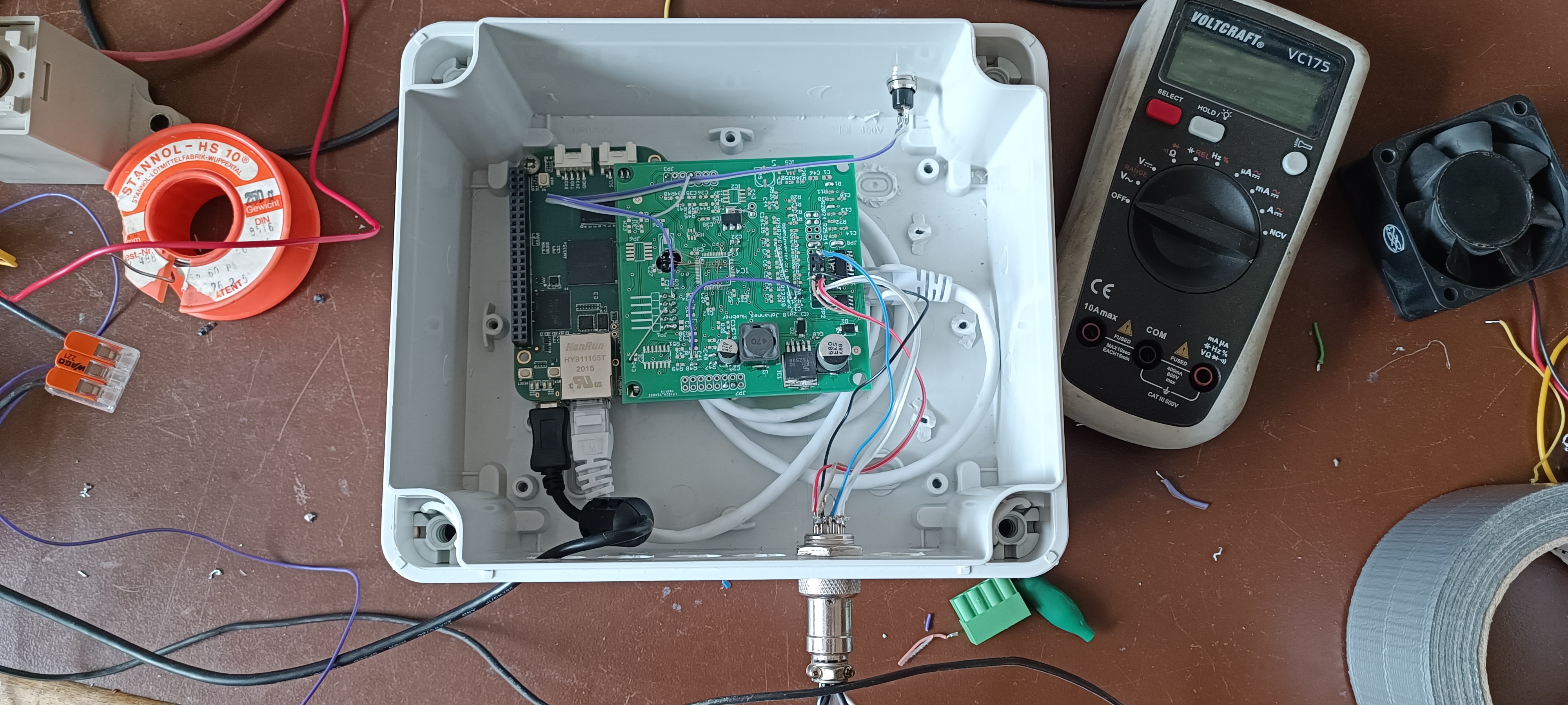

Here's my second attempt, had to return to the desk to check if it handles a second contactor.
The former inverter board has become sort of a motherboard. PLC modem is soldered right in to receive power, likewise the beaglebone. Also can transceiver and an infamous uln2003 is on there. It handles CP switching and the contactors. Gets up to 50°C as discovered with my borrowed thermal camera :)
Been thanked: 1918 times
Seems that wasn't it :(
Second contactor in and verified there is absolutely no voltage between GND and the power pins or between the power pins. Even unplugged my setup from the socket completely.

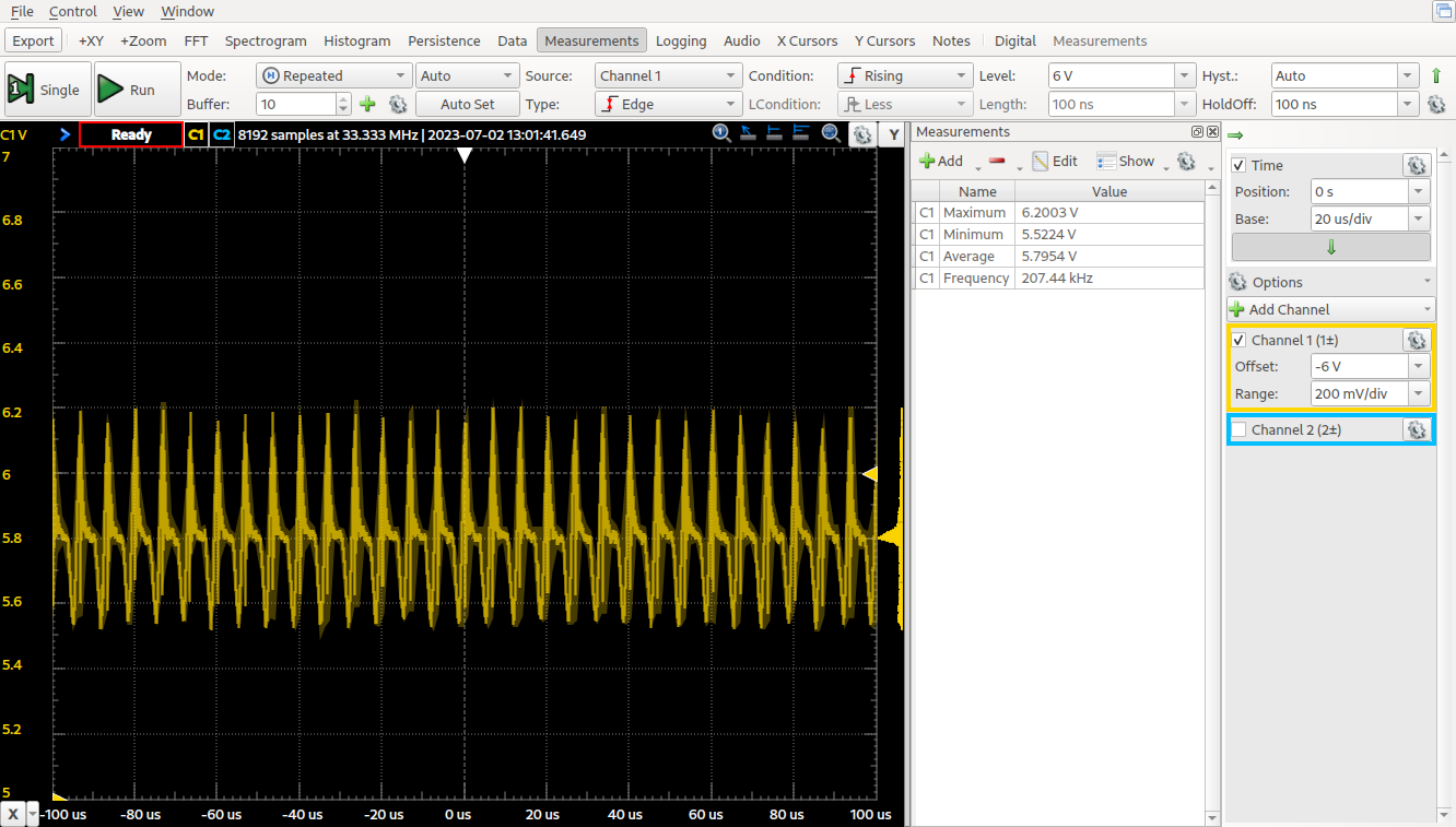

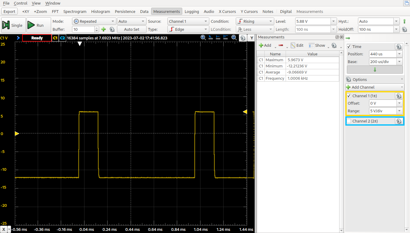

The ULN has significant U_CE_sat even with nearly no load. This may lead to instable state C, e.g. 7V instead of 6V.

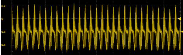

I have checked this now. Supplying 12V via a 1k resistor to the CP pin. In state B I see 8.8V and in state C 5.8V. I use 1k2 instead of 1k3, that probably makes up for the higher voltage drop of the ULN2003. Also measured its Vce and it is 0.7V
EDIT: Also scoped it:
I'm suspecting the noise comes from the PLC modem. Now waiting for it to shut down.
UPDATE: it did shut down now, noise level drops to about half. When I cut power to the modem noise goes away

Hm, the 5.8V are hopefully good enough to make the charger happy. Two more ideas: The diode in the CP is installed? And the diode is fast enough, to follow the 5% PWM? And the coupling to the PLC modem uses not more than 1nF, to avoid lowpass-filtering the PWM?
uhi22
Posts: 1244
Location: Ingolstadt/Germany
Has thanked: 245 times
Been thanked: 684 times
Post by uhi22 »
Two more ideas into the same direction: The modem is on the right side of the diode (charger side, not resistors side)? And the series resistor in the modem path is installed, to avoid that it applies several volts in addition to the intended +6V/-12V? Is it possible to make a scope picture when connected to the charger?
Yes, I use the same diode, 180R resistor and 1nF capacitor as on the working version. 180R from one transformer end to GND, 1nF from the other transformer end to CP. From CP diode to 2k7 resistor to GND and in parallel 1k2 resistor to ULN to GND. Can try the scope thing later.
I now went to the Compleo charger again with the CCS->Chademo and it worked as it did before. Log attached.

And here is a scope shot with my granny cable in state C
uhi22
Posts: 1244
Post by uhi22 »
Really strange. Everything perfect, the levels, the edges, the schematic. Somehow I get the impression that the charger does not complain about the CP, but what else could be a reason to fail the cable check?
But, this noise looks strange:
The PEV modem, if there is no central coordinator (=EVSE or other, non-pev modem) near to it, does not send anything on the line. So I would expect perfect silence. What we see looks like ripples from a switch mode power supply. This could point to a ground issue (missing ground or ground loop or something). Just to be sure: The PE of the CCS inlet, the ground of the Beaglebone, modem, ULN and power supply are all connected together?
