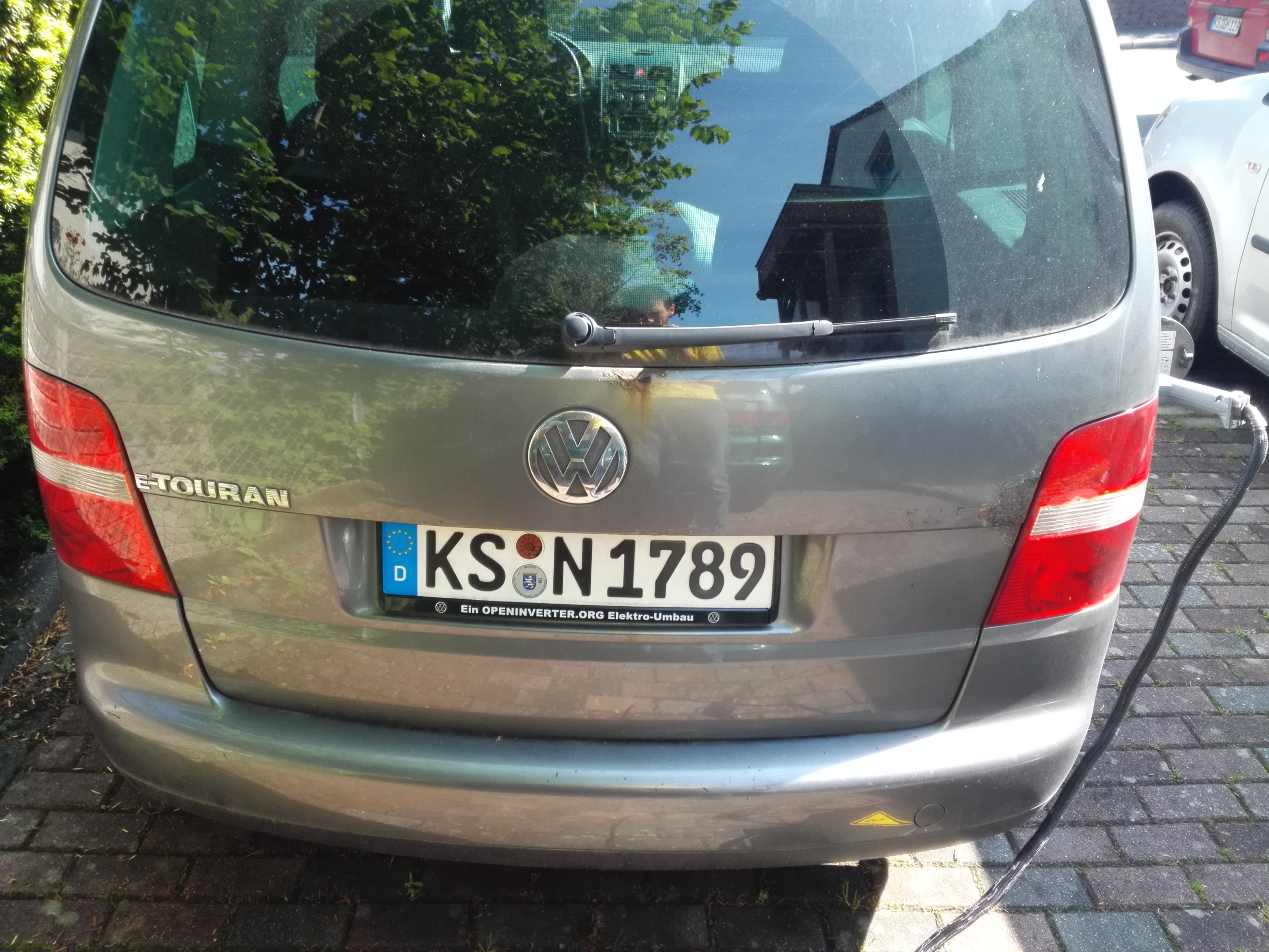

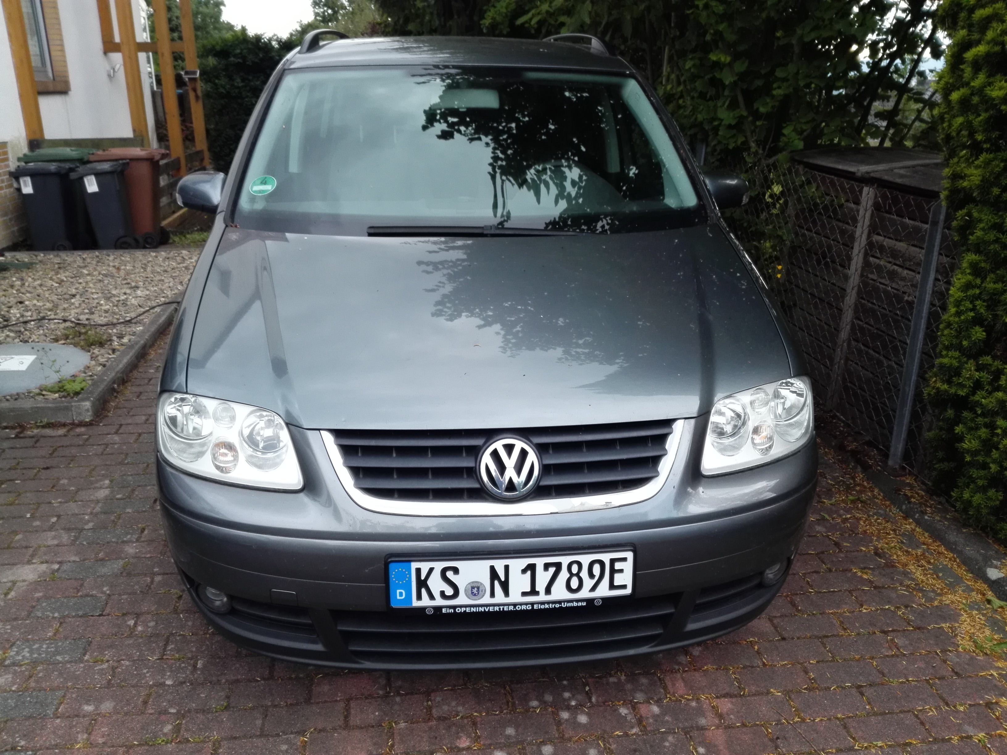

Added some branding 8-)
Will get the E license plate in two weeks.
Need to work on those rust patches eventually.

johu wrote: Fri Jun 19, 2020 8:36 am Will get the E license plate in two weeks.
Very nice!
Why do you need E licence plate? Do you get any benefit on parking/charging because of it?
Been thanked: 1918 times
Thank you :)
Yes in Kassel you can park for free with E plate. Not that I go there often, but still. Plus it proves that my little E- isn't just a fake 8-)
That said plugin hybrids also get the E plate :roll:

I am going to need that text you have under my licence plate too. Is it a sticker on the frame?
I have been thinking about some openinverter.org stickers for some time. Is it something someone is doing allready? Stickers could be nice product to send in a letter mail for a fixed price that would make some level support in price too.

It was printed directly on there: https://kennzeichenhalterung.de/
They were like 6€ each.
The text is just their standard font, openinverter logo is attached. It says "Ein OPENINVERTER.ORG Elektro Umbau" equivalent to "An OPENINVERTER.ORG Electric Conversion"
I can also get some more printed and put them on the shop, what do you think?

Final step done - E-Kennzeichen :)
Almost a bit boring with nothing left to do ;) I will wrap the damaged chrome grill in blue. Maybe I will fit an android "radio" like Shane.
