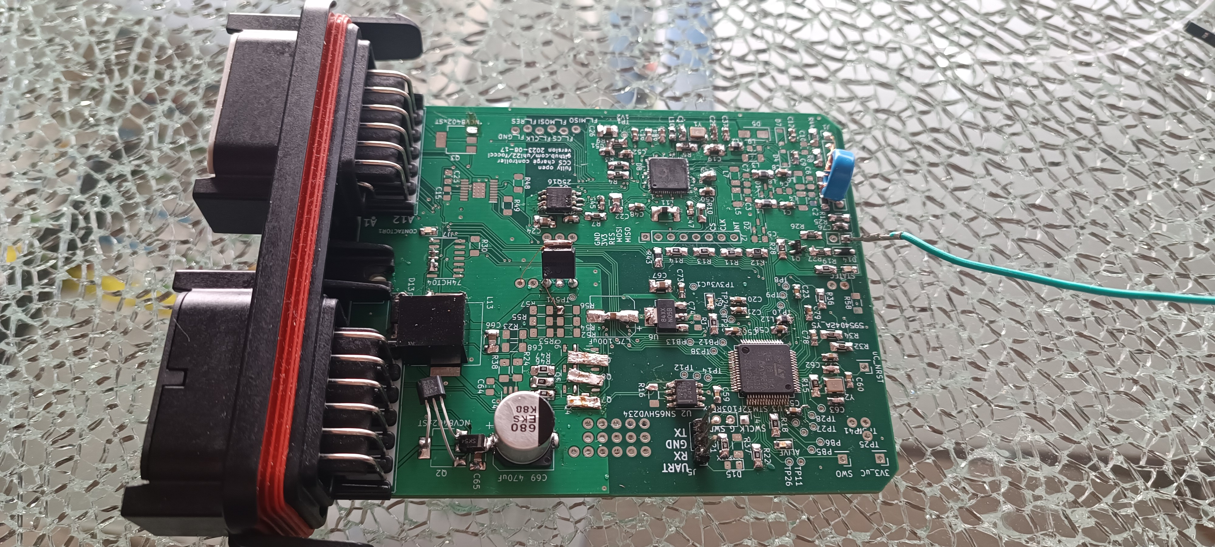

Develop a QCA7000 board?

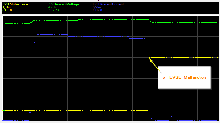

Would be good to see both direction of the traffic. Maybe the charger does not announce its physical limits, but instead announces a combination of its own limits and the limits which clara sent in the ChargeParameterDiscoveryRequest. Exactly our values:
And yes, it says "EVSE_Malfunction". Maybe some combination of the parameters are not plausible enough. But which?

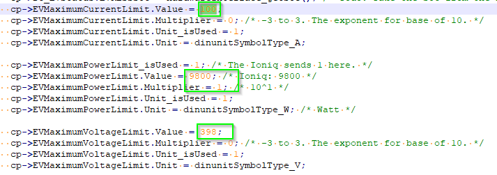

I changed precharge a bit. When batvtg < EVSEMinimumVoltage then precharge never finishes. At the same time I default batvtg=0
Probably would be more appropriate to handle this during ParameterDiscovery. Later...
UPDATE: the latest pyPLC gives me error "Could not decode the supportedAppProtocolReq"
UPDATE2: needed to update OpenV2Gx as well, now all working
Been thanked: 1918 times
Re: Develop a QCA7000 board?

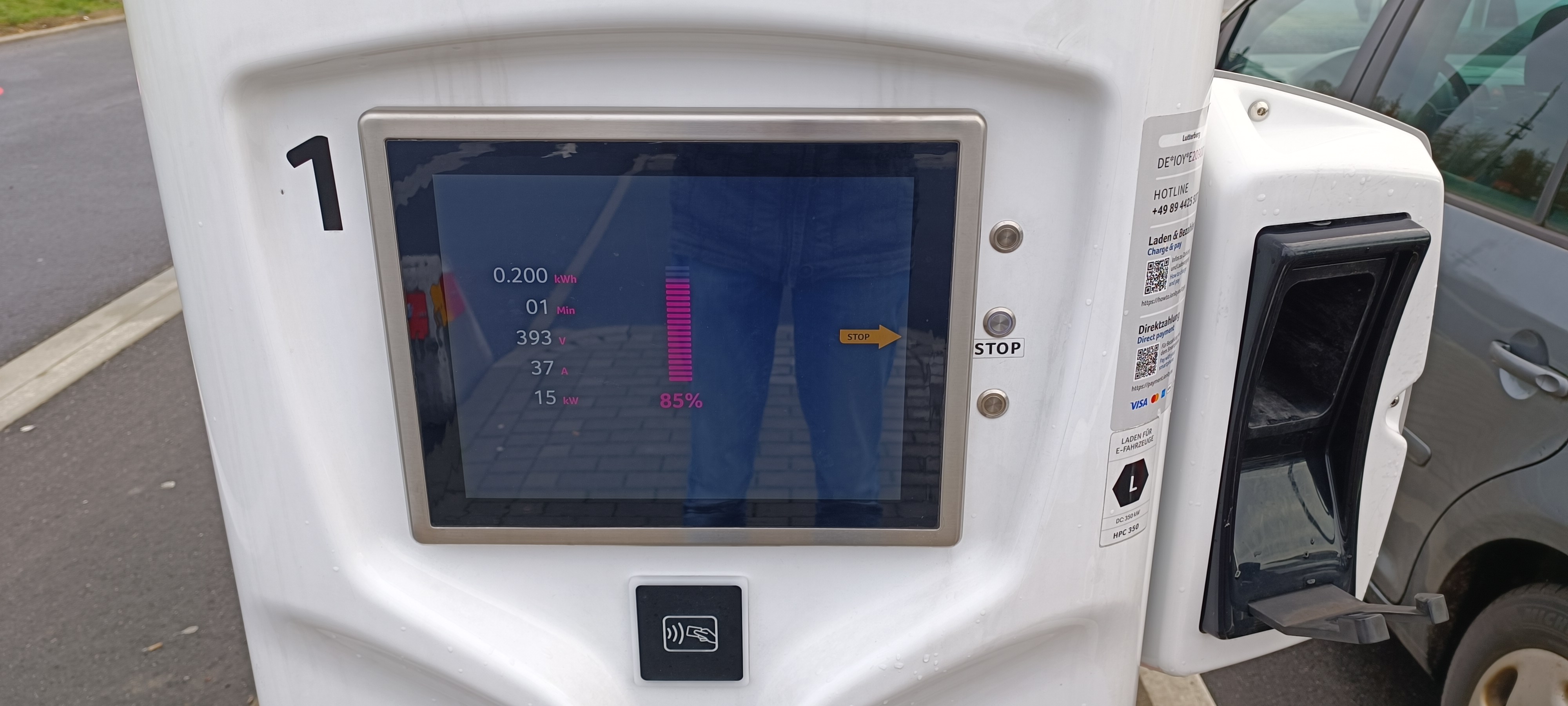

Ionity now works!
It must have been the 398V over voltage limit together with 393V battery voltage that made it conk out. I have now retried with 410V and it worked flawlessly. All limits are now parameters.

On other news I charged 5 kWh from a HyperCharger with 30 kW/80A (the CHAdeMO pins were rather warm afterwards). I think with that we've got the major brands covered.
