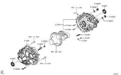

My Outlander gearbox developed a leak it seems. Every day i find a small drop under the car now. When i investigated lower end of the gearbox underneath the driveshaft level on the LH side is greasy all the time. As i wiped it dry and cleaned the residue it seems it leaks from LH driveshaft opening.
I must have damaged the lip seal there. I need to replace it. Does anyone have rear GBX dissassembly procedure and maybe parts catalog?

sorry but i weighed in the ali cases etc that housed the rear diff.arber333 wrote: ↑Sun May 19, 2024 6:18 pm My Outlander gearbox developed a leak it seems. Every day i find a small drop under the car now. When i investigated lower end of the gearbox underneath the driveshaft level on the LH side is greasy all the time. As i wiped it dry and cleaned the residue it seems it leaks from LH driveshaft opening.

TnxBigpie wrote: ↑Mon May 20, 2024 5:43 am http://mmc-manuals.ru/Mitsubishi_Outlan ... ce_Manuals this site?
I managed to go there via VPN
EDIT: MR597852 or 3515A056 seems to be genuine P/N for Mitsu PHEV rear gbx oil seal

I ordered seals for spare Payen NJ452. Looks the same, dimensions seems to match, not needed to replace yet.
