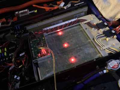

So I'm just asking for a bit of guidance, as a newcomer. Should it now be working, based on what I wrote above, and what should I be seeing?
Started to check signals - the module connector gets 12V and 5V_OUTs OK, but ENABLEs are low. So presumably the micro is not setting these. Not sure why not. Is there any special trick to getting it to run without EVSE?
Edit - update: IN1 wasn't properly connected to a +12V feed, that is necessary. "D1 L" in the debug was the clue.

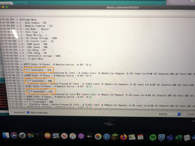

With that corrected, I get more info from the debug...
Two lights are on (module 1 and 3) although I have all 3 enabled in the menu.
After connecting the AC power the module LEDs go out and the debug shows this instead:
Again, any advice on what I should see here would be great. Thanks!
Proximity Status : Unconnected AC limit : 0 /Cable Limit: 0 /Module Cur Request: 333 /DC total Cur:0.01 /DC Setpoint:340 /DC tVolt:355 /DC driven AC Cur Lim: 16248
184366 State: 1 Phases : 0 Modules Avtive : 3 ON D1 H
Phase 1 Feebback // AC present: 0 AC volt: 2 AC cur: 0.00 DC volt: 321 DC cur: 0.01 Inlet Targ: 216 Temp Lim Cur: 15 17 25 EN:0 Flt:1 Stat:100001
Phase 2 Feebback // AC present: 0 AC volt: 0 AC cur: 0.00 DC volt: 0 DC cur: 0.00 Inlet Targ: 0 Temp Lim Cur: 0 0 0 EN:0 Flt:0 Stat:0
Phase 3 Feebback // AC present: 0 AC volt: 2 AC cur: 0.00 DC volt: 323 DC cur: 0.00 Inlet Targ: 216 Temp Lim Cur: 15 17 25 EN:0 Flt:1 Stat:100001
277552 State: 2 Phases : 0 Modules Avtive : 3 OFF D1 H
Modules Turned OFF

you need to turn on the AC as soon as you command 's' for start.
Module 2 is not reporting anything, so it might be broken/not powered up.

Thanks Tom. I was doing that, but the module LEDs would immediately go out, and I'd have to reset the controller and press 's' again to get them back.
However after trying it multiple times, with different modules enabled etc, suddenly it started working (clicks, and then charge current).
Now it charges whenever the IN1 input and AC power is connected, it doesn't seem to need the 's' command.
Something seems a bit random.
Module 2 has never lit up though, I will try to check that it's got the right signals. It could be that I was sold a defective unit.

OK, some progress! There is nothing wrong with module 2, it was just a lifted pin on the connector, which happened to be enable #2.
So they all fire up now and I've turned it up to 20A (briefly, without cooling) - no problem.
However, still one issue - as above when turning on the power for the first time, the module lights will go out. I found the only way to get past that is press the reset button!! It then starts right up and charges. And weirdly it then happily accepts the power being cycled as much as you want.
I wondered if the processor is resetting for some reason (a transient, or related to earthing), and turning off the outputs..
Doesn't seem to be related to whether the USB cable is plugged in.
Any ideas? I appreciate the help so far, it's always a lot easier to debug something if you have the first idea of how it's supposed to behave when it's working...

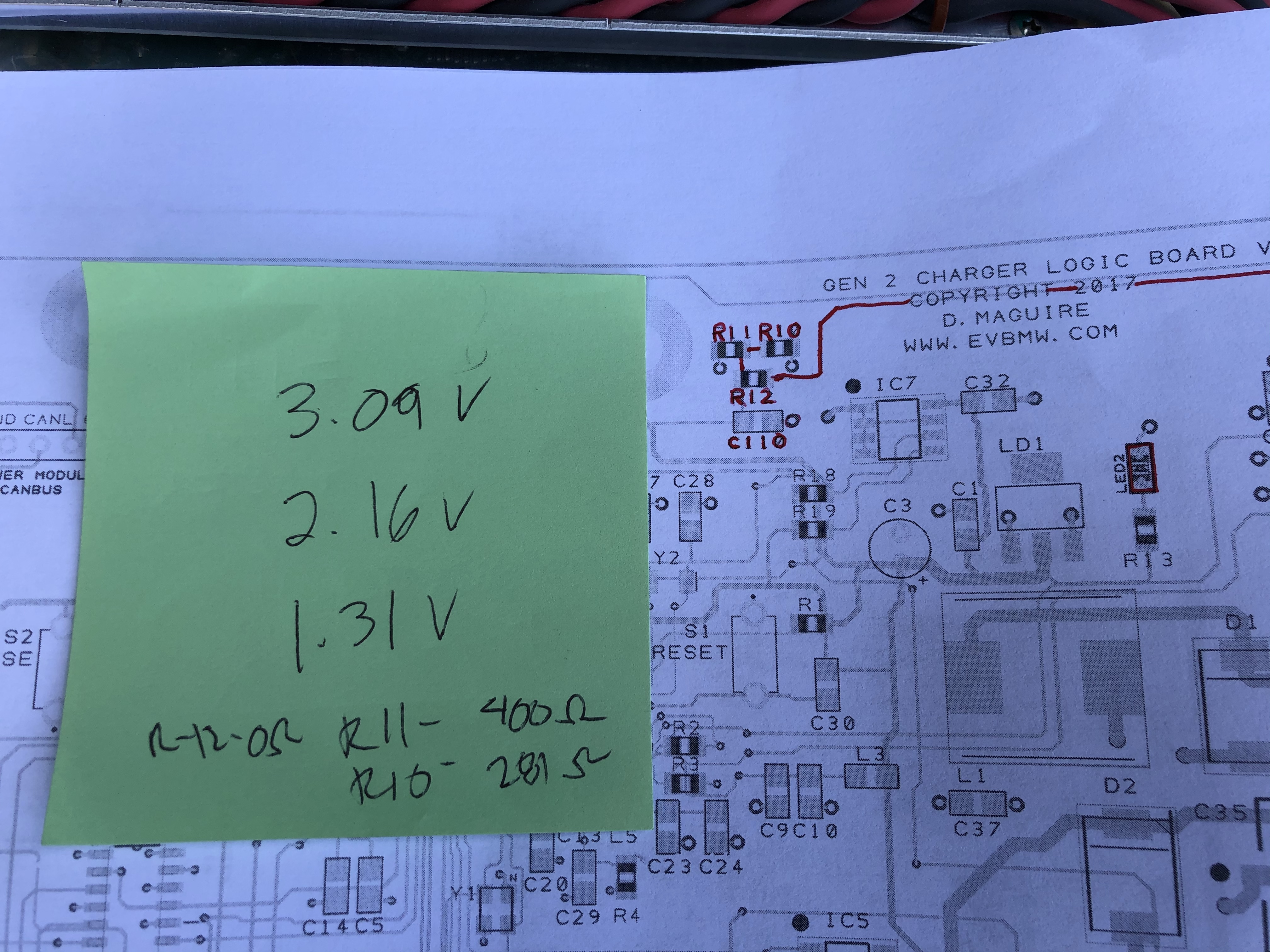

Here's the measurement I got:Kevin Sharpe wrote: ↑Sat Mar 28, 2020 11:49 am
What you want to verify is the proximity pin behaviour at the charger when the J1772 connector is plugged in. What voltage do you measure on the charger control board resistor R12? Does this change when you press the J1772 button?
- Not Connected - 3.09 volts
- Button Pressed - 2.16 volts
- Connected - 1.31 volts
Gen2TeslaChargerV2.ino
https://github.com/damienmaguire/Tesla- ... rgerV2.ino
In header comments it has these:
//proximity status values for type 1
#define Unconnected 0 // 3.3V
#define Buttonpress 1 // 2.3V
#define Connected 2 // 1.35V
These are just a comment so I'm not sure if these are the exact readings in the EVSE.
The EVSE reading seems to be coming from this portion of the code:
void evseread() {
uint16_t val = 0;
val = analogRead(EVSE_PROX); // read the input pin
if ( parameters.type == 1)
if ( val > 800)
Proximity = Unconnected;
else
if ( val > 550)
Proximity = Buttonpress;
else
Proximity = Connected;
Any other tip or ideas I may pursue? Or should I compile the code and upload it in my Gen2V3 board for more debugging?
Thanks!

What connector type are you selecting (sorry I don't know whether this is a runtime or compile option)? If you read this comment from Tom you'll see that you must select Type 1 and ignore the cable current resistors because they don't exist in the J1772 connector;
viewtopic.php?f=10&t=489&p=8802#p8799
*** we really need someone who is running the Gen 2 charger with the J1772 connector to step up and help this user ***

I build the opensource code and uploaded it to the board. I've put debug statements on the "evseread()" values. The values being returned by the evseread() is not consistent during different states {unconnected, button-pressed, connected}. The values floats from 928, 976, 944, 800... and so on. I can force the charger to start if I hard code the evse value to the state that it will turn on.
The voltage reading I have on R12 on the board was consistent from last time :
unconnected : 3:09V
button-pressed: 2.16V
connected : 1.31V
(I will need to verify next the voltage reading at the ATSAM3X8EA-AU chip pin 78 {PA16} just to be sure).
I've tested with both versions of the code - "Gen2TeslaChargerV2" and "Gen2TeslaChargerV4" with the same result.
Now, it might be the case that the analog channel (A0) is defective on the chip? Any other thoughts? Maybe Damien can pitch in on this one? Thanks!
For reference here's library and code I've used for the build:
Source code location for the charger : https://github.com/damienmaguire/Tesla-Charger
unconnected : 3:09V
connected : 1.31V

New variable for printing the evseread() value placed in the top of the file.
// JGM debug
uint16_t _val=0;
// JGM - debug
Serial.print("* * * evseread() - ");
Serial.print(_val);
Serial.println();
Serial.print(" Proximity Status : ");
uint16_t val=0;
_val = val;

Please ensure you wiring has good connections everywhere, especially the ground.
If you have a scope use that to measure the voltage at the resistor, with your debugging you can then see if a value stabilises at the each state.
If it does there is no wiring issue and ADC issue. If it keeps jumping there is, easiest state to check is unconnected.
If this is not the case software cannot fix this.
The place this is handeled is here, so if you get stable values just move the values around to match.:
