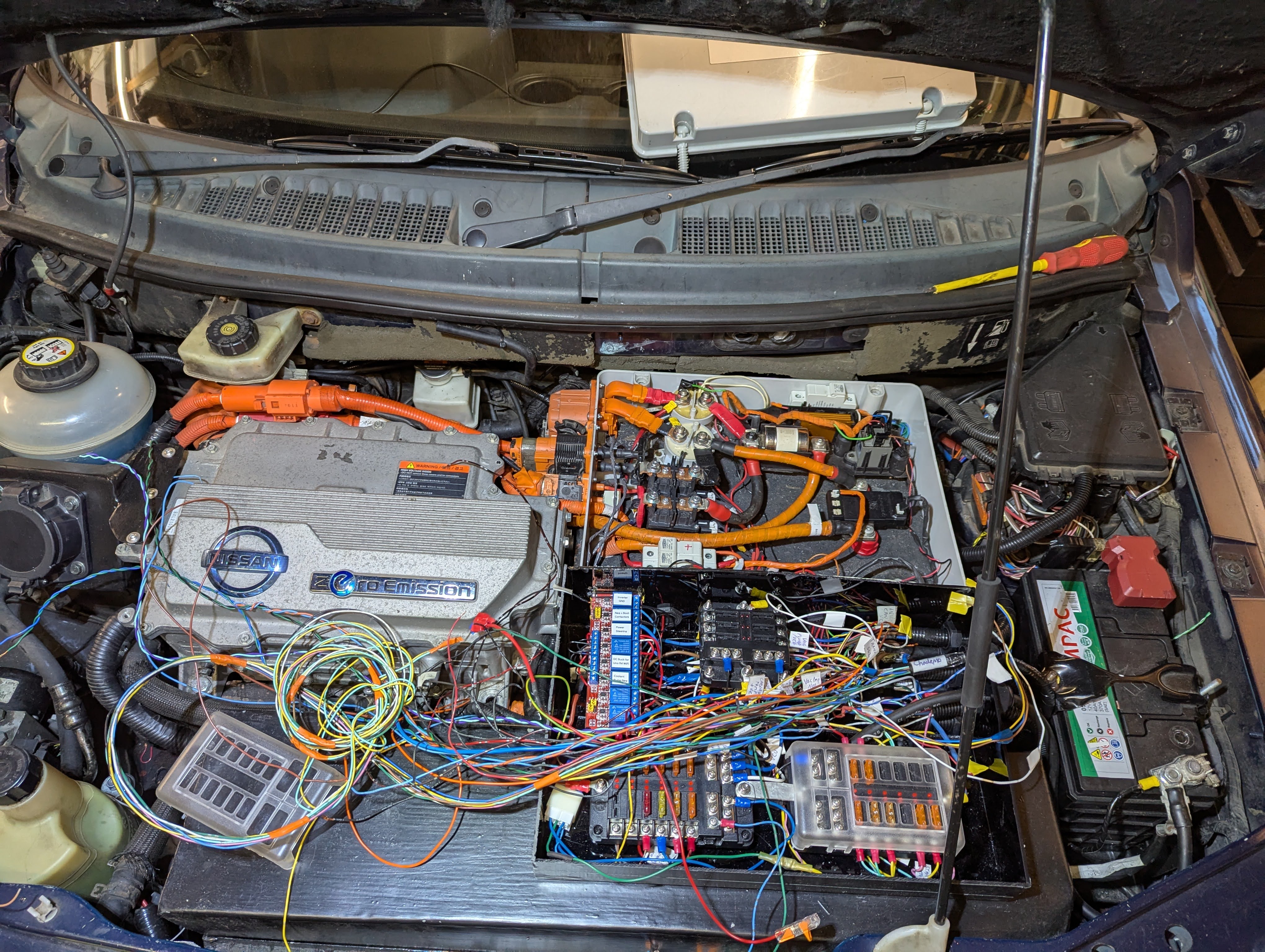

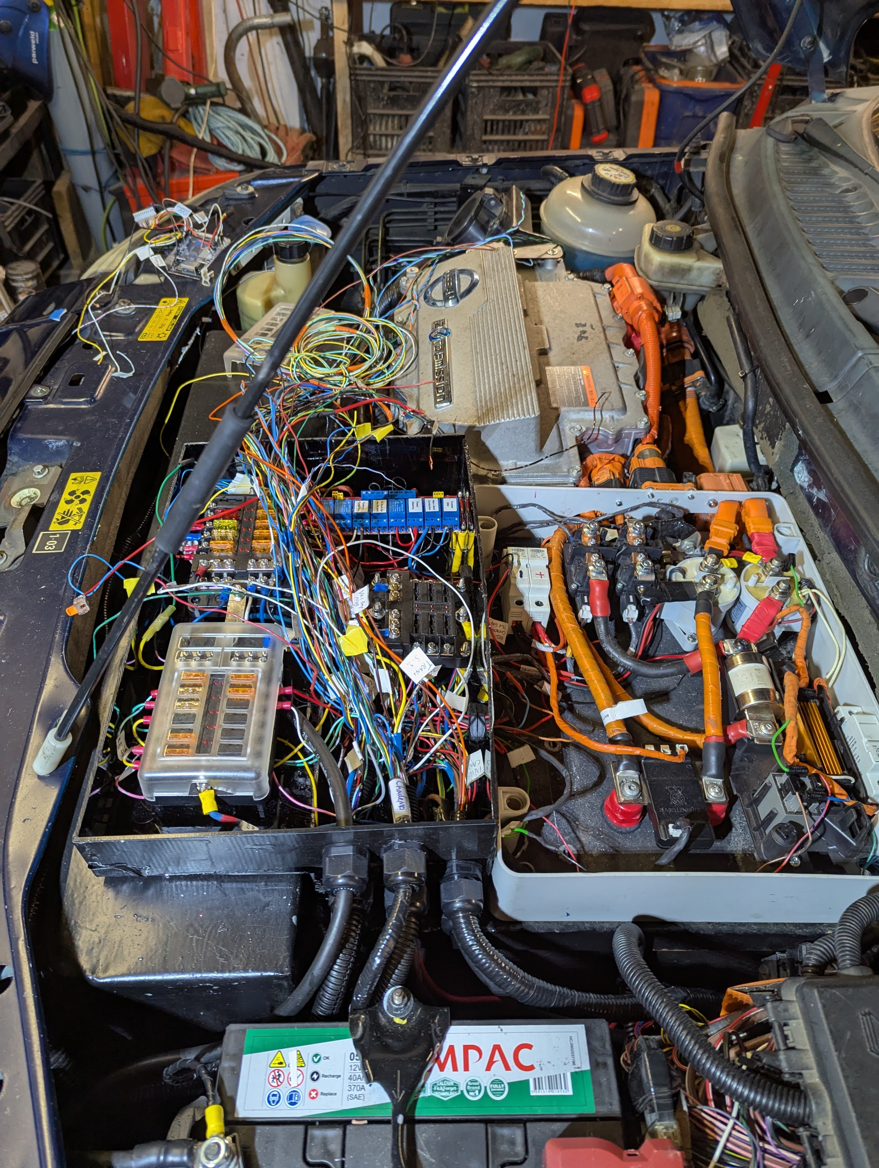

So after a stupid number of hours working on the new improved HV and LV junction boxes and doing a brain transplant by installing a new Zombie VCU I still have a load of work to do but today I finally was able to take it out for a test drive.
This is how it looks under the bonnet now.
If you look carefully you can see the box has already been wrapped in gaffer tape to stop it breaking or falling apart.
The to do list still contains
AC Charger
DC Charger
Heater
Coolant and heater pump control
Tidy the VCU which is lying on the passenger floor connected using umpteen Wago connectors.
Make a lid for the new LV box.
And probably 20 more things I've forgotten about.
I might even remove the smaller 6 way fuse box I thought I needed and only bought a couple of weeks ago. The new VCU is able to control many more aspects of the start up sequence than the old one could so I don't think I will need it. This fuse box is on ignition position one and previously I had several things like the boot battery box contactors turn on when the key was turned.
These are now being controlled by the VCU so this fuse box is just taking up space.

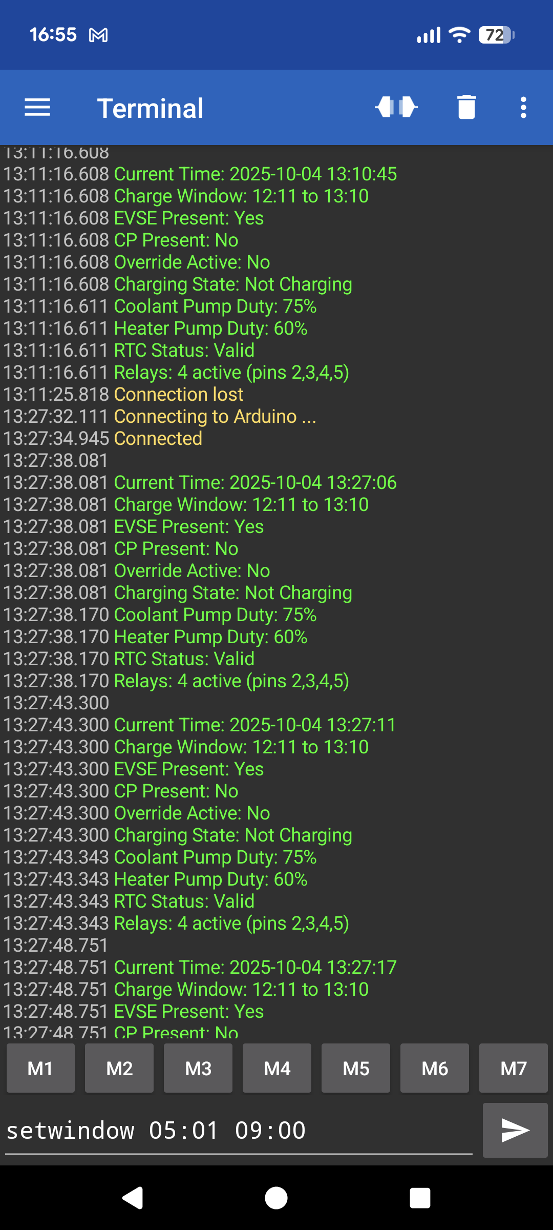

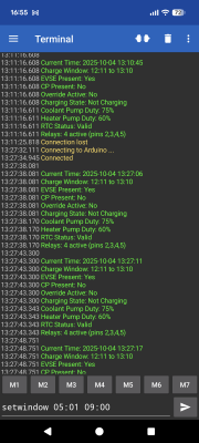

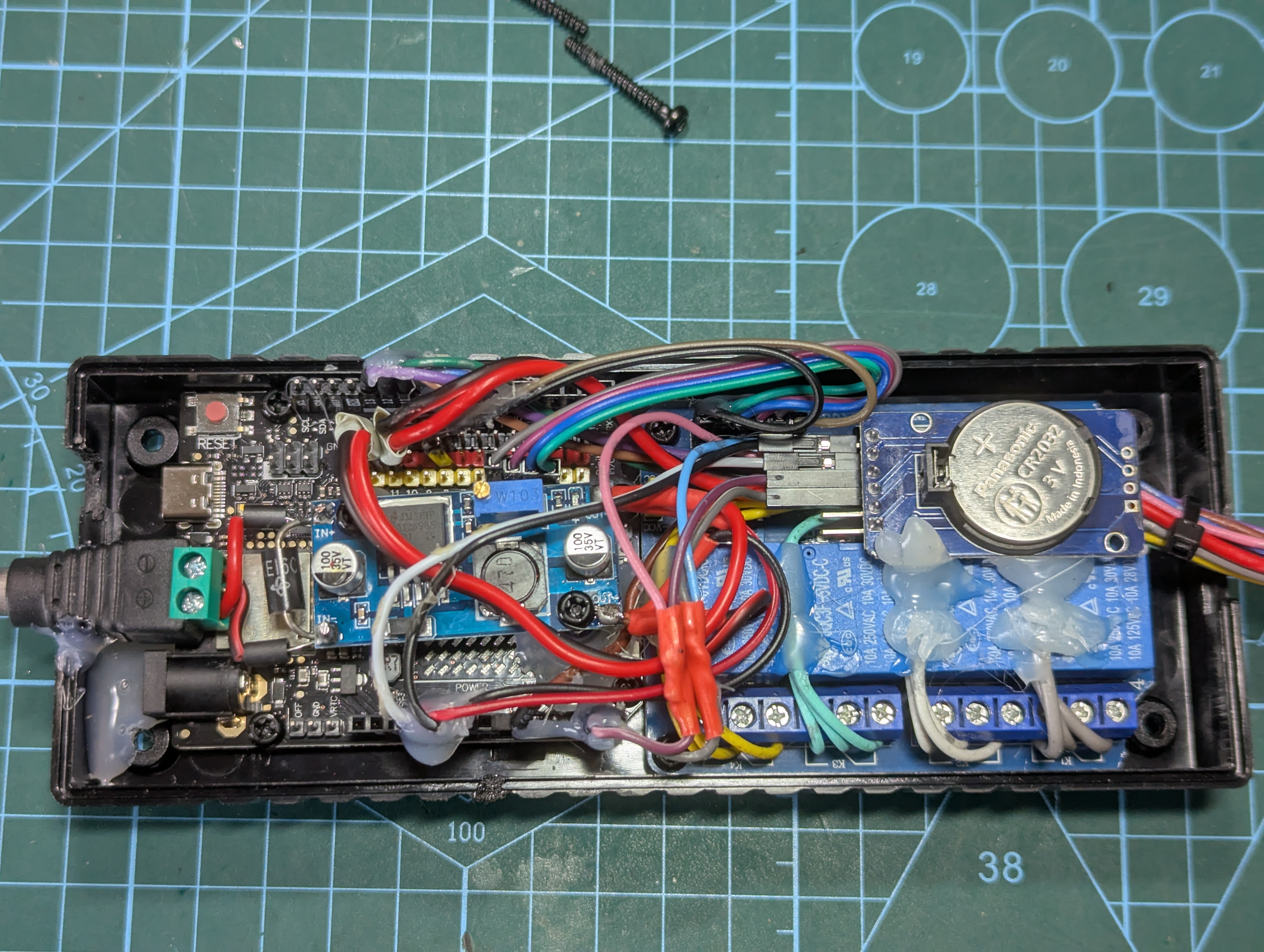

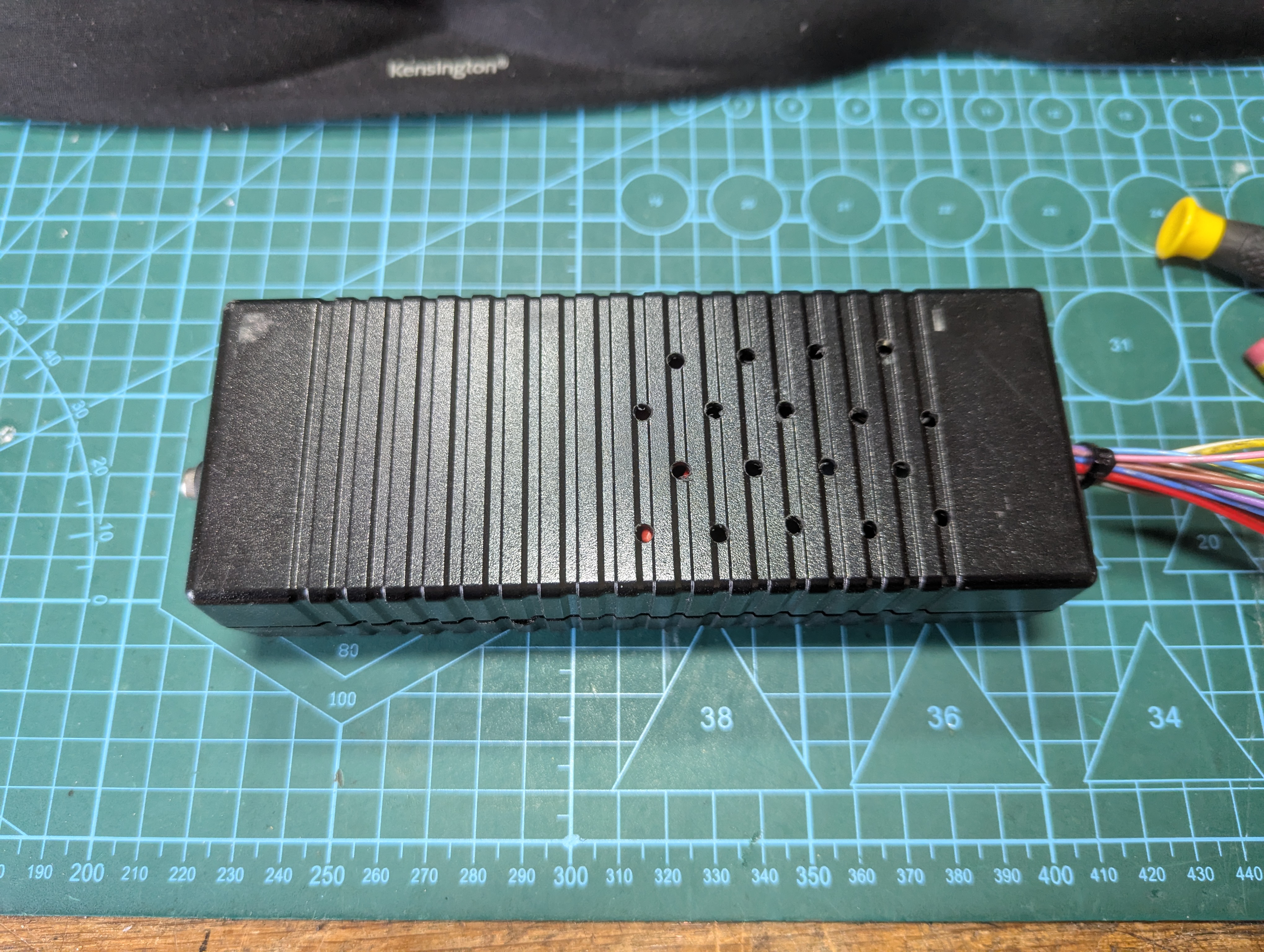

Sure enough when I checked what was powered by Ign pos1, everything is now controlled by the Zombie so the small fuse holder is out.

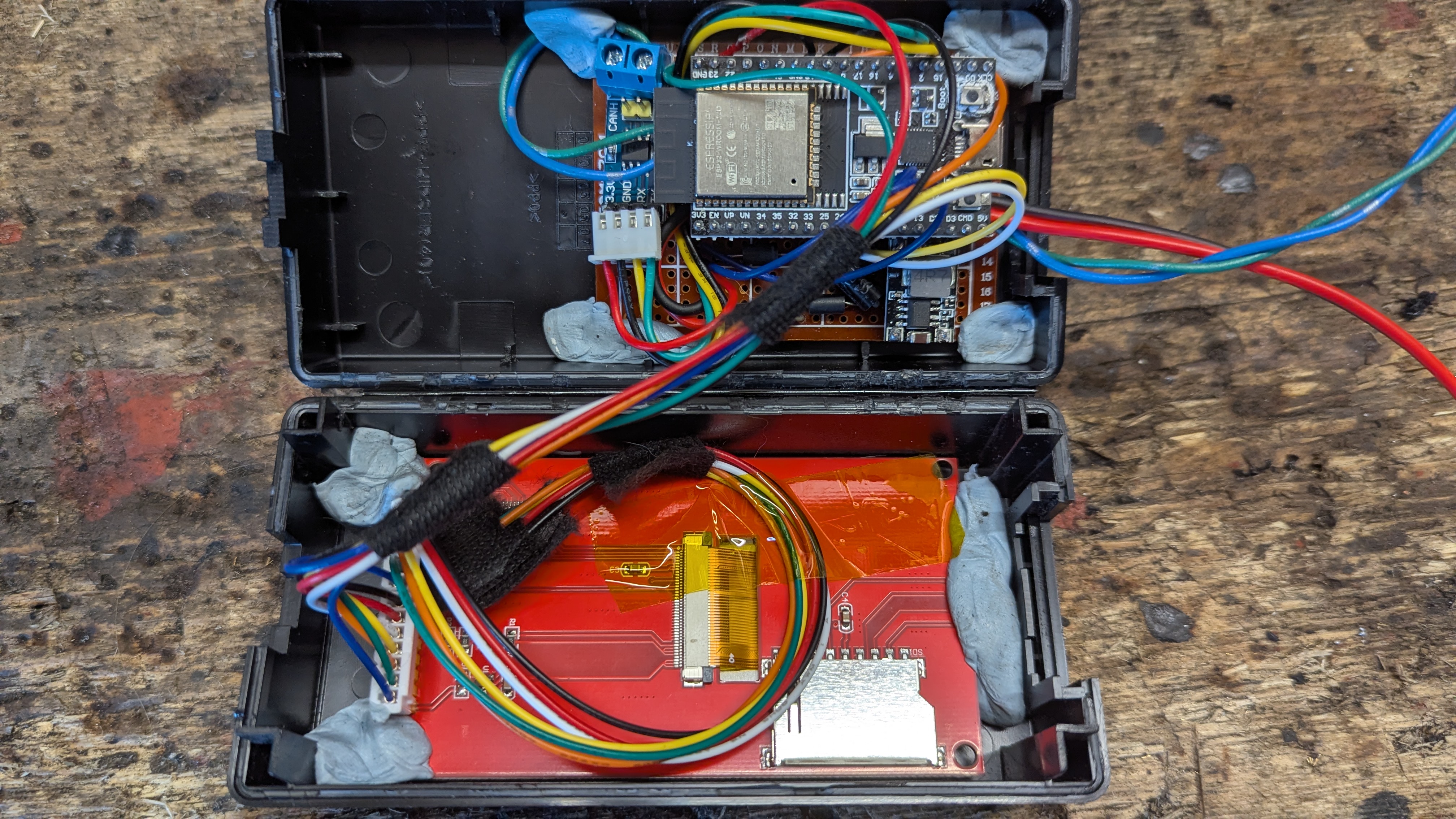

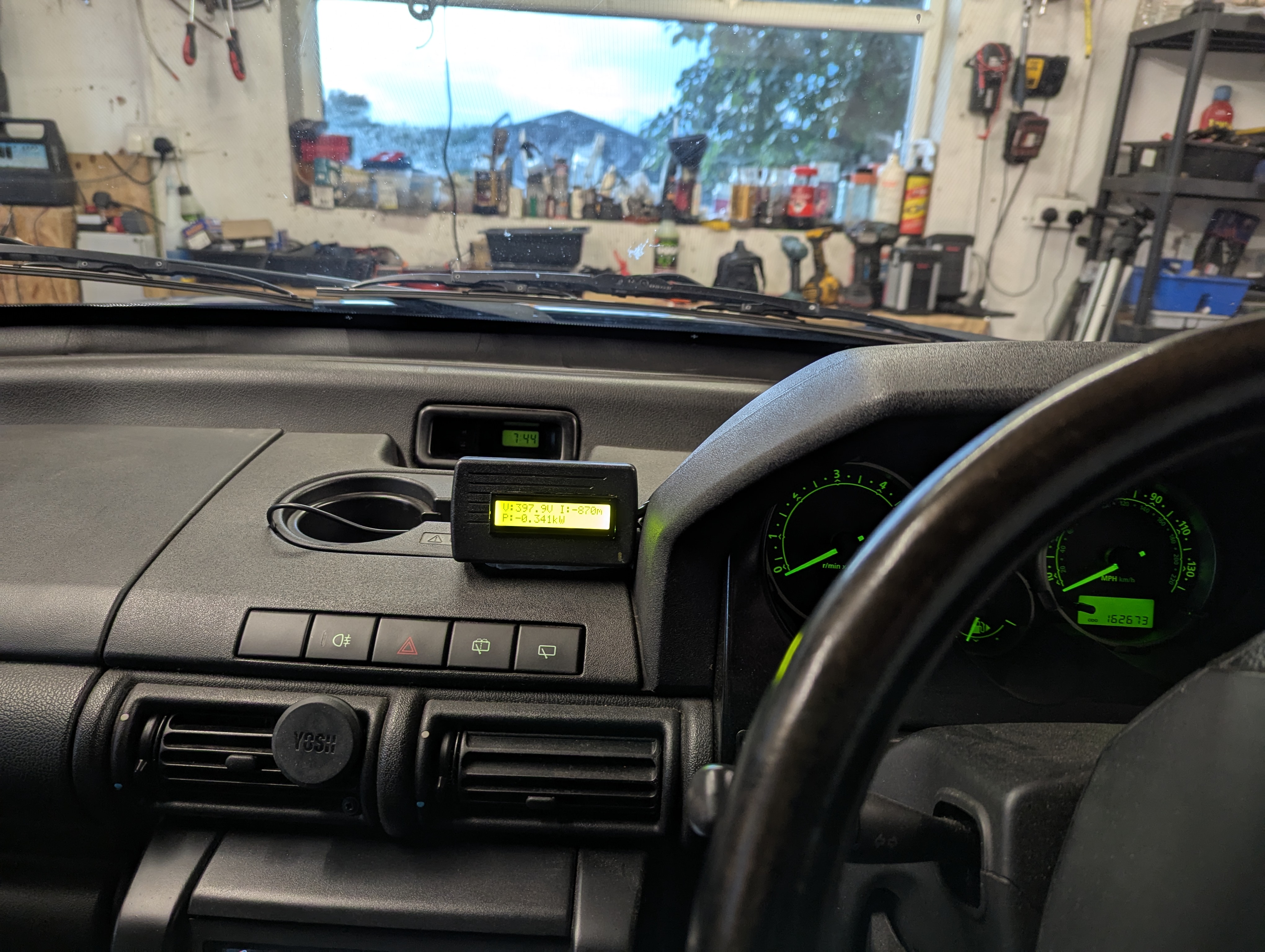

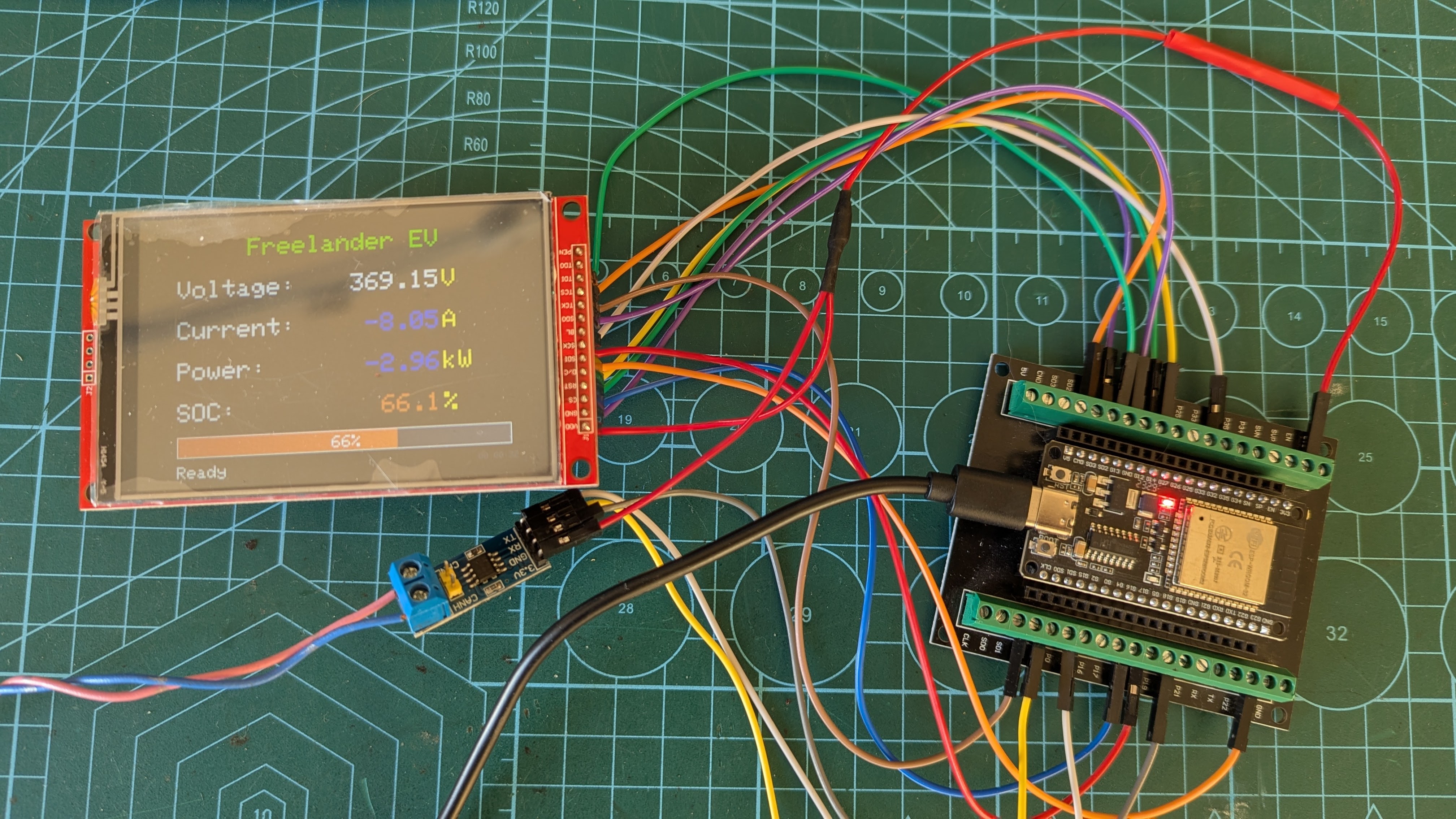

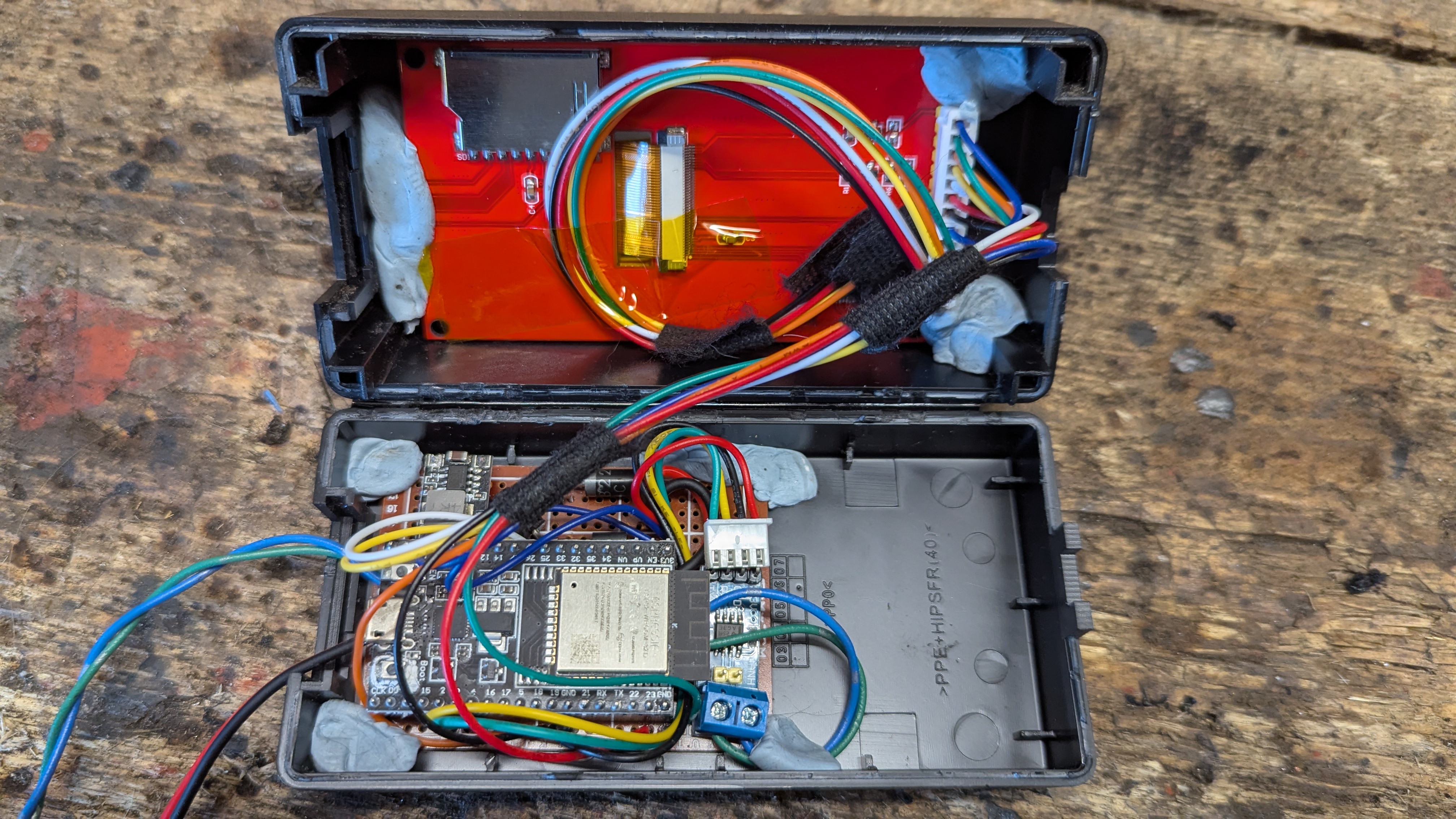

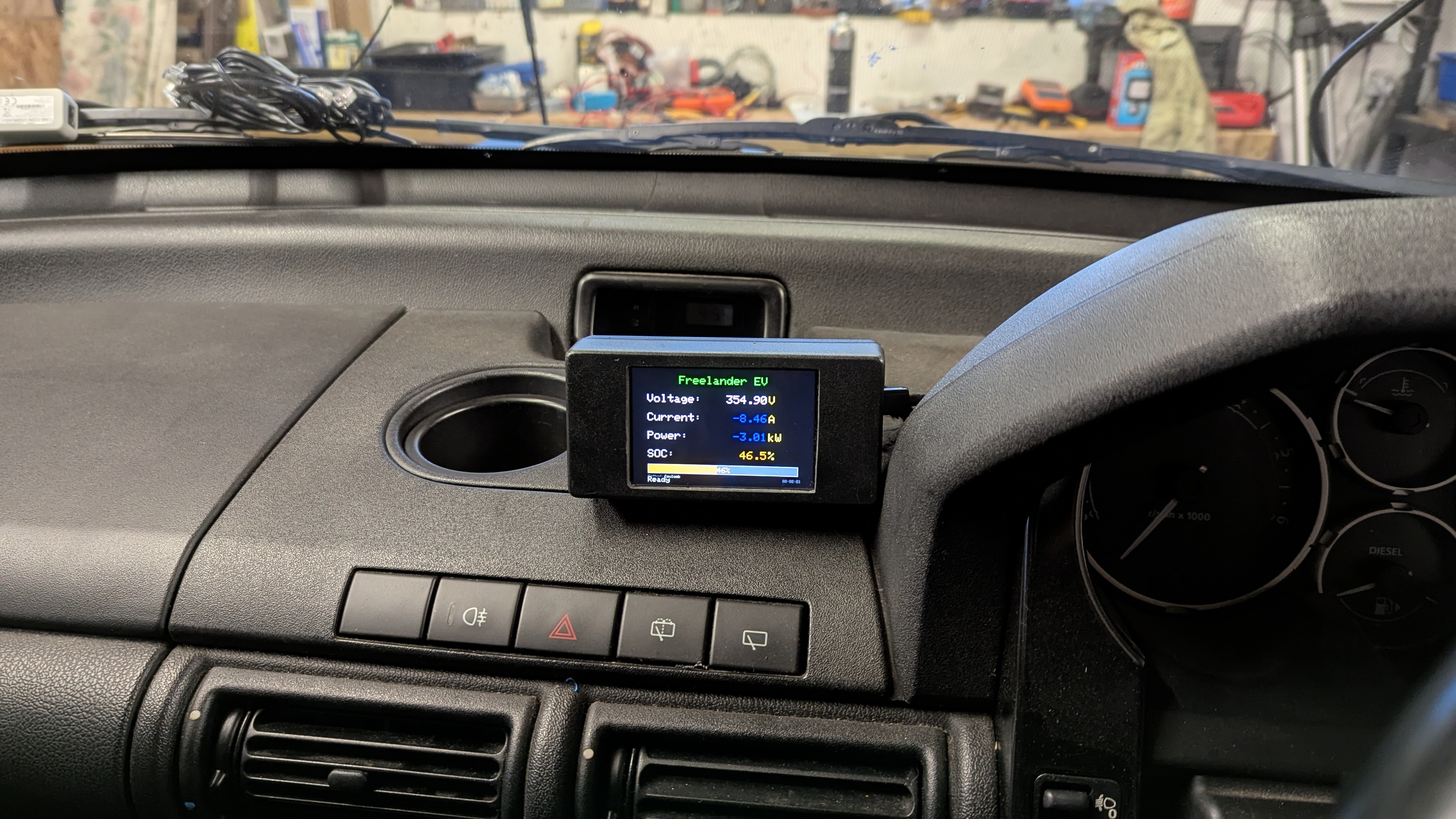

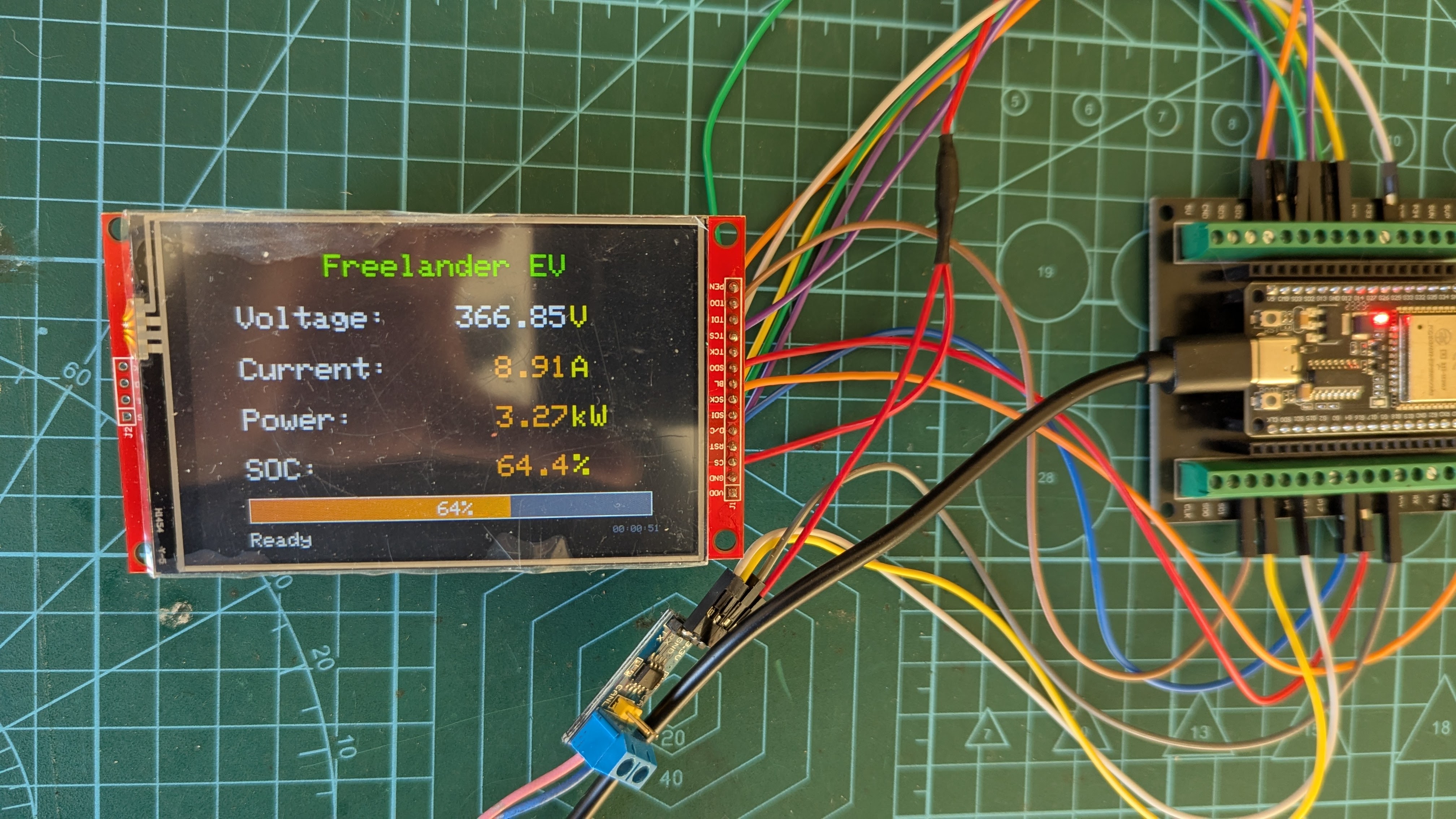

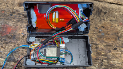

Hopefully I won't get too much stick for this but I plan to reuse the Arduino R4 WiFi. Reasons are I want a simple way to set overnight charging plus send 2hz PWM to the water pumps.
My EVSE is dumb so the car needs to control timed charging and the Bluetooth app I'm using makes this really easy. I've also added the PWM control for the pumps and as far as I know neither of these options is easy with the Zombie
Please tell me if I'm wrong here as reducing the number of Arduino's was one of my goals.

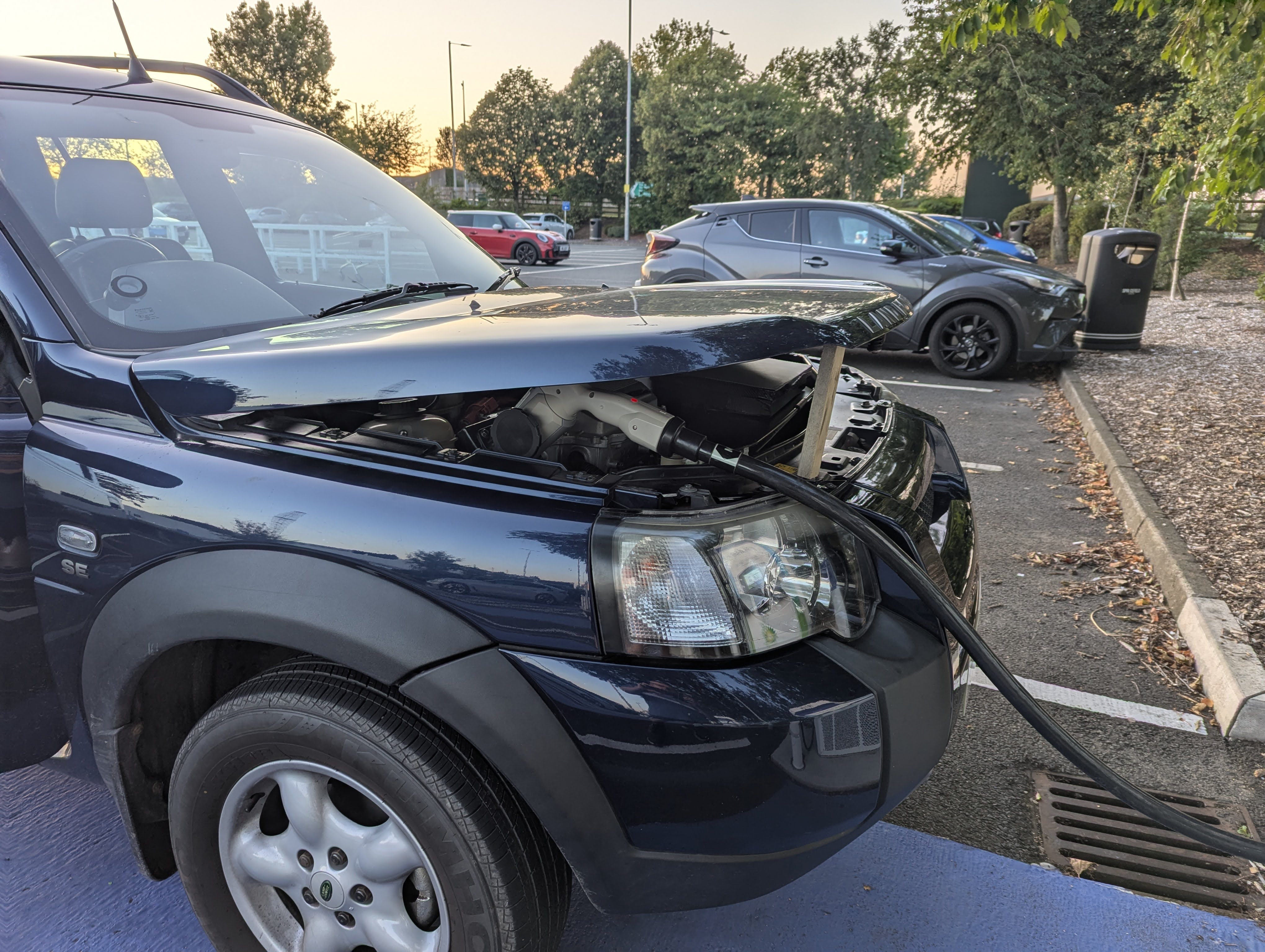

So we set off at mid day for the two hour (in a normal car) 100 mile journey hoping to arrive between 2:30 and 3 for the 3pm start. I had planned to stop at Castlebellingham services which is about half way for a top up charge as it is close enough to abort and return home should DC charging not work.
Charging enroute using the patented Gregpak 1001 bonnet/hood support
This was when I learned that Chademo chargers can be a little ........ mmmmm ....... iffy.
I tried the charger in the South bound service station nothing happened. Bare in mind this is only the second Chademo charger I have ever used and I had been working on the car the day before so it took a bit of faffing to confirm the issue was probably the charger.
This was now make or break time and we drove to the North bound services for a second attempt which thankfully worked. If it hadn't we probably would have gone home.
So with a mostly full tank we headed on to Dublin arriving at 3:45 and had a great time there meeting up with all the guys. A huge thanks to Marc for organising the event and all the guys in Dublin TOG for their friendly warm welcome.

So the charger in Castlebellingham was working right? Wrong! When I plugged it in a message appeared on the screen saying There is a fault!!!!!

I was a tad confused as to why and I wasn't able to sort it at the time so propped open the battery box lid, let it cool for a while then drove very gently to the hotel. The next day I was driving to the meetup so I took it easy and charged at a lower current making sure the contactor didn't get as hot as it had been. When I arrived I reversed into a garage to have a proper look and we decided it was the contactor and not the cable crimps as I first feared, the entire contactor was sitting at 70C.
The contactor was on the negative side of the battery pack so I was comfortable to do without it and moved the two cables onto a single terminal. Just to be certain I gave the crimps a squish with a big pair of mole grips but I don't think this did anything. Removing the contactor is probably not ideal but OK as a temporary fix and after that there were no further issues.

As mentioned earlier I had planned to reinstated the Arduino Uno R4 WiFi to control ac charging and today I got it working reliably (hopefully).
The Zombie has a timer built in but it doesn't keep great time and it's a bit awkward having to dig out the laptop every time I want to make changes so having a BT connection is handy. This is the output on the phone.
This was taken with the Charger plug pushed in but not charging and I was just about to set the start and stop times for overnight charging.
I also use this Uno to control the pumping speed of the Coolant and heater pumps so it has a dual purpose.
To change the pump speed I type "setpump coolant 75" or "setpump heater 55" or whatever.
The Uno is connected to a 4 x relay module and a RTC module.
I have a voltage divider circuit (Jamie sent me details of it) which powers the Uno R4 when the Type one plug is inserted.
When the Uno powers up it sits and waits until either I push a button or the timer initiates charging.
I have a 5V circuit connected to the PP input of the Zombie through the NC side of one relay so when the Uno relay activates it triggers the Zombie to go into charging mode.
Here it is built into an old PSU brick case.
I used a cheap Buck converter but put a couple of filters and a TVS Diode just like in this video.
BTW if anyone thinks doing it this way is dodgy please say and I'll make changes.
The Zombie is still controlling everything, this is just telling when to start and stop.

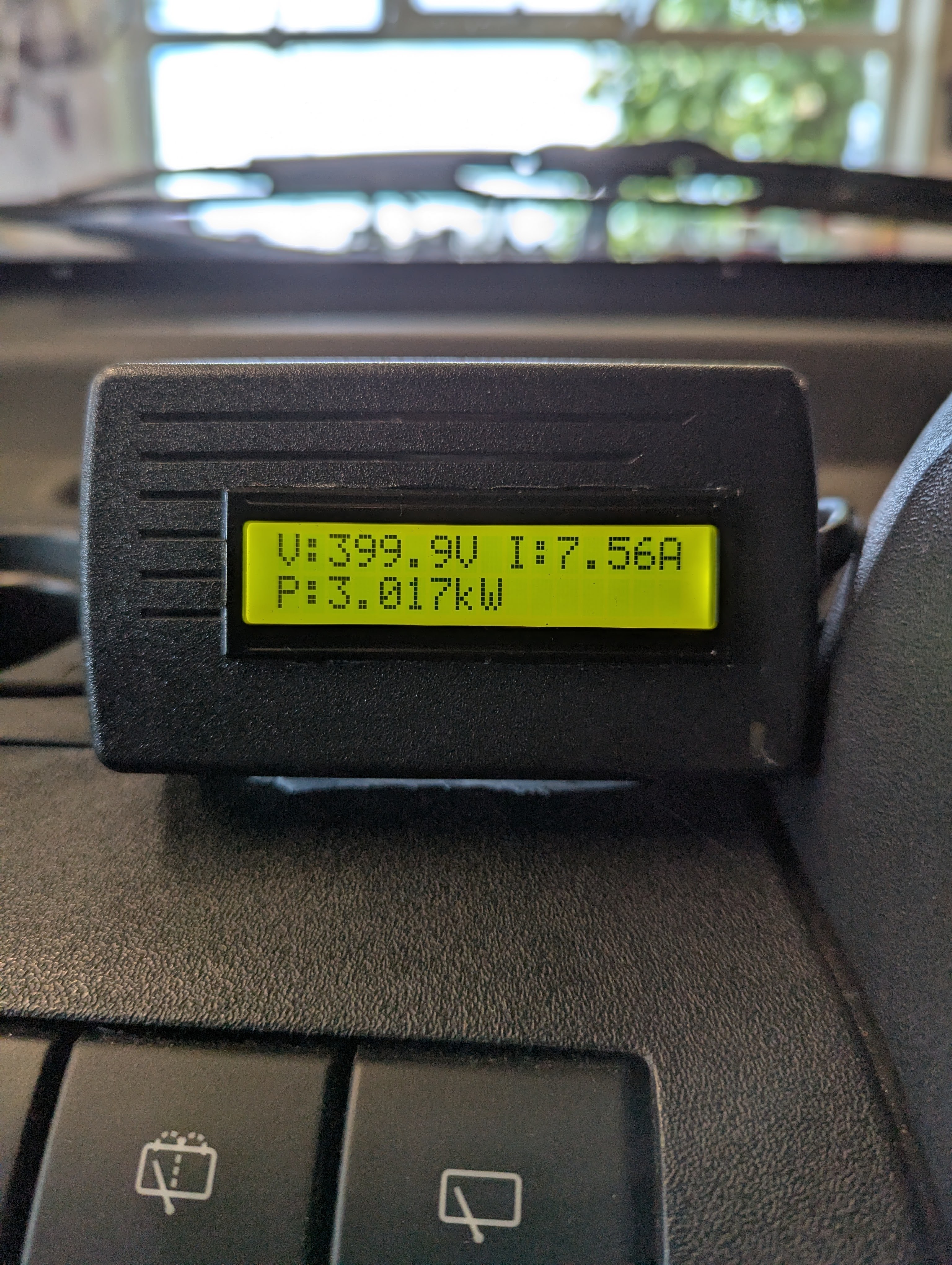

I thought I had already posted this here a few weeks ago but must have forgotten. Anyway this is from before my road trip.
In preparation for the big road trip to North Devon I spent most of yesterday sorting out a Voltage, Current and Power display to make it easier to see the state of charge. It's kinda critical to know what the pack voltage is to avoid running out of electrons and the WiFi display can be a bit flaky.
I hope to make something a bit more professional in the future but for now I came up with this.
This photo was taken as the pack was being charged and just a few seconds before the charging stopped.
I cut a hole in an old PSU case with a dremel to hold the LCD display and used another Arduino to drive it. :rolleyes:
I didn't have a lot of time to mount it nicely so gaffer tape and Bluetac will have to do.
The round thing on the air vent is a magnetic mount for my phone but I had to use a small screw to stop it rotating down all the time. All of this is easily reversible when I sort out a nicer display but as a quick and dirty job I'm happy.
It is controlled by an Arduino R4 WiFi that is getting CAN from the ISA Shunt. It also sends the info via BT to my phone.

The LCD display above works well and I even added a SOC portion but the LCD looks a bit crap so I decided to have a go at using a TFT display instead. After an embarrassing number of hours shouting at DeepSeek and prodding it in the right direction I finally got CAN data displaying from the ISA shunt.
This was while charging This was with the heater on It's an ultra cheap TFT display from Aliexpress on an ESP32 with a CAN transciever so probably under $20 for everything.
In these photos I'm playing a CAN log taken from the car when it was charging.
So the next step is to make a case for it and Bluetac it on the dash in place of the current one.

I did a bit more work on the display and got it installed using another old PSU case and some bluetac which is a temporary fix that will only be replaced if necessary.

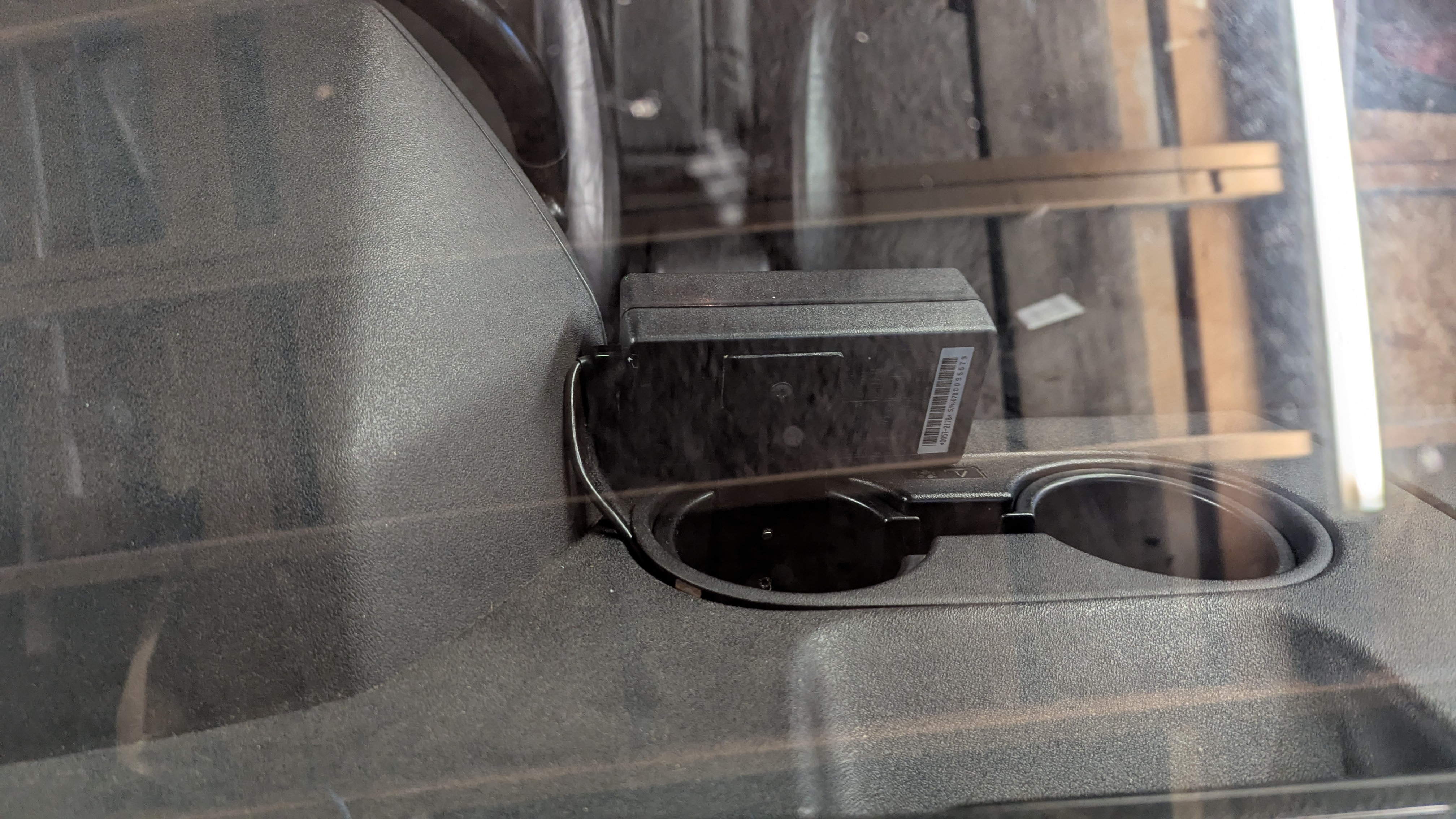

This is through the windscreen at the back of the display. I managed to bend a bit of aluminium to shape and secure it to a cup holder then feed the cables down through the dash to a glove box below. I fed down a USB cable too so it can easily be upgraded.
It still needs a bit of work to tidy up the display and maybe add more info but for now this is working well
