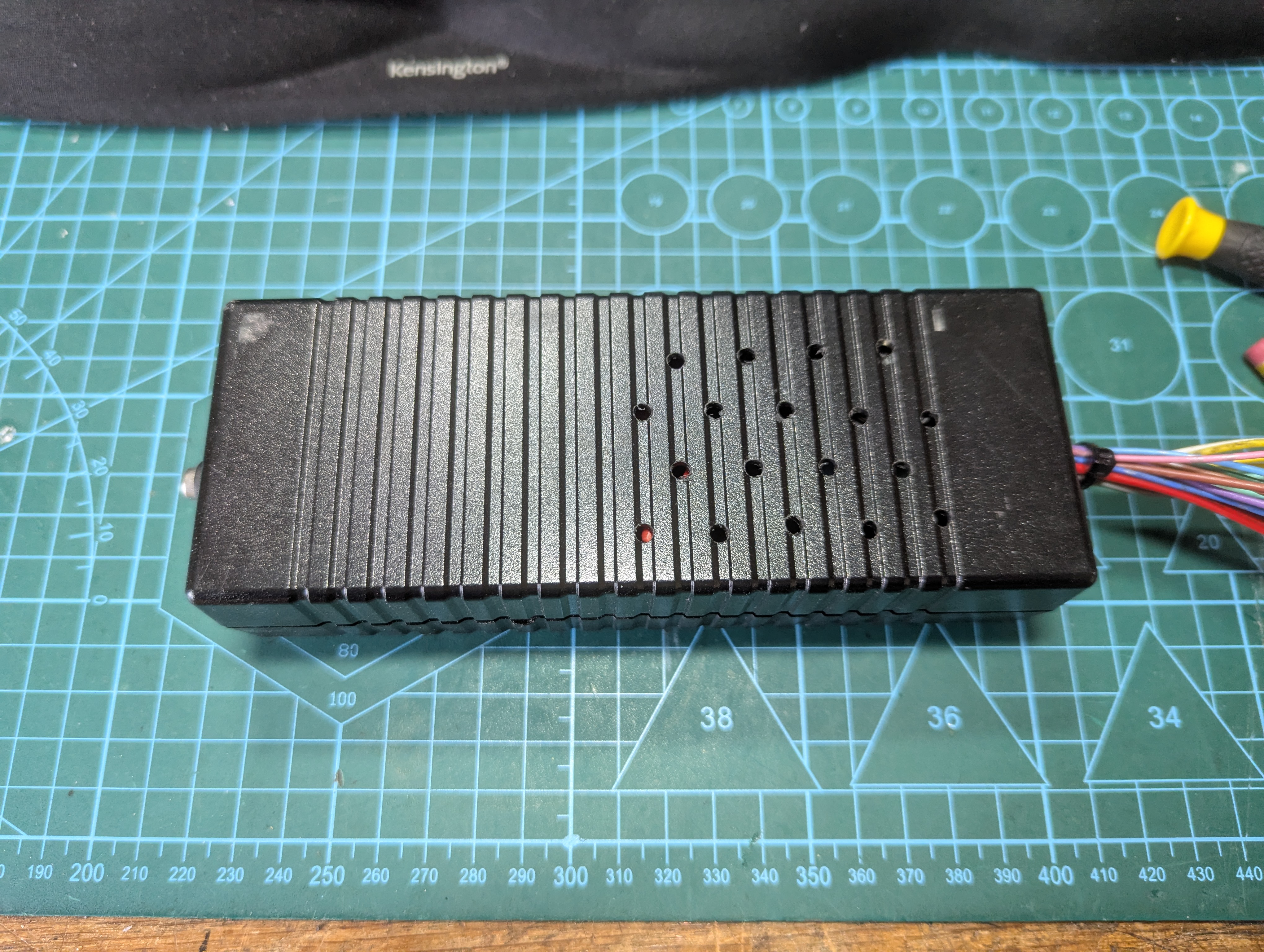

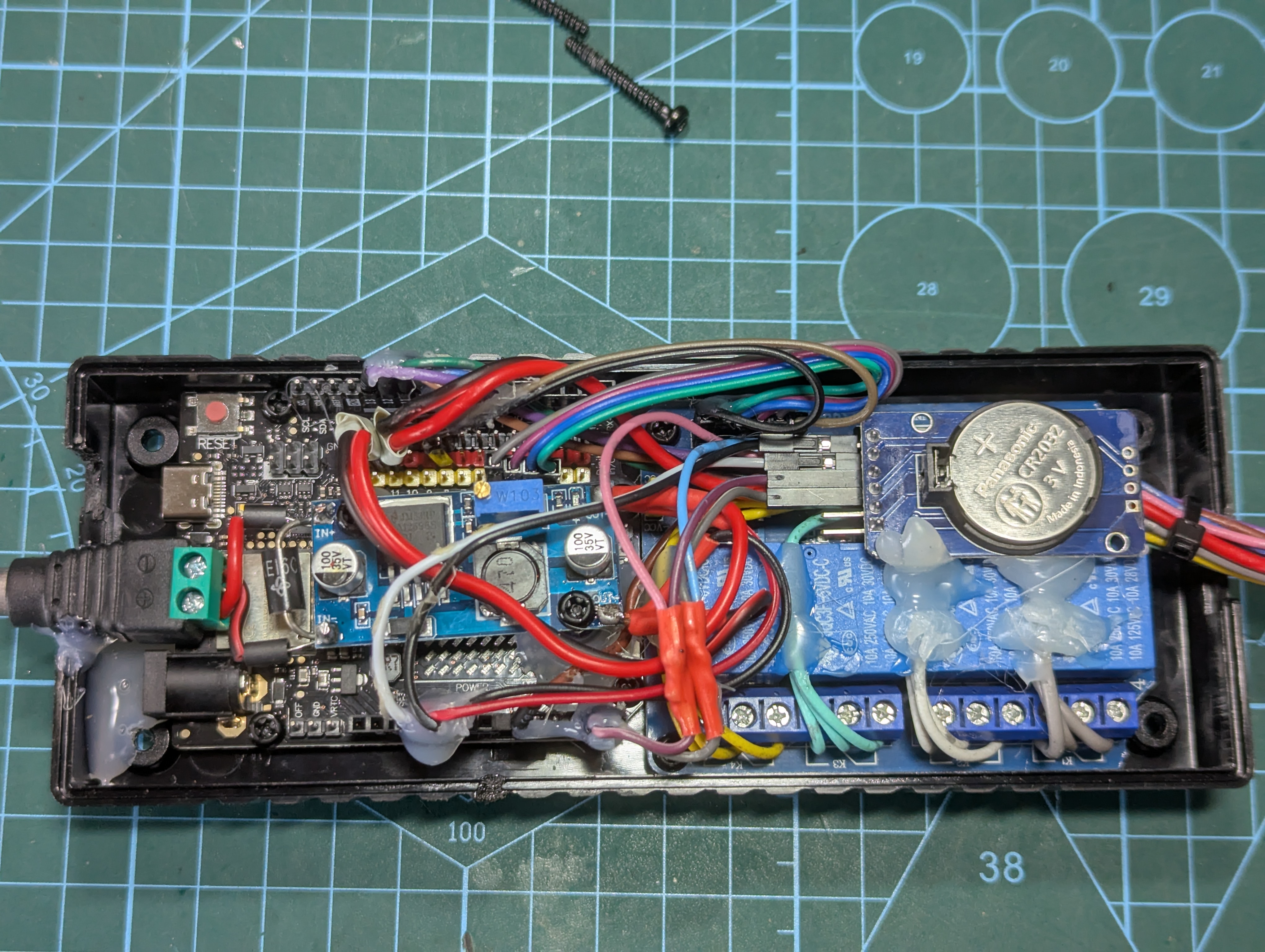

As mentioned earlier I had planned to reinstated the Arduino Uno R4 WiFi to control ac charging and today I got it working reliably (hopefully).
The Zombie has a timer built in but it doesn't keep great time and it's a bit awkward having to dig out the laptop every time I want to make changes so having a BT connection is handy. This is the output on the phone.
This was taken with the Charger plug pushed in but not charging and I was just about to set the start and stop times for overnight charging.
I also use this Uno to control the pumping speed of the Coolant and heater pumps so it has a dual purpose.
To change the pump speed I type "setpump coolant 75" or "setpump heater 55" or whatever.
The Uno is connected to a 4 x relay module and a RTC module.
I have a voltage divider circuit (Jamie sent me details of it) which powers the Uno R4 when the Type one plug is inserted.
When the Uno powers up it sits and waits until either I push a button or the timer initiates charging.
I have a 5V circuit connected to the PP input of the Zombie through the NC side of one relay so when the Uno relay activates it triggers the Zombie to go into charging mode.
Here it is built into an old PSU brick case.
I used a cheap Buck converter but put a couple of filters and a TVS Diode just like in this video.
BTW if anyone thinks doing it this way is dodgy please say and I'll make changes.
The Zombie is still controlling everything, this is just telling when to start and stop.

It's an ultra cheap TFT display from Aliexpress on an ESP32 with a CAN transciever so probably under $20 for everything.
In these photos I'm playing a CAN log taken from the car when it was charging.
So the next step is to make a case for it and Bluetac it on the dash in place of the current one. 😉

I did a bit more work on the display and got it installed using another old PSU case and some bluetac which is a temporary fix that will only be replaced if necessary.
This is through the windscreen at the back of the display. I managed to bend a bit of aluminium to shape and secure it to a cup holder then feed the cables down through the dash to a glove box below. I fed down a USB cable too so it can easily be upgraded.
It still needs a bit of work to tidy up the display and maybe add more info but for now this is working well
