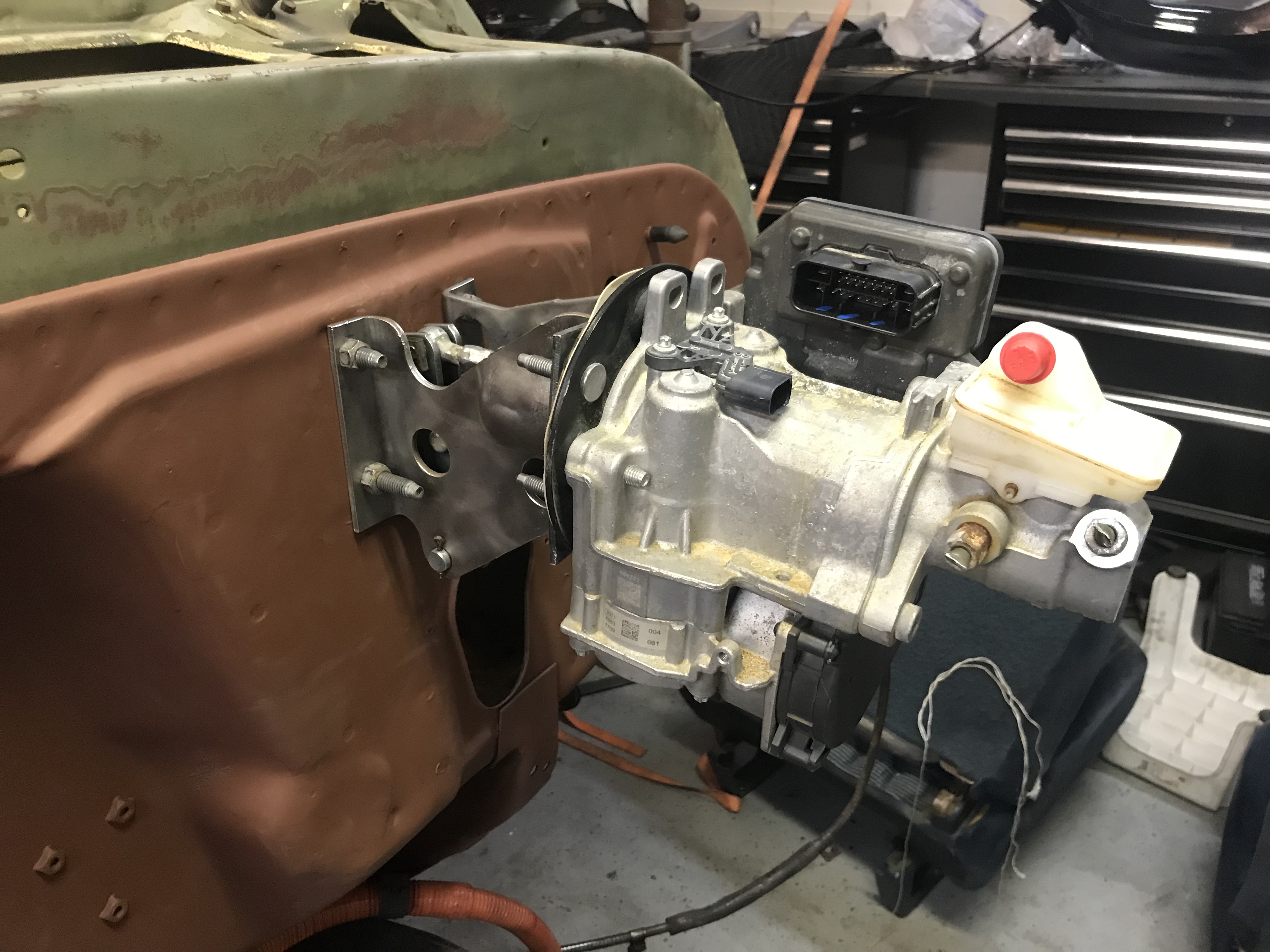

so when the combustion engine goes away, so does vacuum or the source of vacuum, this means that we loose power brakes, as the brake booster is vacuum operated, here I am starting to work with a replacement electronic booster called an iBooster from a 2018 Honda CRV (there were two generations of this animal, and I believe mine is still Gen 1)
thanks be to Lars and his amazing blog on this topic at EVcreate.nl Electric power brakes
but first the mandatory stare and compare (Chevy on the left, not Chevy on the right)

I can't believe the short sightedness of the Chevy engineers, that merely 50 years ago they could not foresee that we would some day be bolting up electronic components to these rigs, was all that pretend metric compliance for nothing? needless to say I must drill four new holes, oh the calamity

Posted: Wed Apr 20, 2022 2:07 pm
by Gregski
time to adapt and overcome
I may weld up the old holes, I may not

by Gregski
after little thought I just nibbed off this eyelet off of the old booster and stuckatized it on to the new one
Posted: Thu Apr 21, 2022 3:41 am
by Gregski
Fun Fact: Trusting that your 70s vehicle was built with the highest of precision fitment standards in mind and perfect symmetry is a sure way to make you drill and weld up your new holes two or three times to fianlly meet their polywhompuses
this is how off the factory brackets come off the firewall towards the new booster, they are NOT even (like I originally assumed)
Posted: Thu Apr 21, 2022 3:49 am
by Gregski
this is the part where you tell me I mounted it sideways or upside down ?
2018 Honda CRV iBooster same crap as in the Tesla but for a 1/3rd of the cost
