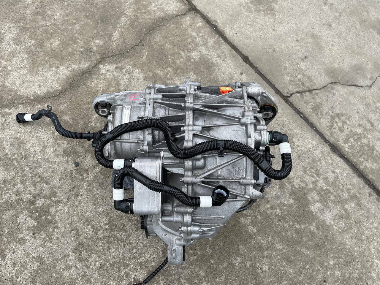

2: How does the model 3 front drive unit cool? This is also an induction motor - so will also get heated - and I can't see any coolant fittings on the case - so I presume either internally oil cooled? or not cooled at all?

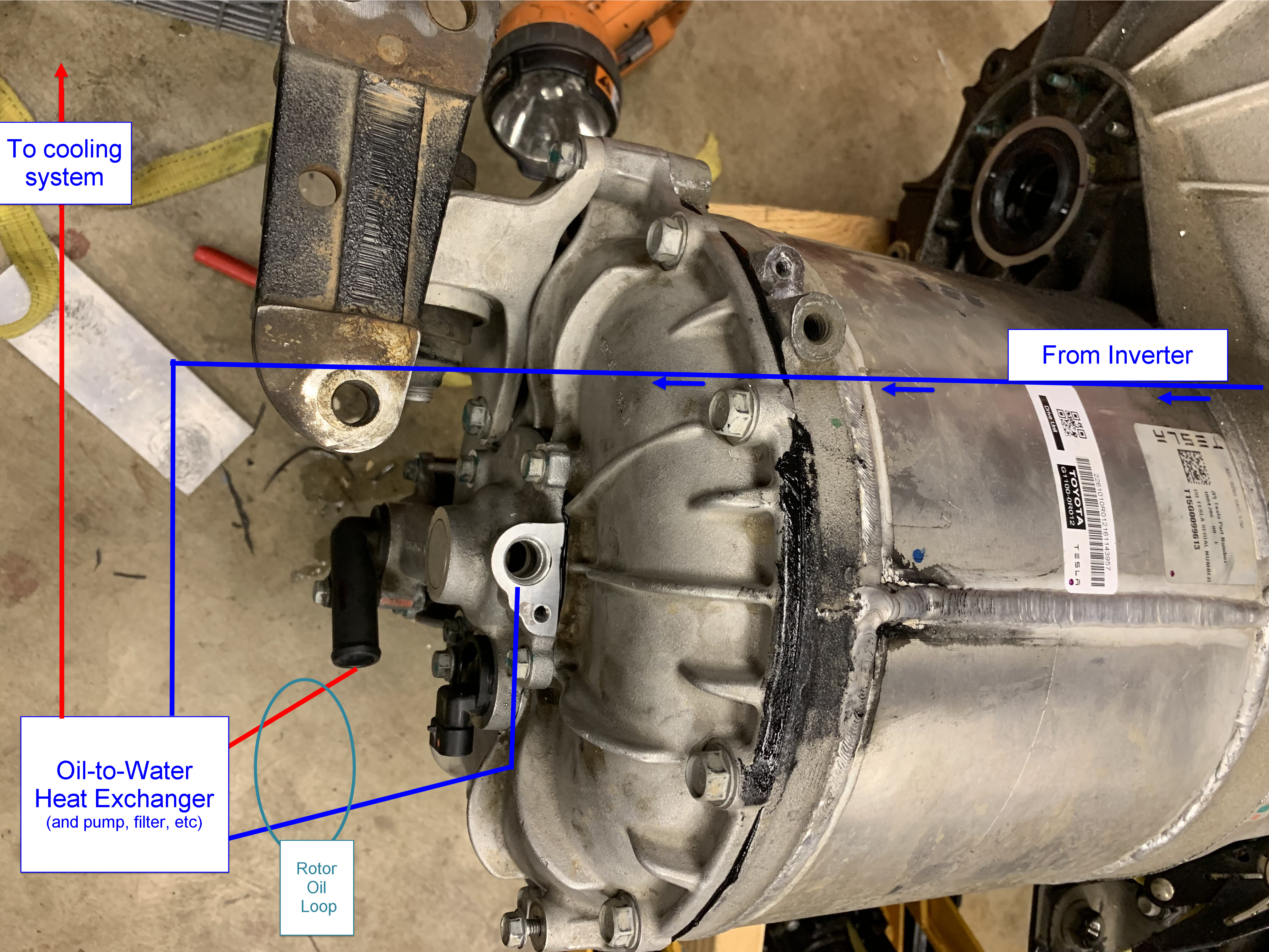

I think the M3 front induction motor uses an oil-to-water heat exchanger (see exchanger on left side of the pic below). It's cooled by oil internally, and the oil is pumped to the exchanger that's bolted to the exterior of the DU. Additionally, the coolant loop cools the inverter electronics first (see the coolant fitting on the right of the pic below) before routing to the heat exchanger, so the more temperature-sensitive electronics get the cooler coolant.

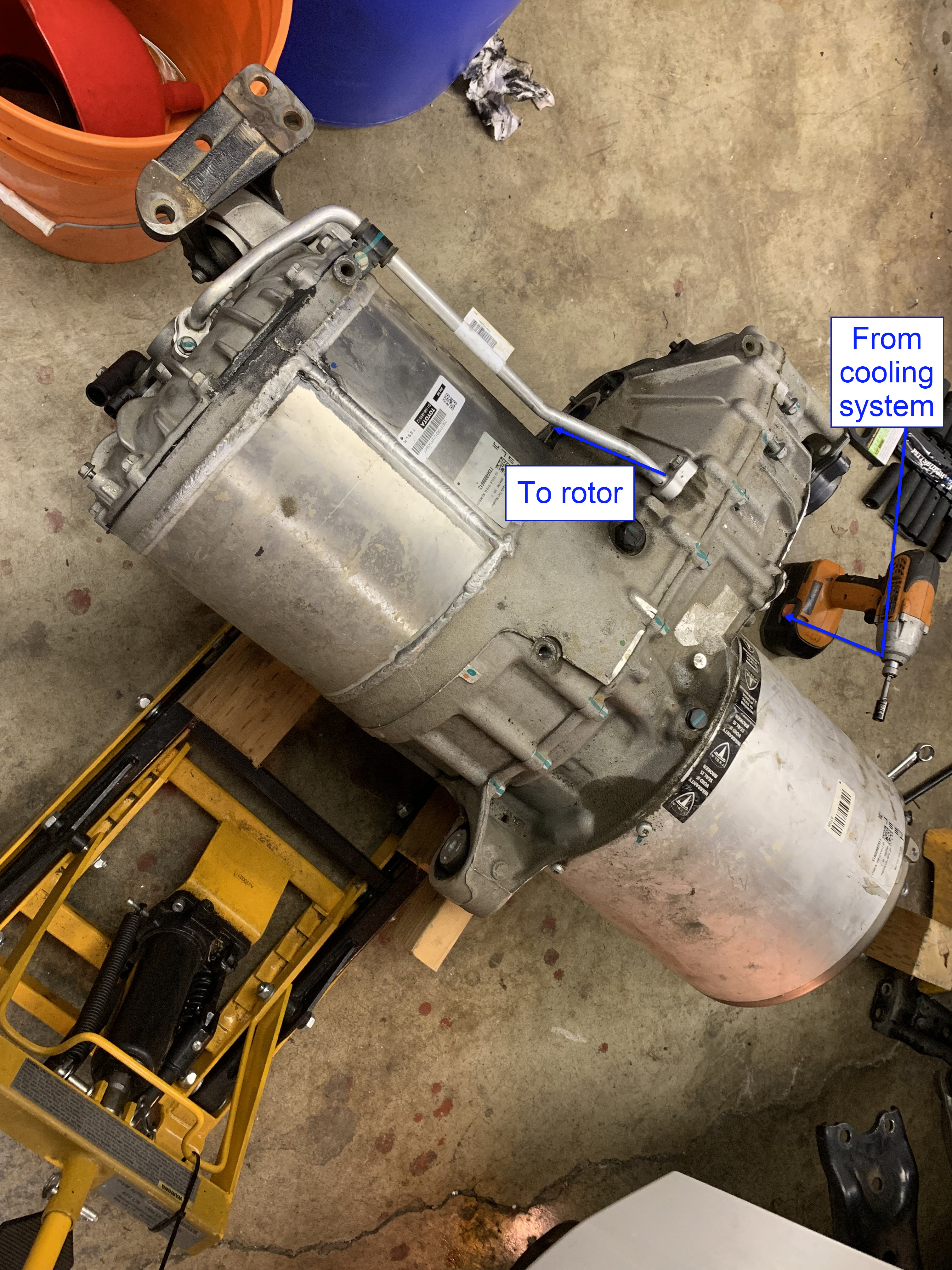

My suggestion idea No. 7 above was to use a non-water-containing coolant (basically: glycol) instead of a 50/50 water mix, so any leakage would cause no corrosion nor electrical harm. I bought a gallon of a typical gycol coolant, and a spare Tesla coolant pump and PWM module, but it's all sitting on one of my workbenches right now, waiting for some testing time.
I don't know if it's practical to convert the LDU to oil cooling for the rotor, and an external heat exchanger, but it's possible. The external aluminum coolant tube that the LDU uses to move coolant from the inverter side to the rotor side, could be interrupted, and a small closed-loop oil circuit established for the rotor side, plus a heat exchanger.
This might be practical for recycled LDUs in EV conversions, but possibly not practical for Model S installations, which is what Howard is aiming to achieve.
My drawing tools are limited, but here's a mockup of a oil-to-water heat exchanger, plumbed in to an LDU:
