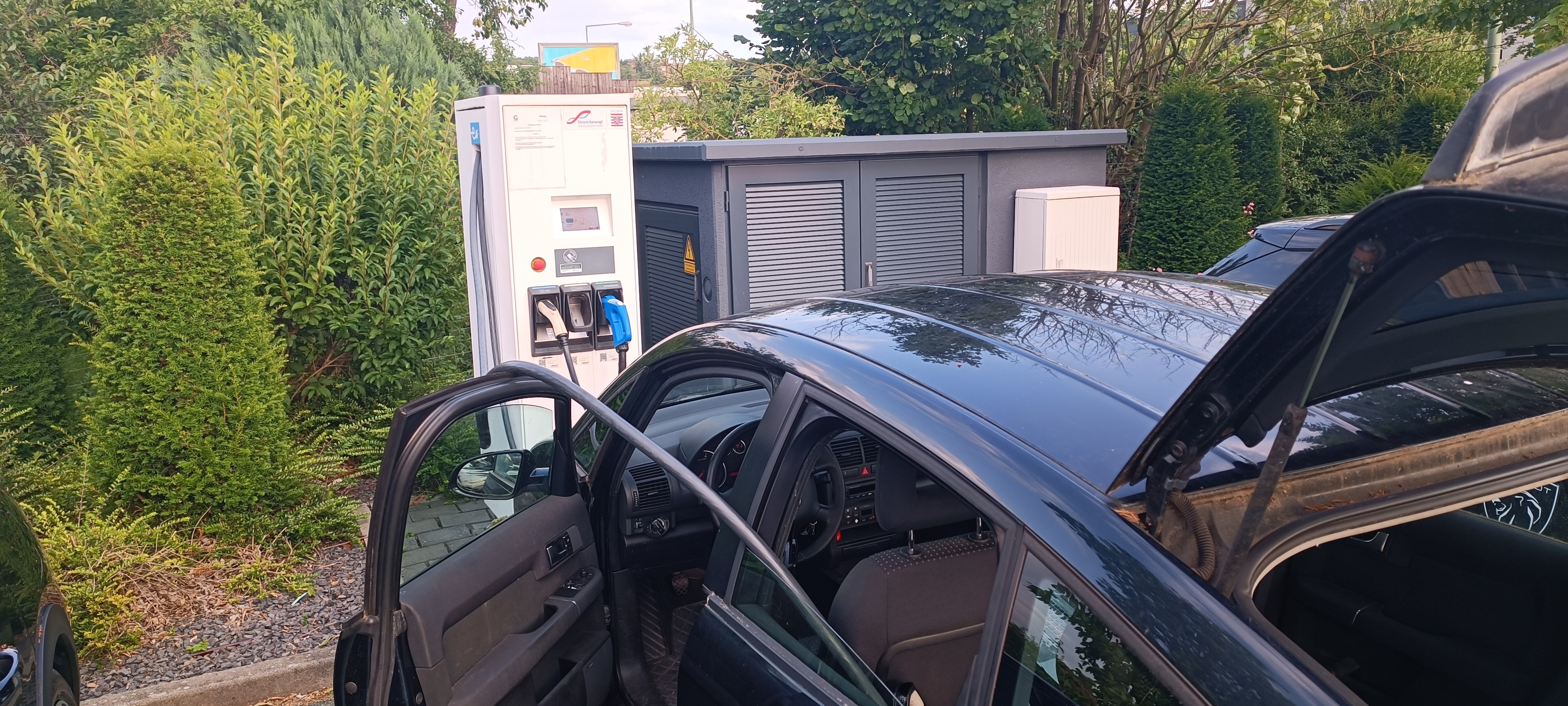

The Ionity, after charging for around 10s with 382V and 72A, says "EVSEStatusCode_text": "EVSE_Malfunction". The famous standard knows exactly two reasons for this status code:
1. Isolation Failure
2. "..."
Since in the same response the EVSEIsolationStatus says "Valid", this does not look like a isolation failure. So it must be "...". Great, or?

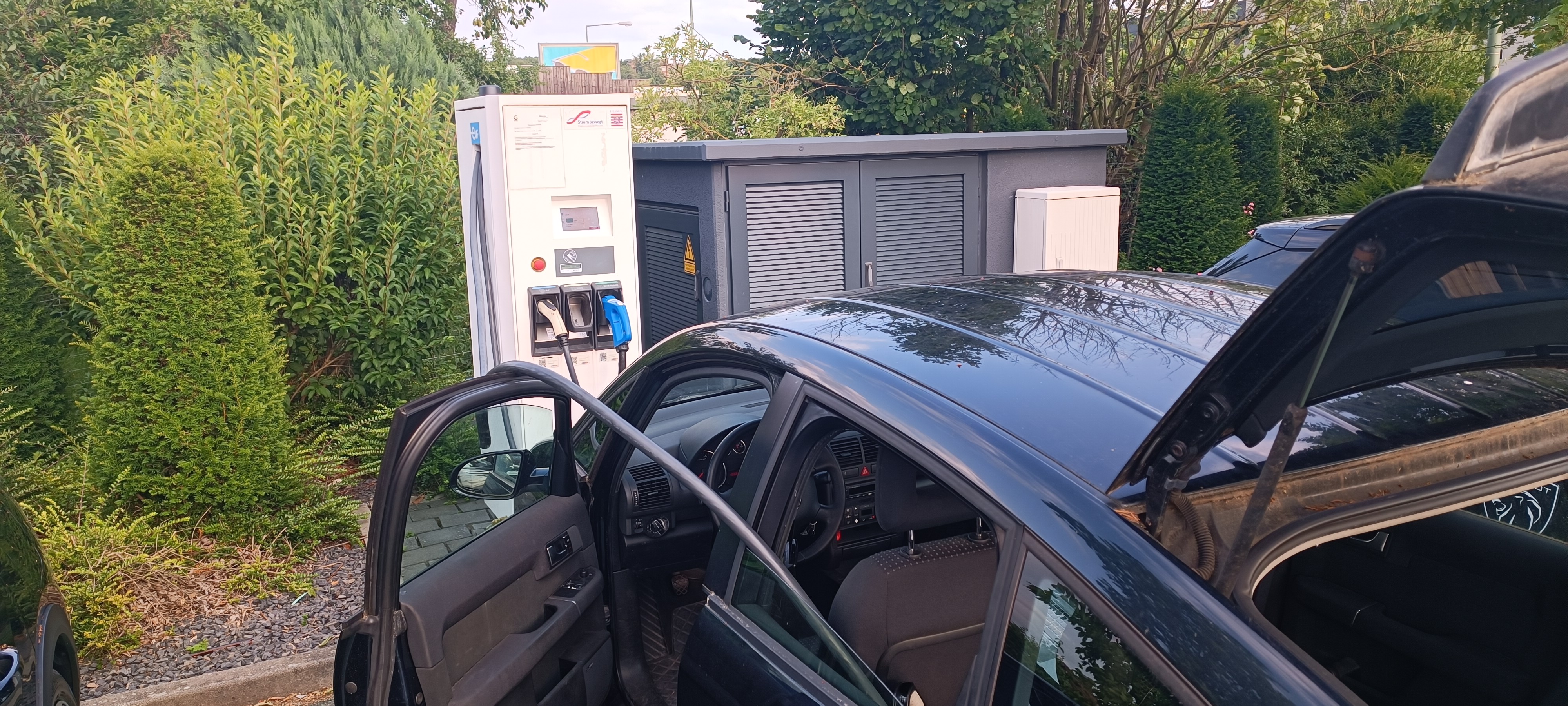

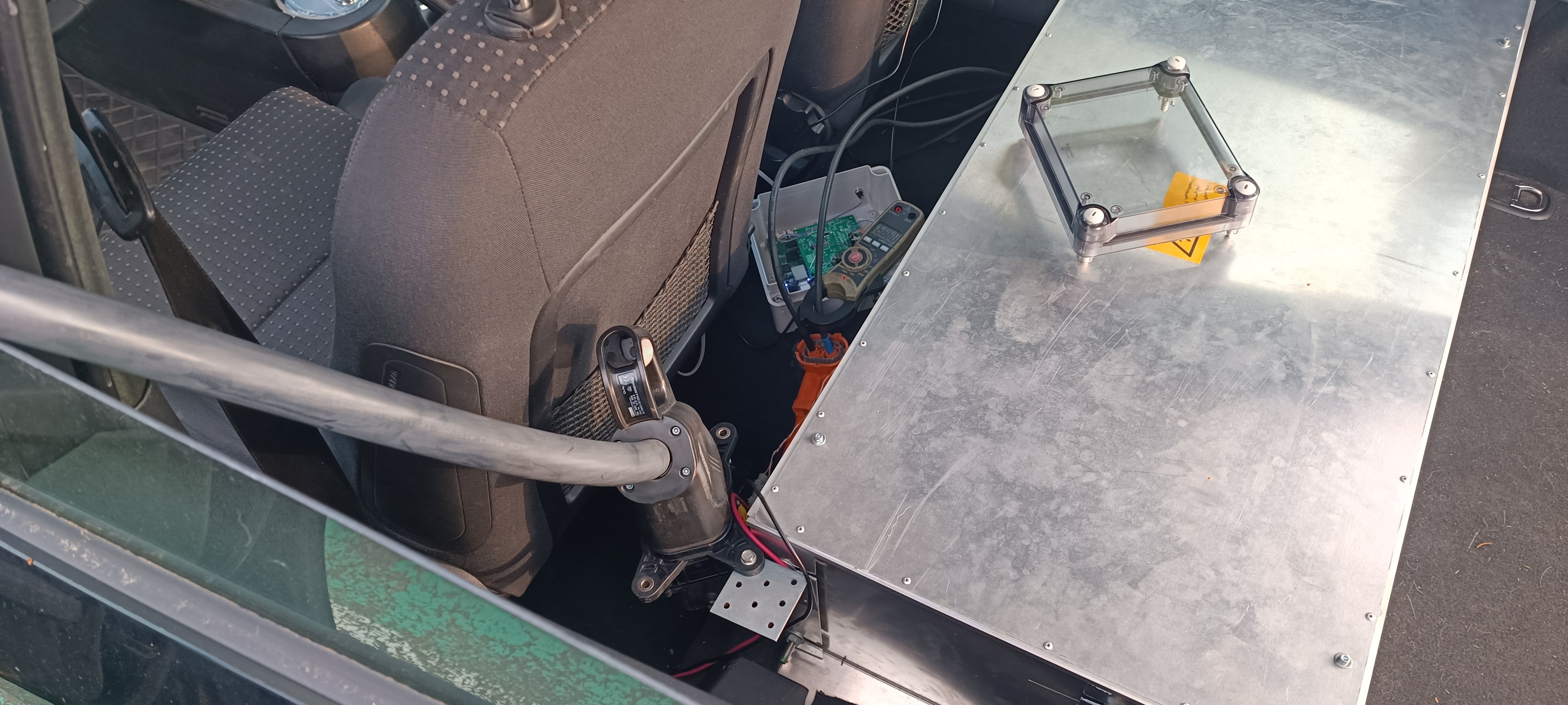

I have now removed the negative port relay and applied your patch. Result: most ABB chargers work, some don't
I also went to the Porsche charger again and it just suddenly stops sending messages and goes red. Same behaviour with and without second relay.
Ionity Tritium chargers didn't change behaviour with one relay.
EDIT: added some pictures of my "charging window"

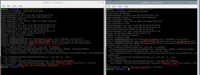

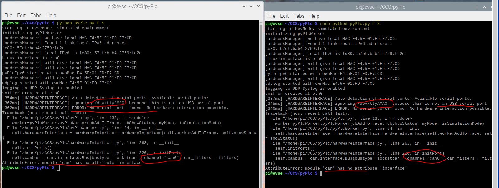

Slowly slowly, moving along. My RPI now has Can Bus to the rest of the car to read off the battery voltage and SoC. Will also take limits from BMS.
Not sure why it cannot find my modem any more, but I should have a CCS socket shortly so I can head round to station and see if they talk, once fixed the missing modem.
[2620ms] [HARDWAREINTERFACE] raspberrypi: Set SoC to 80 %
[2904ms] [CONNMGR] 9 0 0 0 0 0 0 --> 5
[2909ms] [ModemFinder] Starting modem search
[3337ms] [HARDWAREINTERFACE] raspberrypi: Set battery voltage to 369 V
[3478ms] [ModemFinder] Number of modems:0
[4082ms] [CONNMGR] 9 0 0 0 0 0 0 --> 5
[4087ms] [ModemFinder] Starting modem search
[4683ms] [ModemFinder] Number of modems:0
[5300ms] [CONNMGR] 9 0 0 0 0 0 0 --> 5
[5305ms] [ModemFinder] Starting modem search

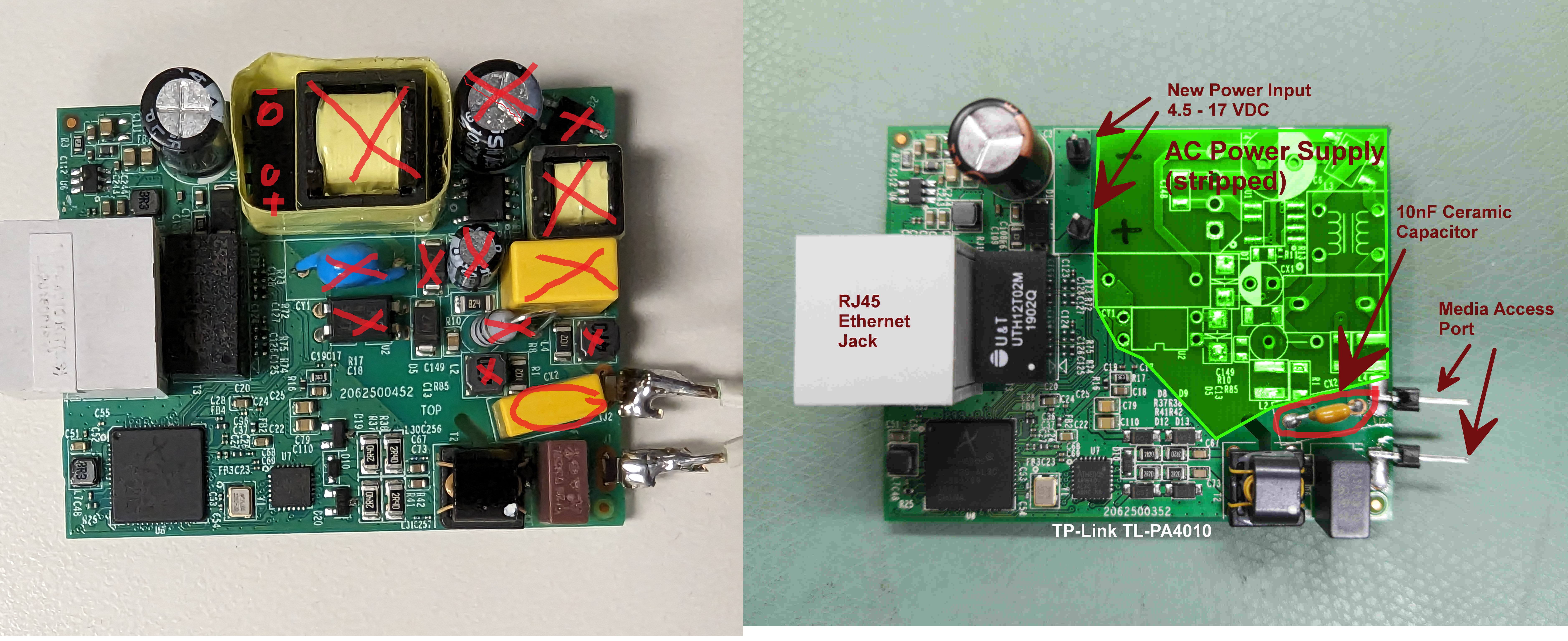

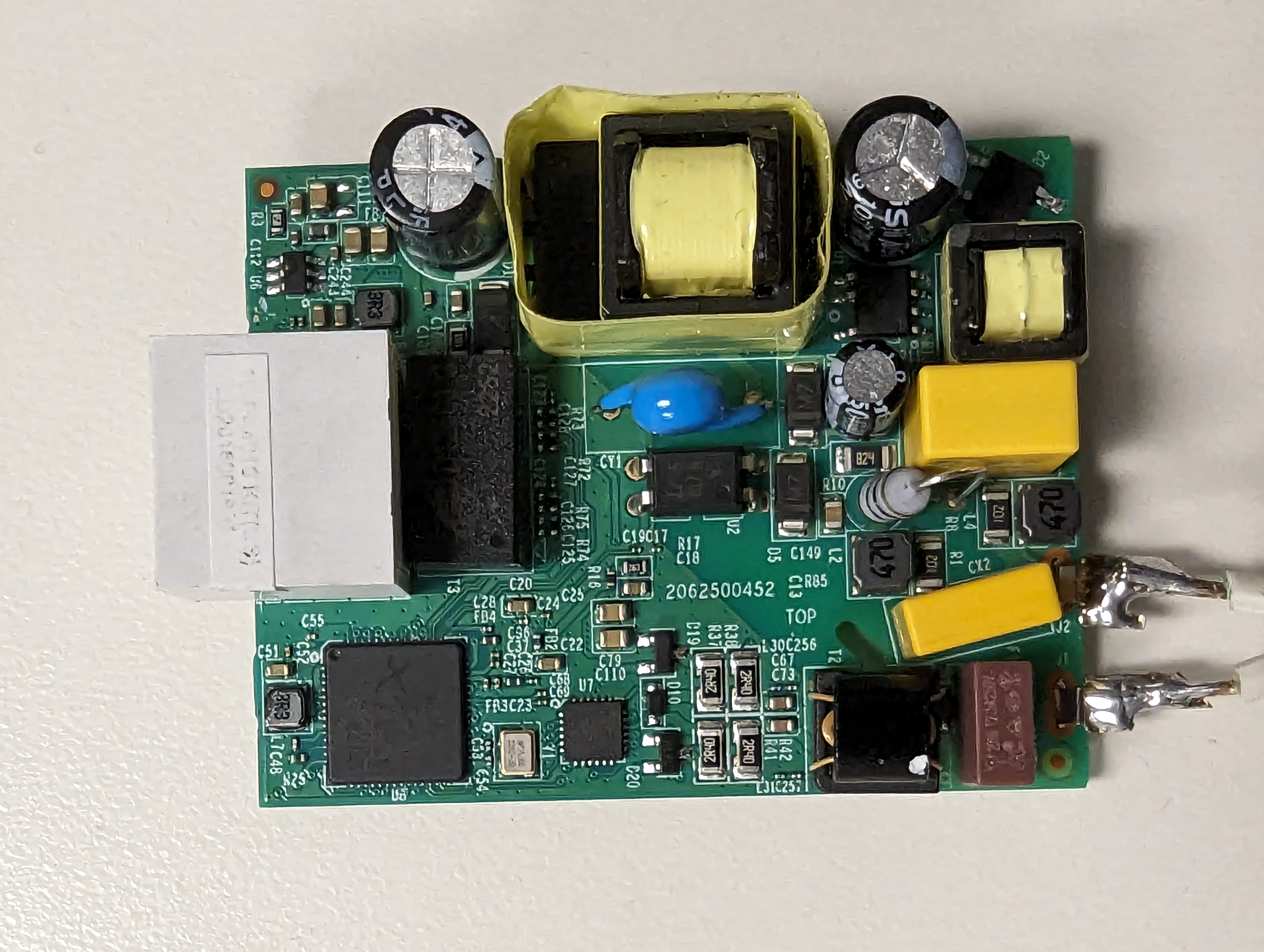

Hi all - you guys have been doing some fantastic work on this.
I have a used Chevy Bolt 2018 and am trying to use your codebase and pointers to emulate the EVSE component of the pyPLC project (have ordered the TPLink GreenPHY modem TL-PA4010 KIT from Ebay). I am trying to get the complete picture on what components are needed to get this setup h/w side built - my use-case is to put the pyPLC in EVSE mode and emulate the charger side and perform some of these use-cases:
1. close contactors on EV side
2. read SoC
3. put the EV in charge state
4. put the EV in (dis)charge state (more like discharge state and ability to draw power V2H type)
5. Implement a sniffer to capture the protocol messages from the EV side.
I understand the interface at protocol level but not sure how this needs to work with the rest of the elements like Arduino for PWM/CP type work and how that fits with the RPi and TPlink/QCA GreenPHY modem. I am going over the posts but there are many evolutions and schemes but I would like to go with an approach that would work without too many changes. Get the connectivity going and then focus on s/w from Pi perspective.
Also my expertise is more on s/w side - I opened up the modem housing but the board/placement of the components doesn't look similar to what is seen in some prior posts from other users. I am attaching the pics from my modem if someone could provide any guidance on how to proceed. To begin I would like to use the pyPLC processes on 2 sides (2 RPi connected to EVSE/PEV emulated sides) and get them to communicate. Once that works move to the next step with the Arduino/PWM and getting the charger to states A, B, C to keep the EV side happy (I wil more questions but first need to get started).
I have built my 2 RPi setups but waiting on completing the h/w mods as well as flashing the EVSE/PEV side of the PIB and/or f/w (if needed) to get the modems to implement the correct protocol stack at L2/LLC side.
Any help and/or pointers to get me started would be appreciated. TIA.

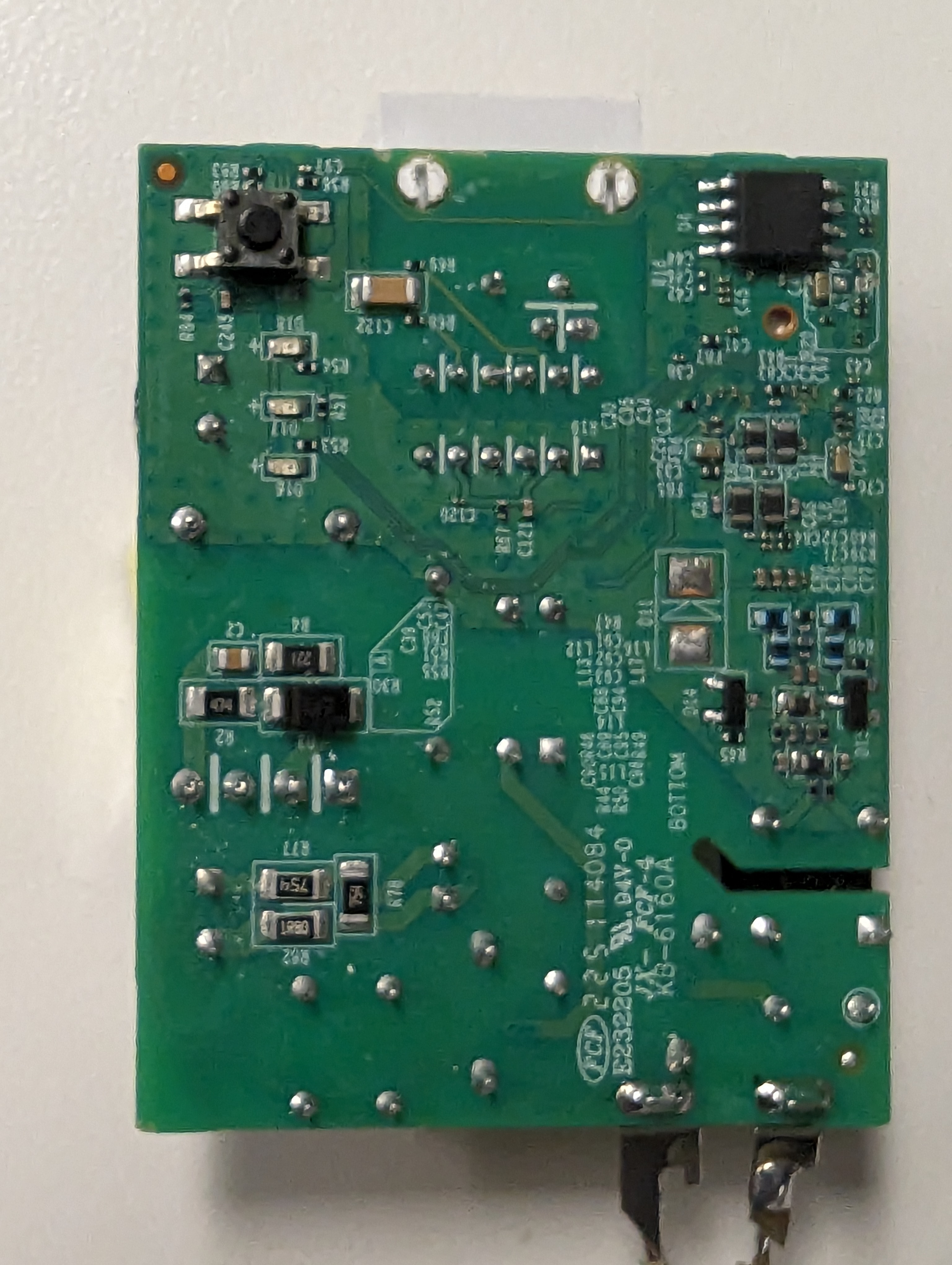

Looks like you grabbed a single board variant, i.e. power supply and logic on the same board. Just find the various rails, usually 12V and 3.3V. Inject 12V and see if that fires up the 3.3V as well.
- Posts: 1884
- Has thanked: 91 times
- Been thanked: 517 times
Check the cap pins when it's powered up, that's a good starting point to find 12V I found. Obvs taking safety considerations when probing.

Oh, goody, another variant.
It looks more-or-less like catphish's and one of mine:
I think you can figure out the 1:1 correspondences for much of that, just visually. The bottom side, maybe not so much. Once the big stuff is removed (esp. the transformer), it likely doesn't matter if some small bits are left behind, the circuit won't be dragged down.
You're aware of the other thread?
Drawing power out of CCS port (V2x, inverse charging, bidirectional CCS)
viewtopic.php?t=3551
Thx @johu, @asavage, and @bigpie for your prompt responses. Yes, this is the non-passthrough version I found on eBay. It's a newer version 3.x v/s the 1.x when I closely looked at from pervious pictures you folks had posted.
I will do the recommended and validate the voltage at the capacitor pins. That seems like a good starting point. Then will start eliminating the transformers next. Just to be on the safe side I also ordered a set of older variants today from eBay to be closer to the ones you folks have working (in case I bust these).
@asavage - yes, I did go through the thread for inverse charging - that is one of the goals but first things first
Reading the posts I realize most of the folks are trying to implement the EV side of the interface while few including yourself were more interested in EVSE side. My focus is on this side and use the Chevy Bolt EV as the PEV (it supports CCS1 interface today). Once I get this comm working next, I want to understand the tie-in to the Arduino for the fixed voltage 1KHz PWM at 5% duty cycle and how to get that built up and integrated. The h/w instructions on the instructible seemed pretty complex to the Arduino HAT but will look at it closely. If anyone here has pointers to simplify that plus pictures on how to connect this to the PE/CP interface of the GreenPHY modem side, please provide (@uhi22 had pictures with the EV Deiter LV/HV side if I remember correctly but not with the EVSE side of the Arduino - please correct me if wrong).
Another option I was also looking at was the QCA 7000/7005 modems available prebuilt on AliExpress. They're much more expensive but seems they've done some of the work to make it easier to integrate and bring up (hopefully
As I work thru this, I'll try to document the steps and tie some of the stuff you folks have worked on together. Lot of good info just that it's a bit scattered across the posts so a cleaned-up procedure would help... Thank you again.

I went back some posts and one of the posts had this link http://www.helicopting.de/
So I compared my board with this and seems they're very similar...
So I'll work to eliminate the AC PS side of things and see if it works. One question for the media access ports - which one is CP and which one is PE (lower right side)
Hopefully this will also help others with a newer revision of the TP 4010 modems. Any insights/advice appreciated.

From what I recall, it doesn't matter: it'll work either way. The PWM hits the circuit fine whether one side is ground, or the other.

Yes, the polarity of the Homeplug port does not matter.
Edit: Updated the FAQ with the question for the polarity of the homeplug modem: https://github.com/uhi22/pyPLC/blob/mas ... -is-the-cp

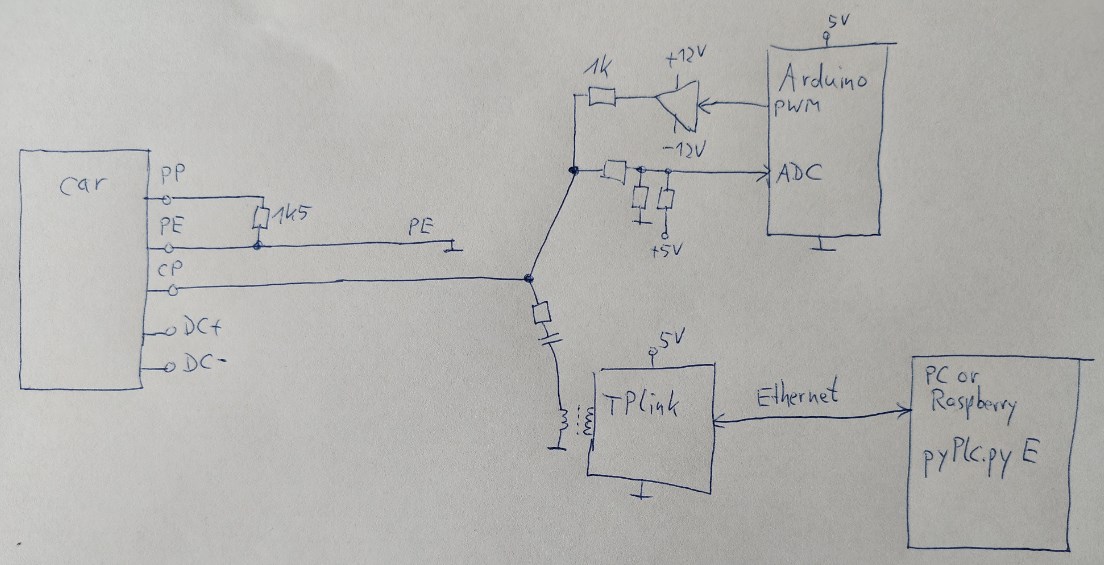

I'm finally working on getting my setup up and running. Have one RPi 4 (EVSE) and one RPi Zw2 (PEV) and loaded up the software following the instructions from @uhi22 github.
For now I am using the RPi4B to emulate both the sides to see if there are no issues with missing libs/packages etc.

But somehow I'm running into an issue when running the simulators - seems like it's complaining about a missing serial conn? and missing CAN interface (not sure why those are needed?) If anyone could help get past this.
If needed I can create a virtual CAN interface - but not sure why I would need it - CHAdeMO??

I did try this out (with unconnected can and UART interfaces to stop the program complaining) but didn’t get much further. Having entered at this stage rather than the beginning it was all rather confusing.

If it says that it expects CAN, then the ChaDeMo is enabled in the ini file. Just change this setting. And If you do not have serial devices, then remove the Dieter or Celeron devices from the ini.

Cant quite tell for the photos the arrangement of the capacitor and resistor for the CP line. Does the type of cap matter? Got my CCS socket so just about ready to do a little test without HV at first.
