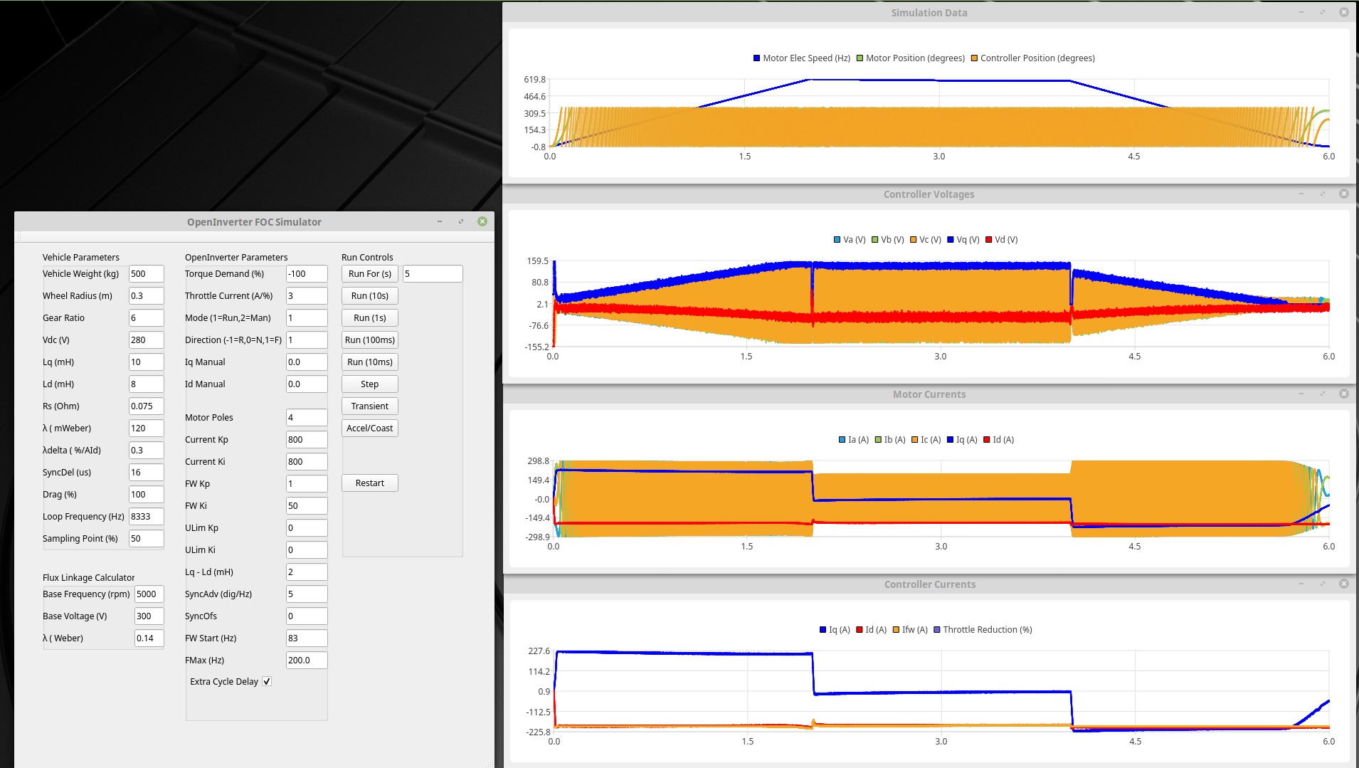

One final plot for completeness, a 100% run to around 3x base speed, a 2sec coast followed by 100% deceleration to zero:
So far it's looking promising. As long as the sync compensation value is kept sensible it seems to be more stable than the other builds tested on the simulator.
Edit - Just found what might be a slight bug in the OpenInverter code, not sure whether the vehicle control functions higher up the code (that the simulator doesn't call) will fix it but just in case they don't I'll mention it here. When coming to a stop under regen the Iq current drops to zero as soon as the vehicle is stationary due to the limits on the Iq PI controller, however, the -Id commanded by Mtpa continues for as long as the negative torque command continues (you can just see the effect at the right hand side of the above plot). As soon as the negative torque command is removed Id returns to zero.

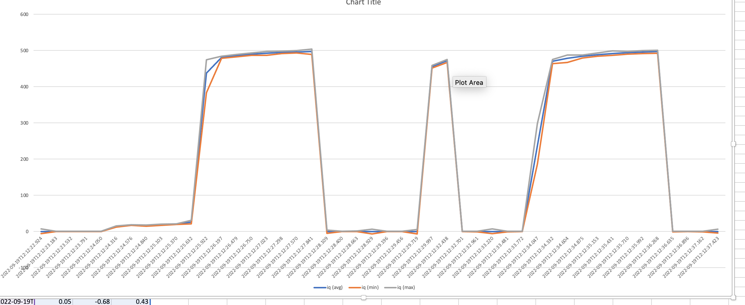

Posts: 1884
Has thanked: 91 times
Been thanked: 517 times

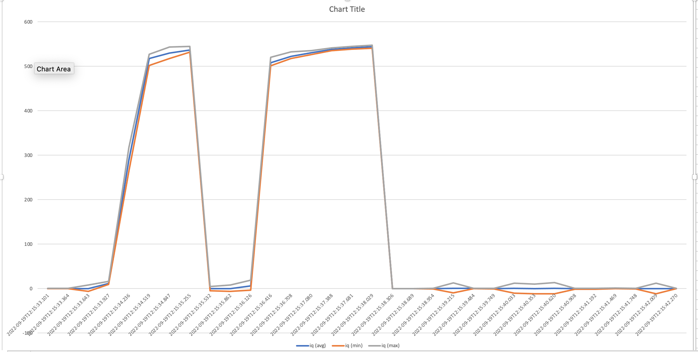

Some findings from my playing around, I need to have quite a low curp of 30, I can get up to 540a on stall but as soon as the car is allowed to move it cuts out. At the lower values the min and max are much closer together. Need to do further debugging on why with the handbrake off it cannot get this high. This is with ldminusld of 0 but having 0.6 seems to behave the same.
p-30-i-40.csv
(1.92 KiB) Downloaded 315 times
540a.csv
(1.34 KiB) Downloaded 322 times
Ev8
Posts: 835
Has thanked: 44 times
Been thanked: 173 times
Post by Ev8 »
Have you tried a p led tuning? For me it delivered the same or better drivability with less spikes, Im currently happy running kp=400 ki=350 I know mine is gen 2 but…. It could be with a low kp your control doesn’t have the authority to catch them
Posts: 1884
p led tuning? With p above 50 the difference between the min and max values gets larger. I'm guessing my motor will have relatively low inductance compared to larger motors such as the Outlander rear or Leaf etc. Maybe that's a factor.

Post by Pete9008 »
Bigpie wrote: Mon Sep 19, 2022 11:47 am Some findings from my playing around, I need to have quite a low curp of 30, I can get up to 540a on stall but as soon as the car is allowed to move it cuts out. At the lower values the min and max are much closer together. Need to do further debugging on why with the handbrake off it cannot get this high. This is with ldminusld of 0 but having 0.6 seems to behave the same.
p-30-i-40.csv540a.csv
You're right that smaller motors will need lower kp but that does seem very low. Would expect some difference between min and max, say 20-30% (just not the 80-90% you had before) so might be worth increasing the values a bit.
Good to see that the Prius inverter looks happy at those currents, is it warming up much?
I'm becoming a little suspicious about the resolver measurement. Any idea what the motor position was doing in those plots?
Edit - just had a look at the csv files, the currents there do match surprisingly well which is good. I think you can get away with higher kp, maybe twice what you have, maybe even a bit more.
Very interested in seeing what the motor angle is doing while the motor is locked stationary.
Edit2 - Just to explain my reasoning on the above comment - the only explanations that I can see as to why integral led tuning could be an advantage is either if it was masking a bug (and there was the windup bug, now fixed, which it might have helped mask) of if there is a underlying noise problem. The integral term has a bit of a averaging effect which might help control noise. If this is the case then proportional led tuning could make things worse. There is no sign of noise being a problem on the current traces above which is what makes me wonder about the motor angle. Noise on the angle would also be more obvious when moving than when the rotor is locked.
Edit3 - out of interest did you take any plots using your original ki/kp values?

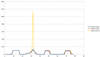

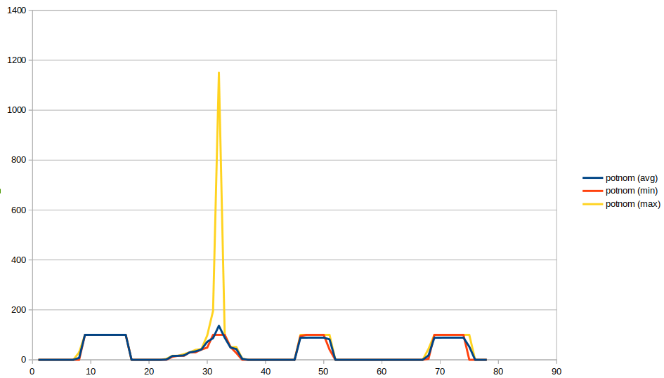

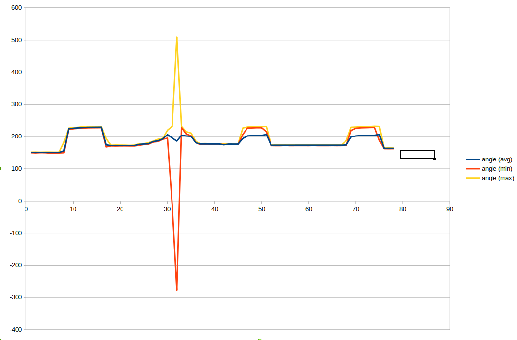

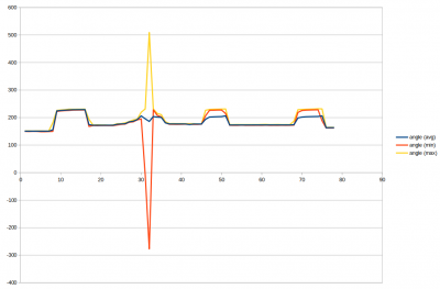

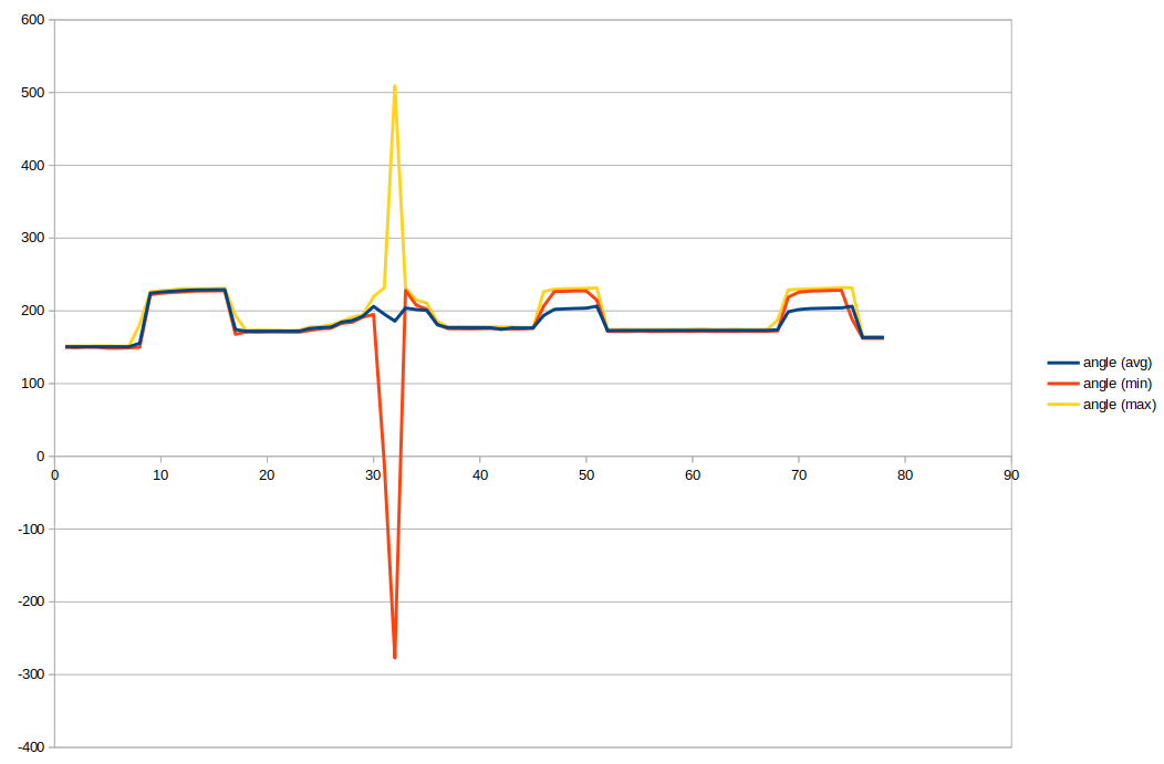

There is something not quite right there. On the stationary plots first the current:
Was that spike a trip?
On the angle:
Now if it was trip then maybe that's to be expected, if not it shouldn't be there!
Edit - Just had a look at potnom:
Surely that shouldn't be there?
BTW - all the above are for the stationary test.
Edit2 - Apart from the occasional noise spikes that seem to be appearing on multiple channels I can't see anything wrong here. Could they be a plotting artefact or are they real? If real it looks like they are either caused by or causing the trips?

Ev8 wrote: Mon Sep 19, 2022 2:47 pm Have done some quick runs this afternoon, turns out with mtpa off I can use field weakening, but performance is pretty lacking (this is with synof centered) but everything behaves. With mtpa on I can’t go more than fwki=1 without getting unwanted throttle when f/w comes in. Regardless of where syncof is at. And also regardless of my mtpa settings I’ve tried between 0.5-3mH 90-150
Interesting! Need to think about the interaction of Mtpa and FW a bit more, not too sure what's going on there. Surprised that syncofs doesn't affect this, could it need a power off for the new value to take? - need to check the code to see.
Edit - does FW behave correctly without Mtpa? No unwanted regen/acceleration and stable (poor performance without Mtpa is to be expected)?
Ev8 wrote: Mon Sep 19, 2022 2:47 pm Unfortunately it looks like In the chase for power it’s possible to gain positive torque by advancing syncof (at the cost of regen torque, a way of advancing syncof with throttle, (within confines) would work better than being linked to frequency.
Not keen on adjusting syncofs to look for power (it can be used this way but will also have side effects), it really should be set to the middle of the deadband. What sync compensation (syncadv) value are you running (it's effect does scale with frequency in the build you have)?
