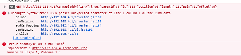

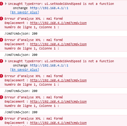

With platormio i did an upload but then i couldn't connect to the wifi anymore.
I updated the firmware via the arduino ui, then with platformio i did a uploadfs.

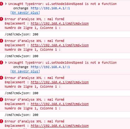

here is what i get when i change the node ID or the can speed. with arduino ui (1.8.19) i can't use the esp8266 upload data as it says it's incompatible with esp32.
I was able to compile/upload the arduino sketch when i selected nano32 as target.
EDIT : got the ESP32 sketch data uploader and used it, but still the same error when chaning the can speed or node id.
EDIT2 : It now works, I hooked up my candapter and it now worked. I guess it needed the candapter to do the ack of the messages.
as i don't have anything else connected on the bus yet.

Re: ESP32 Based Web Interface & Data Logger
seems more like it used a cached ui.js

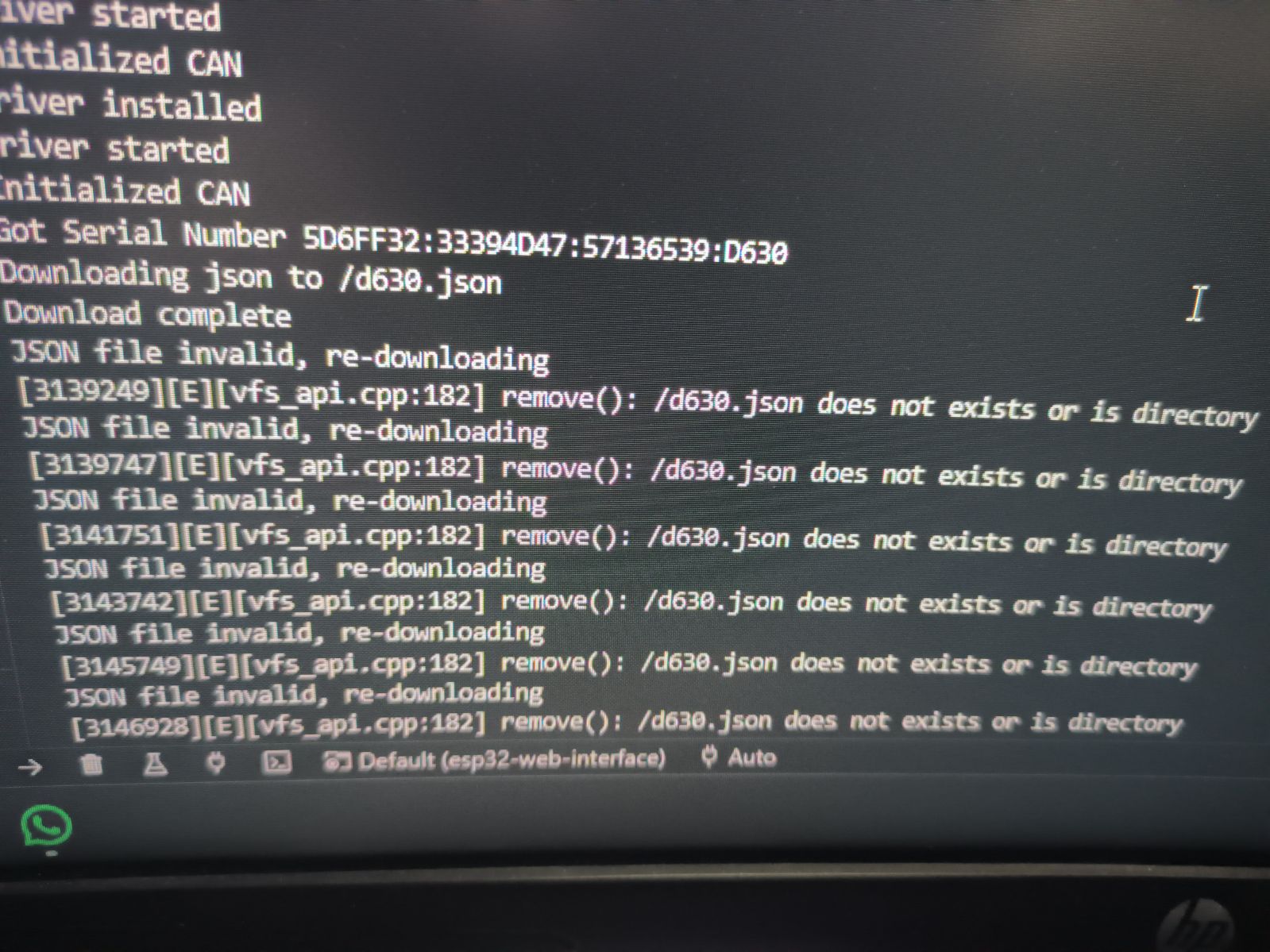

During a recent debug session we found that the invalid json check triggered after 5 minutes. This is odd as it should just load the same json as before but instead it detects an error and deletes the json file. Apparently the re-download doesn't work until you restart or change the node id to something else and back.
I think it is worthwhile commenting it out https://github.com/jsphuebner/esp32-web ... n.cpp#L340

I've just commented out like this
if (result != DeserializationError::Ok) {
// SPIFFS.remove(jsonFileName); //if json file is invalid, remove it and trigger re-download
// updstate == REQUEST_JSON;
// retries = 50;
// DBG_OUTPUT_PORT.println("JSON file invalid, re-downloading");
return false;
Seems to no longer have the issue, I've not noticed any strange behaviour so far.

Just got a new thing while remaking my can man
i haven't done the comments to remove the json issue, could this be linked ?
Edit : I've commented the lines, reuploaded the code to the ESP the wired way, but still no luck. same behaviour, i can't add can messages to the can map. I'm very lost on the workings of this, any help ?

If you look closely you can see the problem: The line that updates the "updstate" should be "updstate = REQUEST_JSON" rather than doing an == comparison and then discarding the result.Bigpie wrote: ↑Fri Jun 28, 2024 9:23 am I've just commented out like this
// retries = 50;
return false;
I turned on -Wall to try and fix the Arduino IDE build which was breaking for me and it highlighted this amongst a bundle of other less serious problems. I'm putting together a PR.

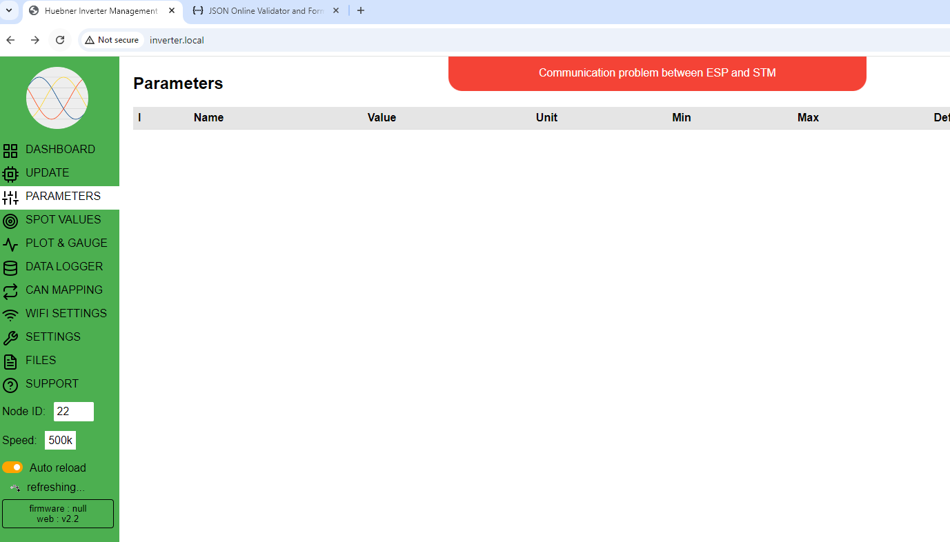

Not sure where to ask this, maybe here makes sense. I've flashed my esp32 per the instructions on the github but the web interface seems a bit flaky. 'settings' and 'wifi settings' are both blank when I click them (except one time it showed up after waiting 5 minutes or so). Is that normal or does it indicate something went wrong? The same interface on my Wemos D1 seems pretty fast and smooth by comparison. Should I try re-uploading the SPIFFS?
Also, trying to enter a node/speed doesn't seem to work and I can't get parameters or spot values from my Foccci (though it's freshly flashed, I cant be certain it's working right either, but I am thinking since the web UI is acting strange I should start there).

This sounds like an instable ESP32. My first point to check would be to have a strong 5V power supply for it. Had bad experiences using crappy USB cables. The ESP needs some current for wifi, and tends to crash if the power drops.
Ah, interesting. I'm using a 12v benchtop power supply though, so I don't think it would be that.
Does this all seem correct? Wondering if maybe one of 'events' or 'arduino' should be on core 0? These are all what came up by default. (Edit: actually from another forum it looks like that would be a bad idea, apparently it runs the wifi stuff on core 0.)

Is it possible to view the ESPs serial? It should give hints how far it comes and what is the reason for crashing.
Well I had the monitor running but didn't get anything out of it after the initial bootup. I even tried a full wipe of the ESP and re-flashed it via the arduino IDE (and the web interface CAN-Backend fork which I just downloaded as a zip and extracted to my workspace). Basically I've discovered it will load all the pages except Settings and Wifi Settings on the first try. And if i refresh the page then click settings, it's about 50-50 whether it will load or give me a blank screen. And of course no parameters or spot values are coming through from Foccci when I enter node 22/500k.
Not sure if this tells us anything useful or not.
I'm using an older version (not really sure, something from December 2023 I assume), but can confirm, that the error with the missing subscription.js is also present here. If I try to open http://inverter.local/subscription.js I get a HTTP 404 (file not found). So this seems to be "normal".
When just opening the main page, I get some errors, but they seem not to block the functionality: No idea what could be the issue on your side. Maybe try an other version, and different browsers. I'm using Chrome and Edge, no problems here with the "December 2023?" version.

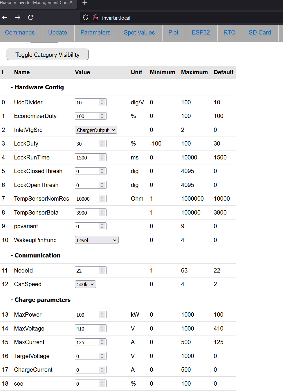

subscription.js only exists if you subscribed to a parameter set which I think hardly anyone does. So it's "normal" that it doesn't exist.

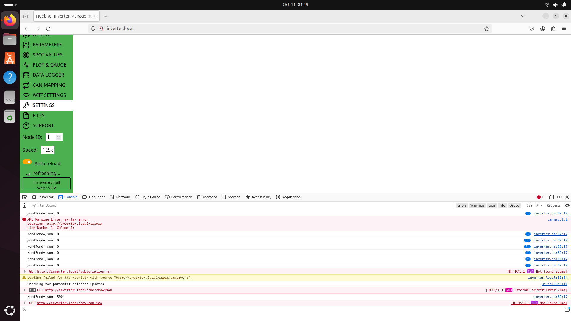

Progress!(?)
Went back the latest everything. Not able to get settings or wifi settings to show anything even when I reload now, but I did enter the node id, left it alone for a bit and I still have nothing in parameters or spot values, but it DOES have a json that appears valid when checked online. I hope that's a good thing?
So far same behavior in chrome, firefox and edge
"UdcDivider": {"unit":"dig/V","id":1,"value":10.00,"isparam":true,"minimum":0.00,"maximum":100.00,"default":10.00,"category":"Hardware Config","i":0},
"EconomizerDuty": {"unit":"%","id":7,"value":100.00,"isparam":true,"minimum":0.00,"maximum":100.00,"default":100.00,"category":"Hardware Config","i":1},
"InletVtgSrc": {"unit":"0=ChargerOutput, 1=AnalogInput, 2=CAN","id":8,"value":0.00,"isparam":true,"minimum":0.00,"maximum":2.00,"default":0.00,"category":"Hardware Config","i":2},
