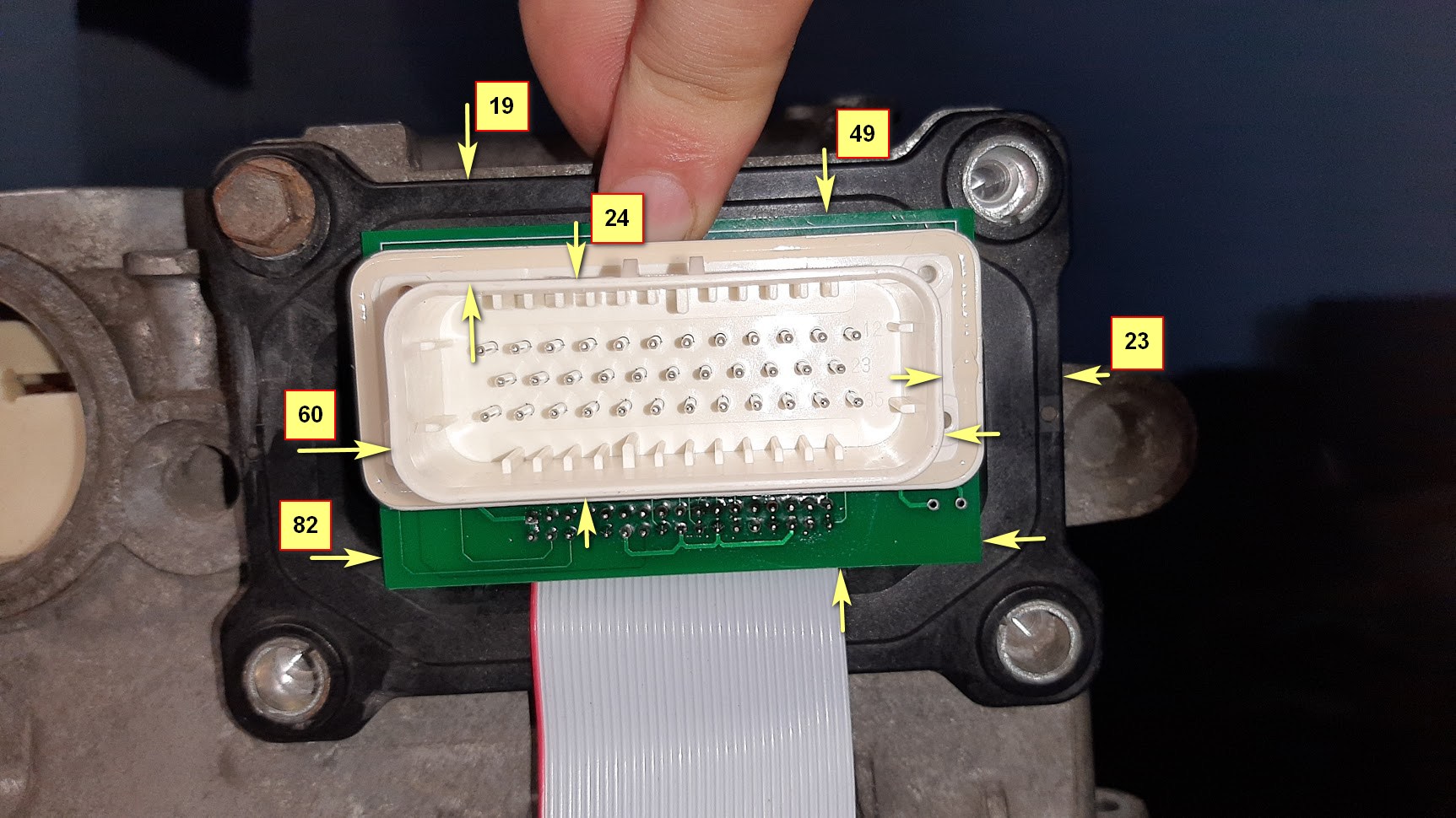

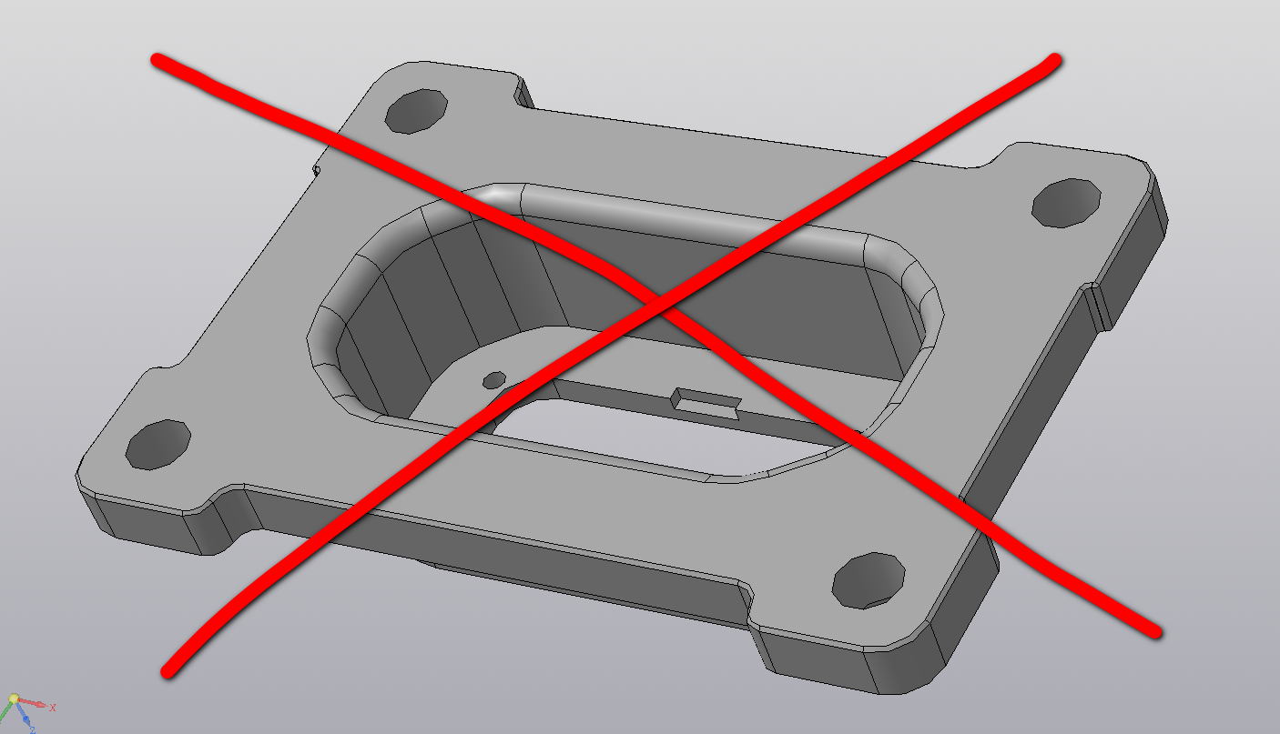

Got free time to figure out 35 pin plug wiring, and came to conclusion that this plate design is "no-go":
There is simply no room for IDC headers. So for 3D printing good design is outward facing plate, or flat plate if material is sturdy enough or it is milled from some hard plastic insteard of 3D printed.
Here is DXF drawing for flat plate for CNC milling. Keep in mind that recommended maximum plate thickness is no more than 4mm in area where 35way header is located(for correct installing).

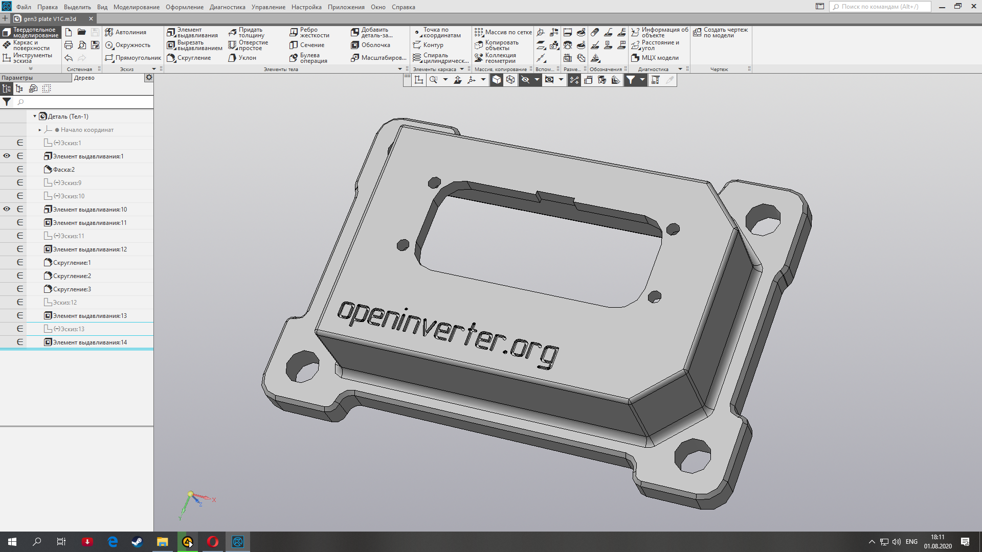

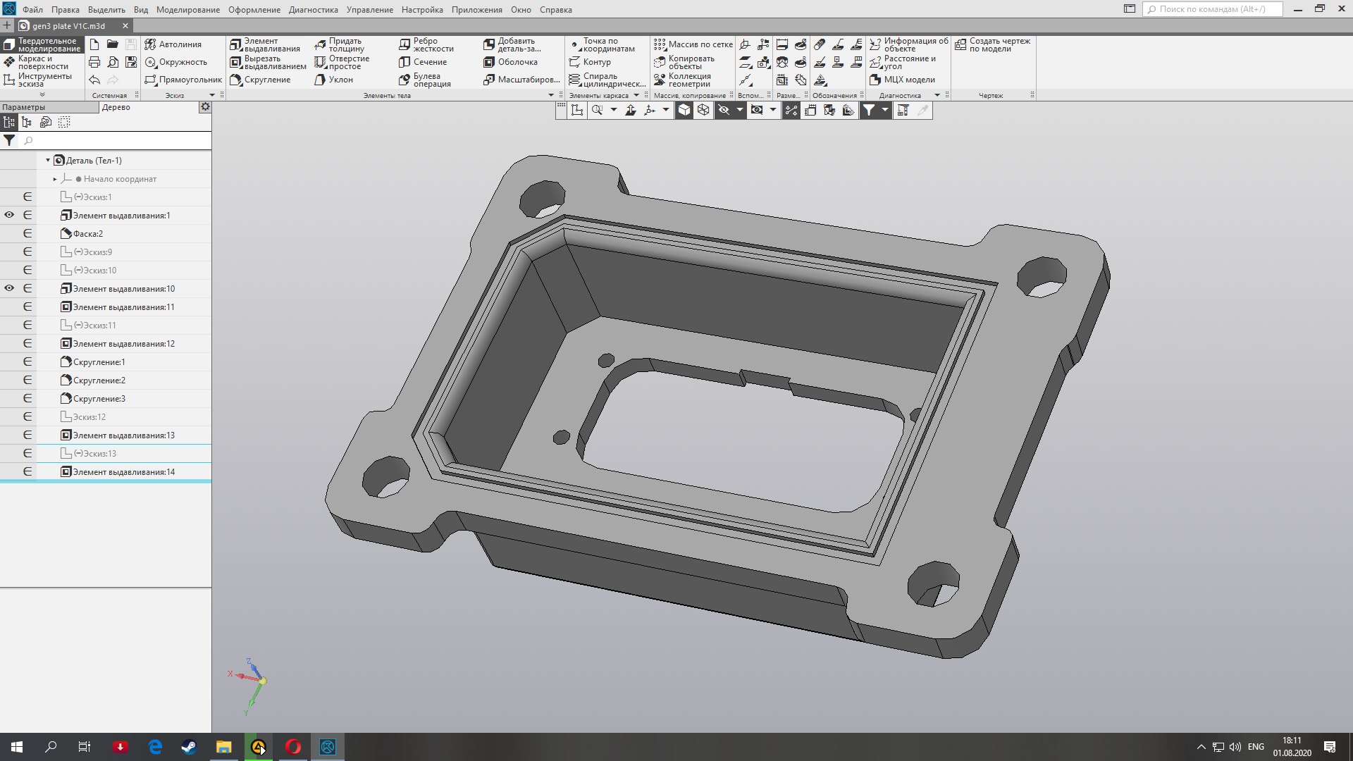

OK, I've got a little package from RS components(they send to Belarus :D ) Few connectors and AMPSEAL 35 way socket.

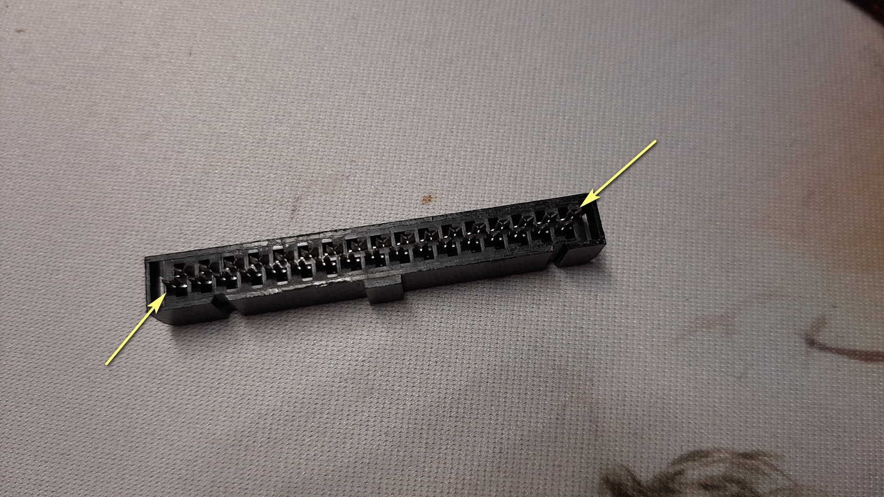

I've soldered it to V1C adapter plate. One thing I didn't get is "notch position". It makes no sense. IDC plug always have first contact at a bottom no matter how you flip it. So all you need is to connect that ribbon cable to IDC plug so it remain straight, not twisted. And IDC connector being at the bottom and AMPSEAL 35 way connector at the top :?:

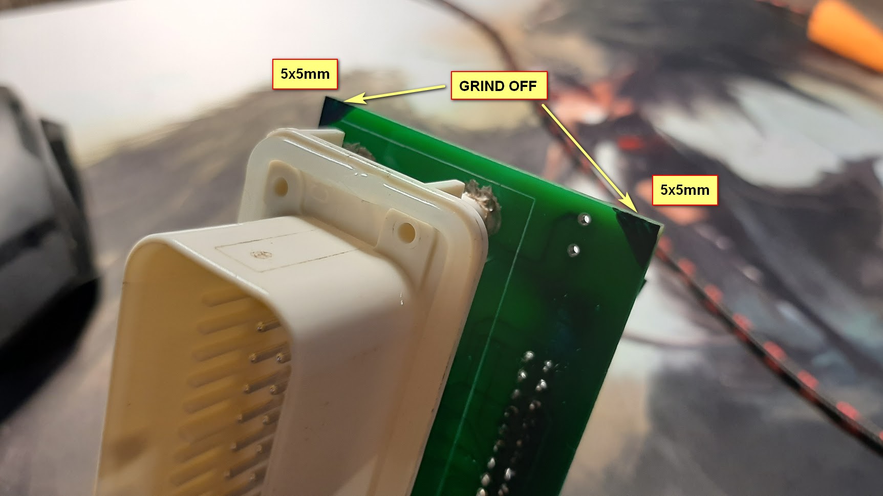

Anyway, there is no room for adapter plate with connectors attached inside the inverter. So anyone who willing to use AMPSEAL connector and install it correctly(so inverter case remain sealed) will need to use adapter plate housing, with outward offset. Because flush housing is "no-go" as well.
Also IDC header on the control board is placed with little offset to the right if you watch at it from outside.
To prevent damage of ribbon cable, I've added this right offset to a new housing design.
The only thing you need to do is to grind off two angles 5x5mm on the right side of the adapter plate
This is needed to be able to place some silicone gasket to maintain sealing.
As before, design must be checked, but I've got no 3D printer. :|
STL model attached in ZIP file:
gen3 plate V1С.zip
(128.67 KiB) Downloaded 381 times

This looks really nice but I'm confused! The one I knocked up with a second plate behind it fits perfectly? And you don't need to cut the adaptor plate. You could add some ridges/valleys to that for extra sealing but other than that I don't see the advantage of this design?
konstantin8818
Posts: 290
Location: Minsk, Belarus
Been thanked: 10 times
Post by konstantin8818 »
bobby_come_lately wrote: Sun Aug 02, 2020 9:20 am This looks really nice but I'm confused! The one I knocked up with a second plate behind it fits perfectly? And you don't need to cut the adaptor plate. You could add some ridges/valleys to that for extra sealing but other than that I don't see the advantage of this design?
I've tried to fit it in the middle and ribbon cable was bending sideways, maybe it is because it is too short, if you make it longer and set so it form a loop, it won't bend. As I've said earlier I have got no 3d printer to be 100% sure about this designs.
Gotcha - my ribbon cable is perhaps too long but does loop nicely so doesn't foul the inside.
