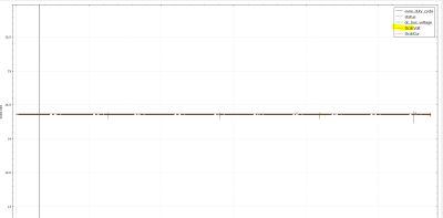

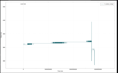

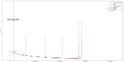

Today I started a charge and a CAN Dump with SavvyCan, around 20 minutes later I climbed into the car and tried something which caused the car to cut out a couple of days ago while driving. I turned on the headlights.
Immediately I heard what sounded like the clunk of a contactor and the charge stopped, the coolant pump briefly changed tone but then went back to normal, I didn't see the change in low voltage but if a contactor was turned off briefly then this makes sense .
I tried turning the headlights off and on again to see what would happen but nothing so this is intermittent.
I have attached the CAN Dump anyway but I think I'm looking for a stray voltage, a poor ground or a bad connection.

Contactors are opening
You can see the voltage suddenly jumps to the max, the charger errors out.

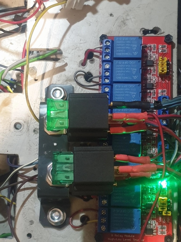

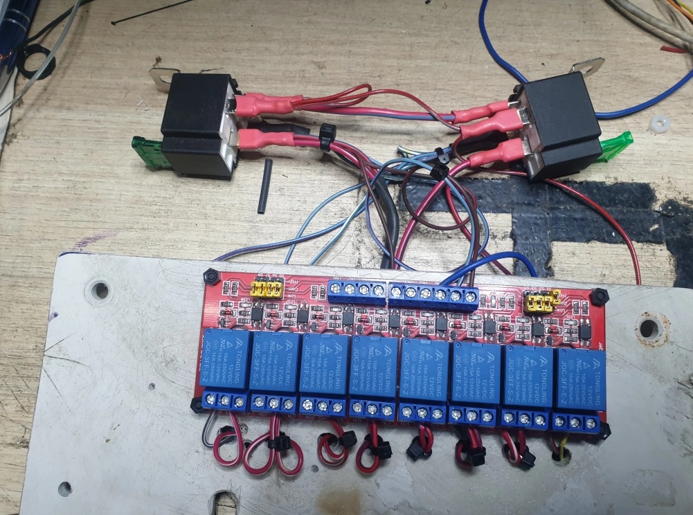

First i would advise you to make a latching relay circuit. The fact you are using timed relay to power your contactor can be tricky.
I allways want to have ability to latch contactor so that no mattery what VCU does HV wont be an issue.
You can do this by using two automotive SP relays (or single multipole) and wire them to receive power from ignition side with trigger pulse from timed relay. That way you will have control to unlatch the pair simply by removing ignition. This would be a stop gap measure to use the car interim until fuse block come...
This is how they look:

I'm very happy to report back that the charging issue has not reoccurred since rewiring 12V supply to the Positive contactor.
I have also connected it through a latching relay as suggested by Arber333.
And the car has not cut out while driving either so I guess the two issues were caused by the same fault.
The latching relay is being triggered by the timer module but is held closed by 12V directly from the ignition switch so even if the timer module glitches it will not cause the positive contactor to drop out.
