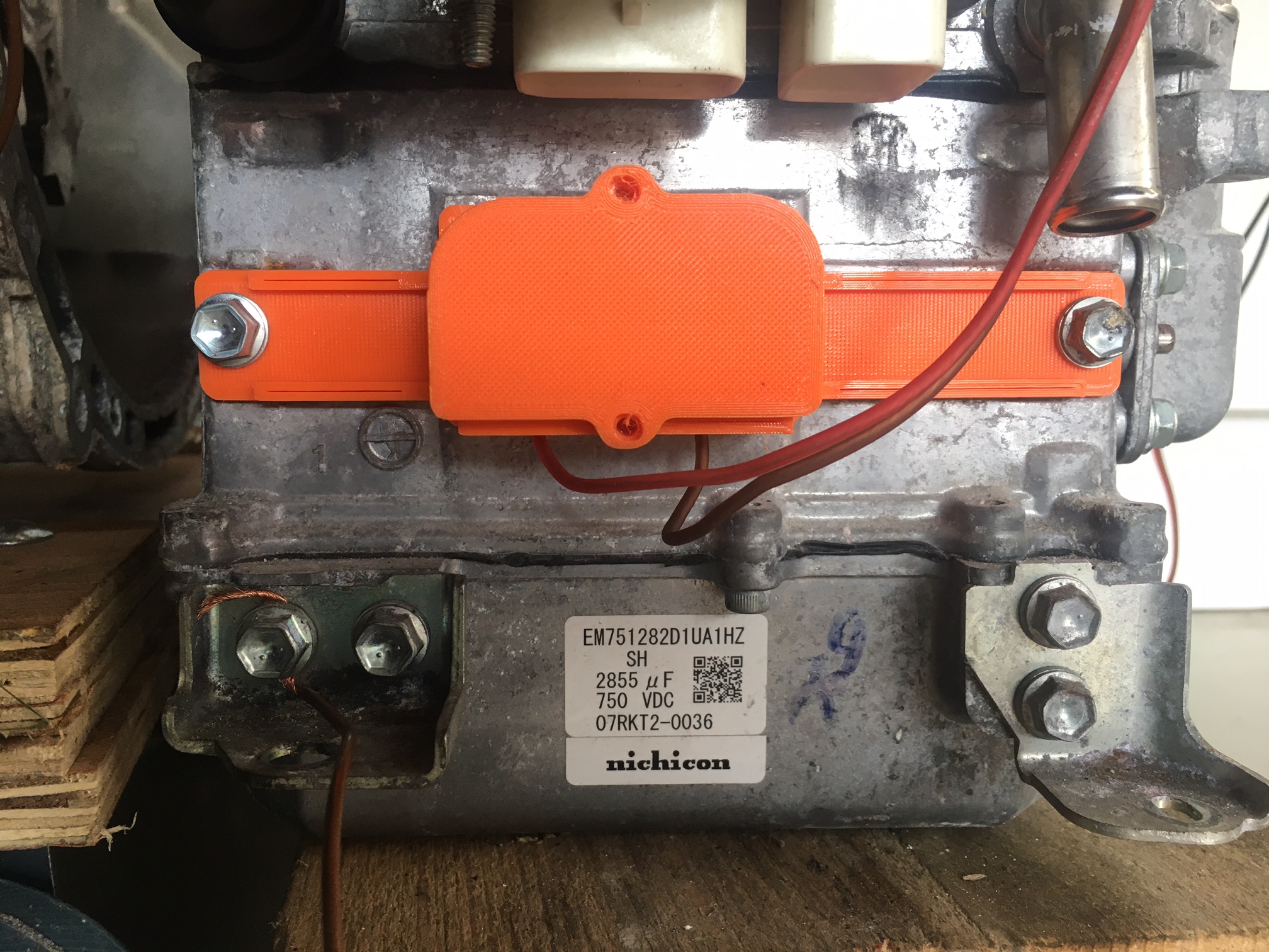

I think this has been done before. For my 24volt test rig, I needed a cover for the GS450 inverters high voltage connectors, so I printed this in orange PETG.
If you would like to do the same, the gcode files are attached.(you'll need to rename them from.txt to .gcode)
Now the disclaimer - you use the files and cover at your own risk.

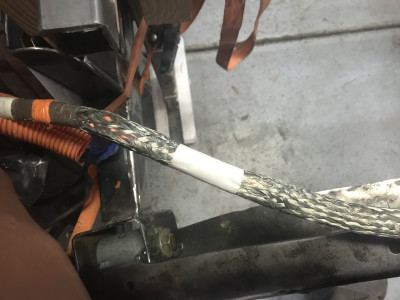

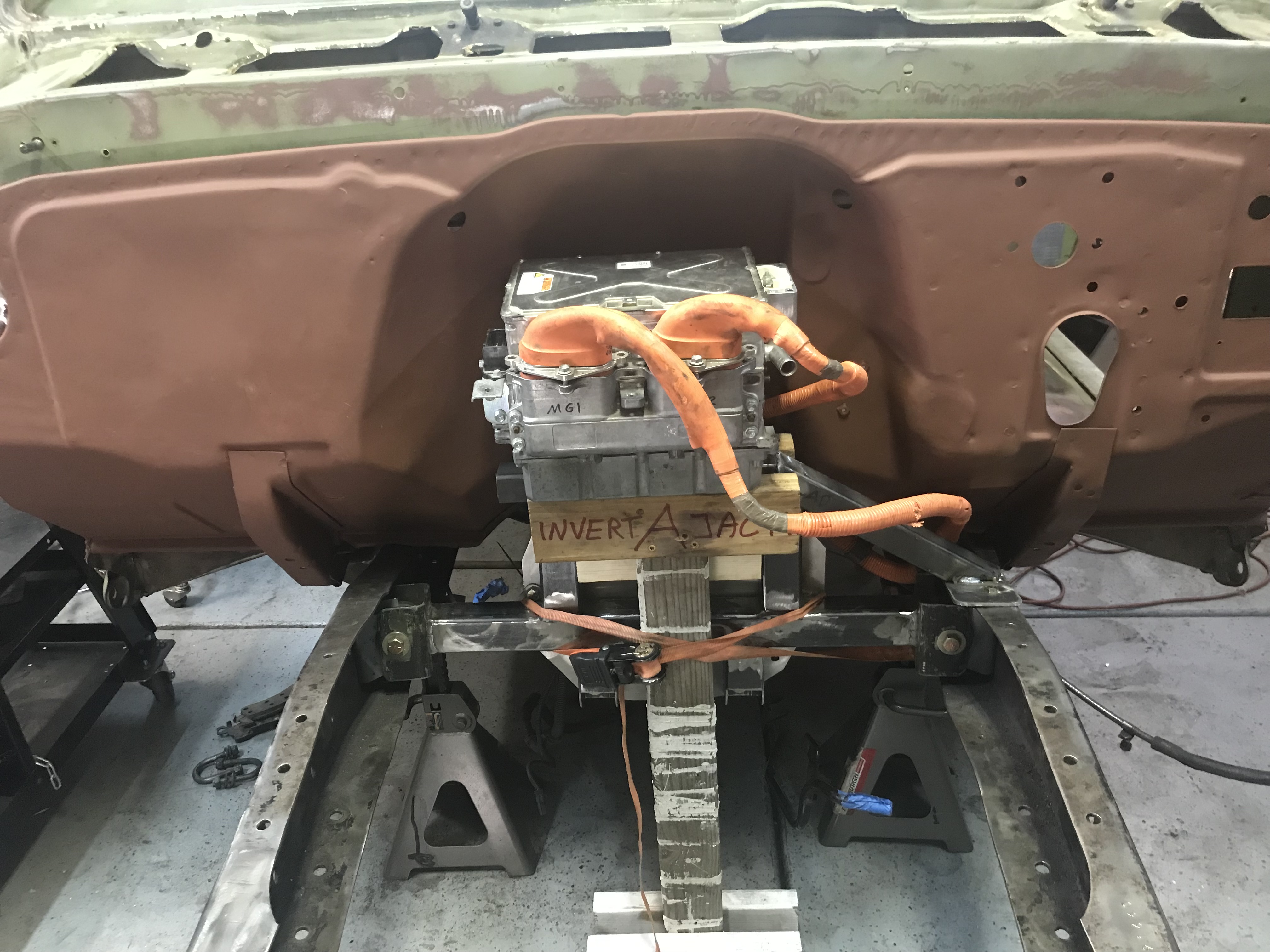

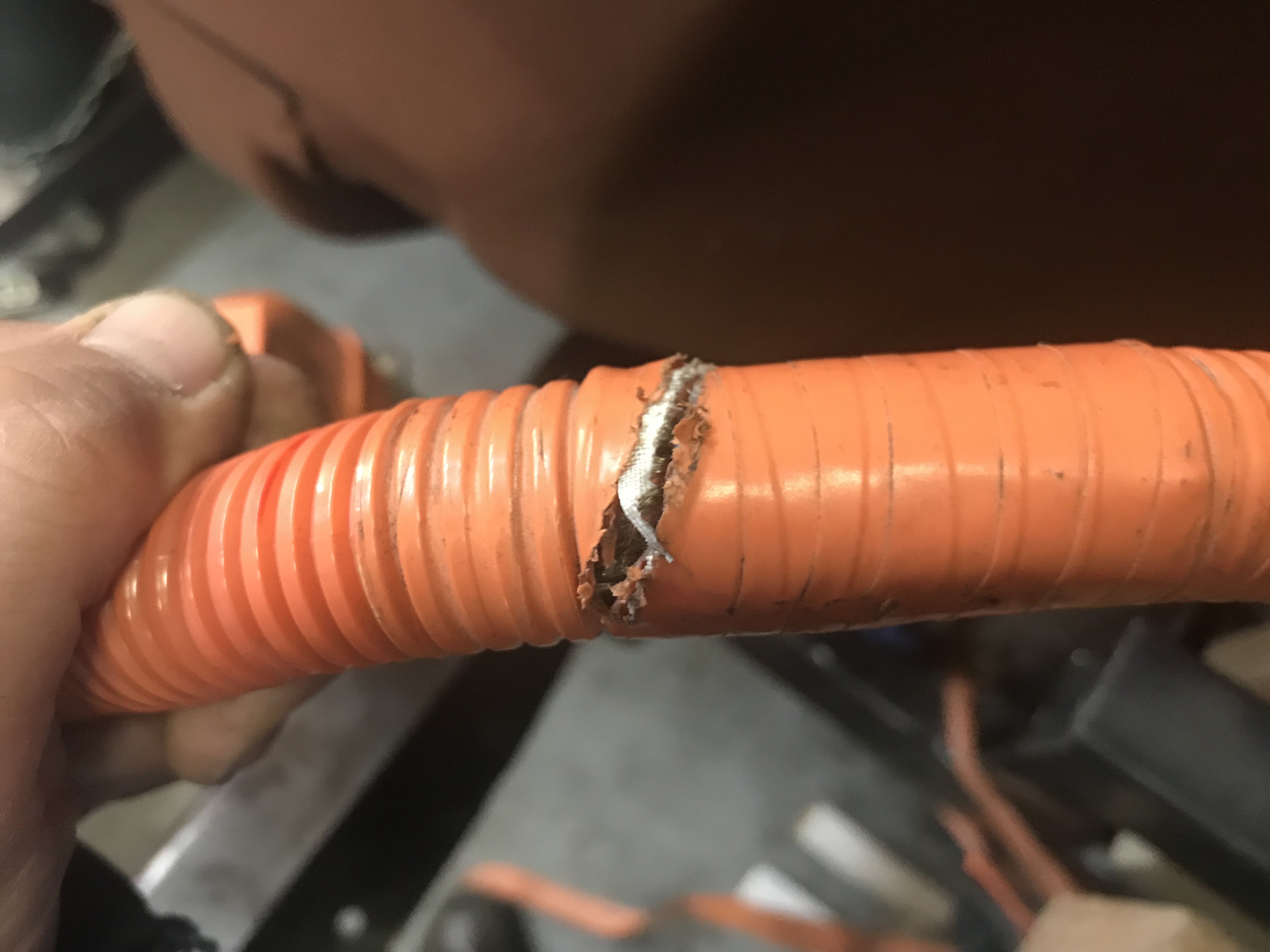

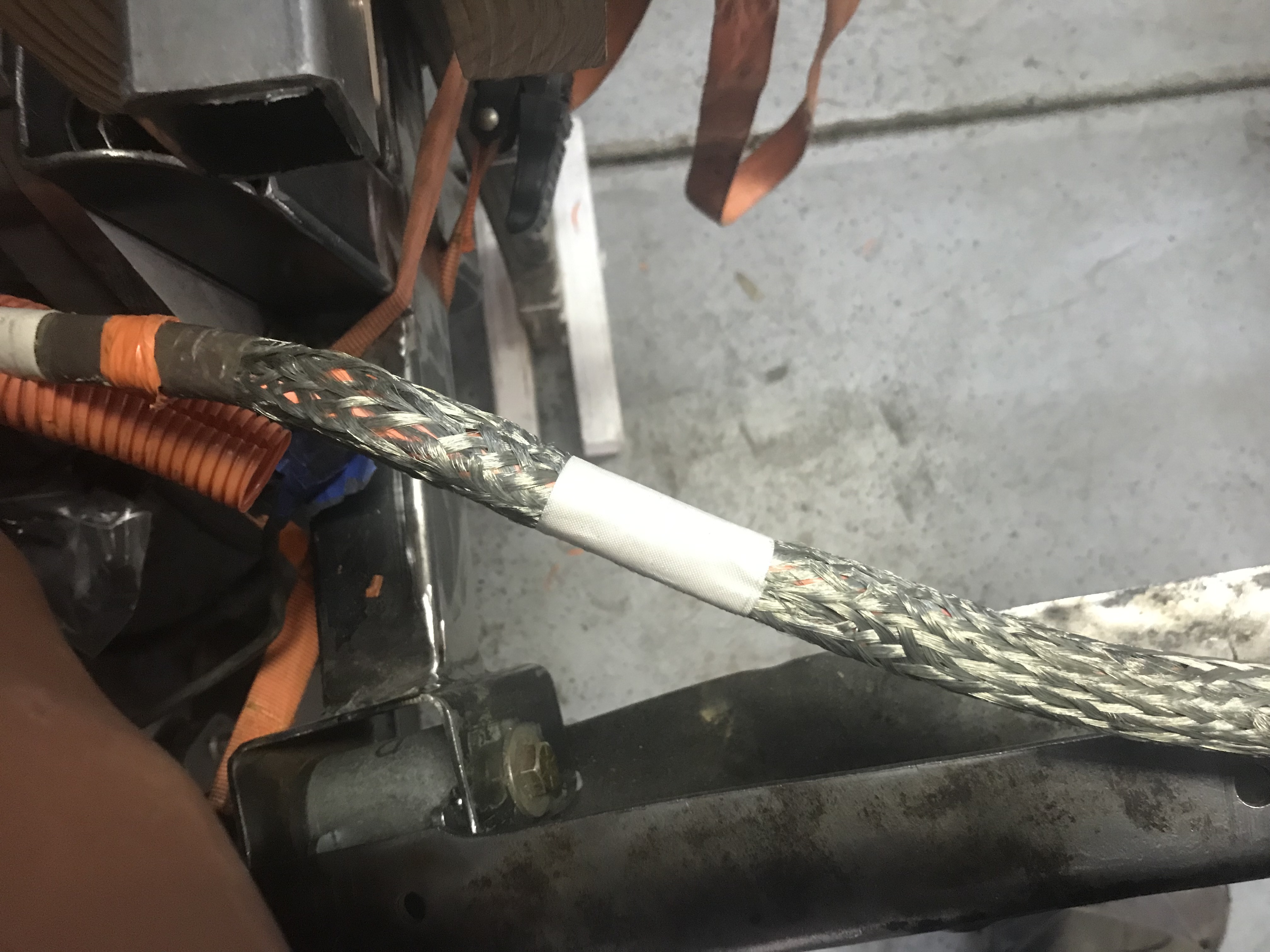

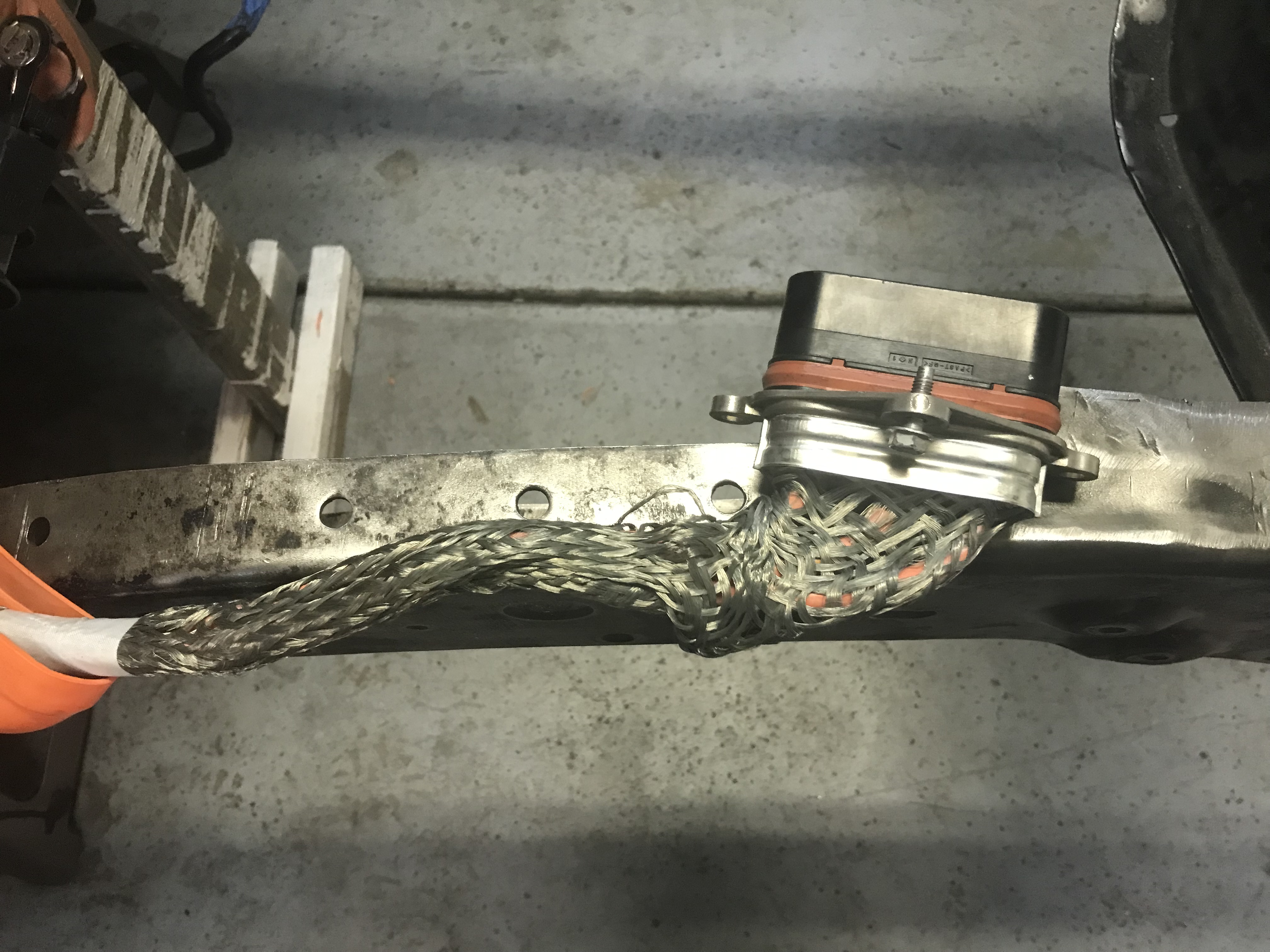

Re: GS450H Discussion
my GS450h transmission / inverter combo came with one of the high voltage orange cables with a nick in it, so I thought it would be a good time as any to unwrap it and see it's internal construction, thought I would share, I also hope to reroute one of them to go to the left from the inverter instead of both heading to the right
there were also two white zip ties inside the metal webbing helping it keep it's 90° shape
that's as far as I got with the transmission mocked up in the truck, I will unwrap more later
