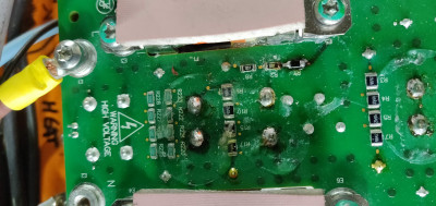

I'm having an issue with a Gen3 charger - there is a row of 3x 1206 10R resistors in series next to the Live fuse on each module. On each of my modules, one of these resistors was blown off the board on each module, it was R1 on one, and R6 on the other.
I have replaced these resistors, however as soon as I connect AC, they blow again. The modules so have communication over CAN, they are reporting accurate AC voltage (CAN ID 0x207, byte 1), but the AC present bits (CAN ID 0x207, byte 2, 00001100) are 0 when AC is connected, I think it may be linked to those resistors?
I have requested 80V from the charger, and have connected a 100R, 500W resistor across the output to simulate a load. However, the charger does not produce an output voltage. I'm not sure if this is related to my resistors, or if I've just set the voltage too low.
A voltmeter across the blown resistor shows 230v.
Any idea what's causing this?

Posted: Mon Apr 27, 2020 7:29 pm
by xp677
Sure, to answer the questions:
This is a 48A NA Gen3 charger.
There were no signs of flooding, fire damage, etc on this charger. The charger was still sealed with it's warranty tag.
The charger contains two modules (and an empty bay). The original wiring had both modules in parallel - single phase.
I have modified it by connecting a controller to the 12v, 3v3, 5v, GND, CANH and CANL connections. The modules work as expected, when powered up, I can send and receive valid CAN data.
The current wiring setup is a 13A UK plug, with L and N connected to the L and N terminals of Module 1 (see photo). The Earth is bolted to an otherwise unused thread on the charger chassis.
The resistors were already burnt out when I received the charger. Since different resistors had burnt out on each module, it was possible to cross reference these to find the value (10 ohms, noted "100" label, and verified with a multimeter).
After replacing the resistors, I connected power to Module 1. There was no load connected at the time. The modules were unpowered (no 12v, 3v3 or 5v power). The recently-replaced resistor (R8) on Module 1 immediately blew.
After powering up the module, it detected 230(ish) V AC through CAN, however the "AC present" flag (as mentioned above) is still negative. My initial impression is that the resistors in question are part of this detection.
See below, Module 1, as it sits now, with my replaced R8 resistor blown,
Module 1
Module 1
Module 2 has not been connected to AC power yet. See here, It's previously blown resistor (R1) has been replaced, I have little doubt that it will blow as soon as I connect power to the module.
Module 2
Module 2
These are the resistors which I used as a replacement: https://uk.rs-online.com/web/p/surface- ... s/8071117/
There is 240V measured across the terminals of the late R8 on Module 1.
Hopefully this helps?
Posted: Mon Apr 27, 2020 7:47 pm
by Kevin Sharpe
xp677 wrote: Mon Apr 27, 2020 7:29 pm The resistors were already burnt out when I received the charger. Since different resistors had burnt out on each module, it was possible to cross reference these to find the value (10 ohms, noted "100" label, and verified with a multimeter).
Any chance you can return the charger for a refund? If not then it sounds like you need to reverse engineer the charger power board to understand what's going on.
