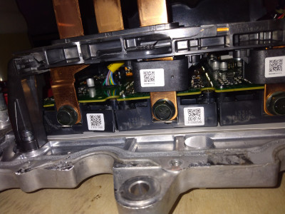

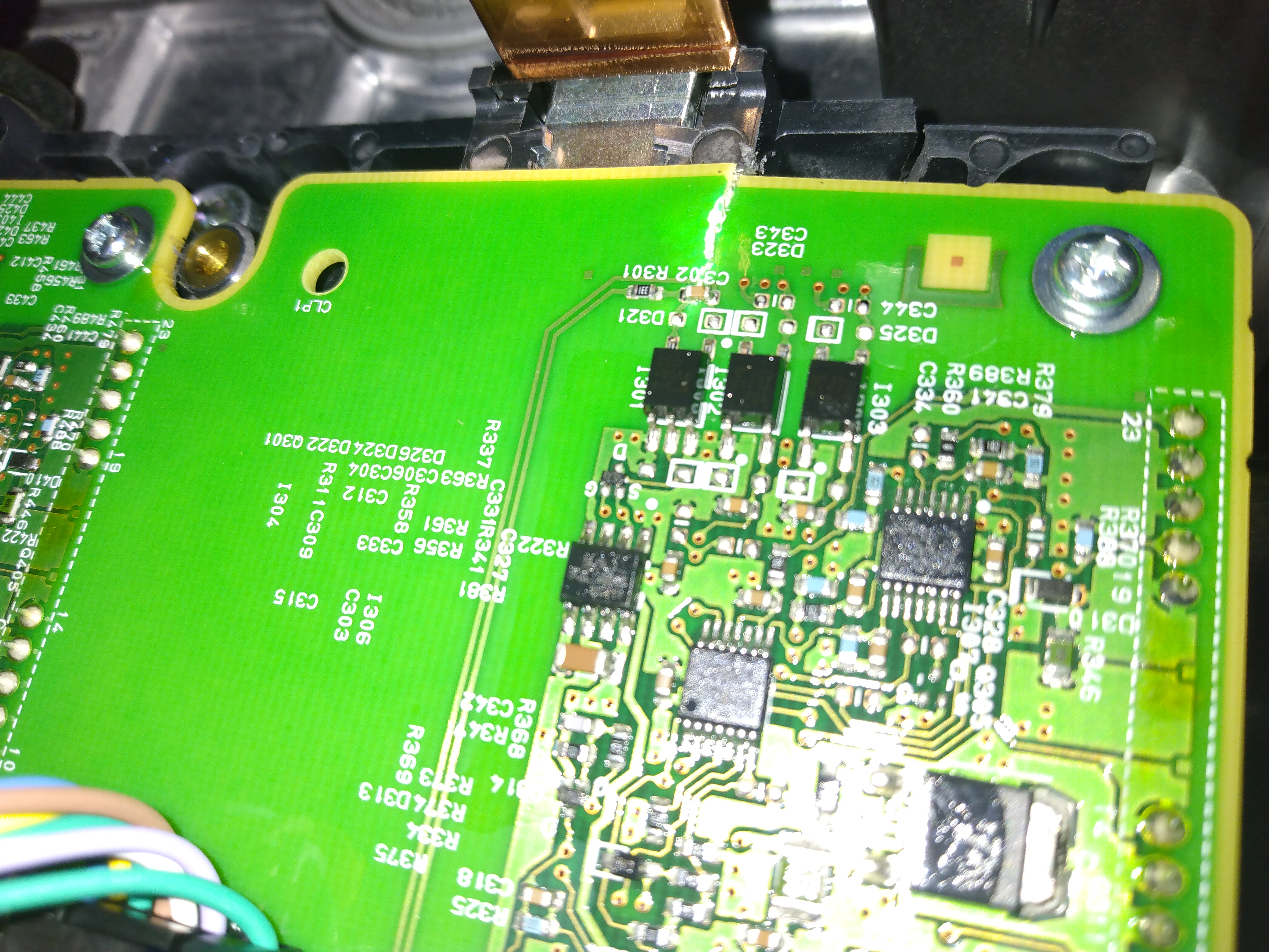

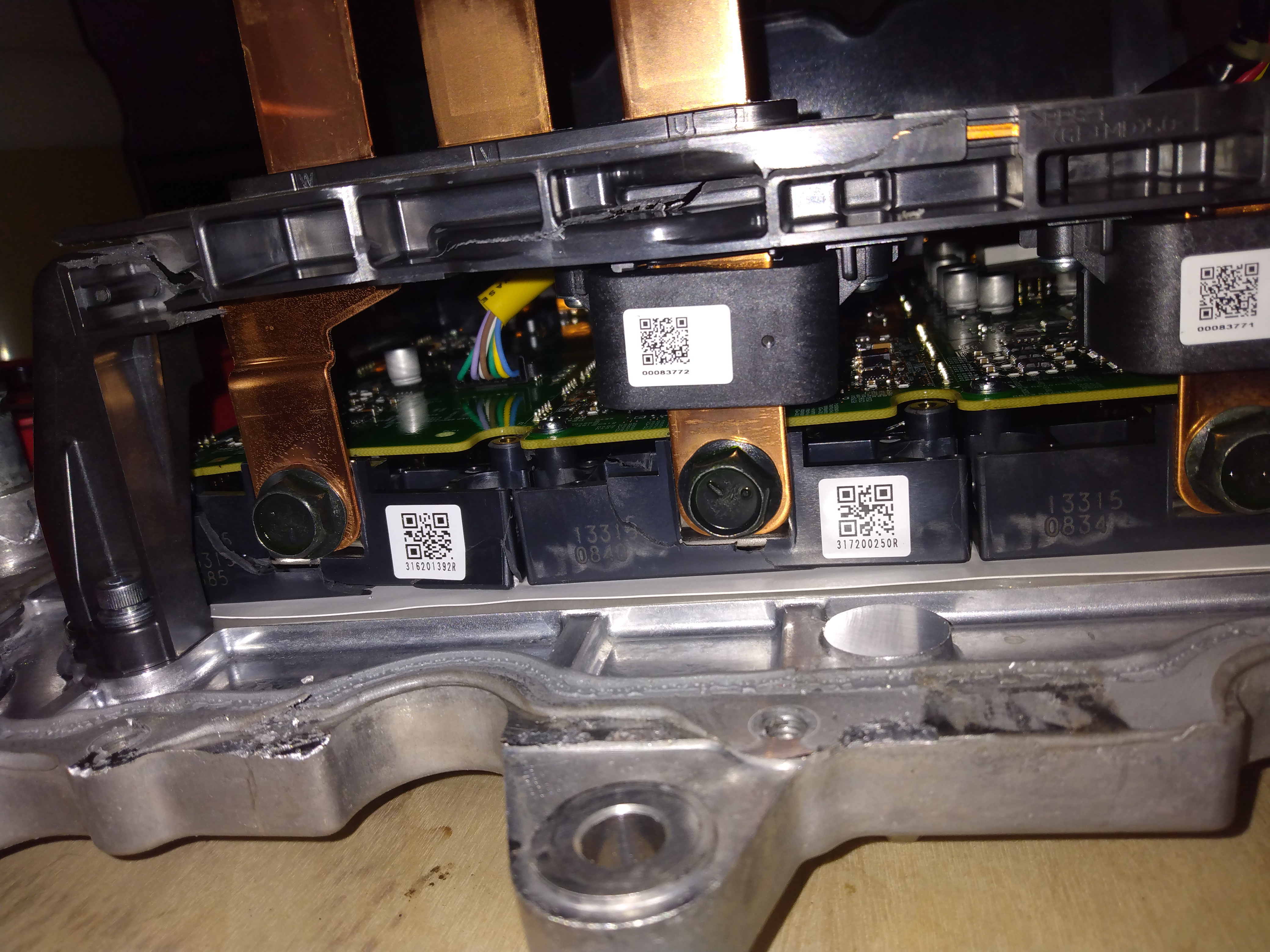

Inspected my inverter and found that to be damaged so going to look for a new leaf inverter to pair with this or maybe another option like a volt inverter and see if I can get the zombieverter to work with it.
Can the zombieverter program the offset if I get another stock leaf inverter?

No it can't, there is other software that can do that though.
If you buy the exact same inverter you could also just swap the memory component. It's either an EEPROM or the complete MCU.
