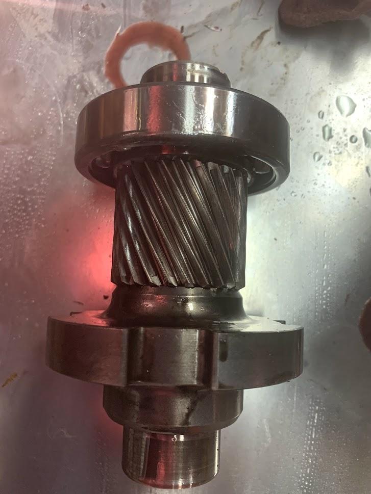

Just to document what I did (in case anyone has the same question): There is an excess of grease in the female spline of the primary gear that fits on the end of the rotor shaft that gets pooled up on the surfaces where it’s not used. I just rolled the shaft around these surfaces and used that. The volume of grease there was much greater than what was sitting on the rotor splines so I don’t think it’s a huge issue to have that little bit less.

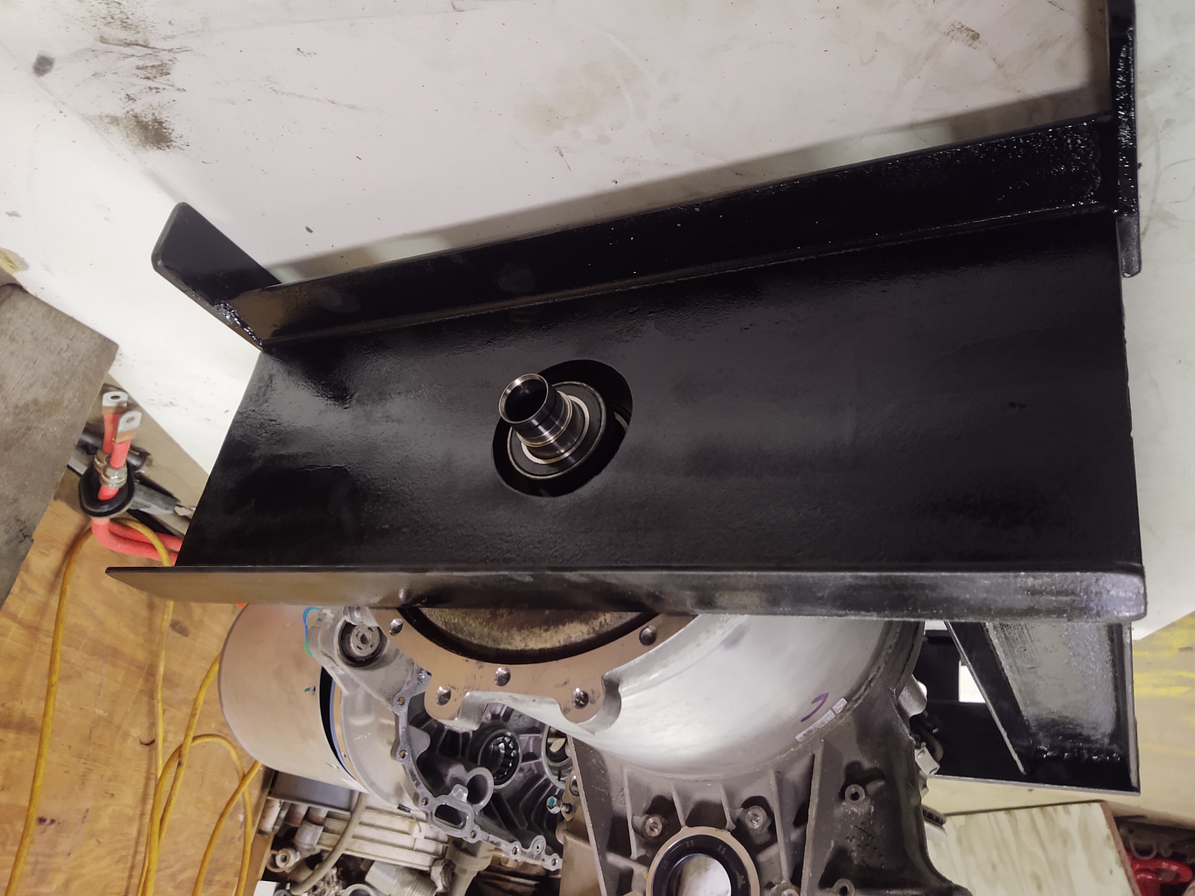

Rotor half is assembled! Now moving on to cleaning up the inverter mating surfaces and getting the wiring passage ready to do the final merge. Wish me luck!

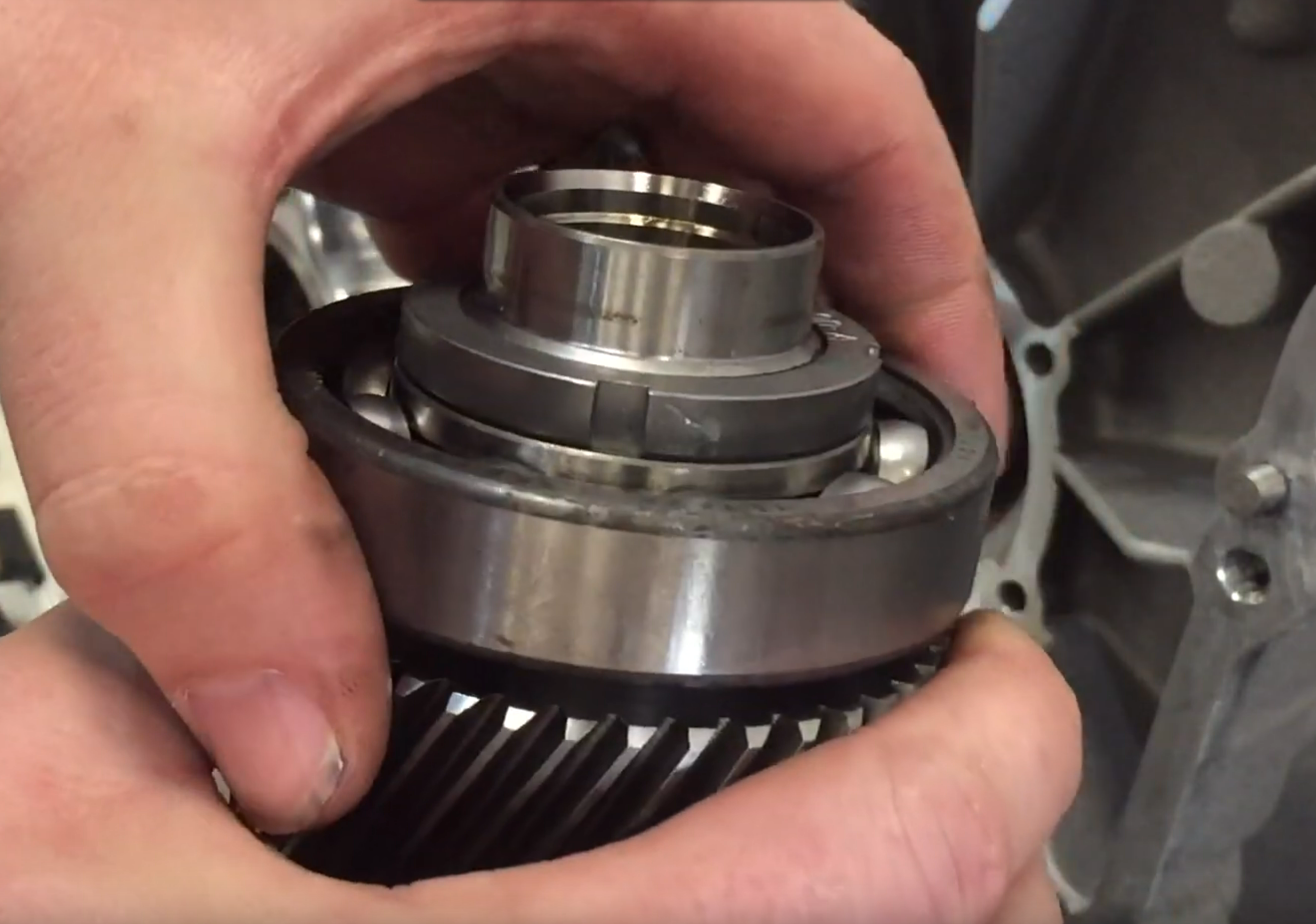

Thanks for the thermal expansion index of case/bore and bearing. In my experience on this LDU, here is what I encountered on the 3 counter bore bearings
- Primary shaft's 6207 bearing dropped into the retaining compound coated bore slowly seated with gravity alone. All surfaces clean (wiped off frozen bearing surface ice coating from condensation) other than retaining compound on the bore where it mates to the bearing's outer face.

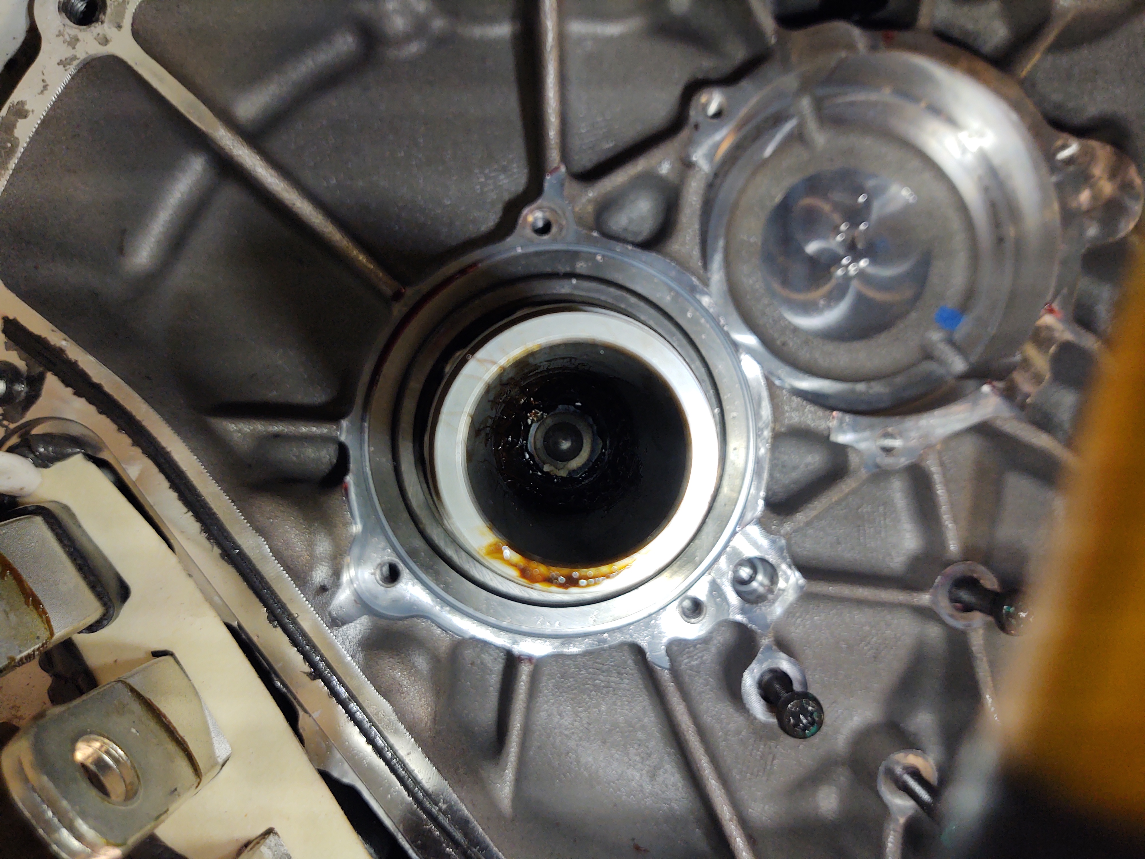

I'm not 100% on where the oil seal inside the motor seals on its sealing surface. Ideally the assembly starts there to watch that seal can be installed properly and without worry of damaging the oil seal. That looks like the center point / starting point of the assembly from what I'm seeing.- Intermediate shaft's FAG bearing was much tighter if all surfaces are dry and will jam if just slightly angled into the bore. Lubed insertion would be better but no way to do retaining compound this way. So I chose not to apply retaining compound here (original bearing had a 1cm red dab on the side wall of outer race (I didn't follow this as was suggested it makes no difference and original bearing was pulled out by fingers while lubed with ATF so this dab achieving nothing) Perhaps thermal trick would have worked (heat bore and/or freeze bearing). Unfortunately didn't try.
Likely slid into a heated case while its already on a gear / countershaft assembly. The electronics would handle 200°F which should also make the bearings slide in easier.- Big bearing on the differential shaft has no evidence of retaining compound on original assembly.
Jigs, stepped press plates, and bearing press tools to match shaft heights would be really helpful.Anyhow, definitely experienced knowledge on installing tighter fit bearings with retaining compound AND inverter removal/install along with custom jigs to position the 3 feet tall 300+lb drive unit for assembly would help.
That looks great.Weep hole
We cut a weep hole in the lowest spot in the seal chamber. Position sensor hole is higher than this but any accumulated liquid here would just run down to the lowest spot. Here is a pic of the weep hole and speed sensor mounting location for reference.
https://teslamotorsclub.com/tmc/attachm ... eg.874371/
An adapter could be spun op to be able to use a different seal. Like a collar the seal presses into (with o-ring) then install that assembly into the coolant manifold.
Is it possible the coolant manifold is available as a spare part with a seal installed?

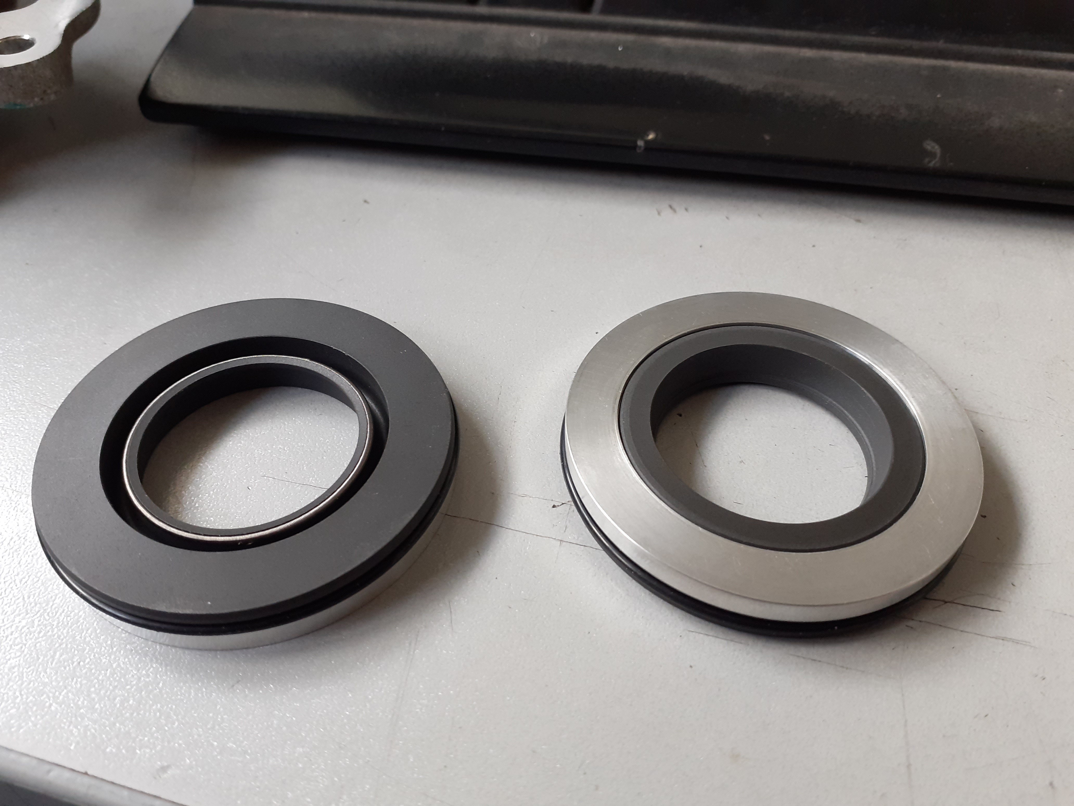

Very interesting!muehlpower wrote: ↑Thu Jul 06, 2023 9:48 am As already announced, I had a professional sealing company make sealing rings for the LDU. These have now arrived. Haven't tested them yet but look good. They should work with or without Speedy sleeve.

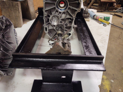

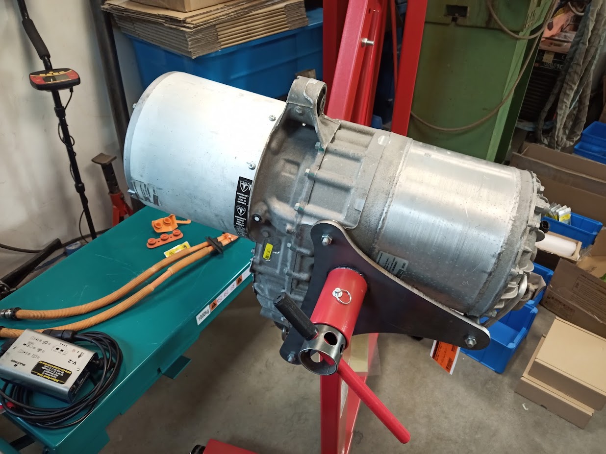

I made an adapter plate to mount the drive unit on an engine stand. Makes it at lot easier to work on.

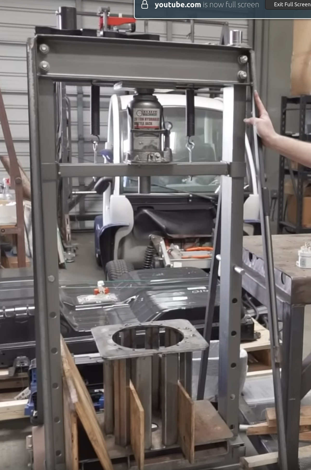

Without a top view, and not having a lot of in-person experience with the LDU at this stage (other than visiting Howard a couple of times during his journey), I can't tell if there's clearance between the end of the rotor and your end frame in this picture.

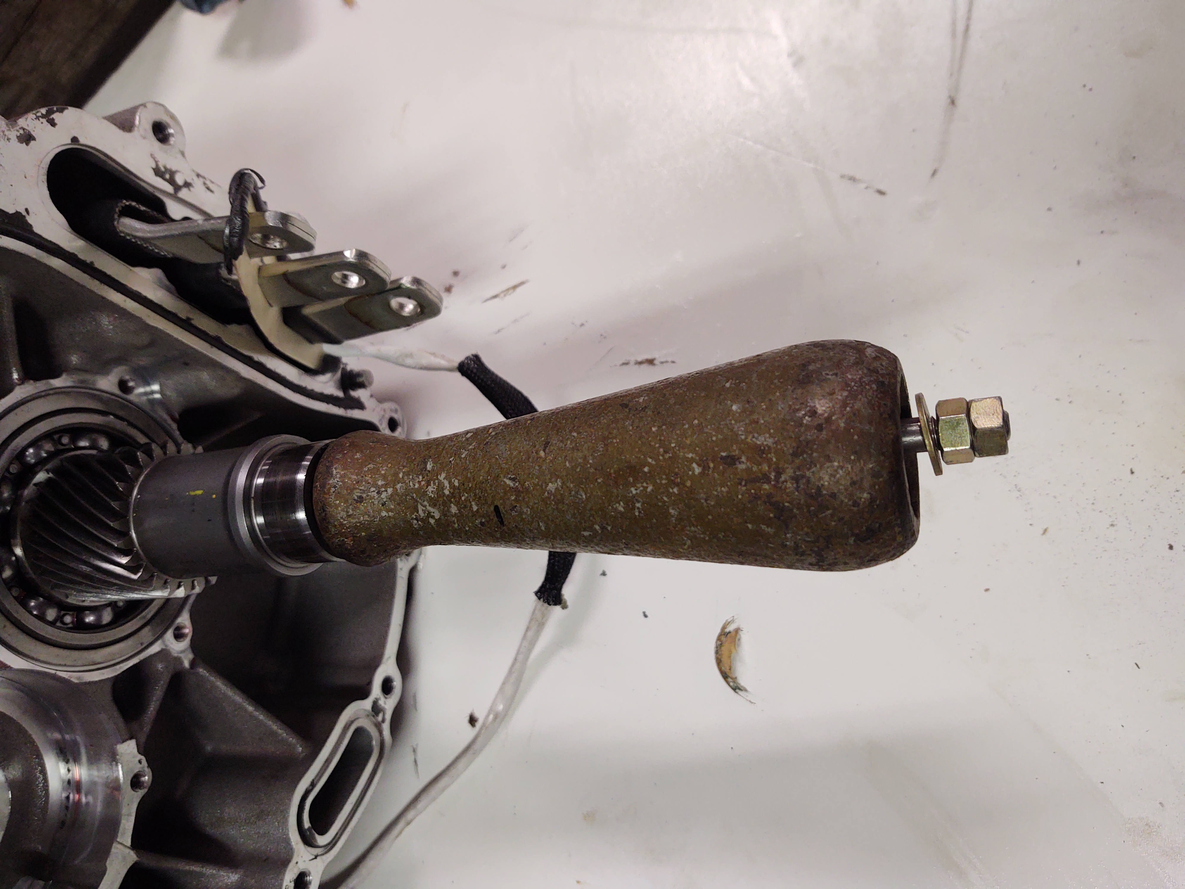

Regardless, you are not pushing on the rotor, but on the pinion gear. I believe you're pushing on the back of this:
You are pushing against the pinion gear/shaft, which abuts a retaining ring in the case:
[later: forgive me: this is a pic of a RAV4 EV pinion, which is why it has that "extra" externally-toothed doo-dad on the end, for the Toyota-mandated park pawl that Tesla made just for this vehicle and the MB B250e. It's the picture I have handy, though . . . ]
Lemme go find a vid (no, not Idiots at Work, something less combative . . . I'm well into "wine time" tonight) . . .
. . . found it:
Worth it to see the vertical alternative, but now that I've reviewed that vid again, it doesn't mention the important part . . . I think.
I'm guessing that you want to use a drift and press through the pinon to the end of the rotor.
Howard, do I have this correct?
[later still]
You'll want to press on the end of the rotor, which looks like this when it's got rusty bits around the rotor's bearing, to the inside of the pinion shaft/gear:

After pouring WD40 in it last night and sleeping with this on my mind I came out this morning to find exactly what you described. I'm pushing on the pinion shaft. I will now attempt to remove the collar inside the pinion shaft so I can get to the end of the rotor shaft. I'll probably use a slide hammer with a course thread on the end to grasp the collar. The flared end of the collar is inset 2.320" (59mm) from the end of the pinion shaft. A brass mandrel should be soft enough to not damage the splines as I push the rotor out. I should make a video of this process but I don't have the necessary equipment. As a side note, this 2012 Model S has 182,000 miles on it and the motor has been out at least twice for bearing noise repairs. The tag does not specify REMAN so it might have been a new revision R motor when it was installed by Tesla under warranty. I'll check the exact mileage and dates shortly. Updates to come...

They're pressing on something. IDK what, but it stands to reason that pushing on the pinion shaft/gear won't work.

I just got a call from GFD. Someone asked about my sealing rings. This is bad because I did not have permission to publish the drawing. This means I will keep my ideas and results of my tests to myself in the future.

Your previously posted solution and references made it sound like there's a solution available to replace the seal. There was no mention of how to buy one, anything about confidentiality from your post, and nothing noted on the drawing. Usually there is a confidential stamp across the drawing if it is. The breadcrumbs were there to source them with the info you provided but not to know it was confidential. I don't think anyone intentionally got you in trouble, they were likely trying to solve their own issue with the solution and info you provided. If I was in either of these situations I'd be currently apologizing for getting you in trouble.muehlpower wrote: ↑Tue Jul 25, 2023 10:31 am I just got a call from GFD. Someone asked about my sealing rings. This is bad because I did not have permission to publish the drawing. This means I will keep my ideas and results of my tests to myself in the future.
Thanks very much!
If I needed a seal I would have reached out to you first. If that failed or you didn't reply after a week or 2 my next step would be to contact GFD and try to buy from them. If I was an engineer at Tesla and was tasked with solving the sealing issue I would have gone straight to GFD to get one and see how they stack up.
I appreciate you posting / sharing your work, thanks for sharing it all. You are extremely talented. I think most /all on this site appreciate your contributions as well. Please consider sharing exactly as you have in the future, just not the confidential bits.

There is a reference to the Copy Right on the drawing, but I haven't seen it either. I have ten rings that would sell at cost price of 100€ + shipping. Actually, I wanted to wait until I have made meaningful tests. So who wants to buy at his own risk, please contact me. Shipping Worldwide!

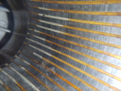

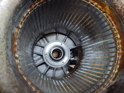

- Posts: 11
- Joined: Sat Jul 22, 2023 8:25 pm

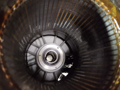

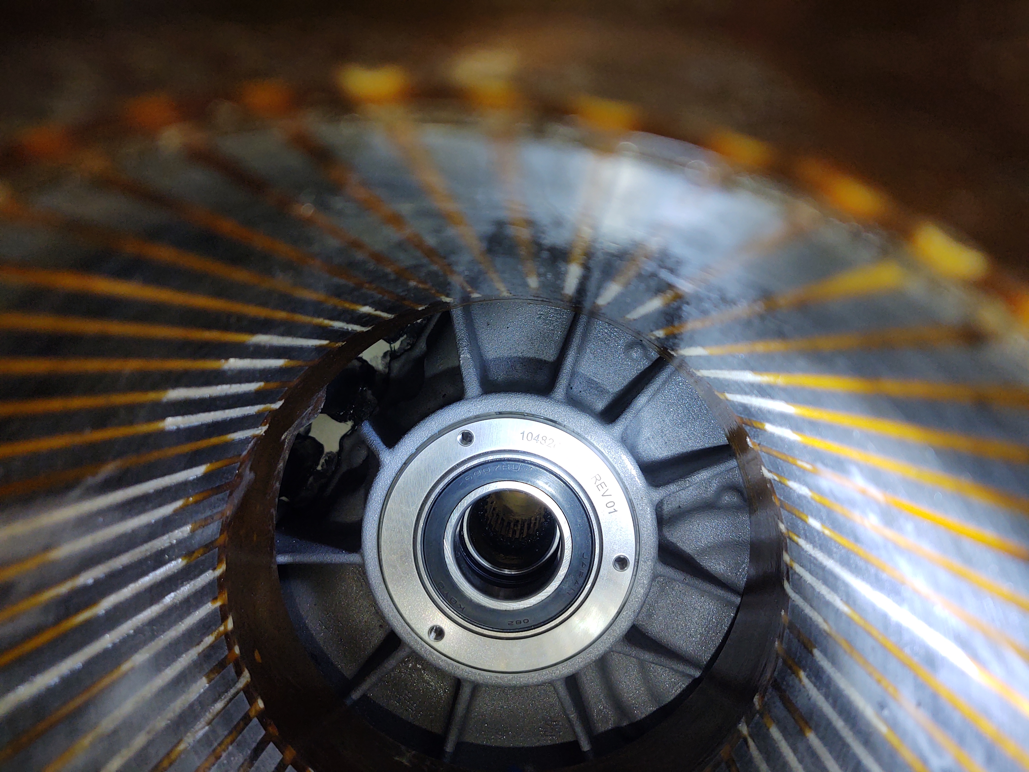

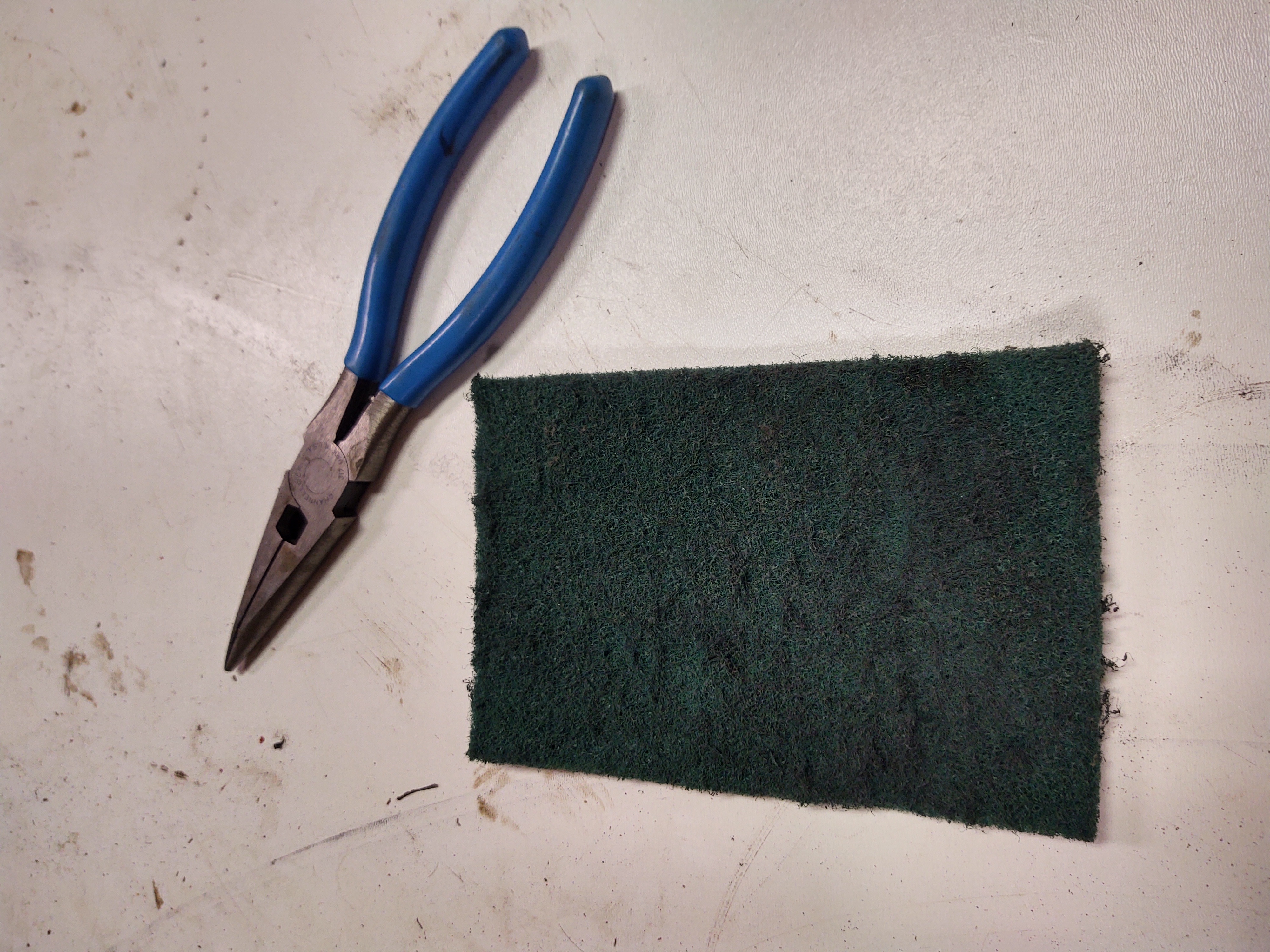

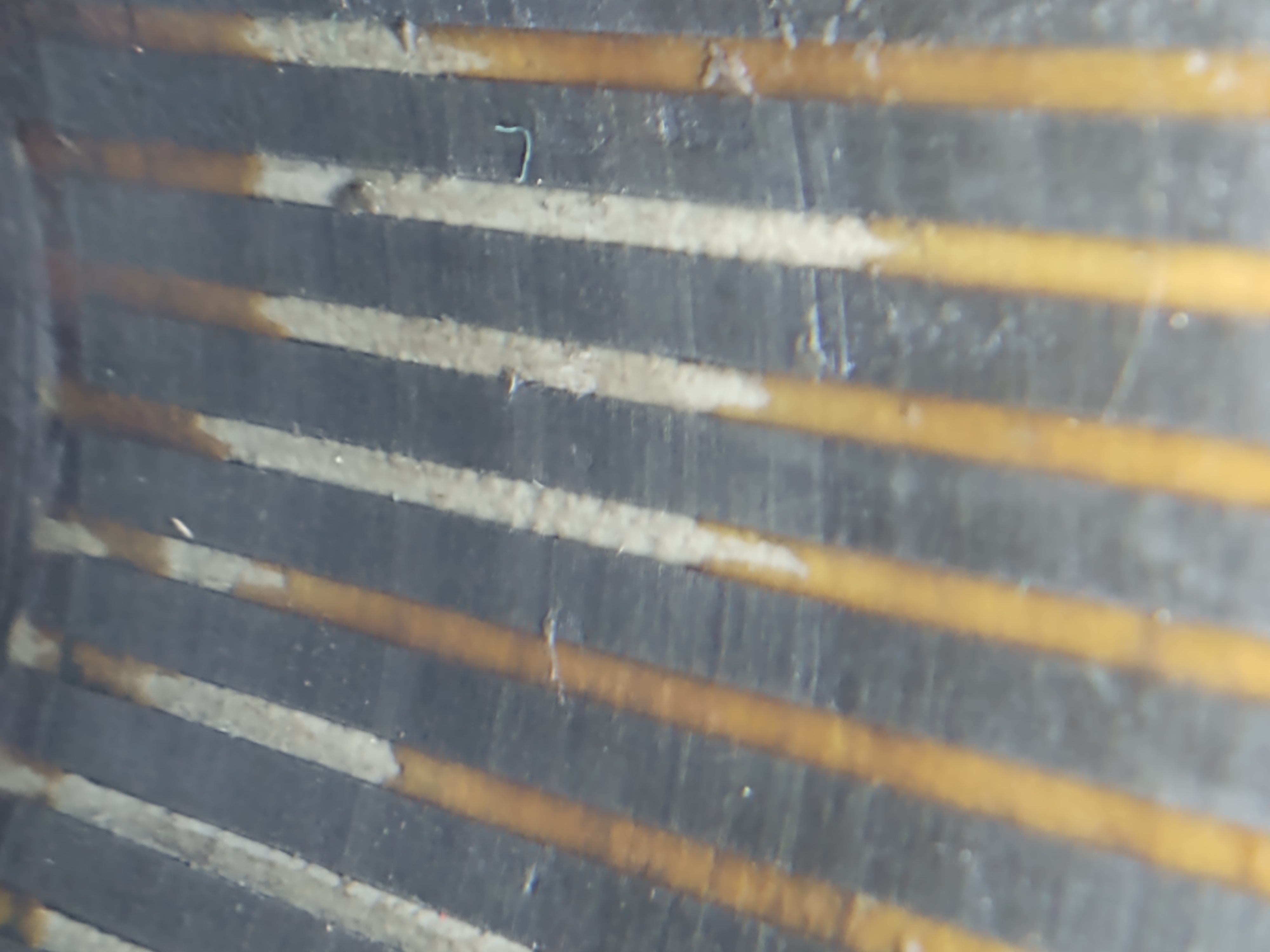

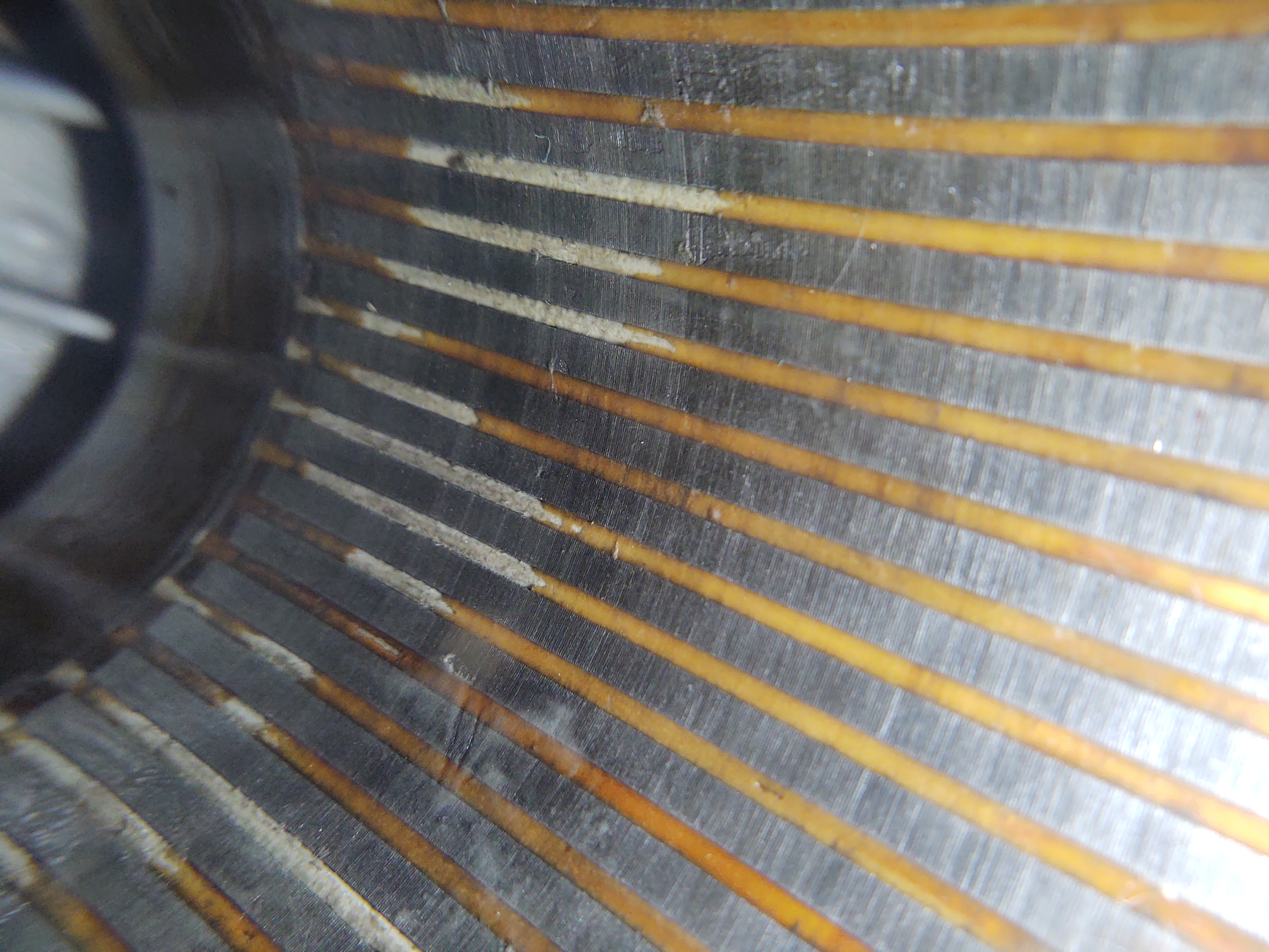

While cleaning the stator with an abrasive pad I noticed small metal shavings (hairs) sticking straight up from where the potting material was missing. (The grey strips in the picture.)
I attempted to clean them out and apply some quick set epoxy but the metal filings stuck up through the epoxy as it set. The filings had to come from somewhere and I don't think I created them with the green kitchen abrasive pad I used to clean the rust. An electric motor rebuilder told me to check for continuity between the individual strips and between the strips and the case as this was a sign of a short in the windings. They all have continuity. I found that this is because the strips are spacers connected to the case between the windings. Make sure you talk to people who know about this type of motor. Three phase AC brushless. I will attempt again to remove the metal filings and repot the windings. Has anyone else run across this? The motor is not a reman but has about 80,000 miles on it.

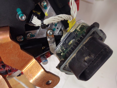

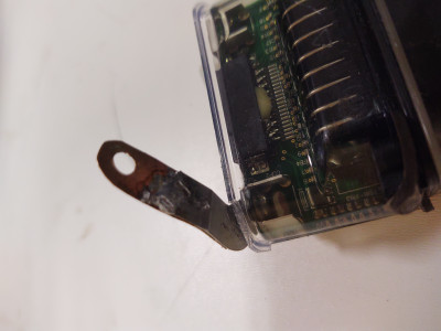

While I was checking continuity I decided to check everything else. I separated the motor buss bars from the inverter side by using plastic shims to isolate the connections from each other (picture). All 3 phases on the motor side have continuity with each other and none have continuity with the case. On the inverter side none of the 3 phases have continuity with each other or the main + and - power cables or case. This all makes sense and I believe it is working as designed. I'm no expert on electric motors though. Please correct me if I am wrong. Also be very careful to not bump the electrical pin plug on the inverter when you have the case removed. It is VERY fragile and will tear the ground strap that is potted into the plug itself. I had some brass sheet metal so I soldered that to the original ground strap to make the connection. The ground strap is a location mount for the plug so it has to be shaped and mounted properly (picture). I'm learning a lot working on this car and look forward to facing more challenges as I dig deeper. This site is a good resource for people to exchange ideas.

Listen for about 20 seconds, after Alex describes rusted-in-place rotors, he says "push the rotor out" whilst pointing to the press.

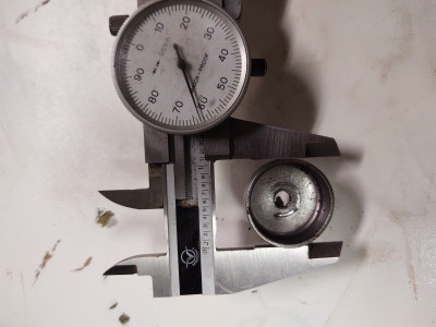

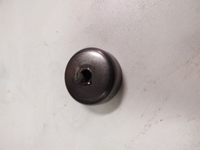

howardc64

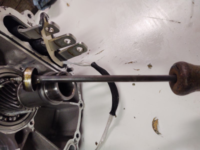

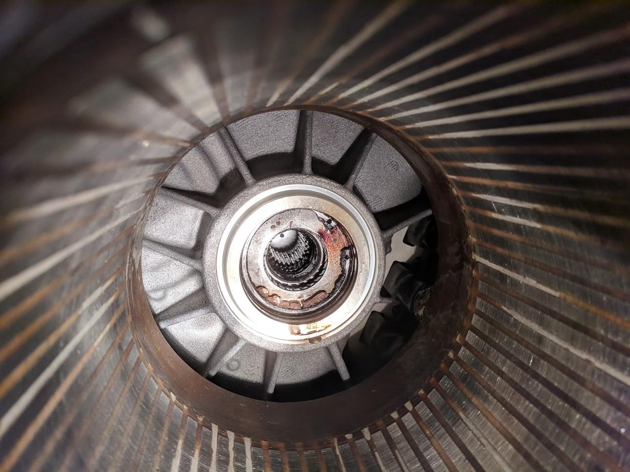

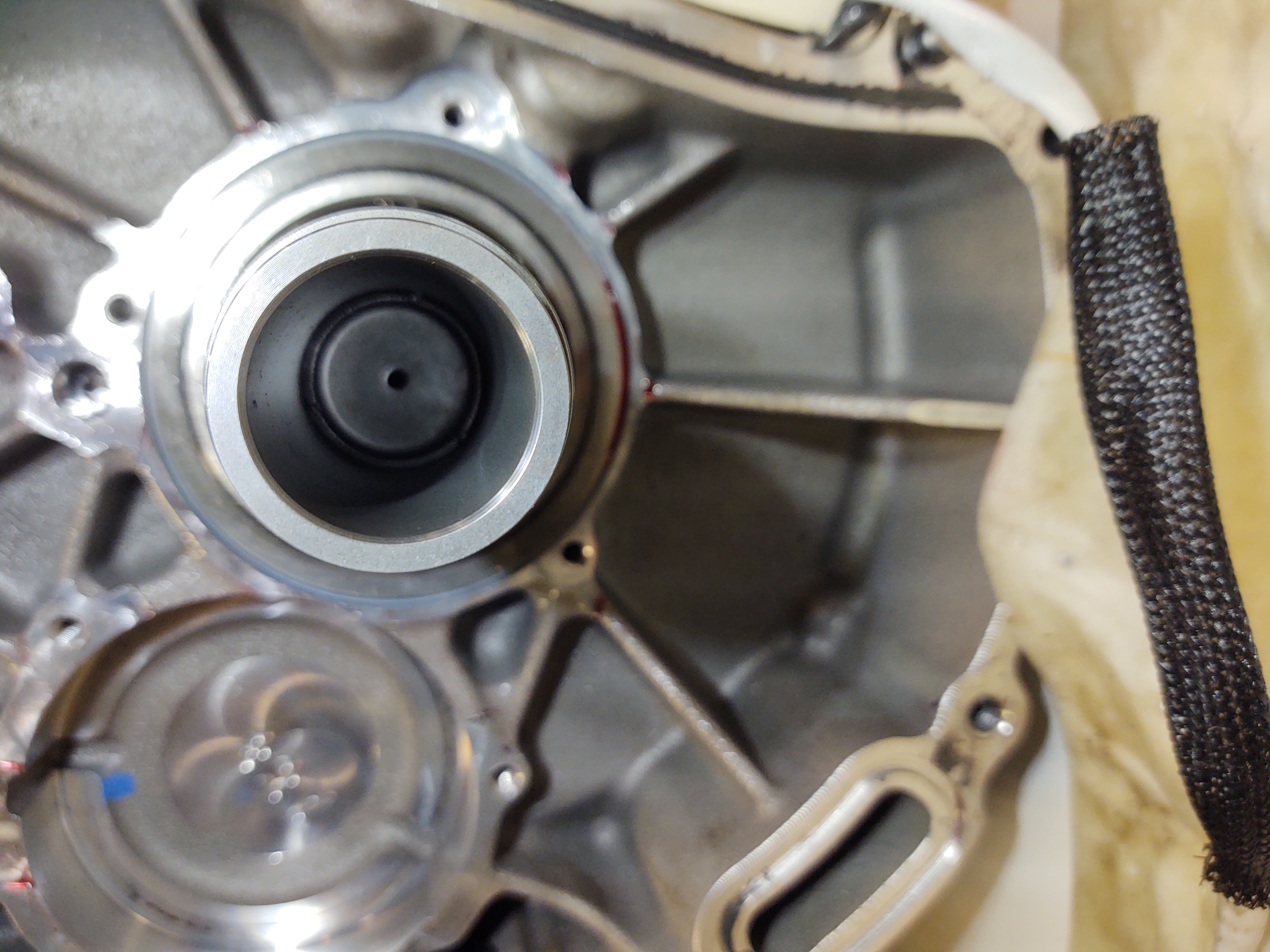

I had the gear case split apart. Inside the pinion shaft there is a steel collar that looks to be a grease stop for the rotor splines. It has a small hole in the middle so I screwed a self tapping screw into it connected to a slide hammer I made to pull the cap out. Then the rotor splines are visible through the pinion shaft. I used a brass slug and a steel bar to push the rotor out with the press I made. The inner ceramic bearing stayed in place when I pressed the rotor out. I took the grease seal off with the tools I got from the machinist and redistributed the grease without removing the bearing. The outer one was much easier to access since it came out with the rotor. The entire assembly is back together and waiting for the coolant seals I ordered. I'll probably use the 2 lip seal first, I think 3 lip is overkill and I've read that it doesn't fit properly.

Now that I'm looking inside the stator with a magnifying glass these metal shavings "hairs" sticking up look more like fibers from the insulating casing around the windings. They don't appear to be metal at all. It sucks getting old, haha.
