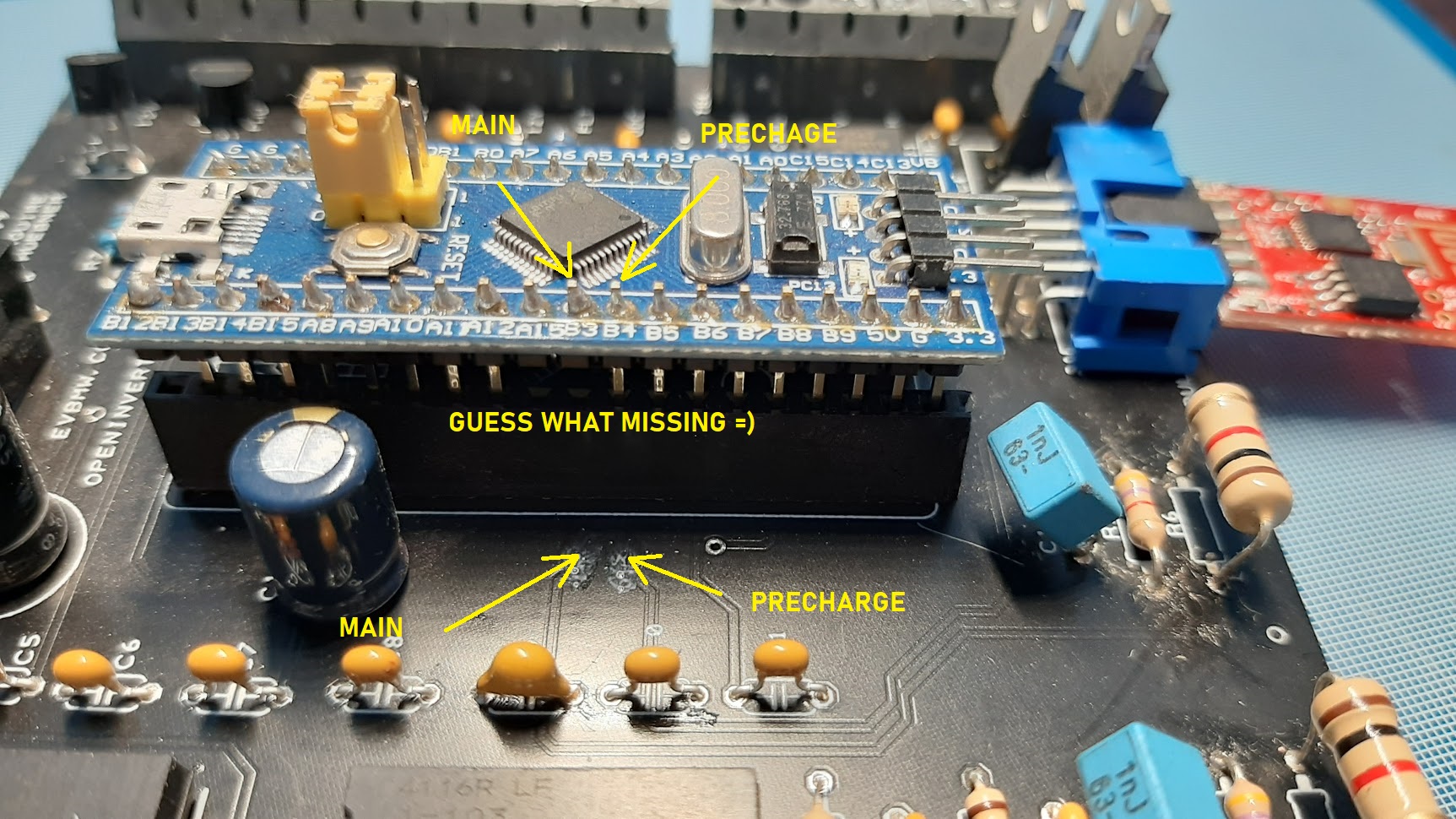

OK. I've got it about inverter is active despite "STR" pin is not activated. Stupid me, I believed that picture on wiki, that is 50% wrong. I've just connected inverter shutdown pin to 12 volts....=( So why there is a "STR" pin in a first place? What is it doing, except shutting down precharge contactor?

Now I could update this picture but there are still some issues with the board, such as direction select works incorrect, main contactor is not closing, and wiki page is thrown somevhere, I can't find it.

Well it would start inverter if there was a pin on the board to connect it to inverter's "mg2 shutdown". But it is not. "mg2 shutdown" only can be controlled manually in this particular case.
I've found out why "forward" remains stuck. After I switch it off, there is still some voltage on it. 4 or so volts. When I hook up voltmeter to it it drains out and switches off. The is no such issue with any other pin. Only with "forward".
Btw, there is what I see when I power up the board.
din_mprot and din_emcystop are both 1. So that means there are no stop errors? So why it not closing main?

About stuck "din_forward" pin. After it is switched off, thre is still 4 volts, which drops to zero in about one or two minutes. There are 1uF capacitors hooked to pins. I've measured their resistance with a multimeter. At other pins it is something around 10kOm, but at forward pin resistance of C9 capacitor is more then 2MOm, does that means that capacitor is dead?
UPDATE: problem was in dead C9 capacitor.

I've encountered strange and dangerous bug with this board.
Unexpectedly car starts to accelerate on its own. "Pot" is below "potmin" but "potnom" is 100%. On neutral it doesn't do anything, but as soon as I choose direction is starts to go there.
I still don't know what triggers this bug. Last time it happened when I was playing with "ampnmin" and "throtramp" parameters, while the car was on steep heel.
The only thing that resets this bug is logic board reset.
All signal wires and board itself are not screened yet, and problem occurs when inverter is hot.

Isaac96 wrote: Sat Jul 04, 2020 6:48 pm I don't think that is supposed to happen...
PWM output is only supposed to be possible in opmode 1 or 2 (normal or manual mode).
Can you try looking at the opmode with board switched on but not started? Maybe you have a wire crossed somewhere.
-Isaac
will check it tomorrow.
-Isaac
OK, I checked it and all works fine. When logic board is switched ON, opmode is "0" and it doesn't react to direction switch and pedal. Inverter start botton is momentary - as soon as it was pressed, opmode is "1" and it only swithes OFF when logic board is switched OFF.
MAIN didn't closed because of no contact on blue pill board :?

Damien is a true 80 lvl troll :D
Also for some reason FLT pin missing as well. Damien can you please tell why?

by konstantin8818
Ok, problem is still there :(
Before strt button pressed there is 3.15 volts on precharge pin, and 2.4 volts on dcsw pin of blue pill. When strt is pressed, precharge is deactivated, there is zero volts, but on dcsw there is still 2.4 volts. I'm confused.
As soon as strt pressed there is derate error occurs - current limit. What could be the problem?
