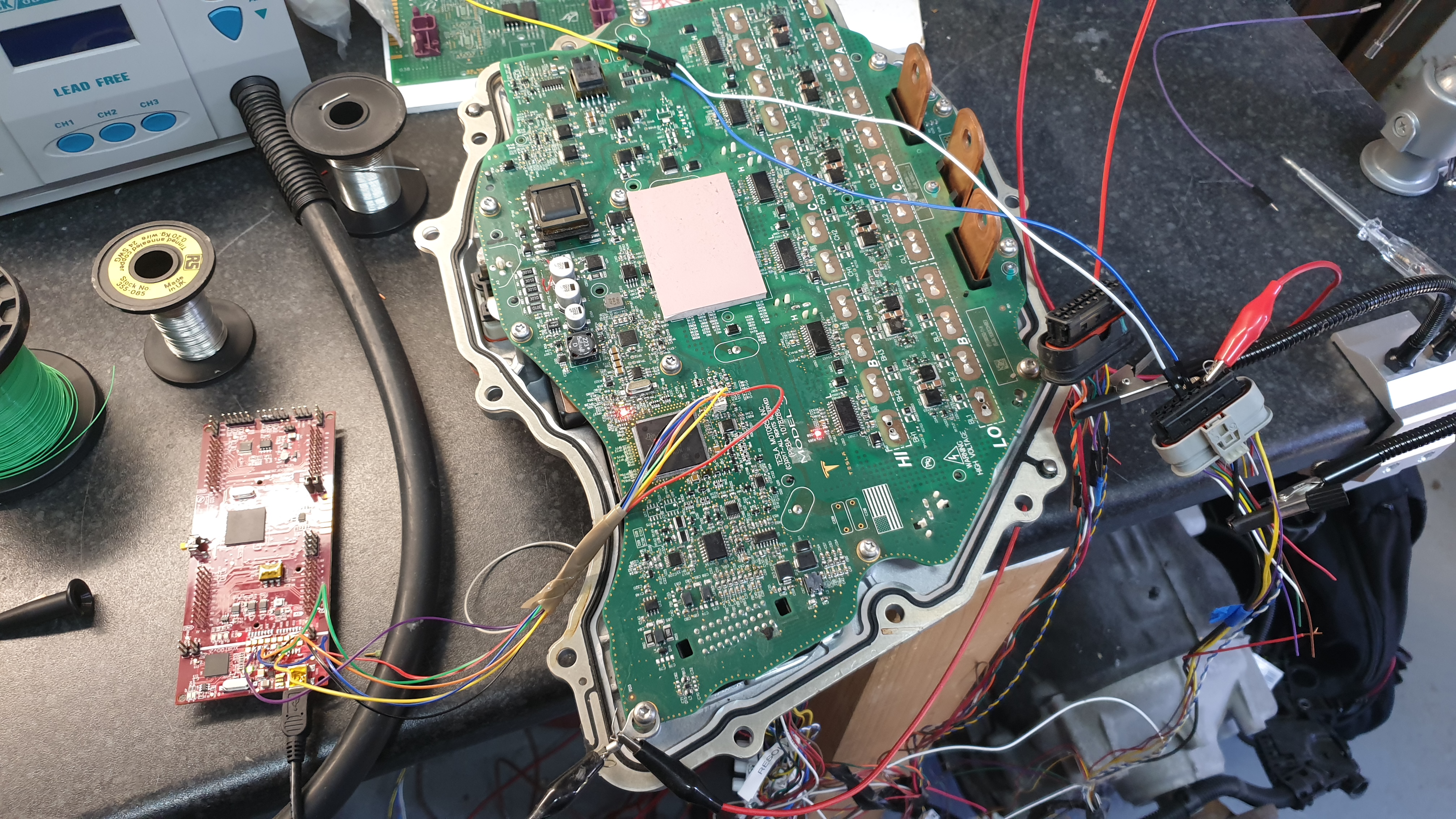

It's my intention to have reprogramming of firmware over CAN (everything has to be done over CAN on this board). Implementing that is a long long way down the priority list though...
Unless I'm mistaken Damien's board is USB connected. You'd only hook it up for programming firmware much like the ST-Link V2 that we use for STM32 projects.

Ok cool. So in the Beginning USB board for every program code version change, later without opening the inverter..?

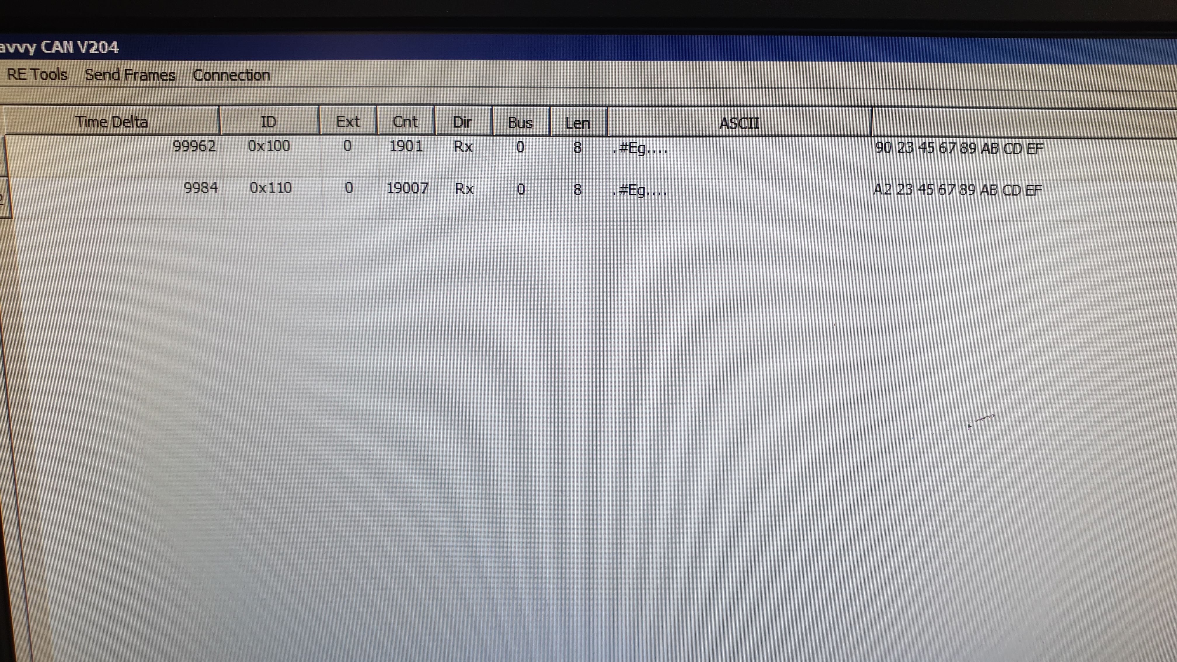

Before everyone goes and erases their TMS320F28377DPTPQ flash, maybe a good idea to verify that CAN boot eg https://www.ti.com/lit/an/spna200/spna2 ... 3198324875 is not supported in Elon’s firmware…
Eg with something like https://www.peak-system.com/PCAN-USB.199.0.html?&L=1

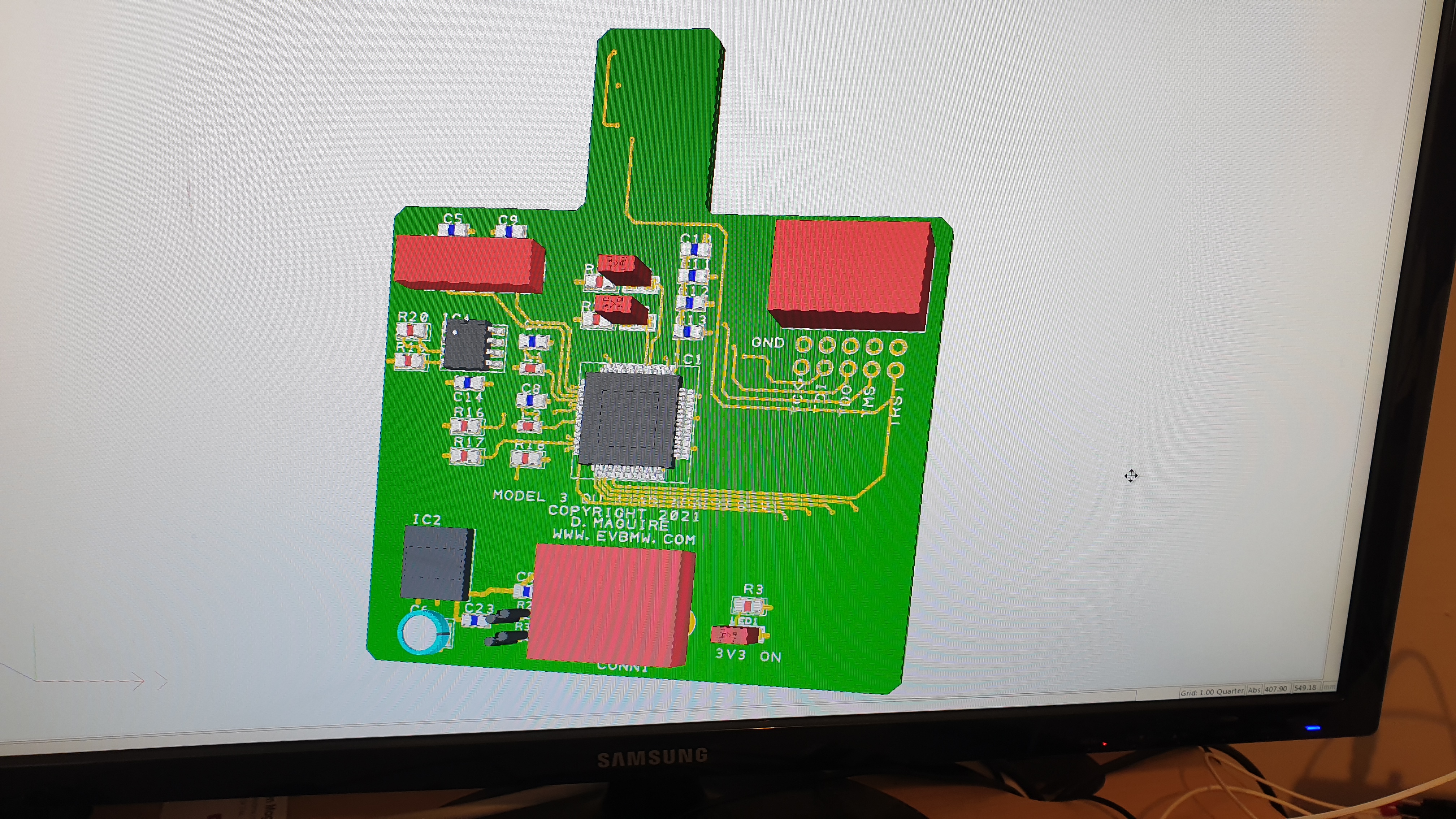

On the subject of erasing micros. Could folks please have a look over the attached and see if I've done something stupid before I go ordering boards from JLC and waste even more time ...
Its basically a copy of the TI xds100v2 USB-JTAG used on their 28379d launchpad board using JLC parts. The connection to the driveunit features a stupidly small 1mm pitch hirose header with crimp terminals about the size of a flea. To avoid that fun I'm going to go with a Harwin M40-3100545R mounted on the rear of the board under the little arm that should make it a plug and go solution thus avoiding the crimping nightmare.

It's a pity Hirose don't have a female version of the PCB connector. I think the connector ought to mate though it is definitely designed for square pins and the Hirose DF20 pins are rectangular. Might be worth testing one mechanically before committing if you haven't already.
Electrically it matches the FT2232-56Q Mini Module based JTAG adapter I built. Seems to follow the layout, PSU guidelines from FTDI. PCB connector orientation and connection seems to be correct.
Can we have a ground pin on the serial port connector?
One thing to note, without an isolator the JTAG adapter seems to back-power the board (presumably via protection diodes) when the inverter is powered off. I'm hoping bad things don't happen but the gate driver fault LED glows dimly.

Thanks Dave. Yeah I noticed the power via jtag also. What I do is disconnect jtag first and connect last. I'll do an iso version once this one is proven working.
On another note just found an error is my pinout for the CAN Tx and Rx. I had them swapped and of course the compiler got angry with me. Now fixed and we are churning out some can, running some basic task timers and of course flashing the all important leds. ooohhh....I wonder could I get cpu2 to flash one led and cpu1 the other. Seems like a good use of a spare processor and my time:)

Mods done and jtag boards ordered from jlcpcb. Will make kits available once tested.

My only concern is that the FTDI can/must be programmed to popup in your PC and load the appropriate drivers etc. So the application uses it for what it is. contact me over PB and I will tell you more what i know. Since this type of stuff is used for cloning adapters.Jack Bauer wrote: ↑Sun Oct 03, 2021 9:56 am On the subject of erasing micros. Could folks please have a look over the attached and see if I've done something stupid before I go ordering boards from JLC and waste even more time ...

You are right to point out that FTDI FT2232H adapters will need to be programmed. It's pretty straight forward though. You need the FT_PROG utility and a configuration template. TI handily publish all of their ones and I used the one for the LAUNCHXL-F28379. I wrote up how I created my JTAG cable for posterity.EV_Builder wrote: ↑Tue Oct 05, 2021 4:21 pm My only concern is that the FTDI can/must be programmed to popup in your PC and load the appropriate drivers etc. So the application uses it for what it is. contact me over PB and I will tell you more what i know. Since this type of stuff is used for cloning adapters.
Looks like it's possible to do on Linux with a utility called ftdi_eeprom. It takes different input from the official FTDI tool and might be a bit more tiresome to use.

As far as we are aware all you need to do is hook up a JTAG adapter and erase the flash and you can put whatever you like on there. There may be cleverness relating to the OTP bits Tesla have set that we don't understand yet but at this point in time we believe that to be true.
