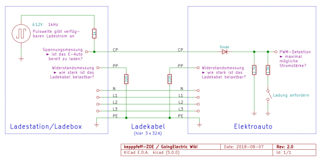

I have a strange behavior on the Superchargers. The Supercharger provides the 12V on CP if nothing is connected and changes to 9V when foccci is plugged in. Fine until here. Now, normally the charger would start the 5% PWM, but the Supercharger doesn't. Other chargers are starting the PWM quite shortly (below 1s) after plugging-in. To observe the physical state of the CP, I created a small Arduino project, which measures the CP and shows with 2 LEDs very fast, whether the upper and lower voltage of the PWM are fine. https://github.com/uhi22/arduino-controlpilot-observer
With no 5% PWM, the Supercharger also ignores the SLAC requests from foccci, I consider this as normal intended behavior.
I tried different stalls, all behave in the same way. The same stalls are working fine with my Ioniq.
At the moment I could imagine only these root causes:
- Maybe the Supercharger also checks for the PP connection. I do not have connected the PP.
- Maybe the Supercharger has some mechanical detection, which my self-printed CCS inlet does not fulfill. I did not see something, but who knows.
- Maybe the Supercharger is very critical regarding the CP resistance, maybe the foccci is not precise enough. [Edit] Used a 1k/1% resistor and power supply with 12V, and measured the resulting voltage on CP when foccci is connected. This gave 8.9V, so quite near to the intended 9V. Should be fine.
Any ideas?
Any ideas?

Superchargers work perfectly for me with pyPLC. I do have PP connected, I'd start with that. I wonder what johu's circuit was like, because it also worked

I left PP dangling

Is it possible that the CCS inlet itself already contains some resistor between the PP and PE, so even if leaving the PP wire open, the charger could sense somehow the connected vehicle?
[Edit] Maybe there are even different superchargers. I know, there are V2, V3, V4. All my tests were on V3, and I definitely got a connection with pyPLC some months ago without connecting the PP. Would be strange if they added a more strict detection.

For AC charging, there is a resistance between both plugs between PE and PP, e.g. 220 ohms for 32A current carrying capacity. The PP of the charging station is not connected to the PP of the car. The resistance on the car side is read from the car. How this is done may vary from control unit to control unit. Usually it will be a pull up resistor to 5V. So what does "PP connected" mean?

For CCS, it is even more simple than in the picture (at least from my current understanding): In the plug there is just a 1k5 resistor between PP and PE, like in the right part of the picture above. The car can measure this resistance, e.g. by a pull-up to 5V. Or the car can ignore it, no pull-up, no measurement. The charger does not even see the difference, because it does not measure anything from the PP.
So with "PP connected" I meant that inside of the car there is something like a pull-up or pull-down or a combination of such.
In theory, the charger *could* detect the car by measuring the voltage on the PP, *if* all cars would have a pull-up of a certain value which *would* lead to a certain voltage level. But if the CCS case is the same as the AC case in the picture above, this should not happen.
I think I need to take some measurements.

I took a look at the input circuit of the LIM. PP goes into an R330 and a 47k resistor. The other side of the 47k goes directly into the microcontroller. The second side of the R330 goes into an unknown component with 6 pins. Two of the pins are bridged. The remaining 3 are connected to 5V, GND and a pin of the microcontroller. I suspect that the unknown component is controlled by the microcontroller during the measurement process, connecting the R330 to 5V, and is open the rest of the time to avoid unnecessary power consumption or damage due to static charging. The measurement voltage then reaches the microcontroller via the 47k.

The 330 ohm pull-up to 5V is confirmed in the picture from the I3 wiki, discussed here: viewtopic.php?p=59932#p59932
It also shows two additional interesting things:
- Directly in the CCS inlet, there is a 4k7 from PP to PE.
- One EVSE side, there is a sense line, PP to the EVSE controller, besides the 1k5 in the connector.
So basically this diagram confirms, that the EVSE controller could do some diagnostics on the PP. But it is not clear, whether the values are officially specified or just an example of BMW.
Measured on the original Ioniq. This has 4.47V on the PP if nothing is connected, and 3.75V if we connect 1k5. This approximately would mean, there is a 330 ohm pull-up to 5V and a 3k pull-down in the car. If the car is sleeping, the static voltage changes to shortly pulsed voltage, something like 1/100 duty cycle and 5Hz. (Only roughly, did only have the multimeter, no osci.)
Cross-linking the PP resistance discussion of the VW charger: viewtopic.php?p=66091#p66091
Conclusion for now: I will wire the focccis PP to the inlet. It has 1k pull up to 3.3V, so the resulting voltage will be only be 2.0V, compared to the 3.75V of the Ioniq. Still the risk that the picky supercharger is not happy with that.
[Edit] Our Indian friends are so kind to publish some more details here: https://morth.nic.in/sites/default/file ... rt_2_F.pdf (This contains a lot of ChaDeMo and CCS stuff.) They say in annex C7: "PP line from vehicle connector to DC supply is mandatory for configurations C and E and optional for configurations D and FF couplers." (Not yet clear, what these configurations mean, something like CCS type 2 and CCS type 1 I guess. [Edit] FF is the CCS2, https://en.wikipedia.org/wiki/IEC_62196#FF)
[Edit2] And in the Indian Figure C.5 we find the 5V, 330 ohm pull-up and 2k7 pulldown in the inlet. This picture is for CCS type 1, not clear whether CCS2 has the same requirements, but could be.

I admit that I am not following this as well as I could, but for confusion's sake . . . a post of mine on another site, from May2023:
https://www.myrav4ev.com/threads/my-own ... post-30114
Granted, this is J1772 . . . but the pins are the same ones
Per the Wiki, the Proximity Pilot is also used (sometimes?) to determine the untethered cable's capacity:

Thanks, now all the information leads me to concluding the PP topic:
- The charger (in my case the foccci) shall contain a 330 ohms pull-up to 5V.
- The inlet shall have a 2.7k pull-down.
- This is valid for CCS1 and CCS2. Only the resistors in the plug are different between both variants.
- It seems that a lot of CCS2 chargers do not measure the PP at all, but the specification says that this is mandatory for CCS1 and optional for CCS2.
I'll patch my foccci hardware to fulfill this, and re-test on the supercharger.
Thanks to all for the contributions.
