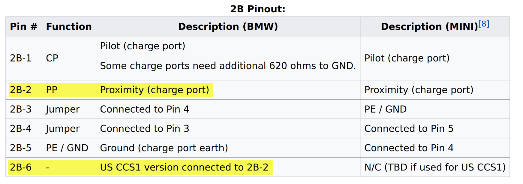

I took another look at the LIM. According to the circuit diagram, PP is connected to pin 2 (A250-B2) in the CCS2 version. No resistor is shown in the charging plug. CCS1 has an additional jumper from pin 2 to pin 6. This pin 6 is connected to GND (PE) in the LIM via 2k7. This means: In EU no 2k7 to PE, in USA yes.

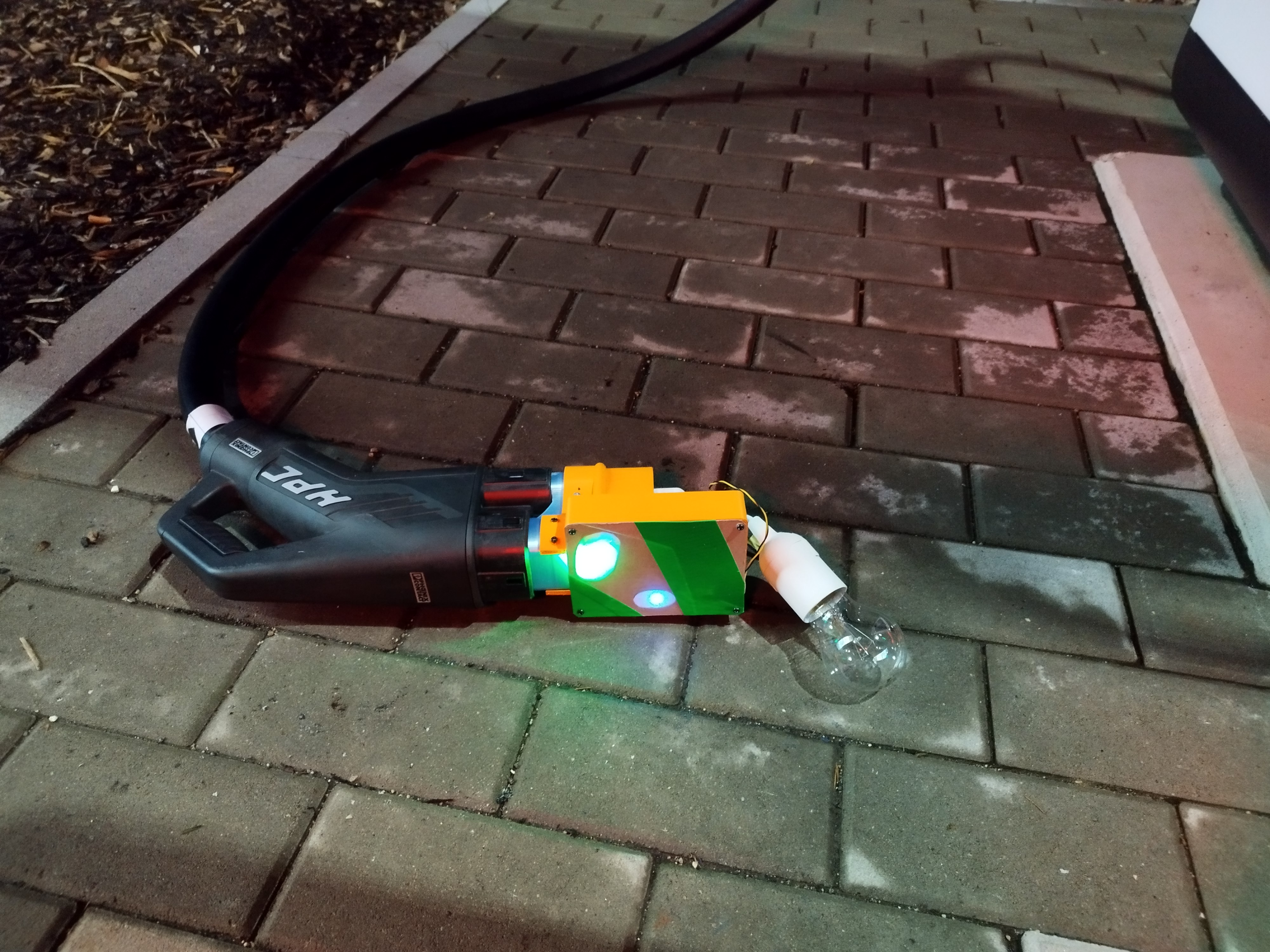

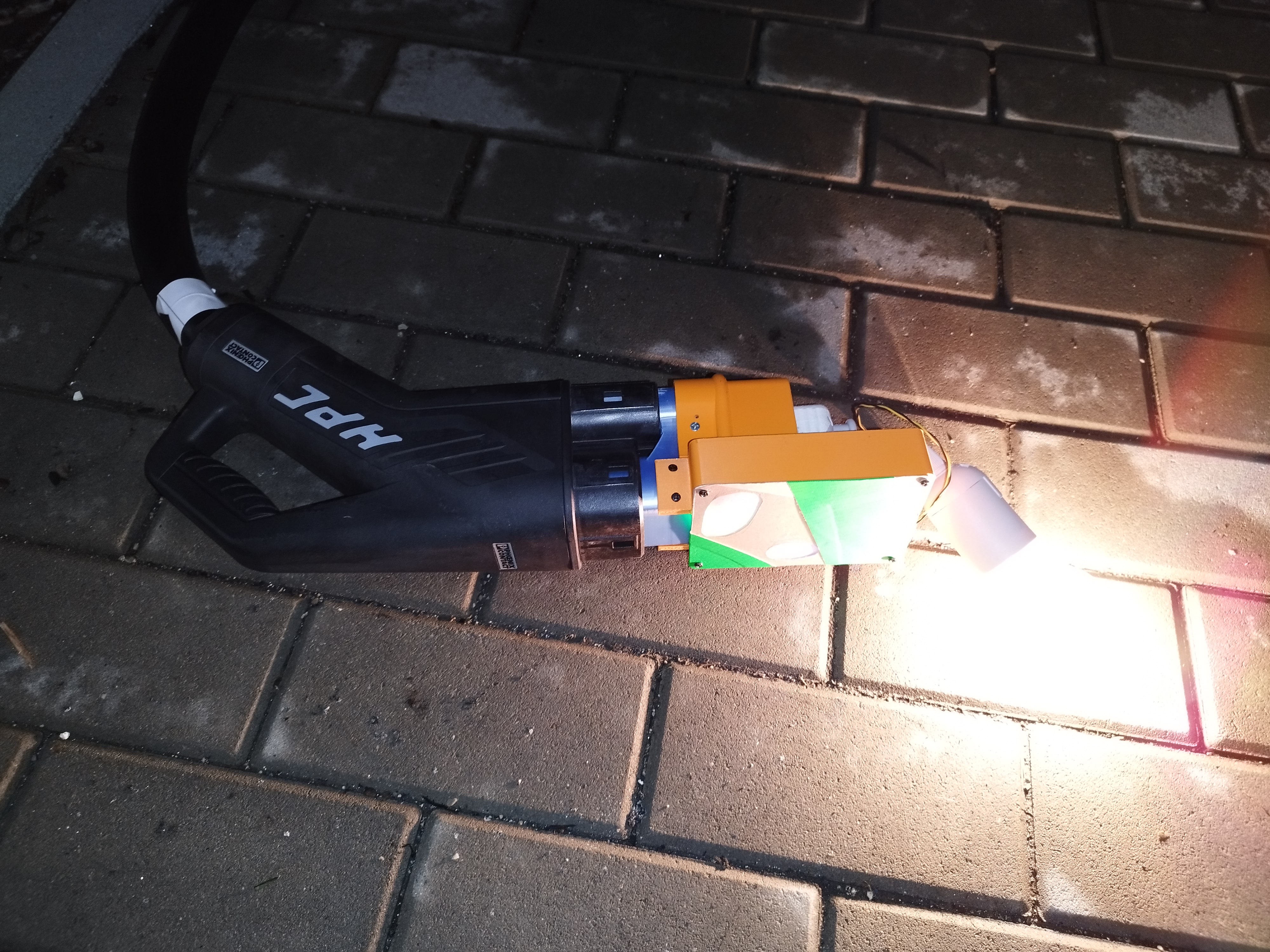

Mechanically the CCS2-to-SchuKo-adaptor is nearly finished, including integrated accu.
Been thanked: 1918 times
Re: Develop a QCA7000 board?
Sweet :)
I'll test the now built-in foccci soon

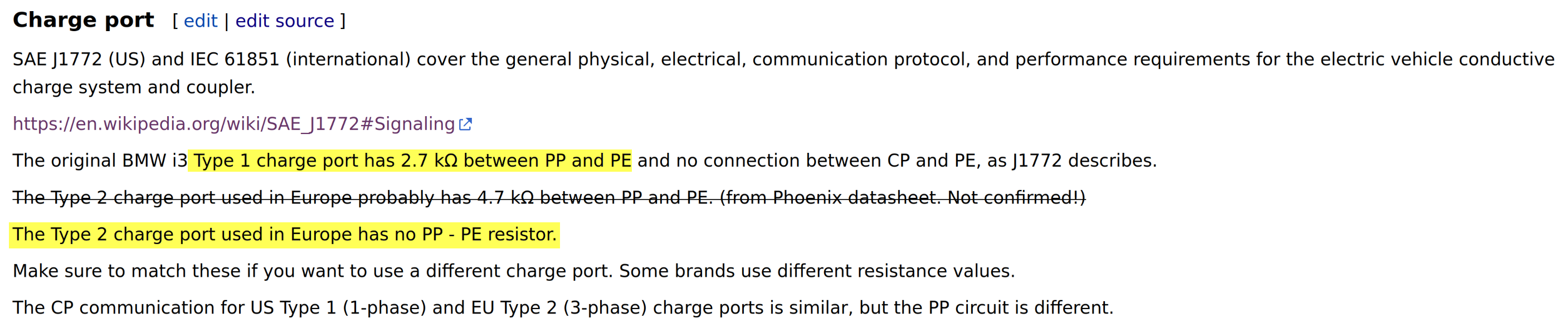

muehlpower wrote: Sat Jan 27, 2024 11:13 am I took another look at the LIM. According to the circuit diagram, PP is connected to pin 2 (A250-B2) in the CCS2 version. No resistor is shown in the charging plug. CCS1 has an additional jumper from pin 2 to pin 6. This pin 6 is connected to GND (PE) in the LIM via 2k7. This means: In EU no 2k7 to PE, in USA yes.
Yes, this has been documented on the LIM Wiki for some time.
20240127 Wiki entry BMW i3 LIM: PP-PE resistance
Those entries could both use some cleanup, probably.

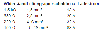

As starting point, implemented the measurement of the PP resistor. Connected a 100 ohm resistor for test, and this gives
So depending on the use case, it is possible to map the following data to CAN as wished: the raw AD value, the calculated PP resistance, or the calculated cable current limit.
For the PP resistance calculation I needed to introduce a new parameter, ppvariant, to be able to distinguish between the "old" Foccci with the 1k pull-up to 3.3V (which is selected by ppvariant=0), and the "new" (handwired) Foccci with 330 ohm pull-up to 5V (selected by ppvariant>0).
[Edit] Tested these possibilities PASS (from https://www.goingelectric.de/wiki/Typ2- ... codierung/)

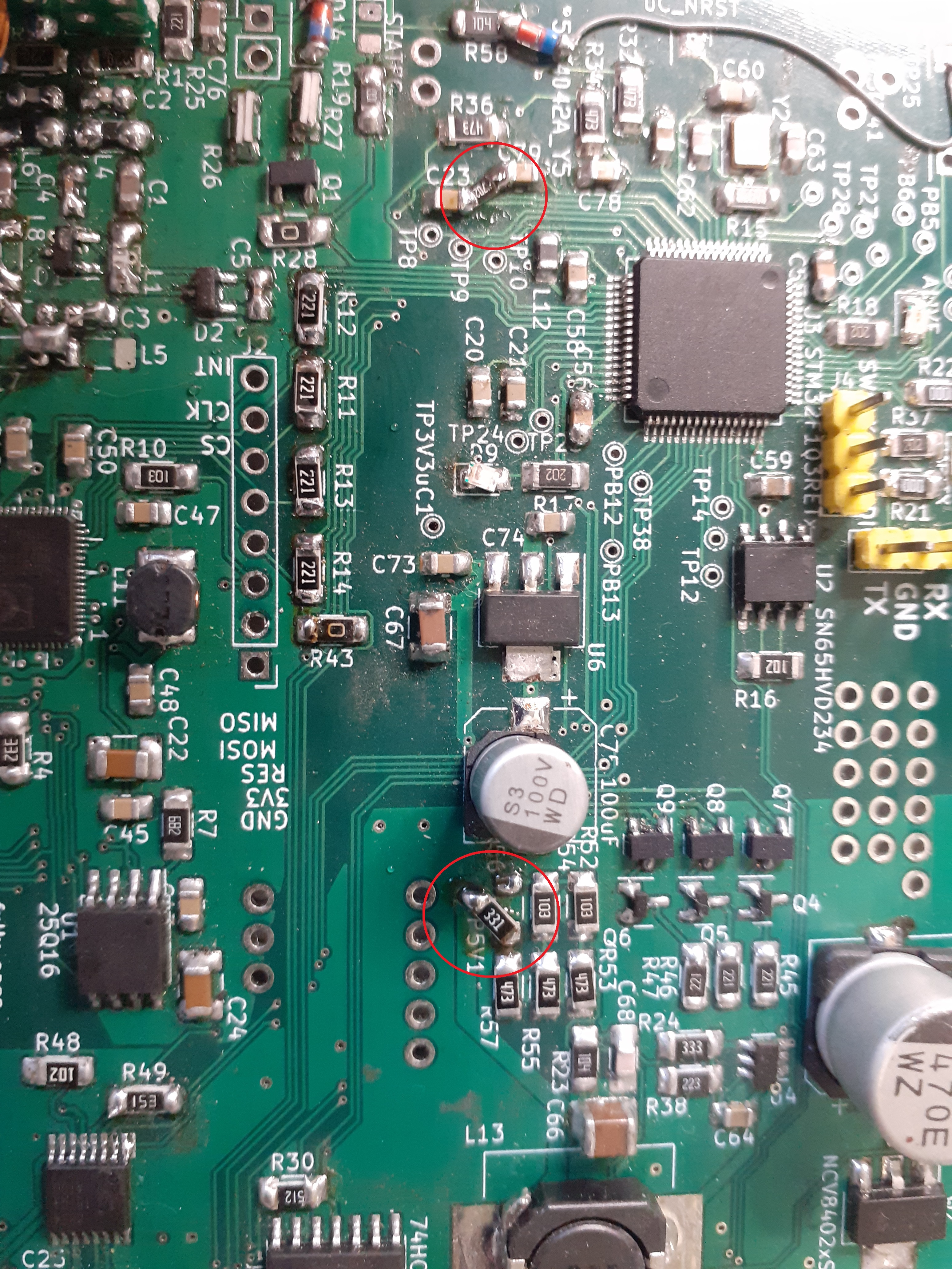

I have the old foccci. If only the resistor needs to be replaced, I would simply resolder it.
uhi22
Posts: 1244
Location: Ingolstadt/Germany
Has thanked: 245 times
Been thanked: 684 times
Post by uhi22 »
It's more:
- The value of the pull-up changes from 1k to 330ohms.
- The supply of the pull-up is moved from 3.3V to the 5V rail.
- An additional 47k to ground needs to be added, to create a voltage divider 2:1, which scales the now 5V PP voltage to be measurable with the 3.3V ADC range.
- Added also a 3k pull-down on the PP, to have the same situation as measured in my Ioniq.
For the moment I propose to support both variants, the "old" and the "new" in software, and configure it with a parameter. So we do not lock-out anybody just using the existing boards. This gives the freedom to everybody to either patch the hardware or to stick to the existing state.

Perfect :-) Fortunately, the 5V is perfectly near to just solder the 330 ohms. The upper circle is the additional 47k I guess, this is difficult to see. And the 3k pull down? Maybe it works without.
