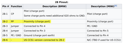

I took another look at the LIM. According to the circuit diagram, PP is connected to pin 2 (A250-B2) in the CCS2 version. No resistor is shown in the charging plug. CCS1 has an additional jumper from pin 2 to pin 6. This pin 6 is connected to GND (PE) in the LIM via 2k7. This means: In EU no 2k7 to PE, in USA yes.

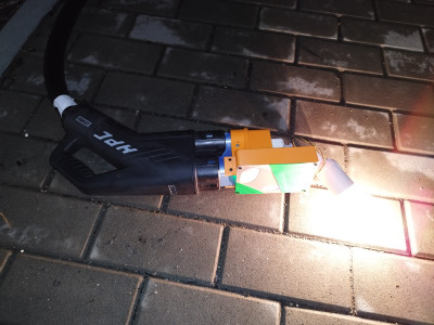

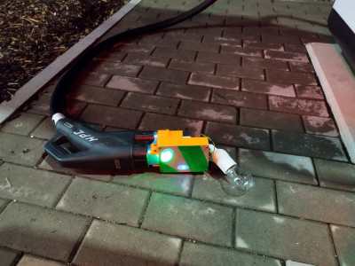

Foccci on alpitronic
Foccci on alpitronic 2
Mechanically the CCS2-to-SchuKo-adaptor is nearly finished, including integrated accu.

muehlpower wrote: Sat Jan 27, 2024 11:13 am I took another look at the LIM. According to the circuit diagram, PP is connected to pin 2 (A250-B2) in the CCS2 version. No resistor is shown in the charging plug. CCS1 has an additional jumper from pin 2 to pin 6. This pin 6 is connected to GND (PE) in the LIM via 2k7. This means: In EU no 2k7 to PE, in USA yes.
Yes, this has been documented on the LIM Wiki for some time.
20240127 Wiki entry BMW i3 LIM: PP-PE resistance
Those entries could both use some cleanup, probably.
