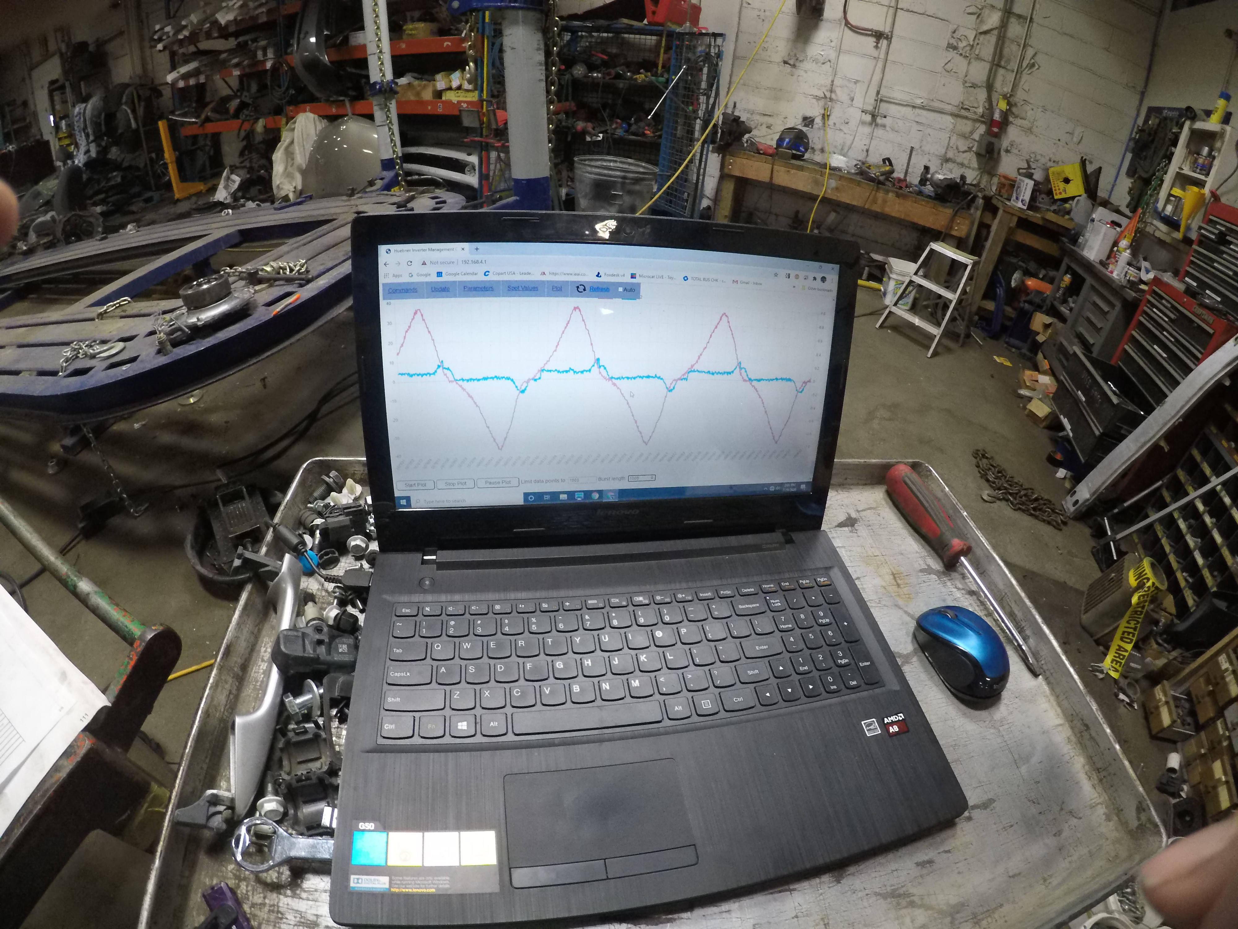

did it, video in the next few minutes. power supply shows a current draw on two as predicted.
il1 and il2 graph not logical.
playing with parameters ( experimentally ) like pwm 1-3 and so on gave me somthin on one but not the other
link to tube
edit: 12 volts in was reversed, per damiens post , so the last few minutes of this vid are really not relevent
link to tube

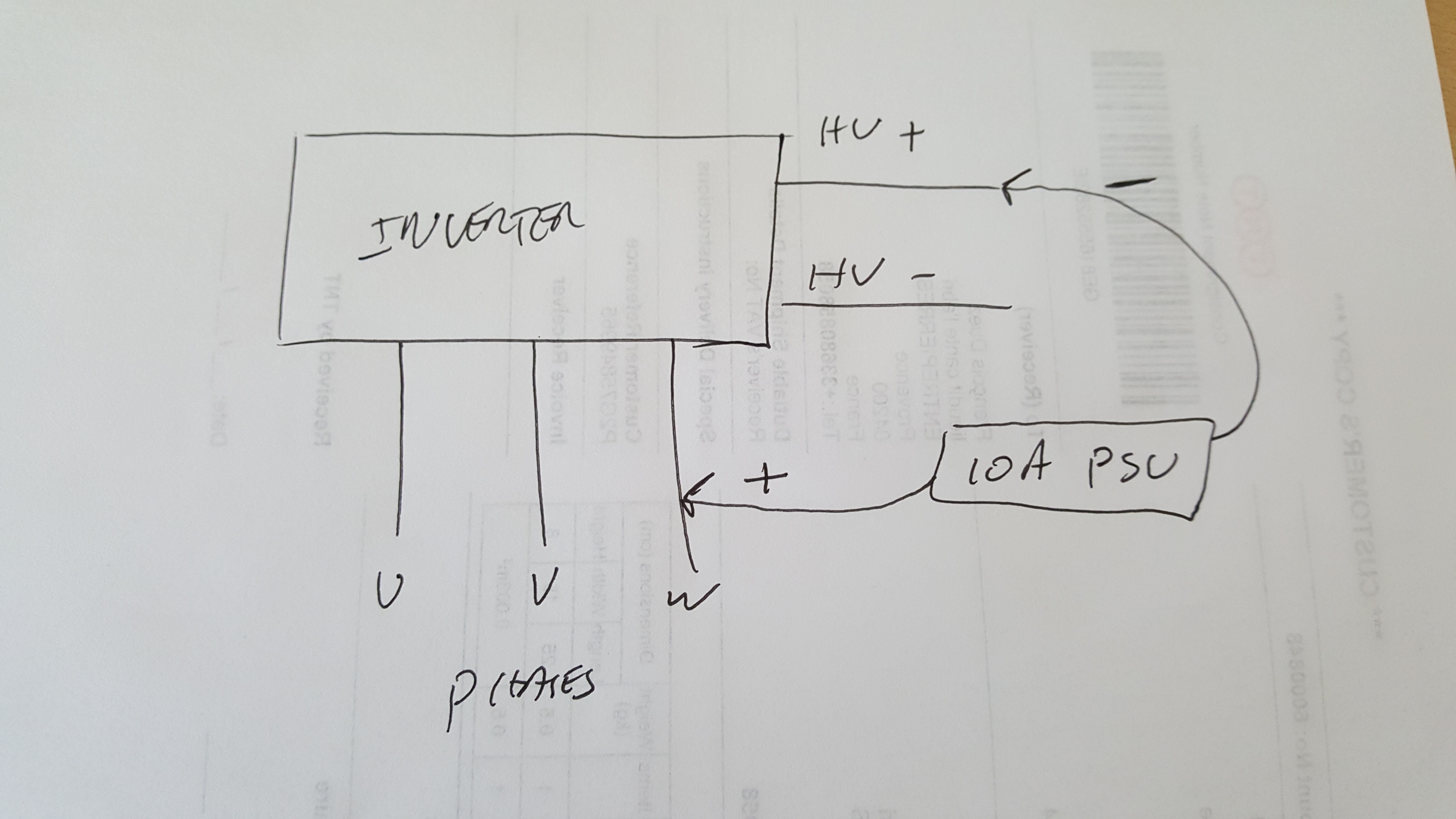

Ok don't change any of the pinswap settings. You want to inject current into the phase lead and out of the hv+.
yes, doing that. except my polarity was positive to hv positive...will go at it again
will undo any pinswap settings I mucked with.
the priustoric boatcar guy
- Posts: 4005
- Been thanked: 1130 times
Yeah you won't get anything that way as the igbt is blocking current flow. if you do it like in my drawing we push current through the parallel diode.
now I get 9.7 amps draw on all three phases, and il1 and il2 both show current draw and they graph from the two most towards the front ( the one that did not hum or draw current earlier today)

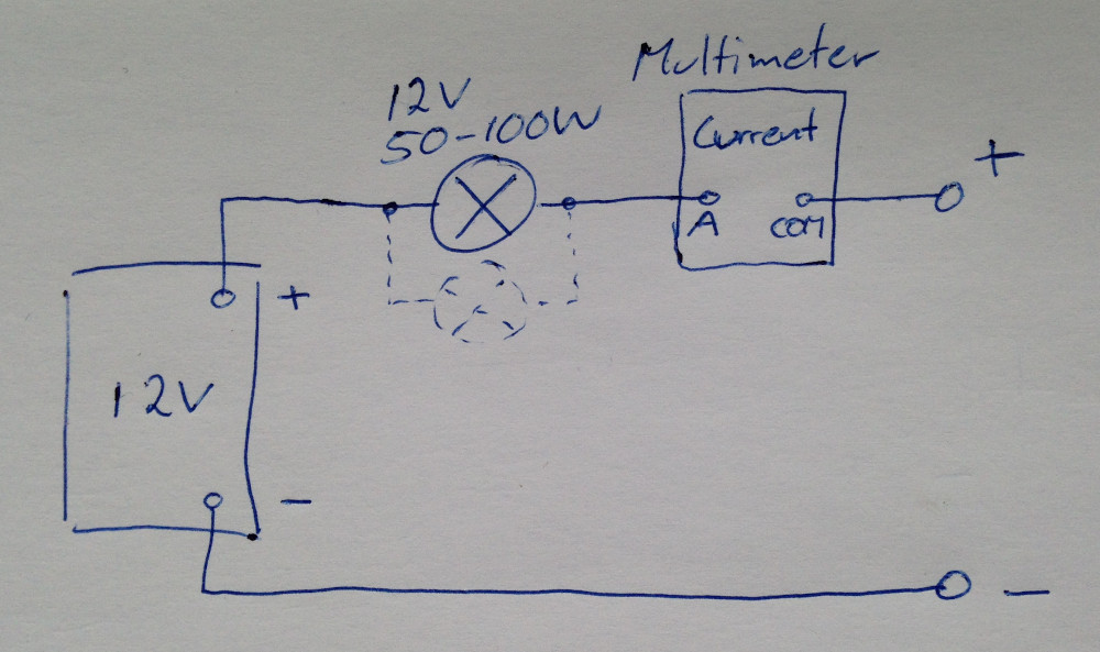

If you don't have a current limiting power supply, here is another alternative.
The best result will likely be achived with the current as high as possible. Most multimeters can measure up to 10A so a 100W lightbulb will get you close. If you don't have 100W bulb you can parallel several smaller until you measure a good current (above 5A).
The power source can be a 12V battery or a 12V power supply.
- Posts: 4005
Yeah that will work well. You only need 2 setpoints just to make sure the calibration is reasonable.

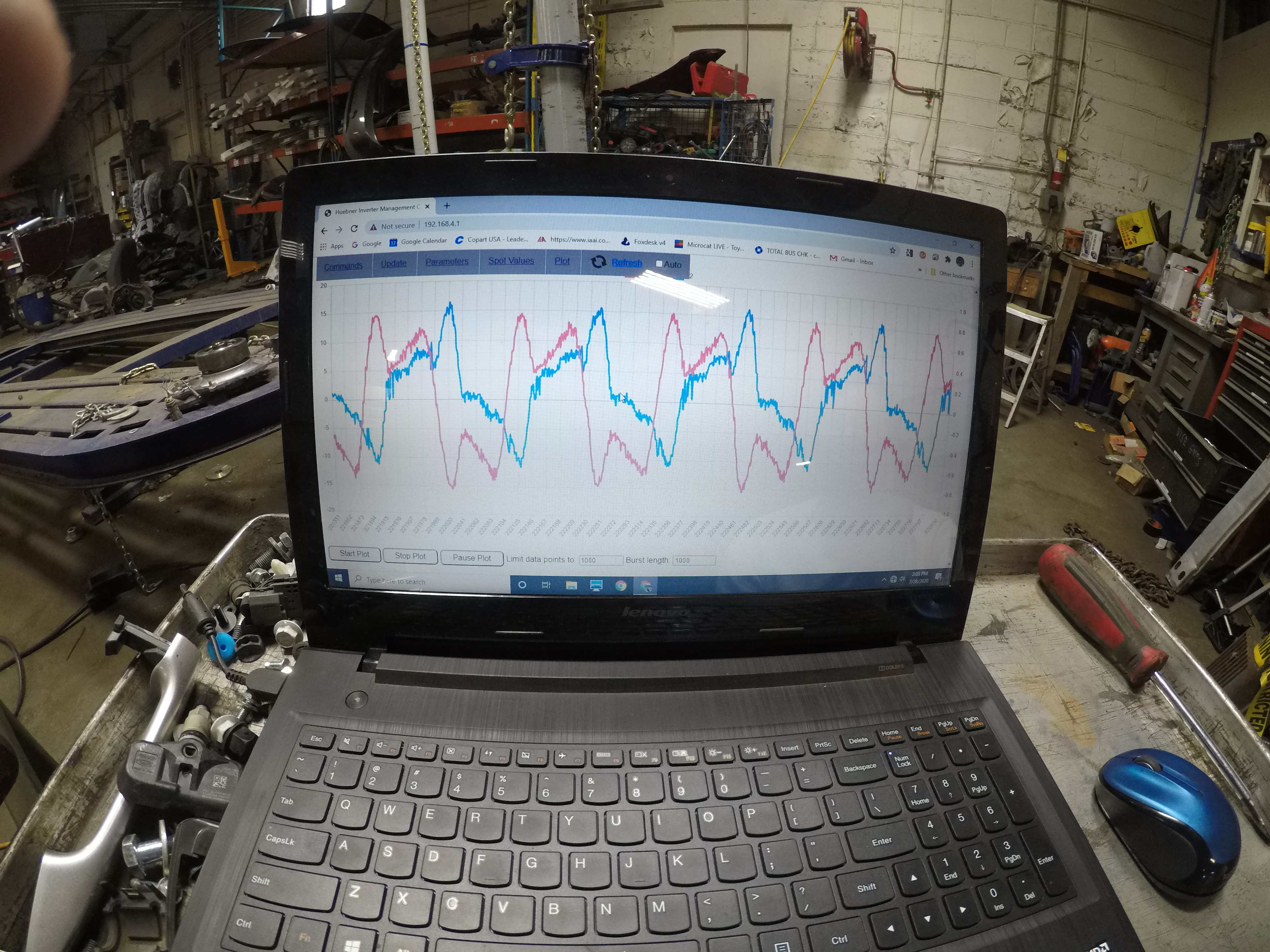

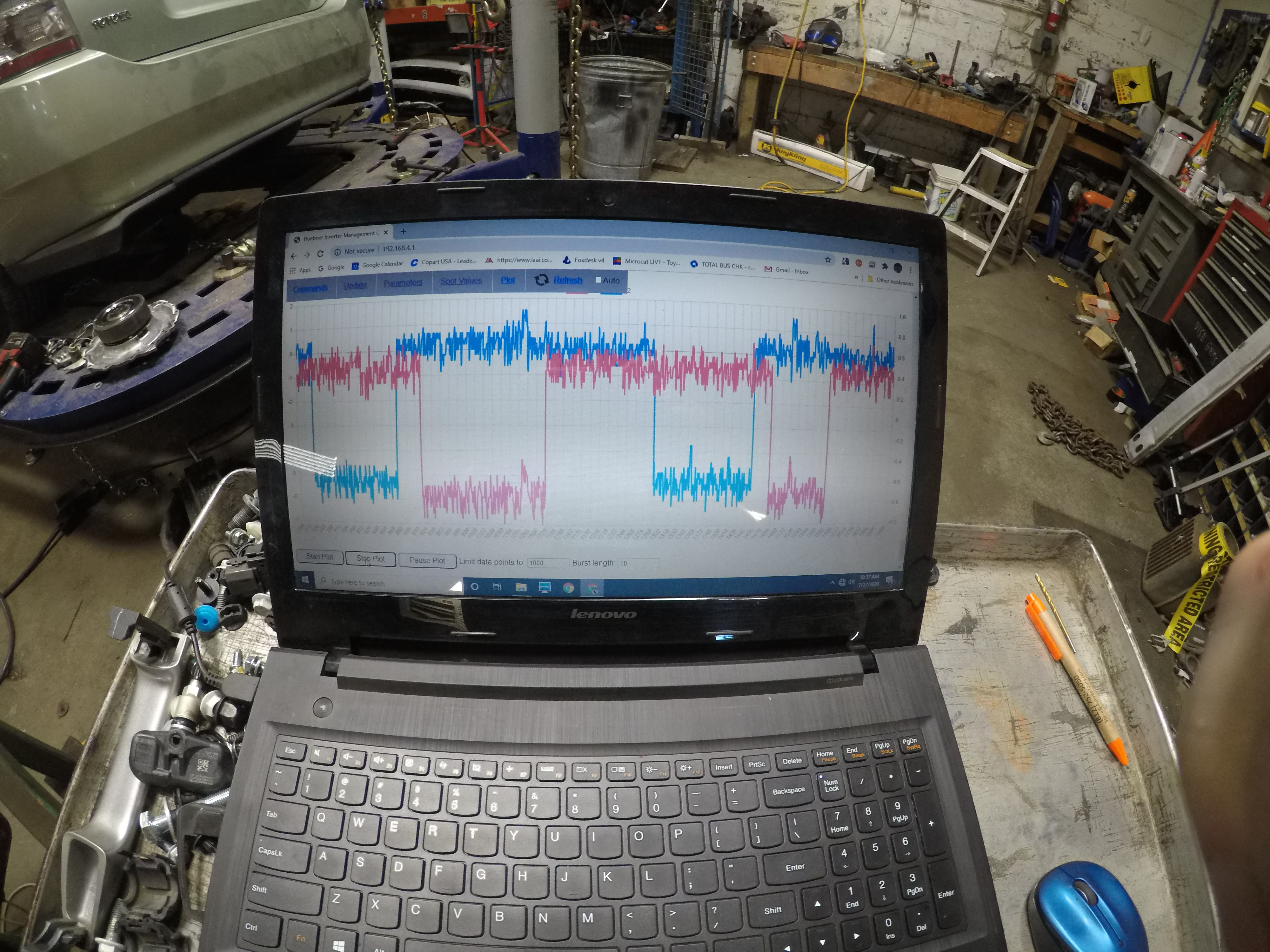

re-did my calibration at 10amps for better resolutionJack Bauer wrote: ↑Tue Jul 28, 2020 6:39 am Folks, in order for FOC to work it MUST know the phase currents with reasonable accuracy (about +/-1 amp) otherwise it won't matter what you do it just won't work.
struggling with syncoffset. when the il1 and il2 current graphs look pretty( symmetrical), then the throttle looses the ability to turn off the motor.
these photos are il1 and il2 and the first photo is id an iq
also reverse is slow or non existent.
is anybody adjusting the " boost" parameter?...oh nevermind...it seems to be one of those parameters that has been removed

So during tuning you must be in manual mode and entering values on the web interface not using throttle control.
okay, thanks for being there D will comply
