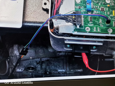

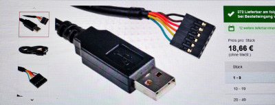

Post by nesto1972 »
Thats great,i was not sure if there is already a running software aviable.
I found this picture from the cable for the Serial monitor !
Is that right ? TLL-232R-3V3?
Regards
NESTO
Posts: 4007
Been thanked: 1139 times
Yep thats exactly what you need.
