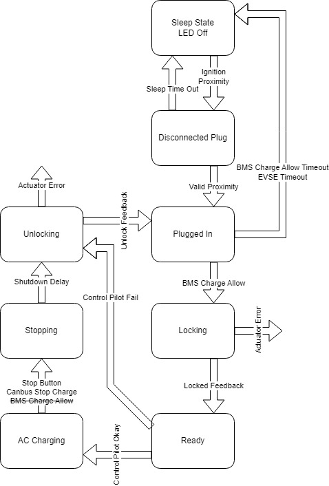

The software flow diagram I did for my AC Charge Port controller
The tricky bits are timeouts for things like:
  • No CP or Invalid CP
  • Vehicle now waking up
  • Vehicle not accepting charge
  • Errors not healing
  • End of Charge

Basically yes, at least this is the plan. The sequence need some refinement, e.g. what means (3) in detail, and which signals carry which values in these steps. Not all is implemented at the moment.
1. Plug-in is detected with PP, and clara provides the PP resistance and PP current limit.
2. Clara measures the CP PWM, and decides for AC in case of valid AC range. DC at the moment runs in parallel, just using the PLC. No check for 5% PWM at the moment.
3. For AC charging, clara receives the AcObcState, which demands the Locking (not yet routed to the lock motor), the StateC (working), and the LED (working).
4. CP stateC see 3.
5a to be refined
5b Clara receives AcObcState with an other value than CHARGING, and switches to StateB. Is implemented.
6. Unlock: to be refined.
7. Unplugging is signalled via cableCurrentLimit=0, but Clara does not use it internally. To be improved.
8. As 7.

tom91 wrote: Thu Feb 08, 2024 9:44 am Does the Clara do the follow:
1. detect plugged in
2. determine the CP signal is 5% pwm for DC or above for AC
3. recieve request to charge or verify okay to start
3.lock motor
4. Enable EVSE via CP pull down
5a. stop because EVSE stops, info via CP
5b. stop because EV requests stop via CAN (or however this is implemented) Clara drops CP
6. Unlock unless there is an inhibit unlocking in place (via CAN I would say)
7. Plug removed
8.reset charging session assumptions and wait for plug detected.
No expectation regarding the AC development just a quick thing to consider:
I would add to the list that there is a mode "charging paused for vehicle ventilation". A lot of cars with 22+ kW AC Charging use this. I think in muehlpowers file it is also referenced. My car does use this quit often when it starts the compressor while AC fast charging.
