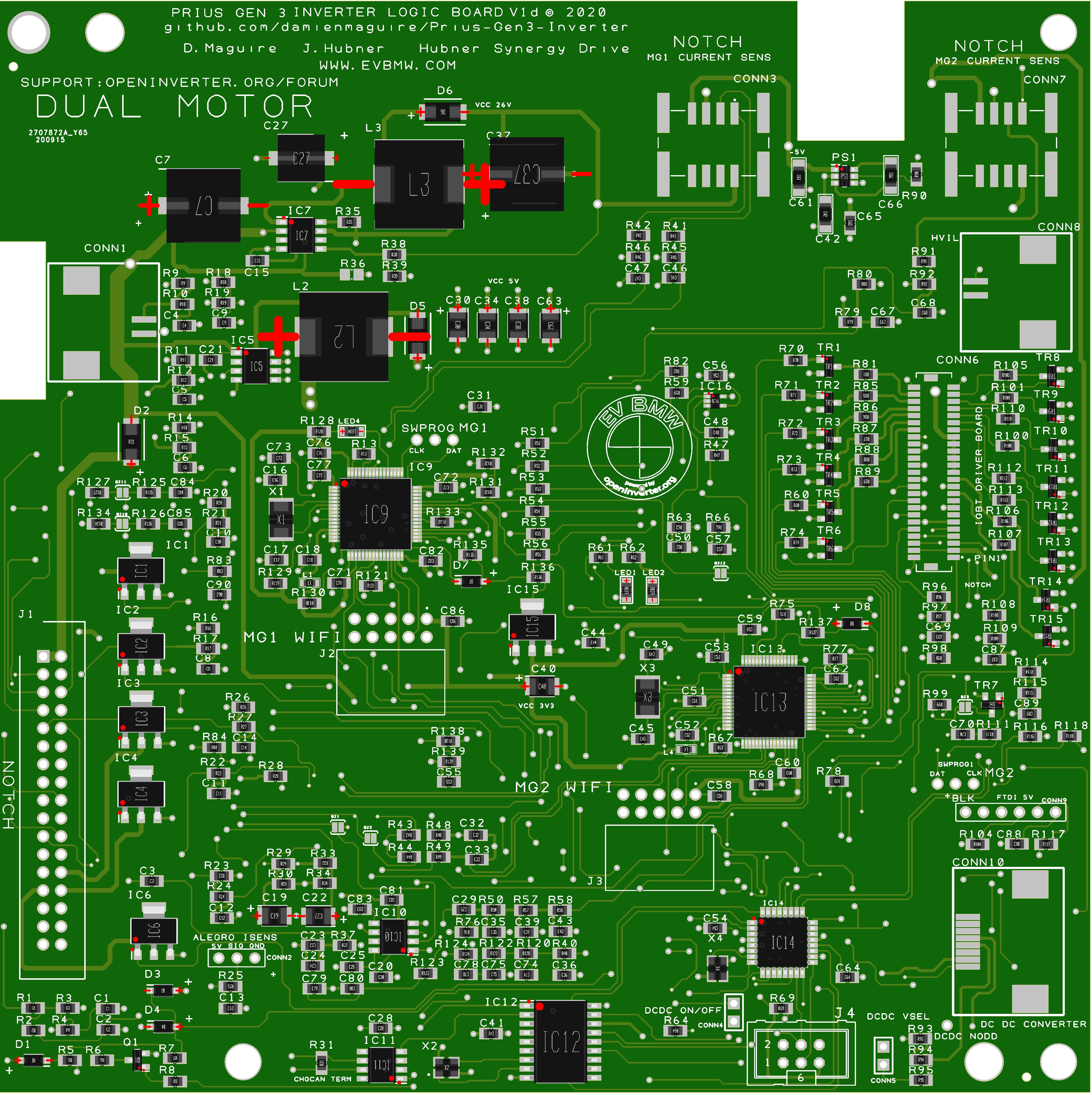

So just to let folks know we do have a V1d version of the logic board on the way with the following additions :
-Second STM32 for running MG1 and MG2 in dual motor applications.
-MG1 cpu is slaved to MG2 via transcieverless CAN : https://www.mikrocontroller.net/attachm ... AP2921.pdf
-Dual wifi modules
-External connectors will remain the same with a few pin remaps.
-Buck / boost charge retained.
This will be sold as separate kit. V1c will remain available.

Transceiverless CAN, thats really cool. So will you pre-program devices with things like pot already mapped?
- Posts: 3666
- Has thanked: 12 times
- Been thanked: 351 times
Yeah for the full kits I'll configure both stm32 to communicate. Mg2 will send things like start, direction and throttle to mg1.

Wow! Would it be possible to implement a sort of electronic differential drive with both motor interacting on torque output? We could have a sort of a torque converter drive similar to Volt/Ampera system where both motors are spinning to relieve traction motor of higher RPM losses. I am not sure where this would be used yet but it is really cool!Jack Bauer wrote: ↑Fri Sep 11, 2020 4:29 pm Yeah for the full kits I'll configure both stm32 to communicate. Mg2 will send things like start, direction and throttle to mg1.

If I understand and what you are asking correctly, two separate motors driving separate axles, then You have torque vectoring. drive like it’s on rails around corners. it would significantly improve handling. add in input from a yaw sensor and steering wheel angle = a very awesome awd system.arber333 wrote: ↑Fri Sep 11, 2020 8:29 pmWow! Would it be possible to implement a sort of electronic differential drive with both motor interacting on torque output? We could have a sort of a torque converter drive similar to Volt/Ampera system where both motors are spinning to relieve traction motor of higher RPM losses. I am not sure where this would be used yet but it is really cool!Jack Bauer wrote: ↑Fri Sep 11, 2020 4:29 pm Yeah for the full kits I'll configure both stm32 to communicate. Mg2 will send things like start, direction and throttle to mg1.
or more related to driving the Prius trans axle?

V1d dual motor initial schematic attached.
- MG1 STM32 has no inputs other than CAN from MG2 STM32 for control.
One concern I have is I am reusing the bias circuit from the mg2 resolver for the mg1. I THINK it will be ok but ....
A fault in either mg1 or mg2 power stages shuts down both mg units.
MG1 and 2 disabled during charge.
Single TDA2822 used for both resolver exciters. One side for each MG.
Single 3v3 reg using AMS117. I THINK it will be ok but ....
PriusG3_V1d_dual - Schematic.pdf
- (697.15 KiB) Downloaded 421 times

Really good management of resources JB! Could we use this single CAN bus to disable MG1 (or put it in freewheel mode) if it would not be needed?Jack Bauer wrote: ↑Sun Sep 13, 2020 9:40 am Single TDA2822 used for both resolver exciters. One side for each MG.

And....here it is. The V1d now with 3 mcus on board:)
The program for release is :
*PDFs of schematic and pcb layout public now.
*Source files only available on Patreon for a period of time. Probably 6 to 12 months.
*Once bench tested both partial boards and full kits will be available from the webshop.
*Once bench tested a Yaris/Auris variant will be released in the same way.
PriusG3_V1d_dual_3D.pdf
- (197.37 KiB) Downloaded 343 times
- (697.1 KiB) Downloaded 397 times
PriusG3_V1d_dual - PCB.pdf
- (472.73 KiB) Downloaded 467 times

V1d design updated and released on github:
https://github.com/damienmaguire/Prius- ... master/V1d
Prototypes on order from JLCPCB.

Now in production at JLCPCB:)
