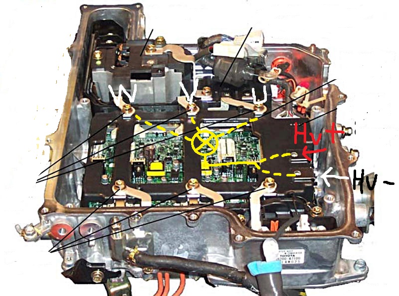

I think, at this stage, ignore the current sensors for now, and just make sure you can get PWM and drive a motor. Johannes' solution will be the most likely to work, but there may be simpler ways, but this isn't what's holding you back (yet) :-)
MattsAwesomeStuff wrote: Thu Apr 21, 2022 8:46 am
[*]You should now be getting pwm from the board pwm outputs. Ideally check with an oscilloscope, but a multimeter should be able to see 'something' happening (maybe also read frequency)
Well, something is happening.
However, my HVDC is fluttering all over the place. It was at 100v, but it's fluttering between 5v and 50v. This is right off the variac's supply's DC terminals.
It's only a 3amp variac, and my smoothing cap is only 47uF (what I had around), so, maybe this is suffocating the smoothing capacitor a bit? Shouldn't be, the inverter's main power cap should basically be in parallel with it, no?
Do you have the pwm lines from the OI board connected with the inverter at this stage? I was aiming to check the OI board outputs with the inverter (and HV) disconnected) But either way...
Are you reading voltage with a multimeter or is that from a built in voltage reading on your supply? You may find that EMF from the inverter does some interesting things (touchpads on laptops can be quite susceptible and behave strangely sometimes while the inverter's switching :-) ) With no current drawn from the HV supply, there should also be no voltage drop, no matter the capabilities of the supply. And yes, the main cap should be doing plenty to smooth any draw.
The inverter should only switch if it has power, you're sending PWM to one of the motor inputs (MG1 or MG2) and you're sending 12V to MG1 or MG2 (or both) enable pins - 14 and 25 on the 32pin connector I believe.

I think you're nearly there,and might get light bulbs 'spinning' (or the motor of course) with a bit more ampnom. I'd aim for a low frequency (the slower it is, the easier it is to see the 'spin'), and gradually increase ampnom. I don't have exact numbers for you, as I didn't use lightbulbs and went straight onto a hacked up alternator motor, and on a different inverter... but with a 24ish V 'HV' bus (two car batteries in series) and think I was getting movement around 10 - 20 ampnom. But it will depend on the inverter, your HV bus voltage, what lightbulbs you're using... try changing ampnom and seeing what happens. Worst you can do is max out your variac :-)

Variac --> FWB --> Smoothing cap --> Output terminals.
Multimeter is on the output terminals.
I get a steady 100v on the multimeter until I turn on the inverter, and then it's anywhere 0-50v jumping all around. Leads for the multimeter are kinda draped across the inverter though.
Parallel? Connect the filament bulb in series with your HV. With no current through it, there'll be no voltage drop across it, and it won't light. If lots of current flows through it (short circuit, fault, trying to drive a motor etc) voltage drop across it will increase, limiting current (hopefully preventing any damage) and it will illuminate (a nice visual feedback of 'current flowing').
I had 3 lightbulbs connected in delta across the phase outputs.
This is a 4th lightbulb that I connected in parallel across the HVDC for 2 reasons:
1 - just as a visual indicator of what was happening to the voltage (which, suddenly measured 0-50v and constantly wandering instead of 100v). If it was flickering or fluttering or pulsing, I'd know that something funky was going on with the inverter choking out the variac.
2 - As some form of steady load smoothing, in case the capacitor was acting up. It's 60 watts of load that doesn't change.
Instead, the bulb stayed lit steadily, with no apparent change when I'd turn the inverter on or not. The voltage on the multimeter kept fluxuating.
As did the voltage on the phase outputs.
Yes, bulbs should work fine. I guess they're a good visual, and naturally limit current, so a good test (compared to a motor, which does nothing until it suddenly starts spinning and throwing itself around the bench... good point :-) )
Too late, motor's hooked up anyways, not room for both on the bench and I don't really want to pick the motor up twice.
I'm confused about how to use the lightbulbs to test this.
Earlier you said that no power draw, with the lightbulbs connected, was good. How do I test with the lightbulbs connected, and what should I expect them to do?

I don't think I'm losing PWM signal. I think it's just not sending any power.
When I turn on the inverter, I get what I presume is PWM down the output-to-motor phase wires, fluctuating voltage.
But, in lack of anything better to try, won't hurt to try.
I suggest you test this with boost 0 and fweak 100, ampnom 1, fslipspnt 1 so that you get a nice 50/50 square wave. Then test on board before it goes into the transistors (don't know the schematic by heart) you should see 1.65V on the 3 PWM lines PWM1H, PWM2H, PWM3H.
Github for project: https://github.com/damienmaguire/Prius-Gen-2-Inverter
PCB: https://github.com/damienmaguire/Prius- ... %20PCB.pdf
Looks like the 3 resistors would be an easy place to poke a multimeter lead.
I'm testing... voltage?
AC or DC voltage?
Between those 3 points on the PWM line and... Ground? 12v? Each other?
See how many ways there are to get this simple instruction wrong? :P
I presumed I'd be testing AC voltage, between ground and the edge of the resistor. But, I got zero. DC voltage, zero. I also tested zero volts on the motor phase wires.
I cranked the Ampnom to 100, and on DC volts I measured 0.36v between the transistor legs and ground. And the usual waffling about 0-50v between motor phase wires. Measuring AC volts got zero.
If instead I was supposed to test on the phase output pins (the terminals that you connect to the inverter harness), with ampnom at 1, those test 14.9v to ground, and 3.6v to the 12+ rail (on a 11.3v supply). Same deal but if I crank ampnom to 100, those terminals to ground are now 7.34v, and to 12+ rail 3.98v. This is all DC still. On AC, they test I think 15.9v to ground.
Behind the transistors I think you should see 15V/2 so about 7V.
Well I did get a 7v DC signal on the output, but with ampnom at 100 and that's the transistor output, not the before the transistor, so I don't think that counts.
If it gets that far and the inverter isn't outputting anything you either have a bad connection to it or MSDN (MG2)/GSDN (MG1) isn't pulled to 12V
Well, I connect the 12+ rail to pin #25. Which is right below pin #9 (the first of the phase wires for MG2). It's right there.
I dunno, here's more idiotproofing, photos of my janky setup for everyone following along at home:
I also connect FLT to pin 27 (fault signal MFIV). Which, I think throws a fault if you disconnect it, rather than connect it?
I suspect it's not hardware, I'm doing something wrong, there's just not an easy way to find out what obvious thing I've done that someone with better context would not have done.

Ahh, the *other* side of the resistors. See, Johannes specifically said: "Then test on board before it goes into the transistors". He obviously meant as it came out of the blue pill, not after the resistors. Smart people can forget how to be as dumb as the people they're helping :p. So, I tested on the traces immediately before the transistors. Lacking understanding, I can only be as literal as code.
I knew that digging up the board layout and posting a precise diagram would come in handy.
The *other* side of the resistors... Measured 1.55v-1.63v when 'ampnom' was at 100, it's a little lower, around 1.50v when ampnom is at 1.
So, I guess, hurray, my software works, bluepill isn't fried, and PWM is getting out of the machine.
I'm not even sure where my scope is, I haven't used one without a copilot since I was a teenager. Would an audio cable and a detailed sound recording from Audacity work at these frequencies? [Umm, lemme just try frying my audio card... ... answer is... I have to turn my mic recording level down to 1%, so, it's probably really not happy with me... but... "Yes"]
Same clip, just 4 different zoom levels. This is just one of the phases.
So... does that help diagnose what it is?

960-980Ω
The schematic: https://github.com/damienmaguire/Prius- ... ematic.pdf
Indicates 1k ohm resistors, which I used, and confirms measurements:
And in other news, I found this on the same page:
So, those are all on this board, and I populated them. So maybe that was spec'd on an early assumption and they're wrong?
are the transistors soldered the correct way around? (They don't match the silkscreen, but there was an errata on this I think?)
Short answer: yes.
I soldered them to match the silkscreen. There was no documentation linked about it other than to have read every post in this thread where it was noted that there was an error, but yes, the silkscreen is a typo. So I tried to desolder them but it was lifting pads so I stopped, cut the legs half way, and flipped the transistors and soldered them back on correctly. Including one leg that sheered off right at the black part, which I kind of got solder to hold and then glooped bondo onto because of how fragile it was (what I had at the time).
Possible the transistors could have failed too I guess, but unlikely.
All 3?
Another leg should connect to ground.
Confirmed, zero Ω.
With the OI board and inverter powered up with 12V (but not running), you should get ~12V (referenced to ground) on the remaining leg, which should be the one that goes to the inverter U/V/W pwm inputs.
Confirmed, ~14.88v on each transistor (with 11.3V as the power rail).
You should be able to see pwm on these pins too (while the OI board is running) - not with your sound card, it'll clip. I guess you should see ~6V on a multimeter?
Confirmed earlier. I need to crank ampnom to 100 but I got 7.34v to ground (3.98v to the +12 rail).
Actually, trying again now, worked fine with ampnom at 1, still got 7.34.
And there I am, testing U, V, and W phases, and when I get to the third one, I hear a "tunk" sound, and then my power supply is plummeted from 100v to 3.2v and from 47mA, to 1000mA (it's max).
I move a bit and the power supply goes back up. I poke the phase again,"tunk", and the power supply plummets. WTF.
- I poke around at the transistor I was testing, wiggling it, seeing if there's a bad connection... not that that would explain the other 2 phases not working, but... no. No change.
- I quickly rig up my Variac supply, hoping I'd be able to see the motor move, I leave a 60w light bulb in series just in case. ... Nothing happens. I poke around at that phase line, nothing happens.
- I switch back to my power supply. Nothing happens. I poke, nothing happens.
- I start jiggling wires. Every time I bump the Forward wire, powersupply gets loaded down. It's a brand new jumper wire, but okay. I replace the jumper wire with a gator clip, much more solid. Nothing happens. I replace the pin that goes into the 12+ supply, nothing changes. I replace the pin that goes into the Forward terminal, nothing changes. I leave it disconnected and connect it after booting. Nothing changes. I switch back to the janky jumper wire, wiggle it a bit... power supply loads down. WTF? It *requires* a questionable wire?
- I leave the room for 5 minutes. I leave things running, same as I have for hours at a time before. It's all current limited.
- When I get back I smell burnt electronics. Oh no. Oh god. What happened? What did I ruin? I shut it all down. I sniff around everything, but everything smells a tiny bit burnt, but not a lot. I look around for burnt components, don't find any. But the burning smell is getting stronger. Where is it coming from? Is something on actual fire? What's smouldering? It's actually strongest next to the motor... which had at most 3 watts through it.
False alarm.
It's a USB powerpack with a damaged cell that I was recharging normally using the cable after pre-charging to where it would recognize it. 7 hours ago. It was on the far side of the motor. Apparently it chose that moment to just... melt that transistor. Cell is actually fine, the charging board just crapped out. What are the odds?
- I leave put the questionable wire back on, and try again. Won't work at all anymore, no matter where I poke or wiggle. Great, I've ruined it.
- I bump the board with my hand... power supply loads down. I bump it again, power supply loads down.
- I switch back to my variac, set ampnom to 1... nothing. Set my ampnom to 1.1? Loads the variac down to 60w (bulb in series). "Tunk" sound is coming from motor when power is applied. Sometimes I can hold it in the sweet spot for 10 or 20 seconds.
- O... Okay. I recheck all the wires. Nothing's out of place or loose. I try plugging and unplugging each wire one at a time, nothing changes.
- I disconnect the light bulb limiter, and tap the power lead a couple times. Some things are hissing (variac brush maybe? relay maybe)? Nothing's moving, my Kill-A-Watt is slow to respond but I saw it at 1488w and I'm sure it was higher. That's 12A on a 3A variac, so, I didn't do that much. In retrospect I guess this was slamming the inverter's capacitor since I'd hardwired the run relay and precharge wasn't gonna protect me. Motor never spun though.
- While on 60w limited, I think the voltage was around 88v instead of 100? I get 0.4v across the phase lines, for whatever that's worth.
- I still haven't figured out what there is about smacking the board that makes it connect, but I guess the next step for me is to scrap these jumper wires and wire it up more solidly. I didn't get a wiring harness with my inverter, so, I kinda need one side of them anyway to connect to the inverter, but, maybe I'll cut the jumper end off one, strip it, and actually screw it into the terminals on the control board side.
... And then maybe try a car battery as my HVDC? See if I can get the motor to spin at all?
It's progress of a sort, anyway.

johu wrote: Thu May 05, 2022 7:23 amConnect 12V to the DC bus, pull MSDN (for MG2) to 12V and connect a 12V bulb between DC bus positive and any of the three phases.
So that I don't misinterpret, to be clear, someone please confirm this is exactly what I'm testing:
... and, that will work with no control board? Just wiring the bulb between the phase output and 12v+?
Now it has to light up if you wired up MSDN, control ground, and inverter logic power correctly. No point in trying anything else if this does not work!
What about the inverter fault wire?
- 12v+ to i9
- Gnd to i9
- Gnd to pin 16 in i10
- 12v to HVDC+
- GND to HVDC-
- Bulb to phase output and 12v+
IF this worked, connect the 12V bulb between DC bus negative and any phase and pull the according control signal low.
- Where is the according control signal? Like, pins 9, 10, or 11 on the 32-pin i10?
- How do I pull it low? Connect straight to ground?

Right at the start of experimenting with this inverter, I simplified.
Lacking a mating half for the 32 pin connector, I did what Damien did and separated the loom into one for the inverter IPM (intelligent power module) and another for the buck/boost IPM. I now had individual wires I could extend as needed to connect to my development board and could ignore the buck/boost entirely.
I had to go back to the Prius manual to work out what you were referring to.
The two pin connector (I-9) with red/black wires is an ignition feed and ground. Power that from a 12v bench supply. I shall refer to this as the system supply.
You don't need the bus capacitor for this test, so just remove it.
Connect a seperate power supply, sufficient for powering the indicator bulb you itend to use, to the HV+ and HV- terminals direct. I shall refer to this as the bus supply.
It's helpful if you use the connection names and/or function, as well as the pin number.
MSDN, motor (MG2) shutdown, Brown wire, pin 1 on the IPM, or pin 25 on the 32 way I-10 connector. This needs to be connected to +12v on the system supply.
Connect your inidcator bulb between one of the phase terminals (U, V, or W) and HV+ on the bus supply. By default, the lower transistor in each half bridge is on when the IPM is enabled, so the bulb should light on all three phases.
Find the PWM signal for each phase, these are;
MUU (Blue/Black) pin 18 on the IPM, pin 9 on I-10
MVU (Blue/Yellow) pin 19 on the IPM, pin 10 on I-10
MWU (Yellow/Black) pin 20 on the IPM, pin 11 on I-10
The second letter in the designator indicates which phase it corresponds to.
The voltage on these connections should be similar (or I recall a little higher) than the system supply. This is the internal pullup.
For whichever phase you have the indicator bulb connected to, connect the corresponding PWM signal for that phase to system ground.
The bulb should go out, but if you swap the bulb connection from HV+ to HV-, it should light again.
Repeat for all phases.
