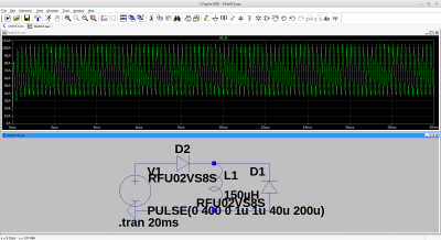

- Posts: 6772
- Has thanked: 385 times
- Been thanked: 1595 times
Gotta say 150uH sounds implausible as the Leaf inverter runs at 5 kHz PWM frequency. 150 uH would not be able to smooth that out at all and you'd have enormous ripple currents:

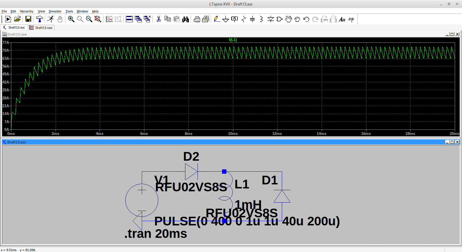

And here's what 1mH looks like

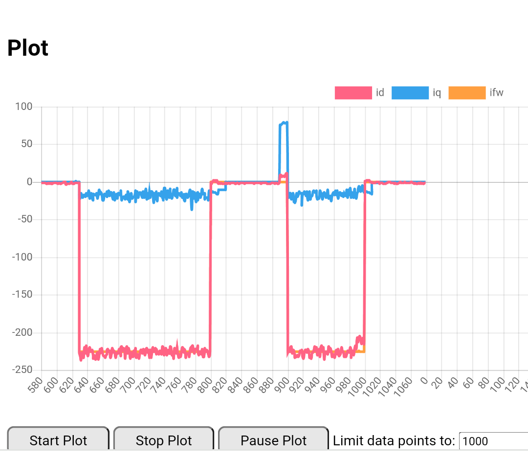

Agree, although trying to keep an open mind on it at the moment. The ripple on the 150u plot is just about on the limit of what I'd consider acceptable, and that is with 400V? It might explain some of the nuisance trips at low speeds though?
Edit - maybe a little bit over acceptable!

Motor measurements done
Not the best measurement method but I decided that trying to rotate the motor via the driveshafts, diff and gears to try and find the optimum q and d positions wasn't going to work (too much play, too much cogging and the (small) risk of a back emf killing my LCR bridge if it moves too quick). Instead the motor was left stationary and I just measured all three combinations of connections (one side of the bridge to one phase connection and the other side of the bridge connected to the other two phases shorted together). The results were:
Phase 1: L = 305uH, ESR = 95mR
Phase 2: L = 310uH, ESR = 91mR
Phase 3: L = 171uH, ESR = 70mR
These were pretty consistent measured at 100Hz and 1kHz but the inductances dropped by around 15% and the ESR increased to over an ohm at 10kHz. 10kHz is pushing it a bit for the test setup so I'm going to ignore that measurement. The change in ESR for phase 3 shouldn't happen so I'm guessing the bridge isn't doing a perfect job of separating the L and R components. It's close enough for now though.
From this I'm going to guess that phase 3 is aligned for Ld and the other two are therefore 30degrees out for Lq and so a bit low. Without doing any sums at all I'd guess at real values of:
Ld = 171uH
Lq = 350-400uH
Now this is with zero current, with a couple of hundred amps Lq will drop a fair bit, Ld less so (for -Id as it's opposing the magnets so reducing core saturation) so the values I'm going to use for simulation are:
Ld = 160uH
Lq = 300uH
Now this is all starting to make me wonder whether the difference between motors that no-one seems to be able to get to work (like the MGR) and motors that do seem to work (Leaf, Outlander rear) is the inductance. Based on limited simulations to date it looks like low inductance motors generate reasonable torque at both low speeds and high speeds relatively easily. High inductance motors generate torque at low speed and can be made to spin to high speed but not do both at the same time (high inductance means that the wLI terms get too big and limit the current, and so torque, at higher speeds). Need to spend a bit more time on the simulator to confirm this. Could also do with a few more inductance measurements for other motors too.
I'm also going to see if I can find, or get hold of, a 300uH inductor, just to check that the LCR bridge is telling the truth at that kind of inductance value as these results are lower than I was expecting!

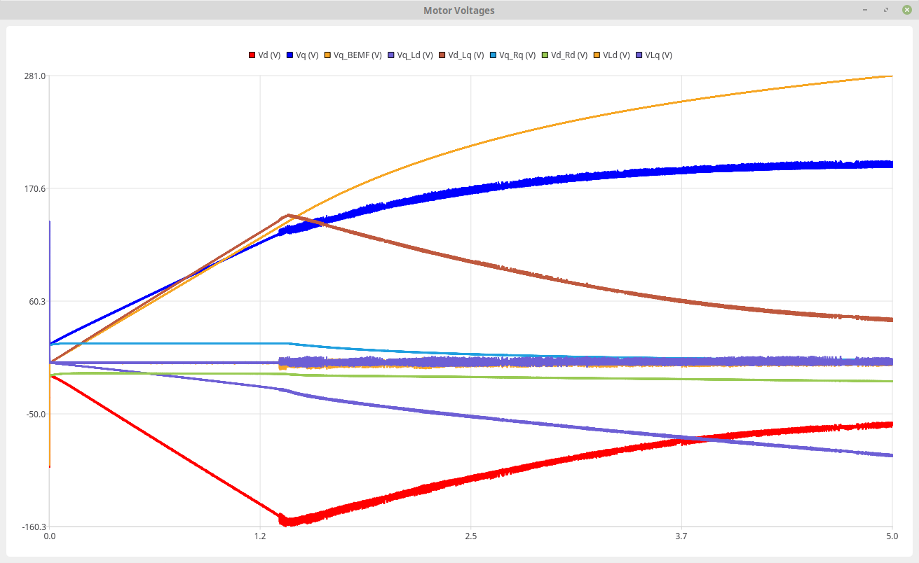

This may all be starting to make some kind of sense now
I think the simulator is now a fairly realistic model (it still doesn't do anything about core saturation but can live with that for now) and we have a better handle on motor parameters. Today's plan is to try and put the two together and see if it is possible to reproduce the behaviour seen on different motors.
I'm going to split motors into two groups for the purposes of this. A low inductance group (Outlander rear, Leaf (debatable depending on which numbers you believe?!)) and high inductance motors (MGR, Prius, basically anything with a boost converter that normally runs at higher voltage). My current theory is that the Toyota motors (particularly the smaller ones that need to make maximum torque to be usable) need the higher boost voltage to work well at high rpms - it will be interesting to see if the simulator results back this up or not!
Low inductance motors will use 160uH and 500uH (compromise between Outlander an Leaf values).
High Inductance motors will use 4mH and 6mH (this is from memory - sure someone measured it, can find the post detailing how to do itviewtopic.php?p=28905#p28905 but not the actual measurements
Edit - spoke to soon, still need to figure out how exactly to model the permanent magnet flux linkage. In particular do I need to modify the value used in the equations based on -Id or do the mathworks equations just take care of it. I would have thought the later should be the case, especially as I can't find any equations for modifying the flux linkage in papers
Going to have to add another plot to give better visibility of what's going on inside the model to try and figure it out. If anyone has come across any good reference material on this subject links would be appreciated.

tell me, is it possible to discuss the increased heating of the controller and large battery currents for the motor without load when the FW or lqminusld is turned on, or is it better to create a separate topic? this problem appeared with the new firmware.
evil neodymium
- Posts: 1801
- Has thanked: 102 times
- Been thanked: 350 times
Really need more data (csv log or plot capture) to comment but I'd guess that it might be this viewtopic.php?p=45686#p45686?
If it is then a momentary small throttle opening following deceleration would reset Iq and Id and remove the current.
- Posts: 1801
Starting to make sense again, just for reference here is a plot showing what the individual contributions to the motor voltages are:
Vq_BEMF is the back EMF generated by the turning motor, if it gets above battery voltage (~175V) the motor is above base freq.
Vq_Ld and Vd_Lq are the voltages generated across Ld and Lq by Id and Iq when the motor is turning (actual term is wLI so are proportional to speed). They are mostly a pain (these are what limit the performance of high inductance motors) but Vq_Ld is useful to produce field weakening. You can see its effect starting to come in as FW increases -Id at around 1.4sec.
Vd_Rd and Vq_Rq are the voltages dropped across the DC resistance of teh windings.
VLd and VLq are the residual voltages left after the above are subtracted from Vd and Vq that appear across the inductance and produce current change in the windings.
At the moment all the control loops are barely stable so they are the next thing to work on.
Vd and Vq are the same as on previous plots and are what are seen on the motor terminals (after the Park, Clarke translation). The rest are the voltages generated by the individual terms of the model equations:Vq_BEMF is the back EMF generated by the turning motor, if it gets above battery voltage (~175V) the motor is above base freq.
