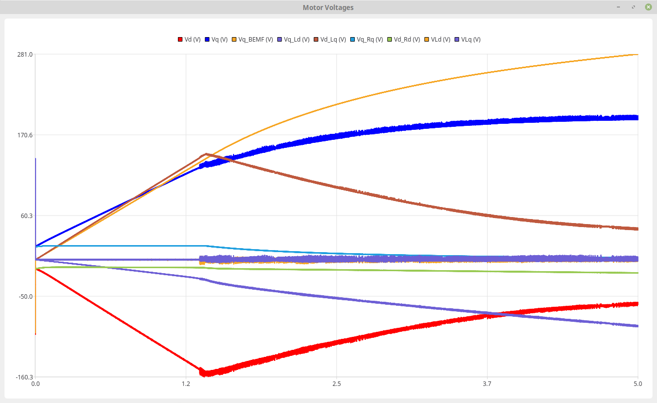

Posted: Sat Oct 22, 2022 11:10 am
by Pete9008
Starting to make sense again, just for reference here is a plot showing what the individual contributions to the motor voltages are:
Vd and Vq are the same as on previous plots and are what are seen on the motor terminals (after the Park, Clarke translation). The rest are the voltages generated by the individual terms of the model equations:
Vq_BEMF is the back EMF generated by the turning motor, if it gets above battery voltage (~175V) the motor is above base freq.
Vq_Ld and Vd_Lq are the voltages generated across Ld and Lq by Id and Iq when the motor is turning (actual term is wLI so are proportional to speed). They are mostly a pain (these are what limit the performance of high inductance motors) but Vq_Ld is useful to produce field weakening. You can see its effect starting to come in as FW increases -Id at around 1.4sec.
Vd_Rd and Vq_Rq are the voltages dropped across the DC resistance of teh windings.
VLd and VLq are the residual voltages left after the above are subtracted from Vd and Vq that appear across the inductance and produce current change in the windings.
At the moment all the control loops are barely stable so they are the next thing to work on.
