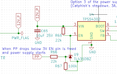

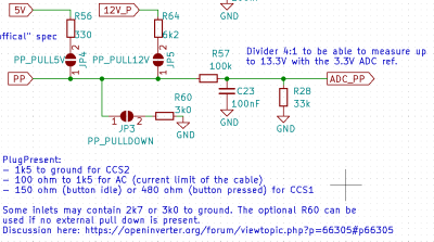

I started working on PP enable logic.
I modified the power supply. Formerly EN was floating meaning always on. I have now connected a CJ431 reference that will disable the power supply when PP voltage rises above around 3V (can be changed with the resistor values).
To allow for this to work I added an optional PP pull-up to permanent 12V
I tried to use resistor values already used elsewhere. To restore default behaviour R66 must be removed or we add another solder jumper
Next step would be a high-side driver (aka PMOS) that Clara can enable to power up or trigger the other devices needed for charging. And a GPIO to the EN pin (with diode!) so that Clara can control its own power

How would you go about having multiple wake up methods for the power supply? Like a hold from the Micro itself?
- Posts: 6766
- Has thanked: 383 times
- Been thanked: 1585 times
Re: Develop a QCA7000 board?
Connect a uC pin to EN via a diode. Diode because otherwise the body diodes in the uC would inhibit turn-on. Since EN is pulled up the only thing the micro can do is pull it down, i.e. shut itself off.
