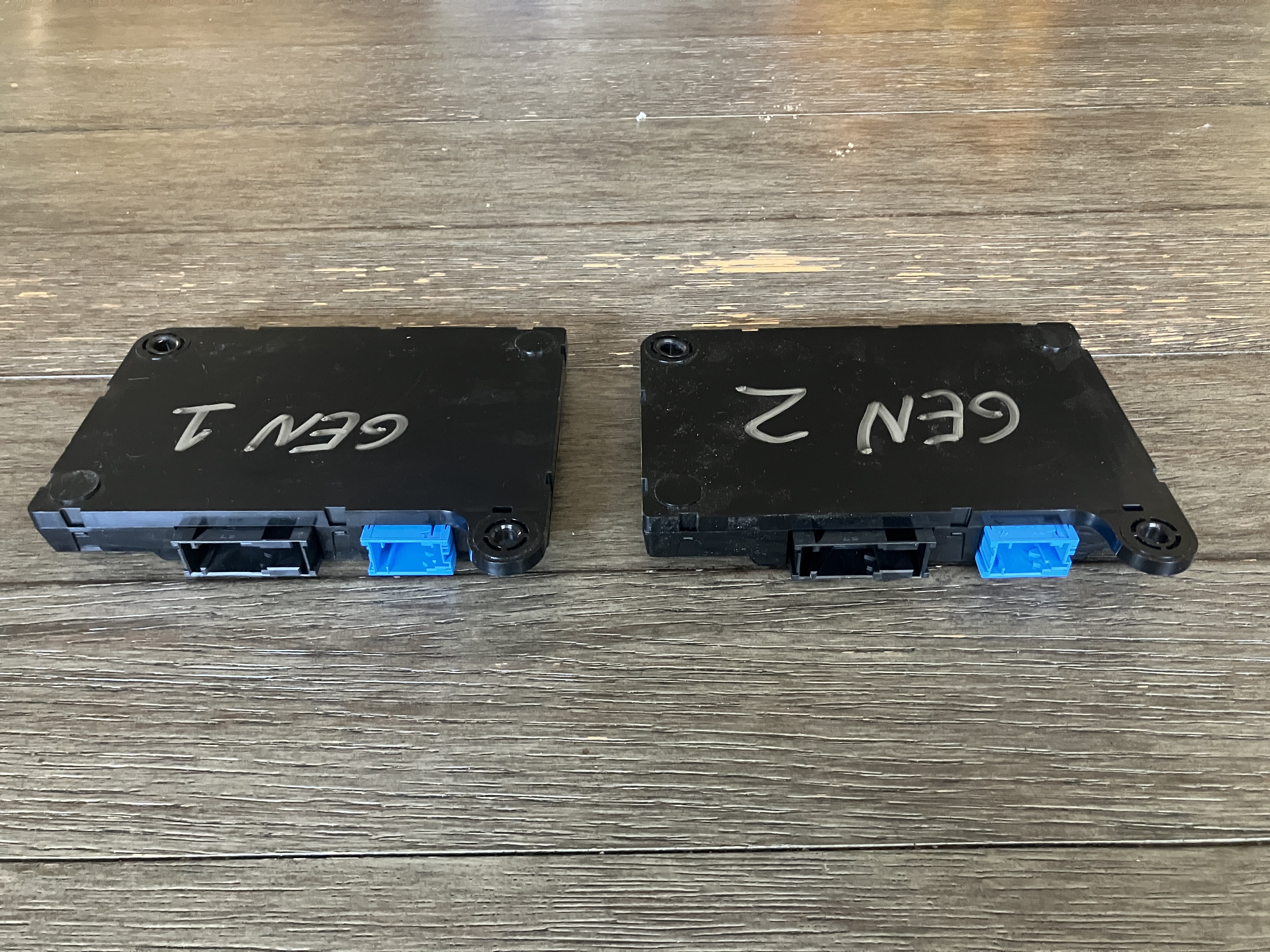

by Gregski
better late than never
the BMW hybrid BMS master module Gen 1 vs Gen 2
FYI: I was able to plug in the Gen 1 wire harness into the Gen 2 module
I plan on uploading pics of the Gen 1 and Gen 2 BMS wire harnesses next
part number comparison
