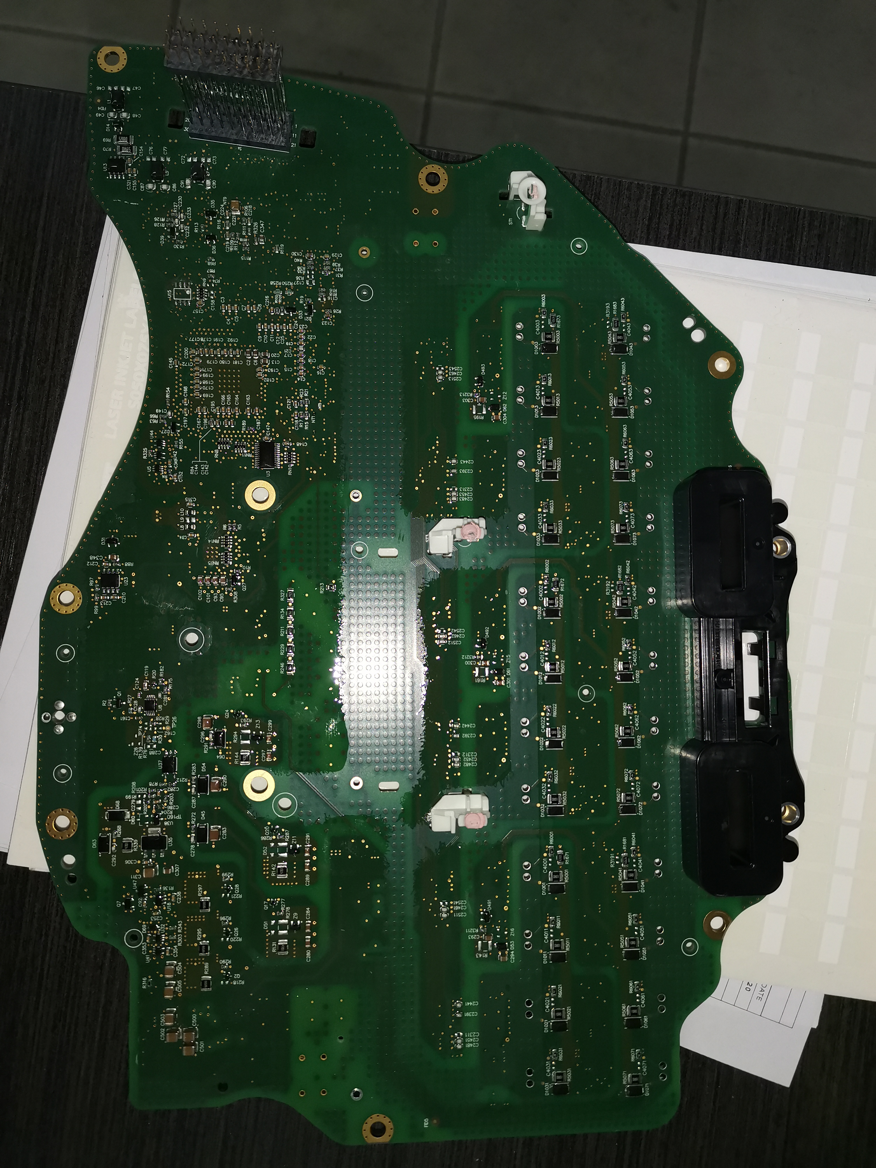

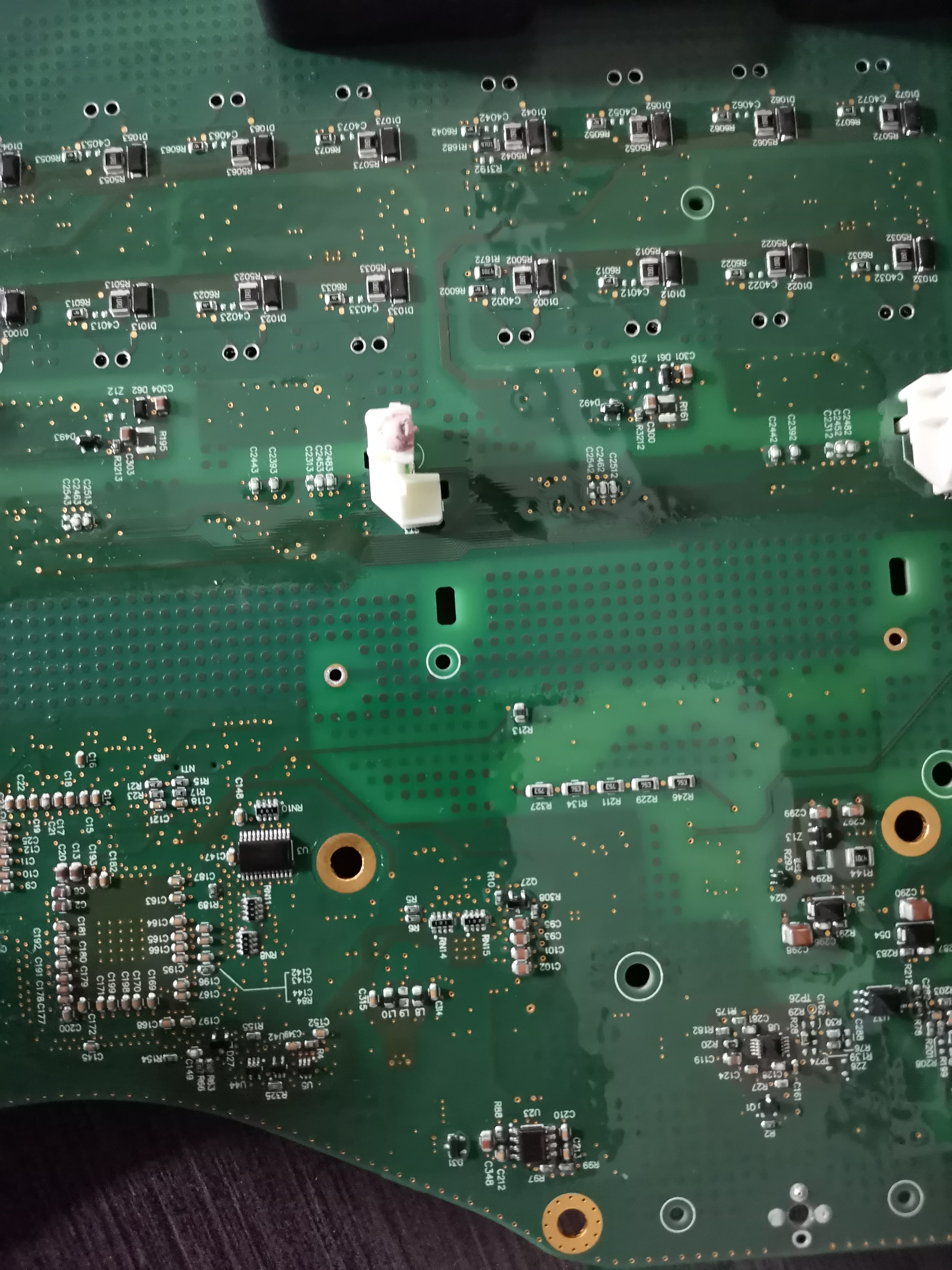

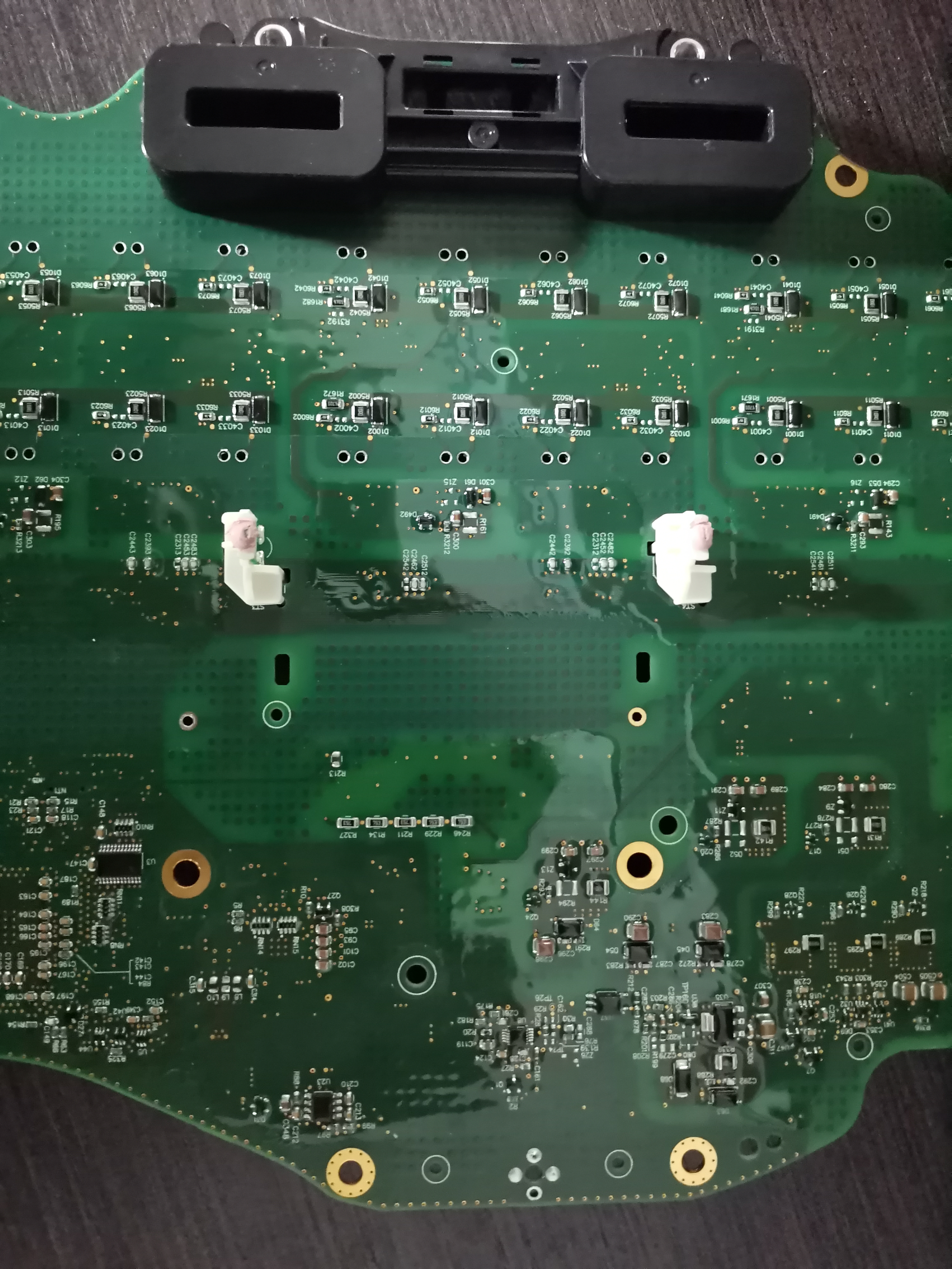

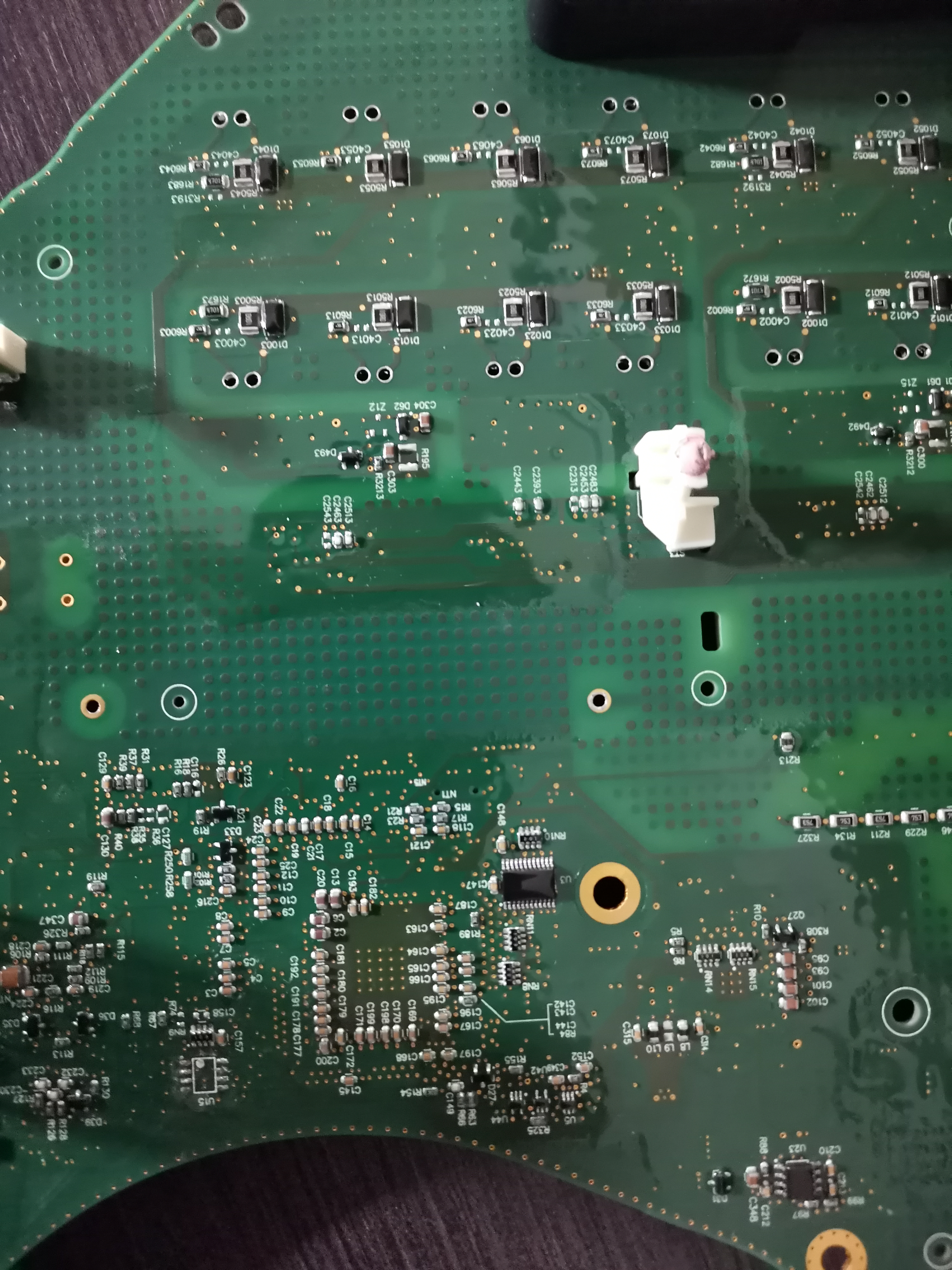

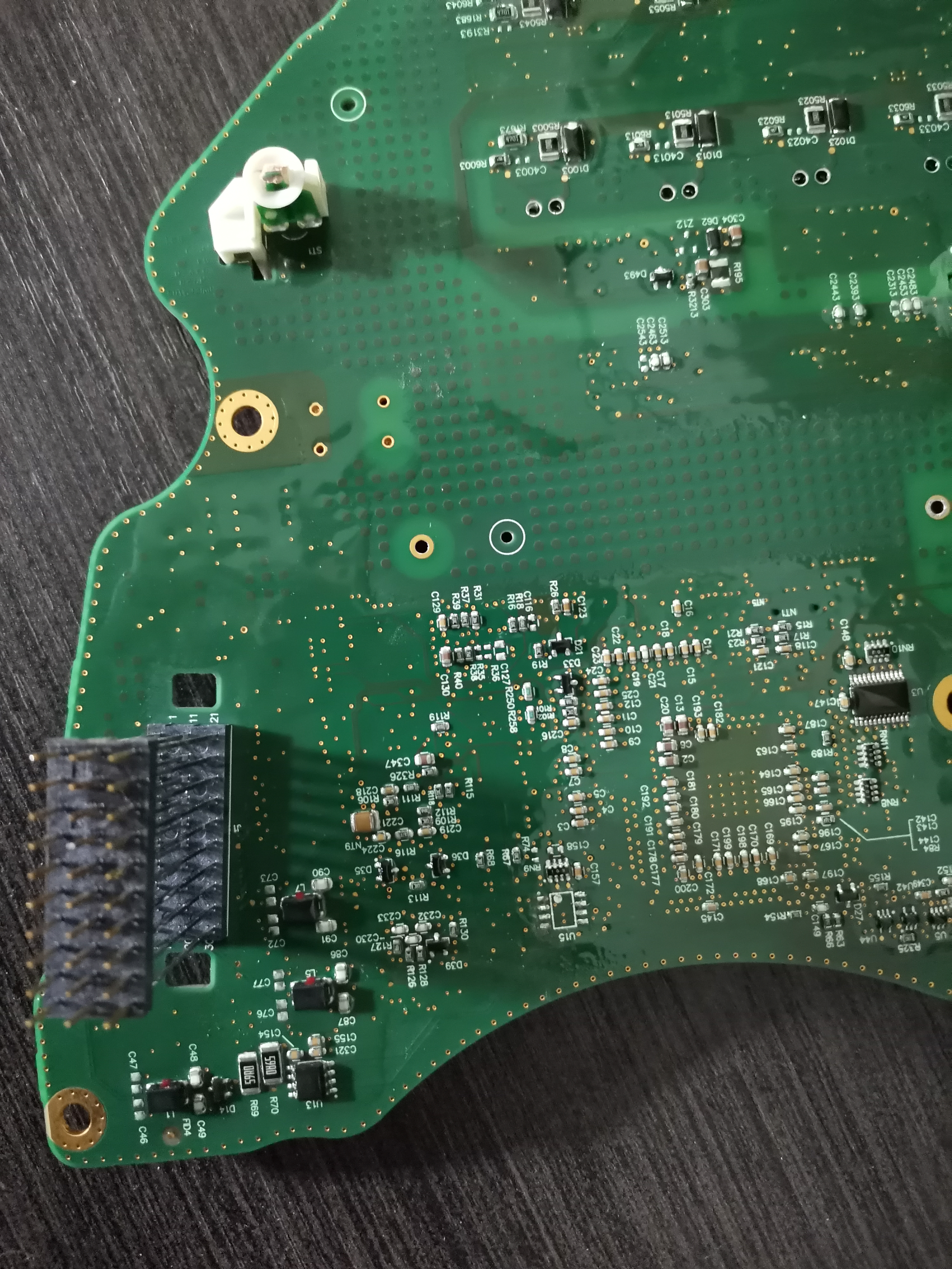

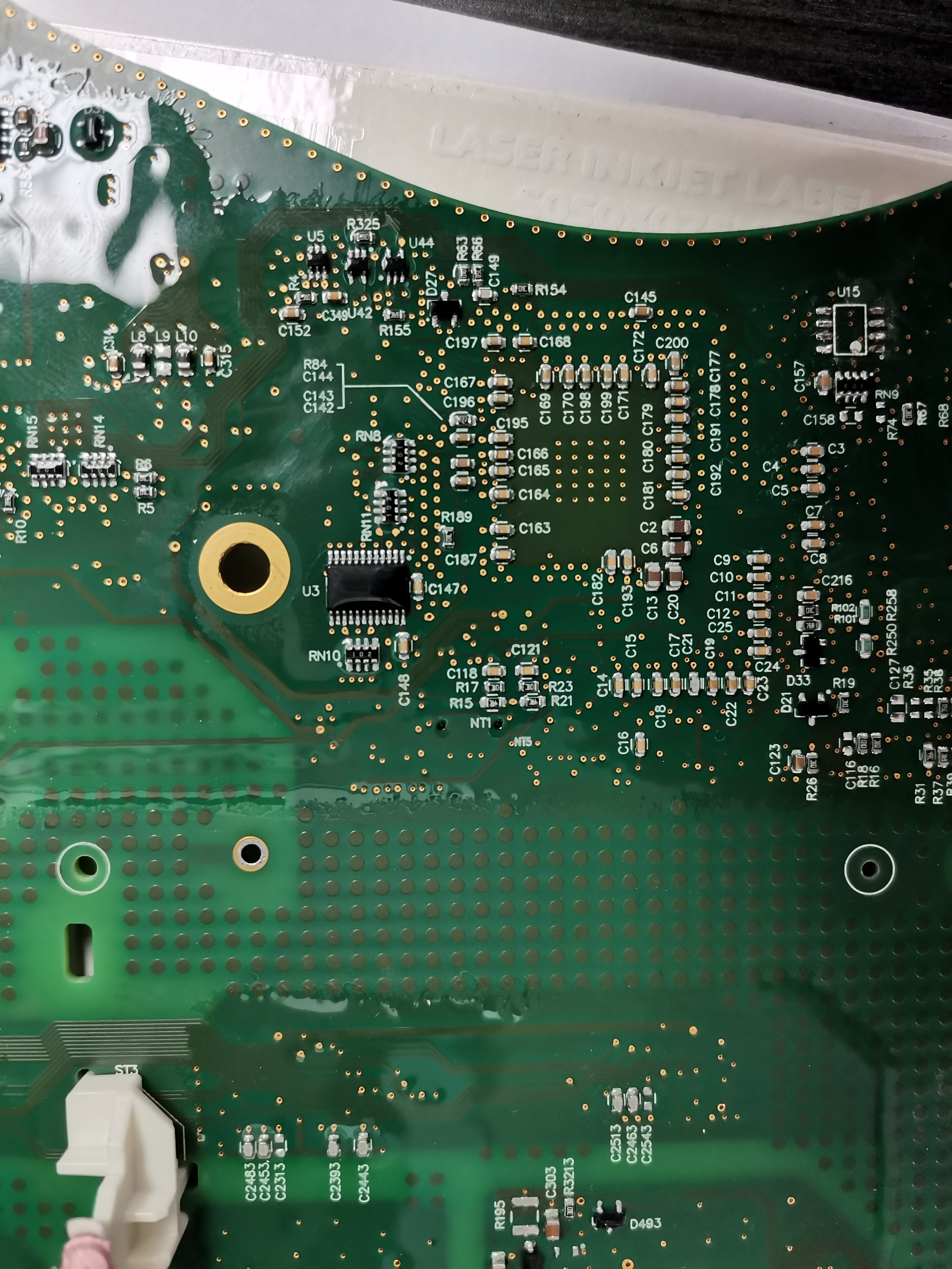

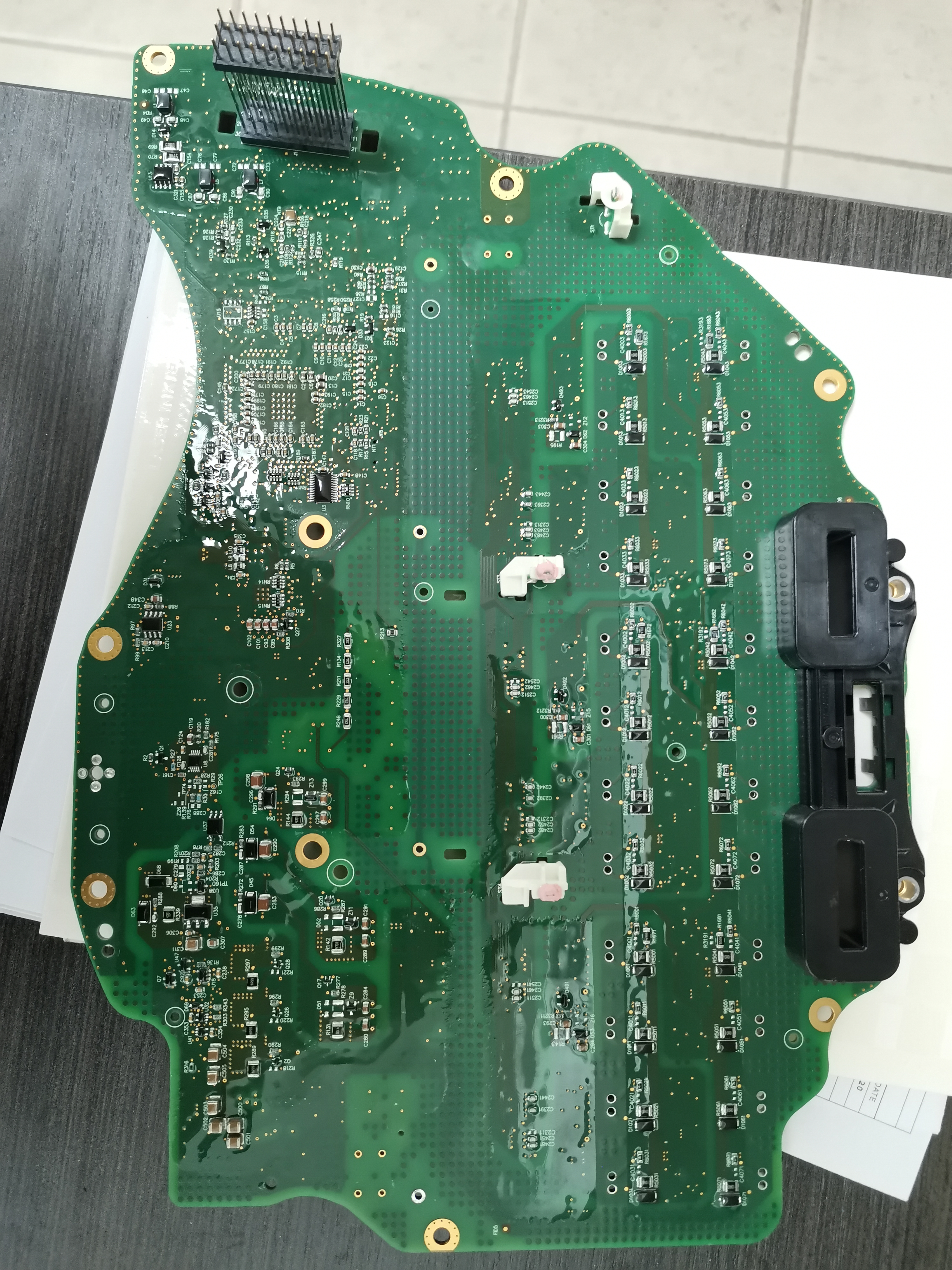

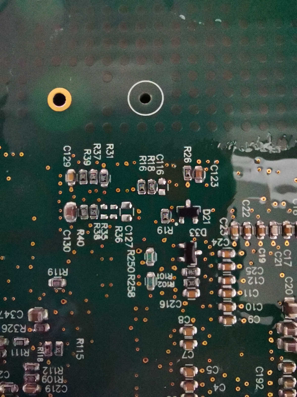

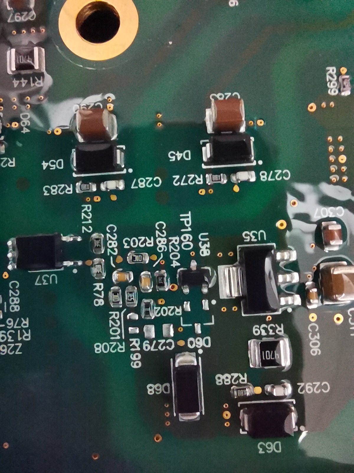

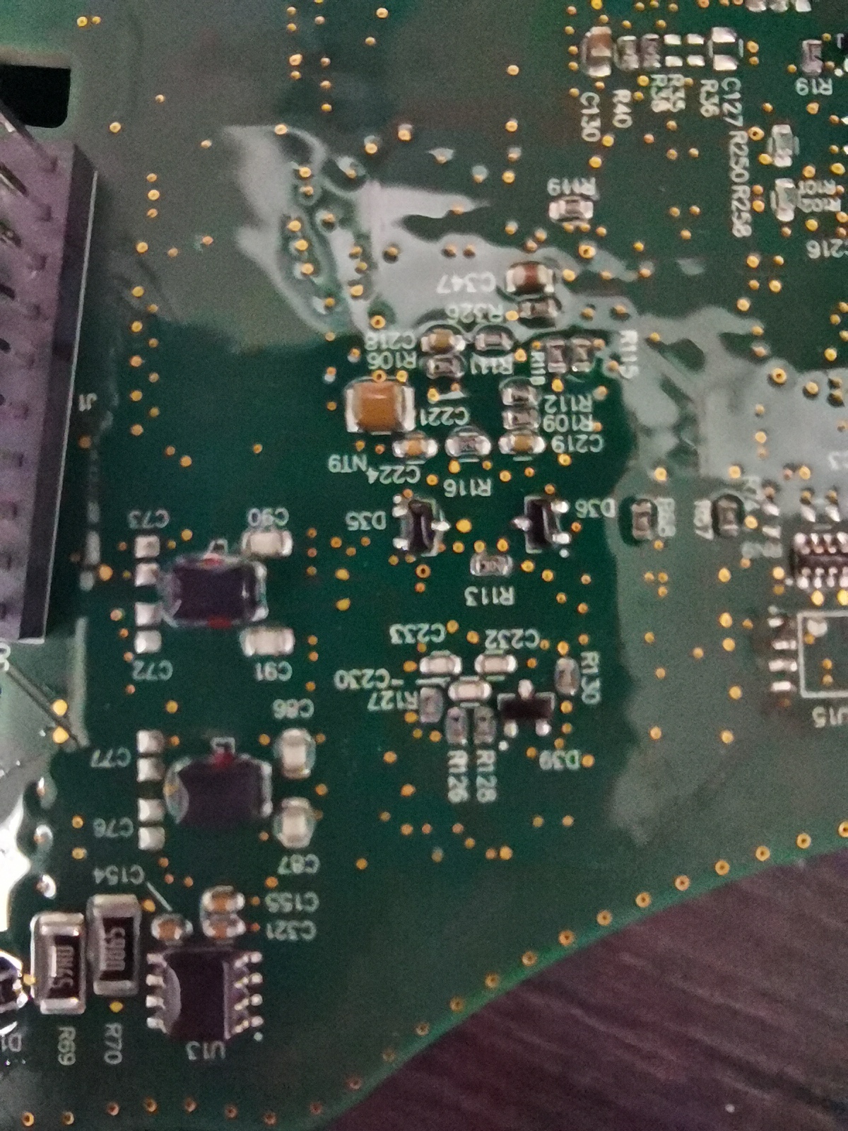

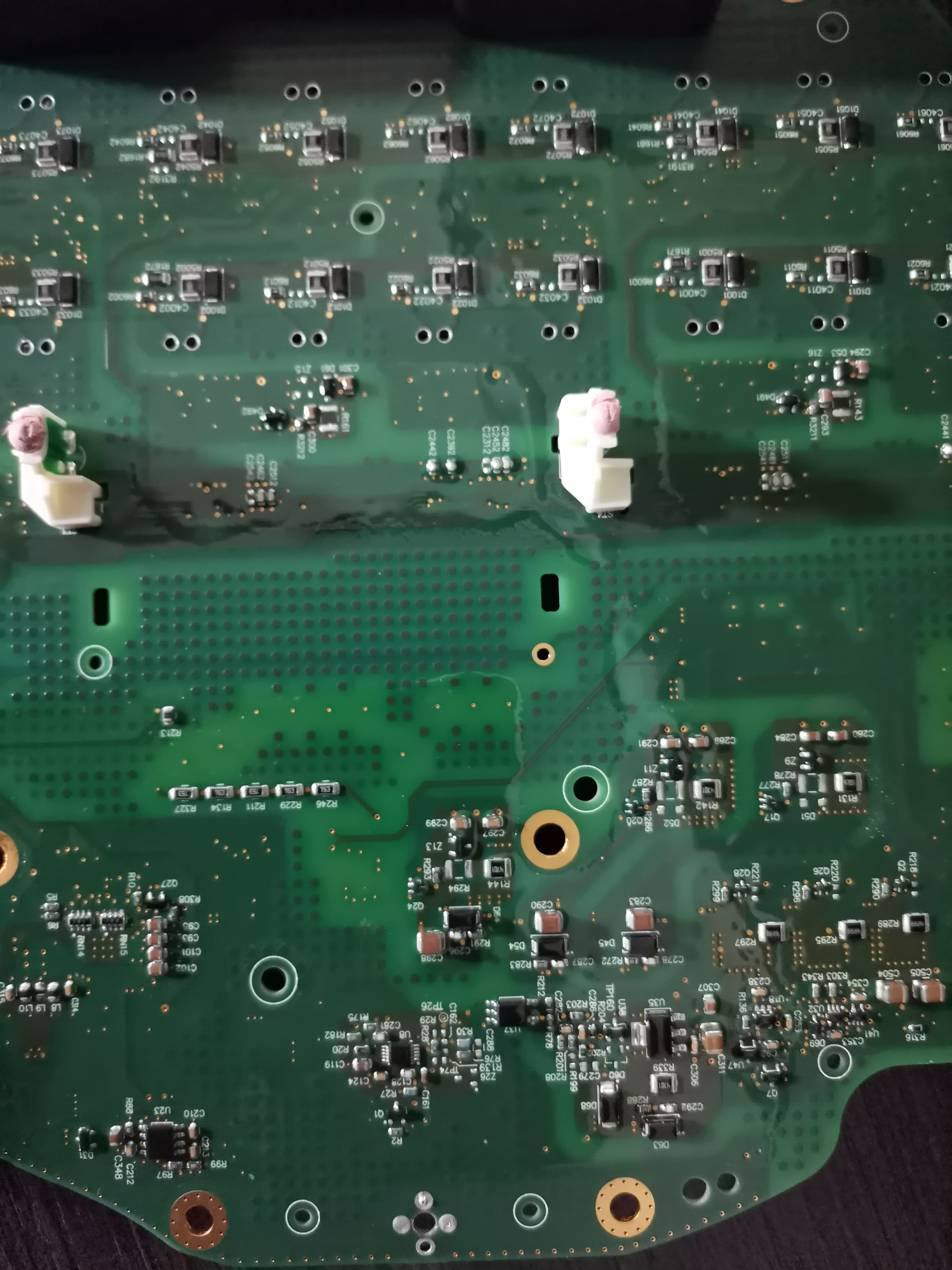

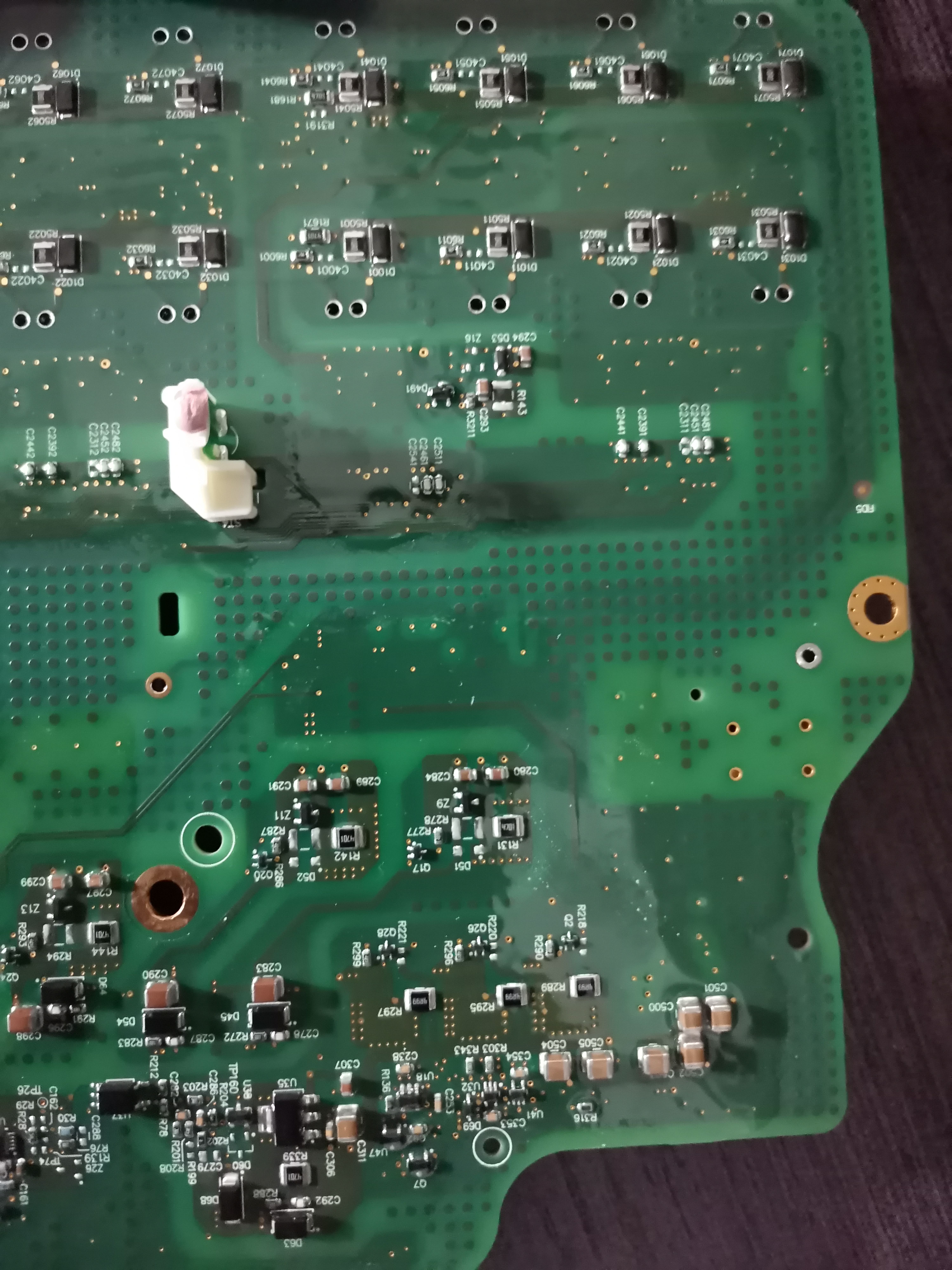

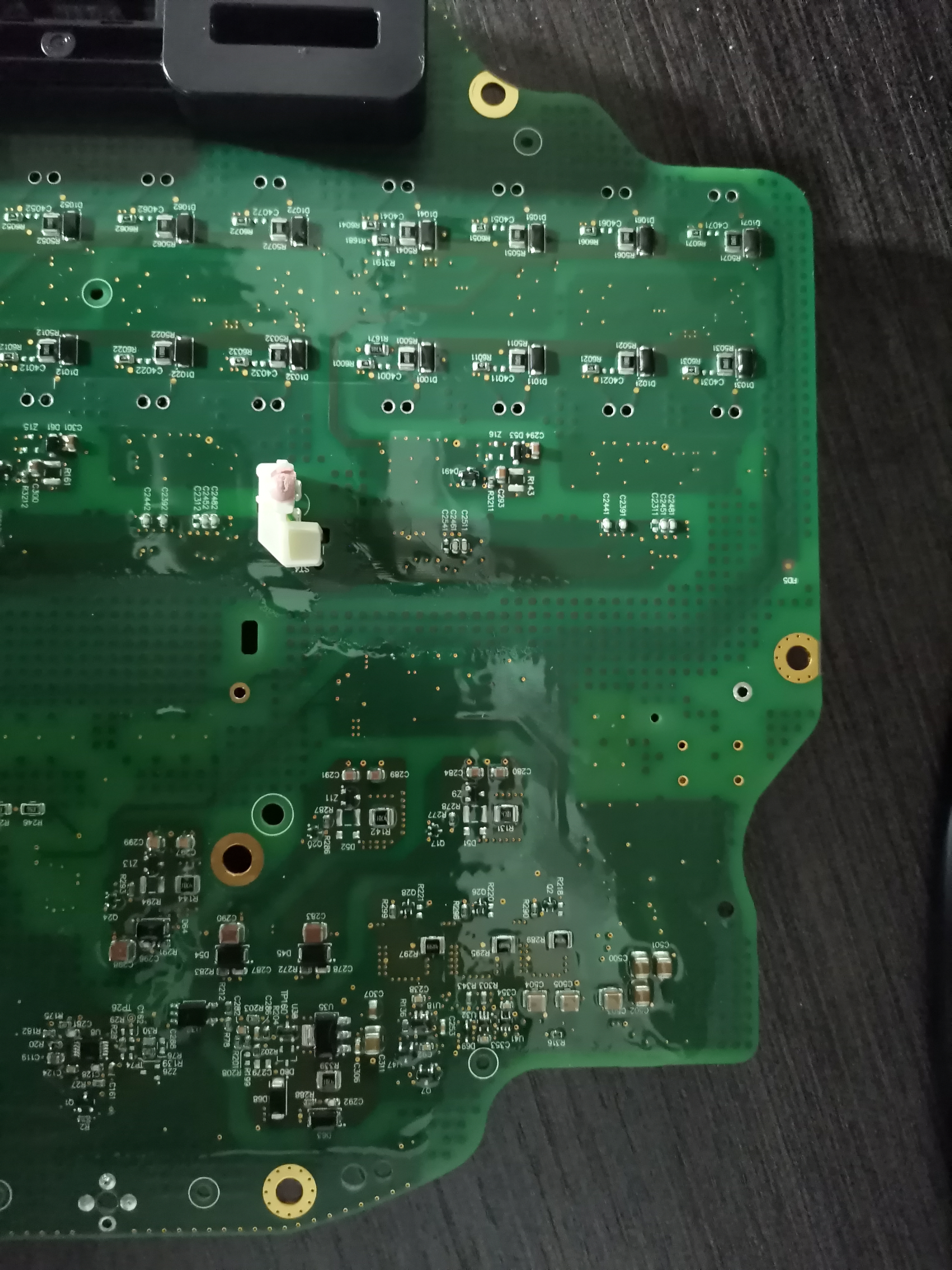

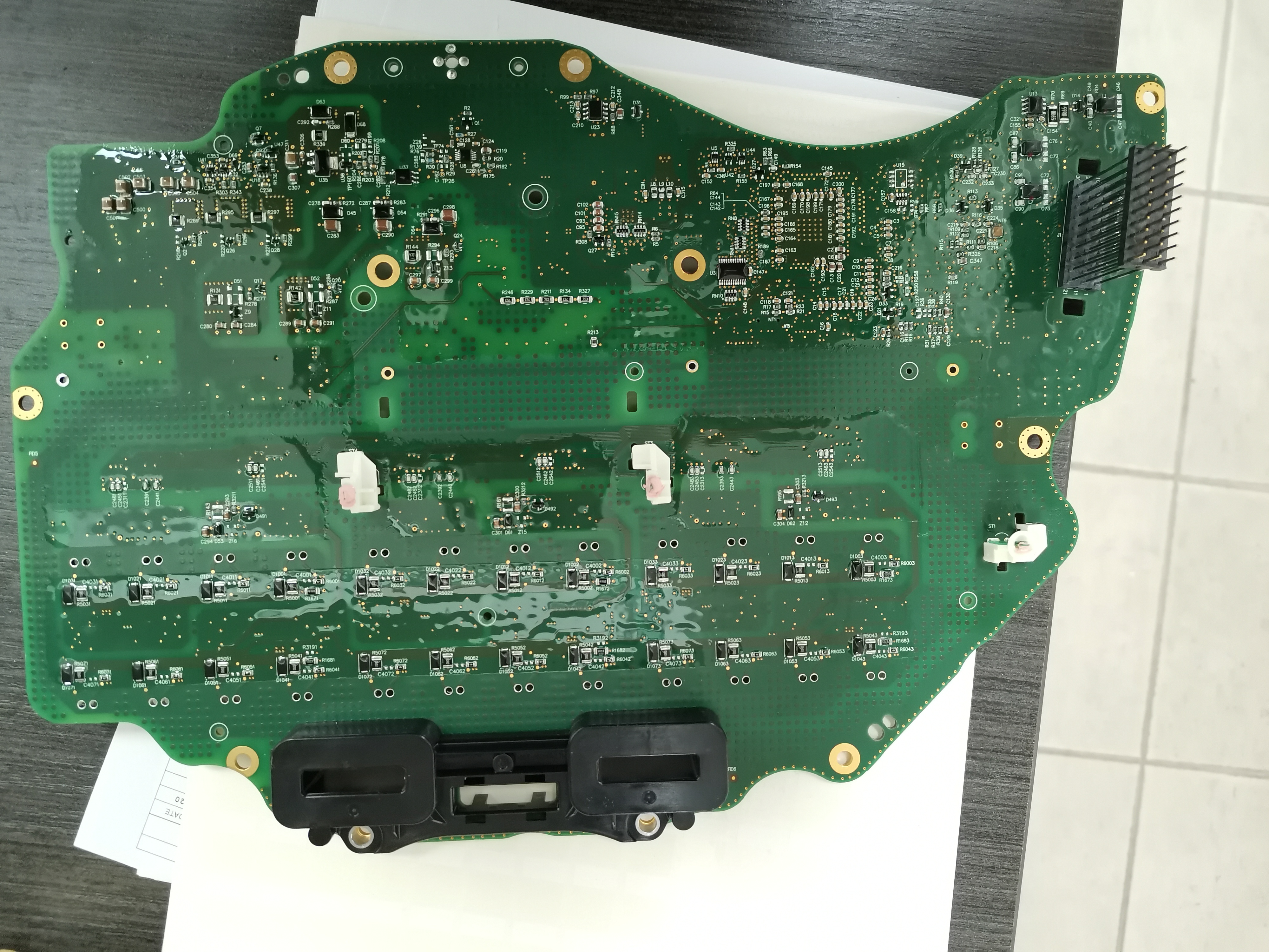

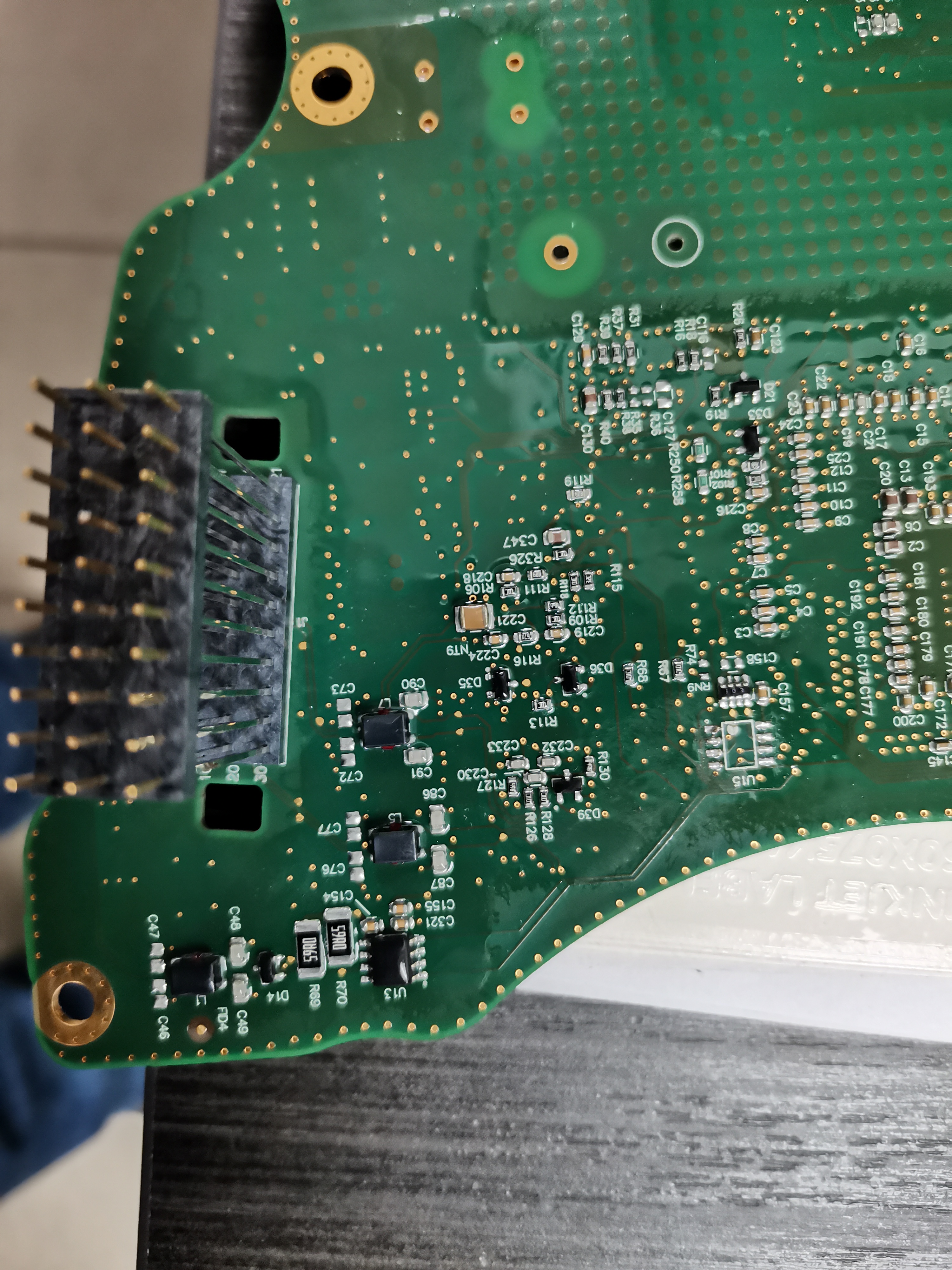

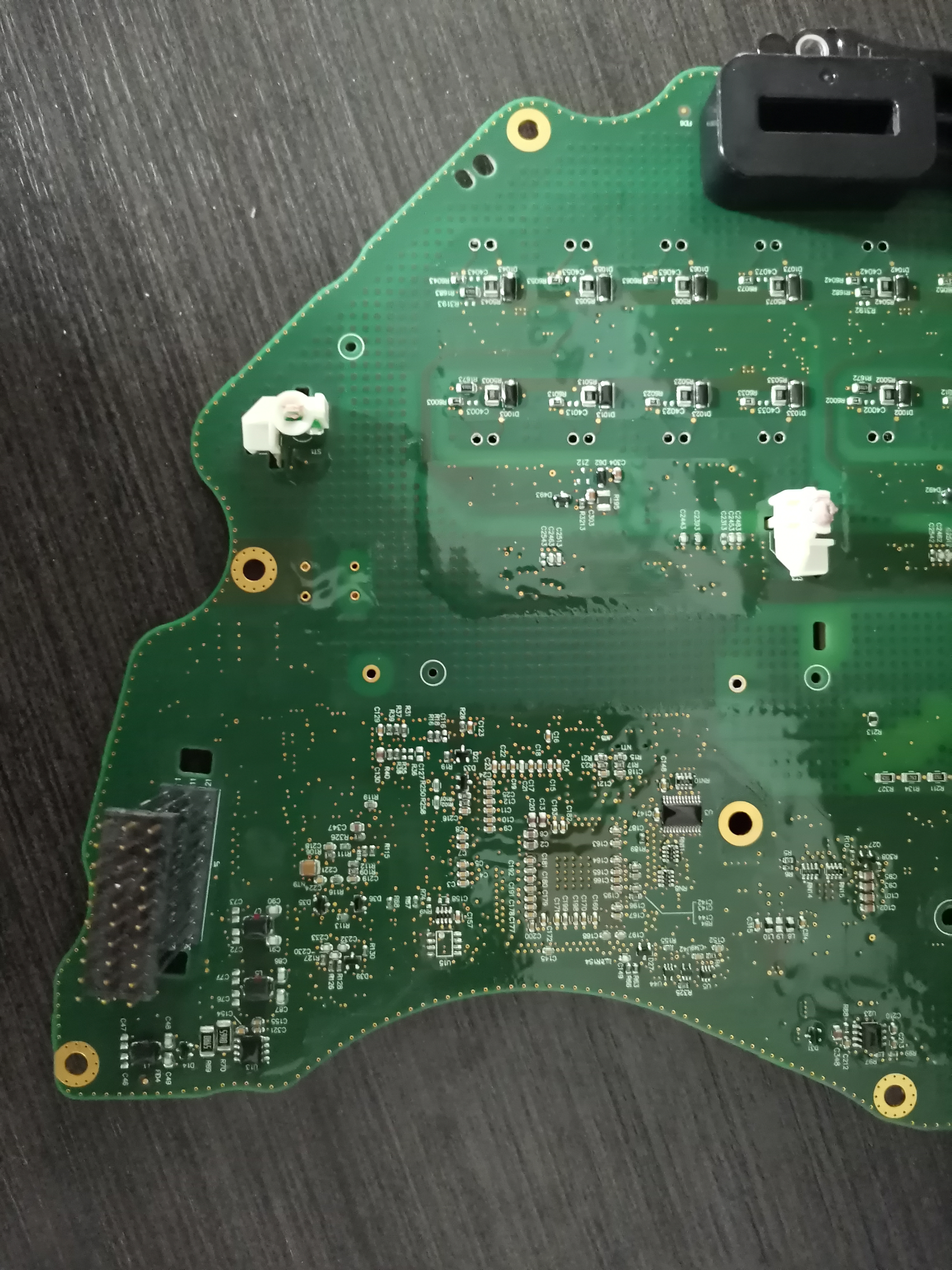

Here is my entire collection of pictures of the rear of the RDU inverter pcb.
davefiddes
- Posts: 416
- Has thanked: 206 times
- Been thanked: 256 times
Very good to have those pics.

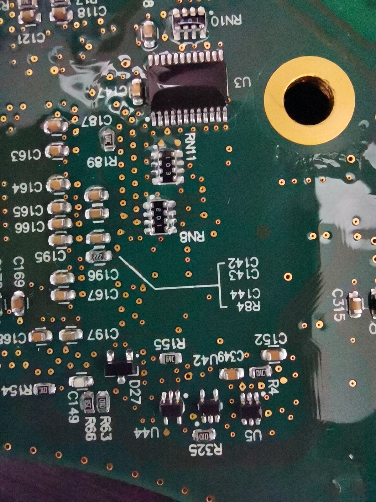

In the meantime I identified the transistor pairs - 6 N/P channel MOSFET pairs of
- a ST STD46P4LLF6 40V P-channel and
- a Infineon 3N0408 N-channel.
Also found better isognd and measure now stable -5V permanent voltage at the source/sink gate output of the gate driver.
20V on the MOSFET pair when having roughly 70V on the HV connector.
Not sure if any of this helps. Analog power electronics is clearly not my area.

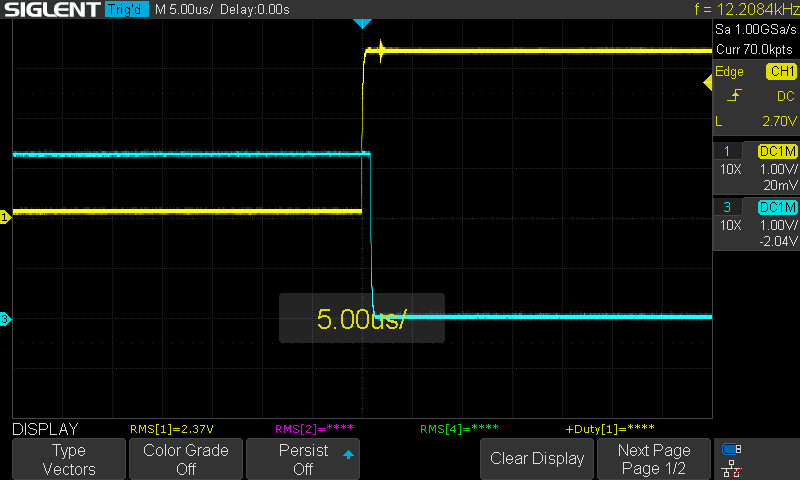

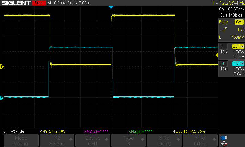

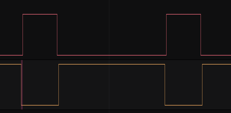

red is IN- (up), orange is IN+ (underneath). Duty cycle 25%.
I think (can you check?) IN+ and IN- are inverse and deadtimes are measured at 855ns (shall be 875ns from MCU) and longer than the gate driver's 800ns.
1. MCU's deadtimes need to be shorter than the gate driver's to not trigger DT_ERR.
2. IN+ and IN- need to be inverted to get GON at 25% in line with the MCU's PWM duty cycle. Now GON is 75% on.
I got a nice square wave on oscilloscope on the high voltage motor connectors.
Also gate drivers seem to finally behave with a -25/+25V signal on it's GON/GOFF output matching the input PWM's 25% duty cycle.
