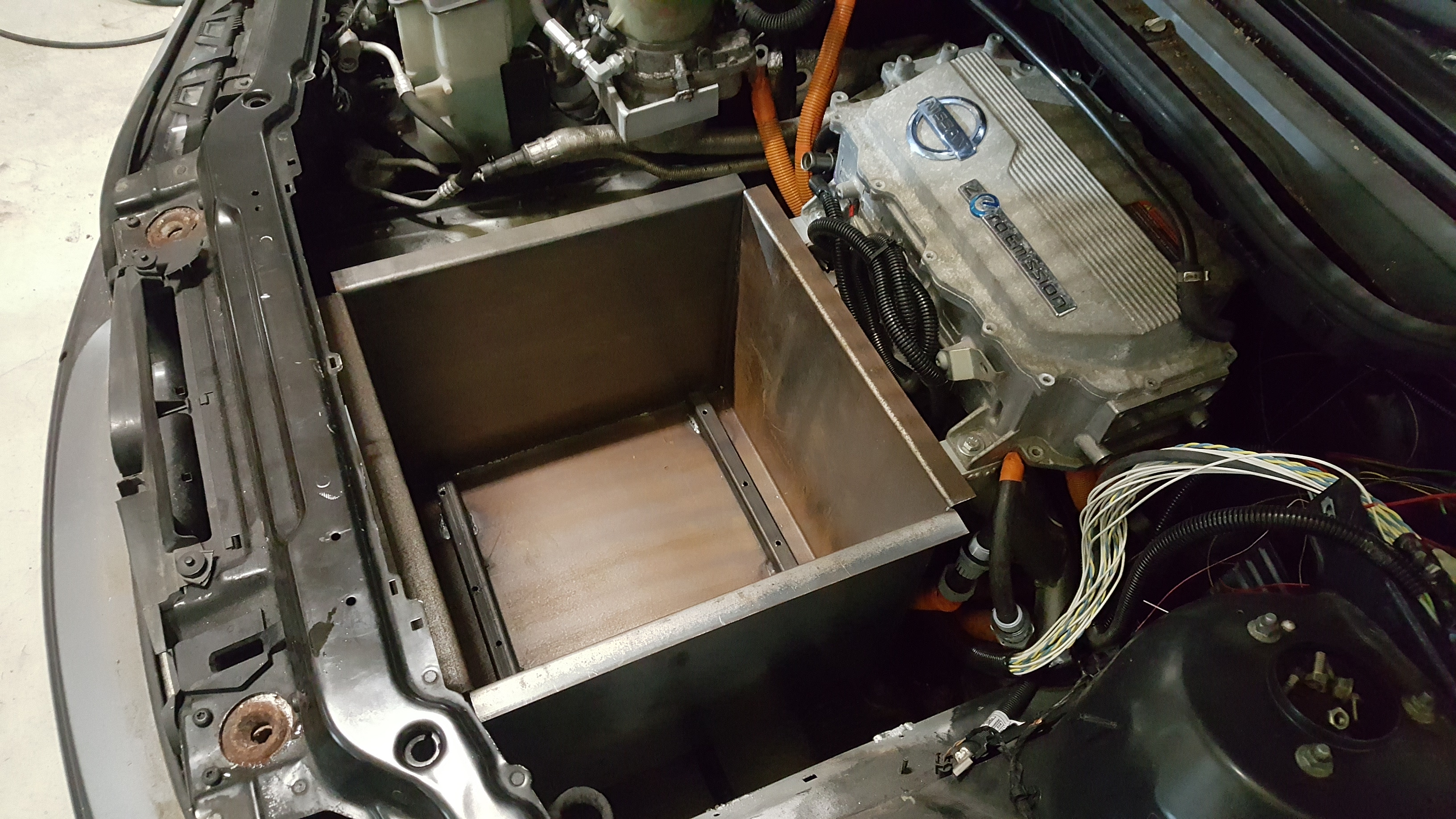

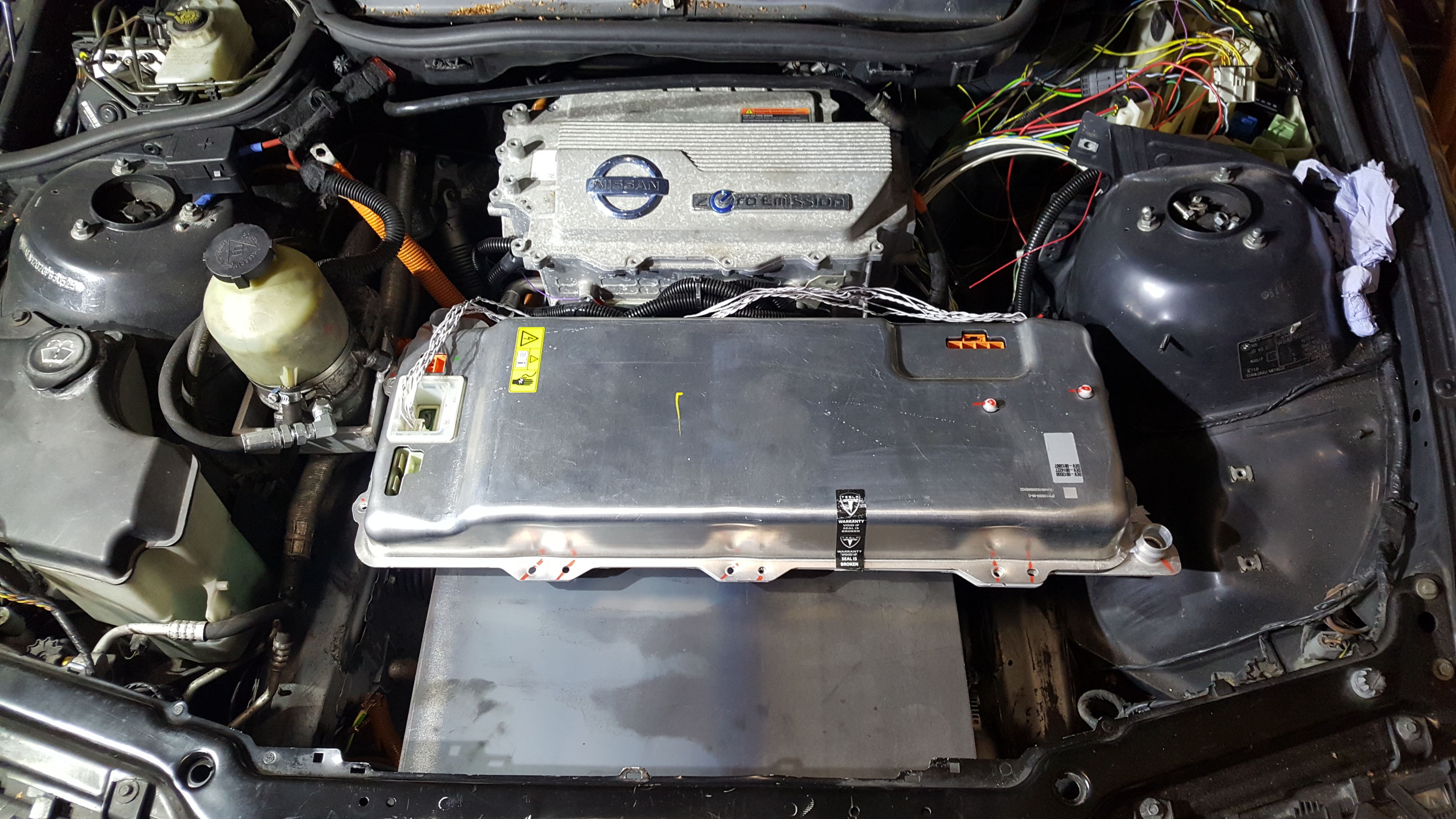

Re: Nissan Leaf Powered E46 Touring

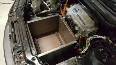

Small update on the E46 touring. Front battery box fitted and currently working out mounting for the Model 3 PCS (charger and dcdc in one).

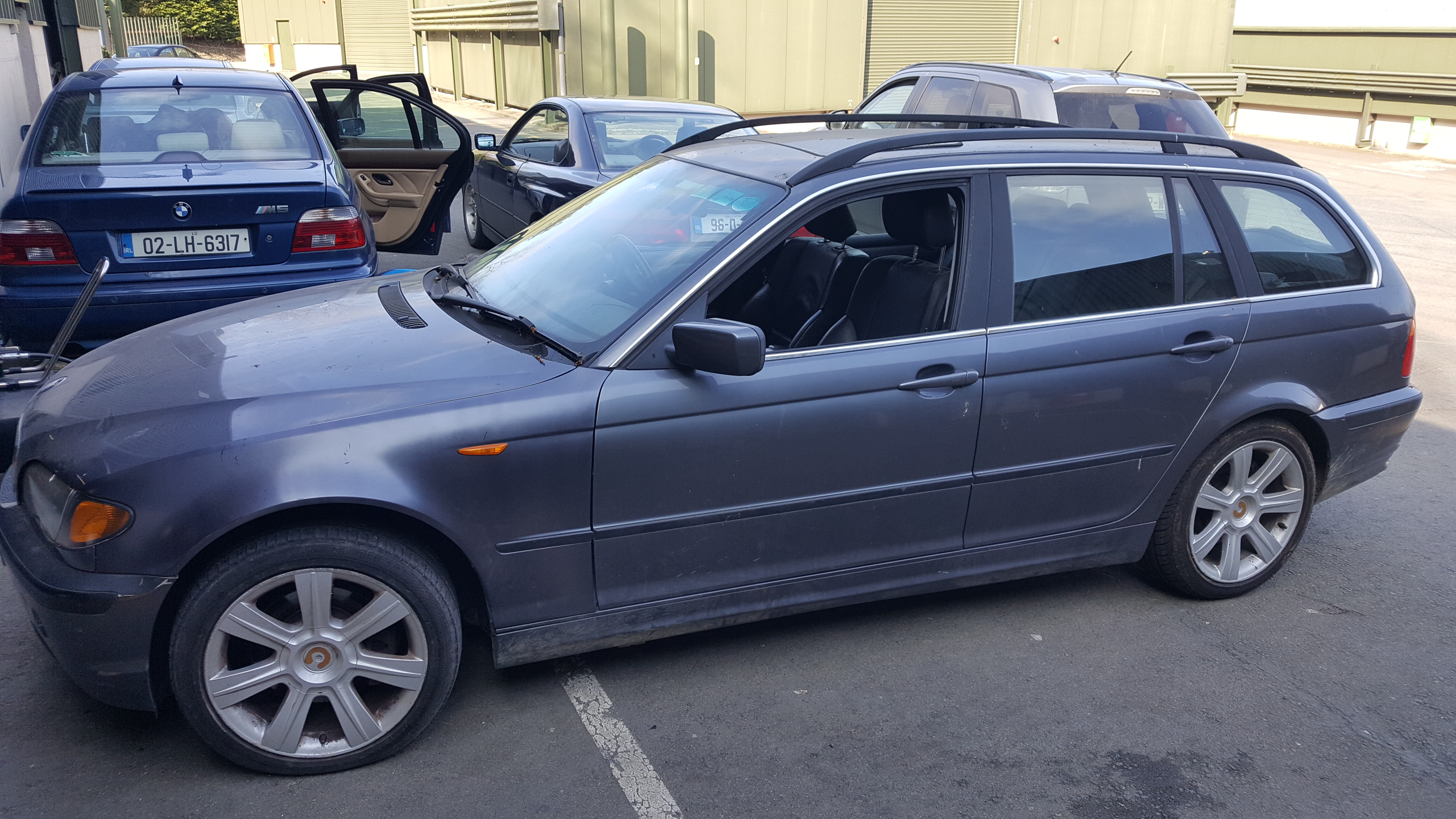

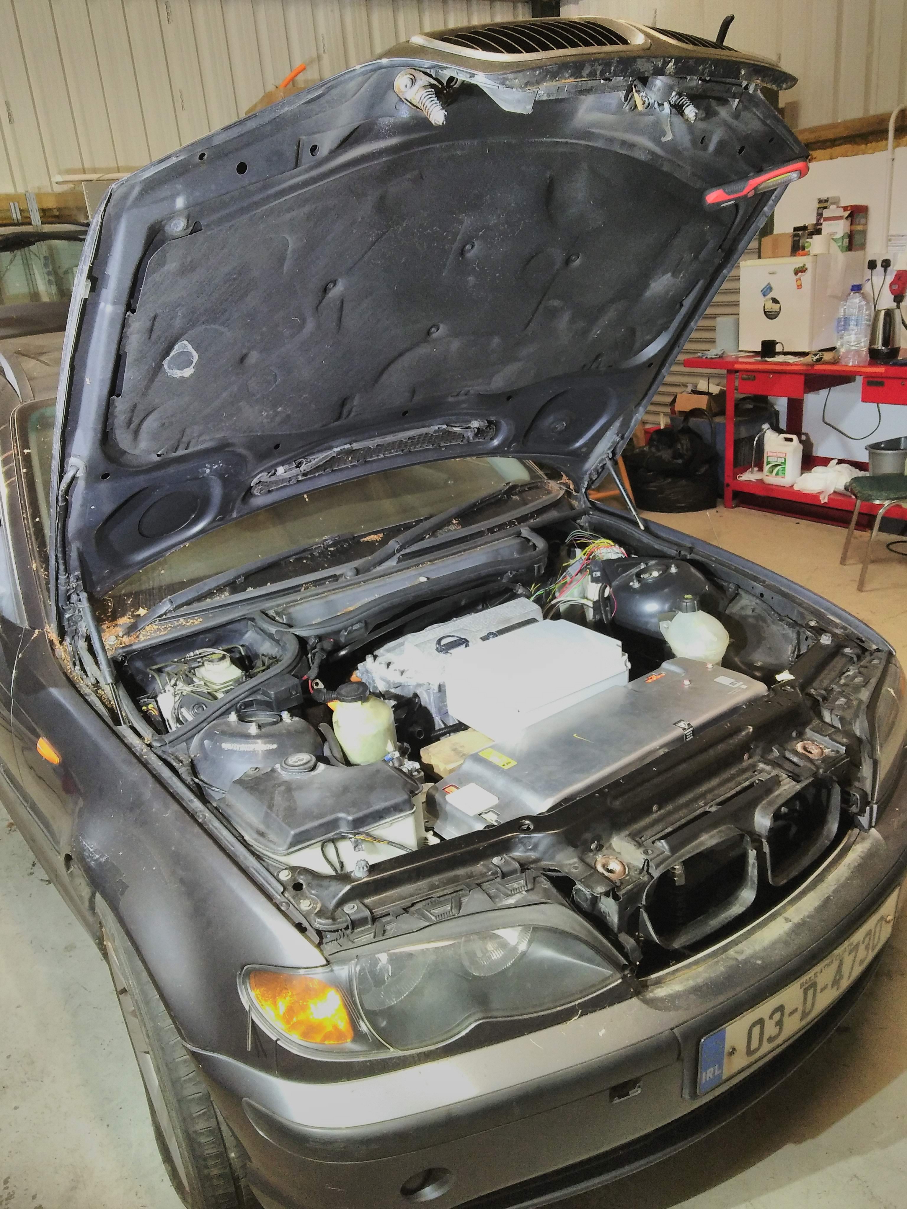

The Grey Goose was inspected and passed by an automotive engineer today... next steps include changing the taxation class to electric drive, NCT, and testing on track and road
The car is now taxed as an electric vehicle (cost €120 p/a) with the automotive inspection/report process working like a dream

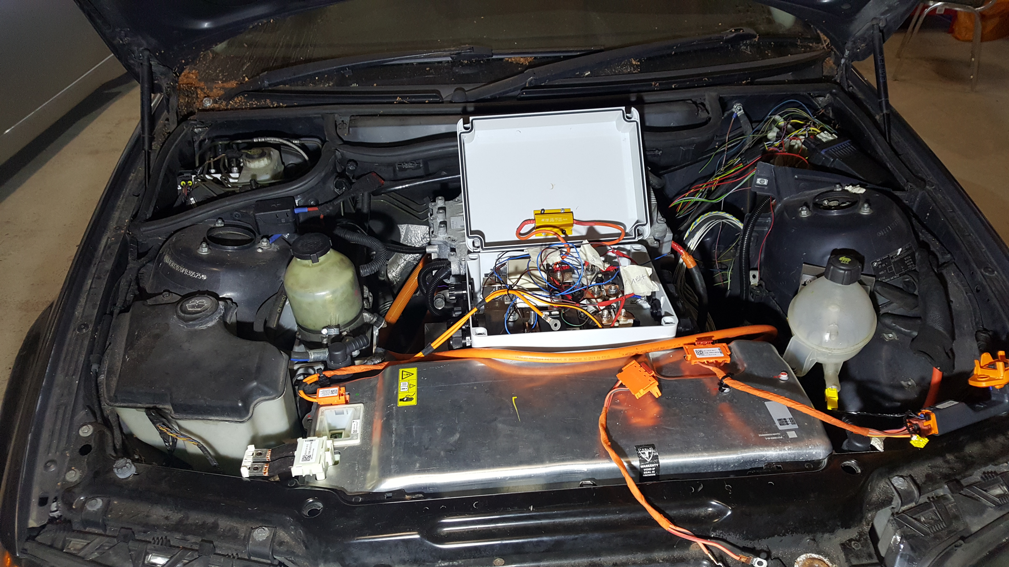

Some good work today. Pcs is mounted and secure as is the high voltage junction box.

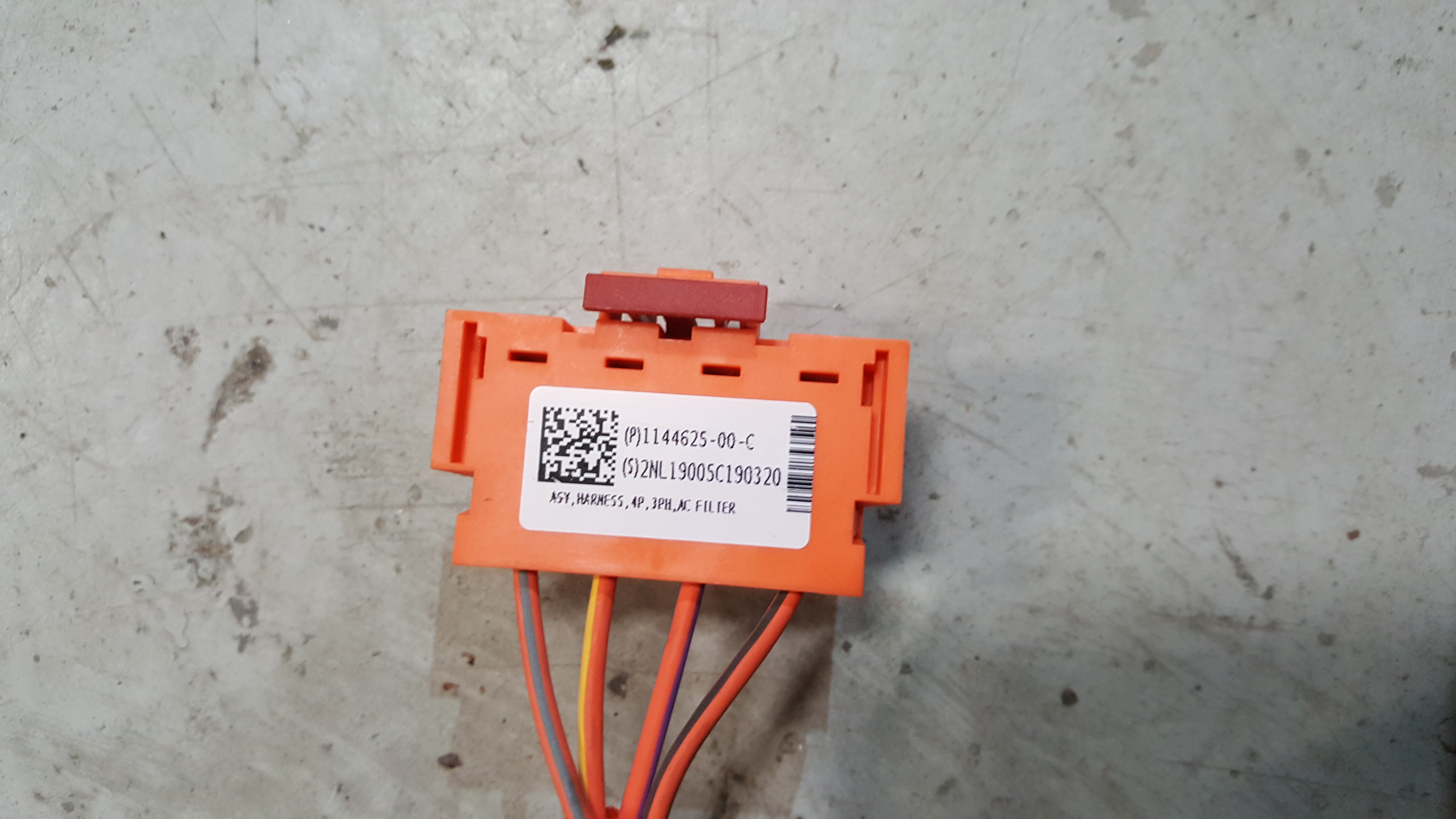

Need some help locating two components. The 12v high current plug and a european AC connector plug. As my pcs was US I only have the single phase connector plug. The ones pictured do not belong to me so I cant butcher them:)

Lots work on Grey Goose this week... the front and rear batteries are now strapped down and the Tesla PCS testing will commence once the last of the cooling system components arrive

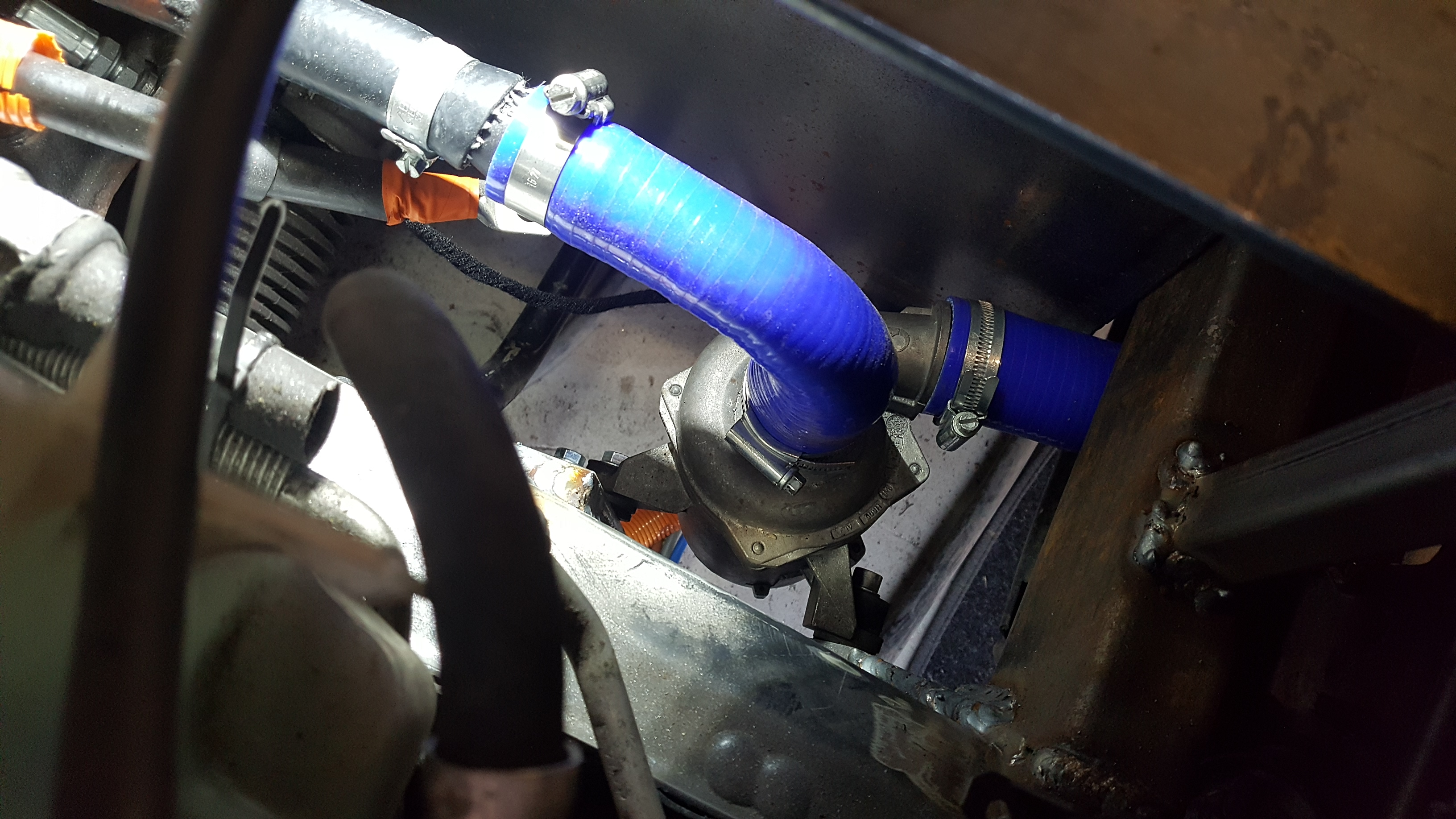

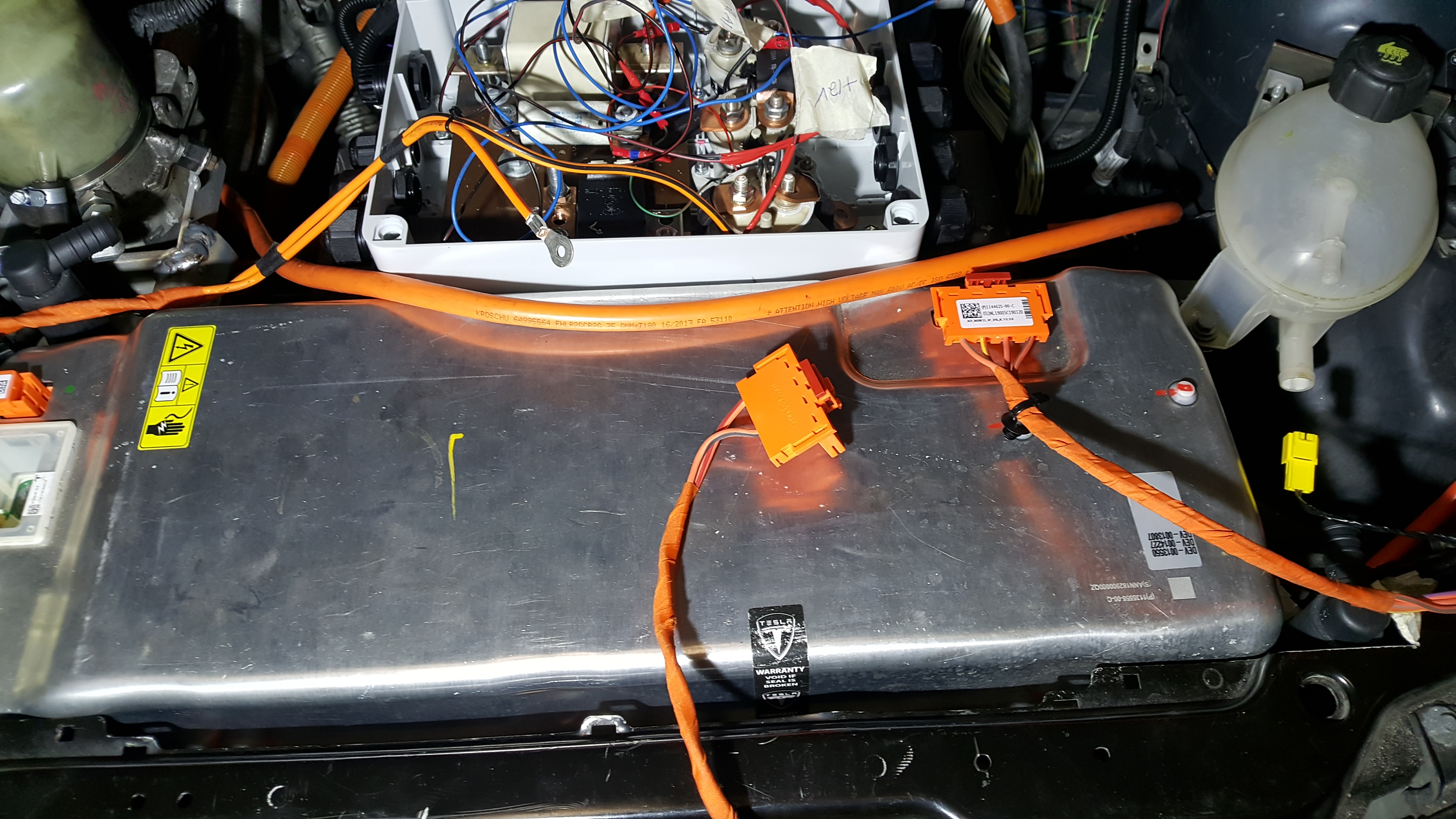

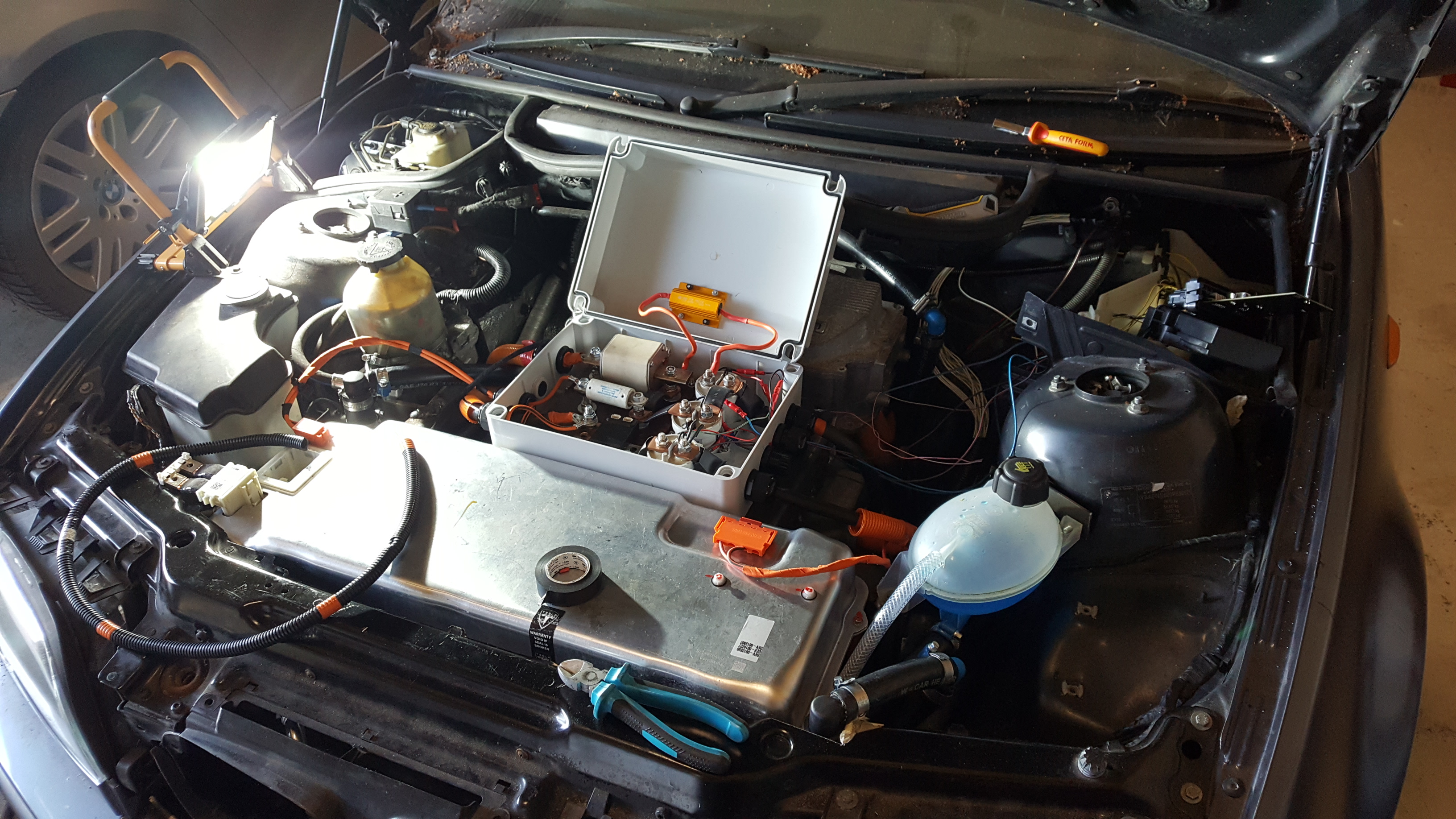

The Goose now has cooling thanks to a BMW E90 electric pump. HV junction box is done and car now precharging and starting and driving. Also does a mean donut:) Next up is PCS controller programming to get the dcdc and charger functions working.
HV box looks good'
What is white unit wire in series with the pre-charge resister
