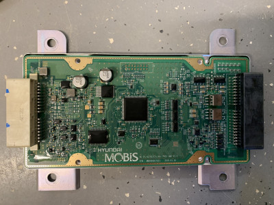

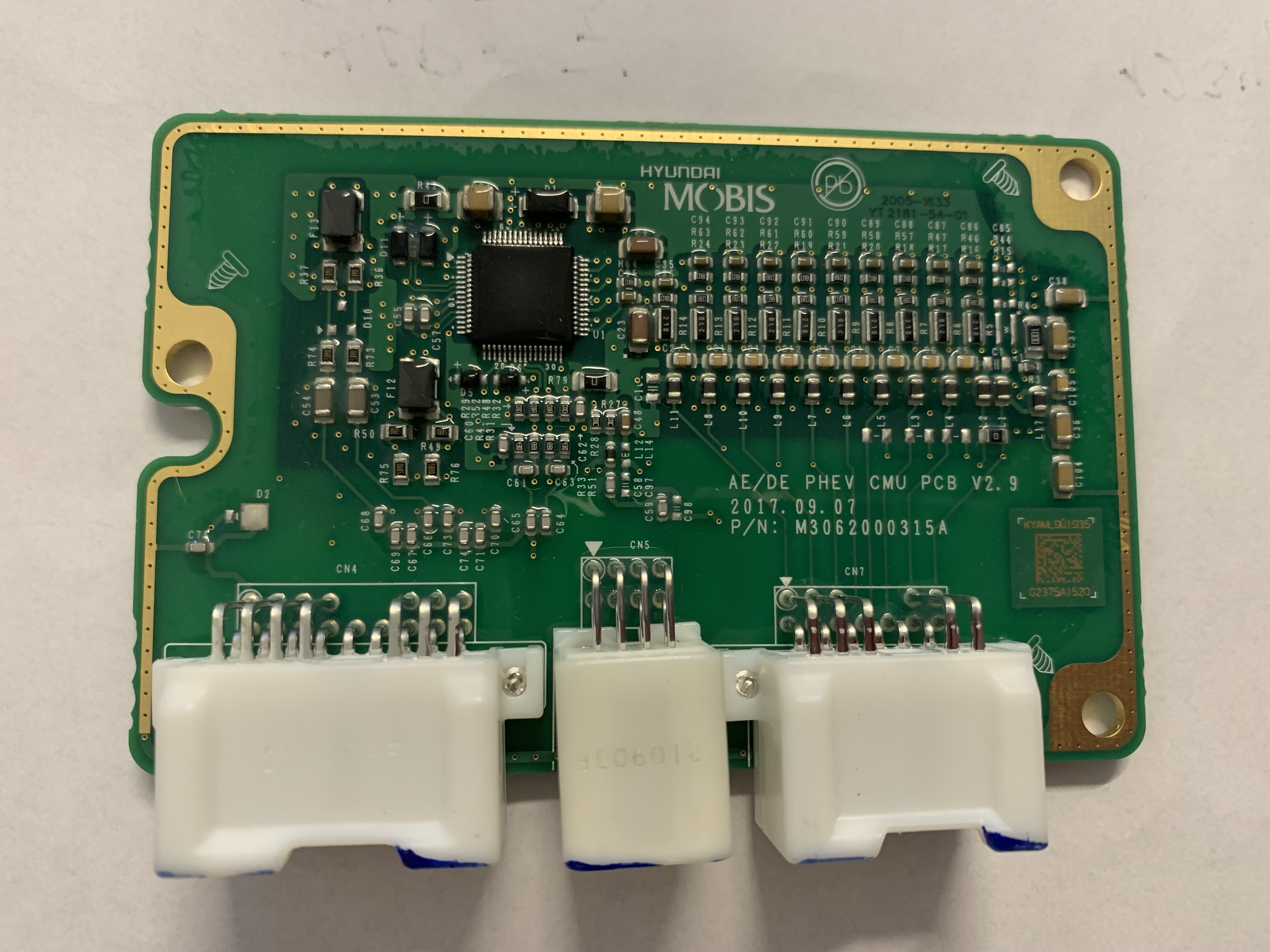

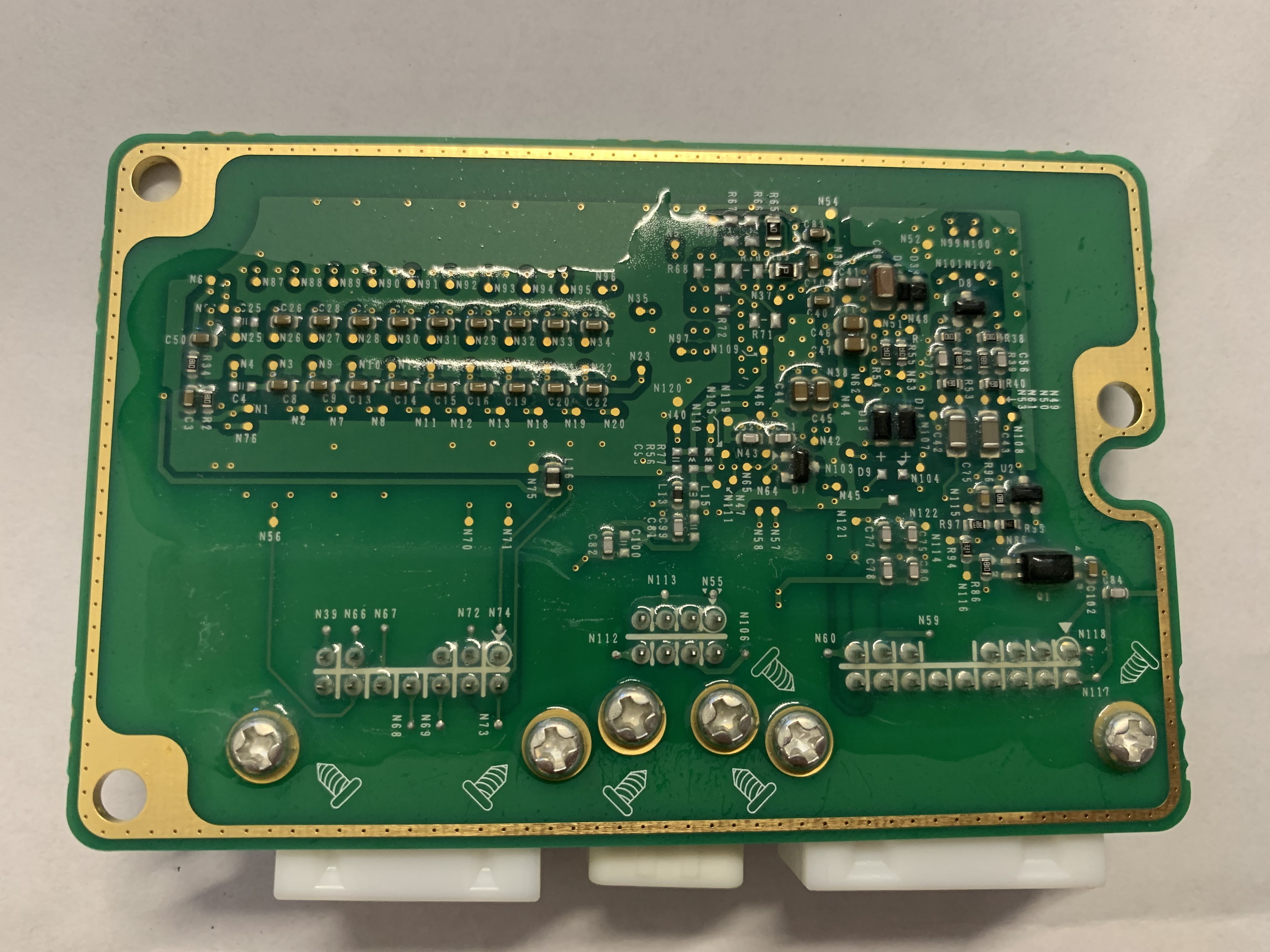

Hi guys
I checked your Slave BMS pictures, I would like to confirm some points with you:
1) Each Slave BMS manages 24 cells (2x12 cells) due to the fact that 2x MAX17845 are mounted
2) There are 24 passive balancing resistors (12 pcs per PCB side), so this seems to confirm the above hypothesis
3) For the daisy chain communication with other Slave BMS boards, I have not noticed any "isolation transformer" (for instance, these are used in Porsche Taycan Slave BMS). In this board, I was not able to find any magnetic transformer (easily identifyable due to their bulky size). Did you figure out how the isolation is achieved? Is it performed in a capacitive way instead of magnetic way (less space needed on the PCB)?
4) In addition to cell voltage monitoring, does the Slave BMS board also have temperature sensing? From the data-sheet of the MAX17845 cell monitoring IC, I understand that each of the 2 IC could in principle acquire 2x thermistors signals, so in total 4x external temperature sensors could be connected. Do you know how many of them are actually managed?
5) Did you find any thermistor directly connected on the PCB of the Slave module? (in my understanding, some manufacturers place it to monitor the temperature of the PCB, which could rise extremely during cell balancing; it is some kind of diagnosis function of the board)
Thank you in advance.

Re: Kia Niro BMS
1) On the OEM config it manages 9 or 10 cells but it should be able to handle 12 cells, all HW is there for it, but I have not tested this only 10 cells.dadez87 wrote: ↑Sat Nov 26, 2022 3:18 am Hi guys
2) See above.
3) There need to be isolation transformers on the main board but not in between slave modules. See MAX17841 and MAX17823 (or MAX17845) datasheets where they explain the daisy-chain.
4) Yes, two temperatures per IC so four temperatures per salve module. See picture in post of connector pinout, https://openinverter.org/forum/viewtopi ... 062#p46062.
5) The external temperature sensors are connected via cables to the PCB. There are one internal die temperature per IC which can be read using my code.
Regarding reverse engineering of this entire slave module board, I would start by reading the HW design recommendations from MAX in the datasheets mentioned above. Kia seem to have used what Maxim recommends i most cases as far as I can tell.

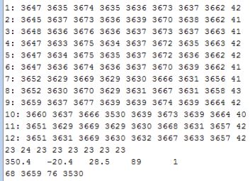

Re: Kia Niro BMS
Dear bexander.
Cells voltage and temperatures are already working. Now I using 12pcs slaves.
Now I have a little problem with cells ballancing. I edited the code with small error I think.

Re: Kia Niro BMS
Seem like STATUS register bit ALRTFMEA2 (0x02) is set for all slaves exept no 10??
I don't know why this is set but the problem is that the specific FMEA2 register needs cleering once set. Clearing just STATUS register is not enough. And that is not handled in my code.
Cell #4 in slave #10 is the lowest cell, close to 100mV lower than all the other cells?? Please, verify this with a multimeter and/or check your wiring for this perticular cell.
1: 3610 3633 3633 3633 3630 3634 3633 3633 26
2: 3609 3633 3633 3633 3632 3632 3632 3633 26
3: 3610 3634 3634 3633 3631 3633 3633 3633 26
4: 3608 3632 3632 3632 3632 3631 3630 3632 27
5: 3611 3632 3634 3632 3631 3632 3632 3633 26
6: 3611 3633 3633 3633 3631 3631 3633 3632 27
7: 3632 3637 3638 3637 3636 3637 3637 3637 25
8: 3632 3638 3639 3637 3637 3637 3638 3638 27
9: 3633 3639 3639 3640 3636 3638 3638 3638 27
10: 3632 3638 3638 3508 3637 3637 3637 3637 26
11: 3631 3638 3639 3638 3636 3638 3638 3638 27
12: 3631 3639 3639 3638 3638 3638 3639 3638 26

Re: Kia Niro BMS
What happends if you start the cell balancing at a higher voltage level and then charge the pack a bit? Do you still get the same error?
Asking cause the FMEA2 indicated something with slave supply voltage and the internal charge pump of the slaves.
Re: Kia Niro BMS
Dear bexander
The current was causing the problem i think. My test charger make only 0,5A /350V.
Now i split one baterry to 6small in parallel connection. I using charger with 60V and 10A and balansig working 10 min without error.
Die temperatures are also higher.
Thank you very much for your help!!!
