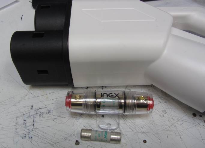

Any V2H/V2G type application is going to be doing way less current than the car running or rapid charging, so the answer is simple - just put fuses in line with whatever you are connecting.
This can easily be done inside the CCS connector, as we'd typically be looking in the low tens of amps range.
The car audio industry do some in-line holders for 38mm cartridge fuses

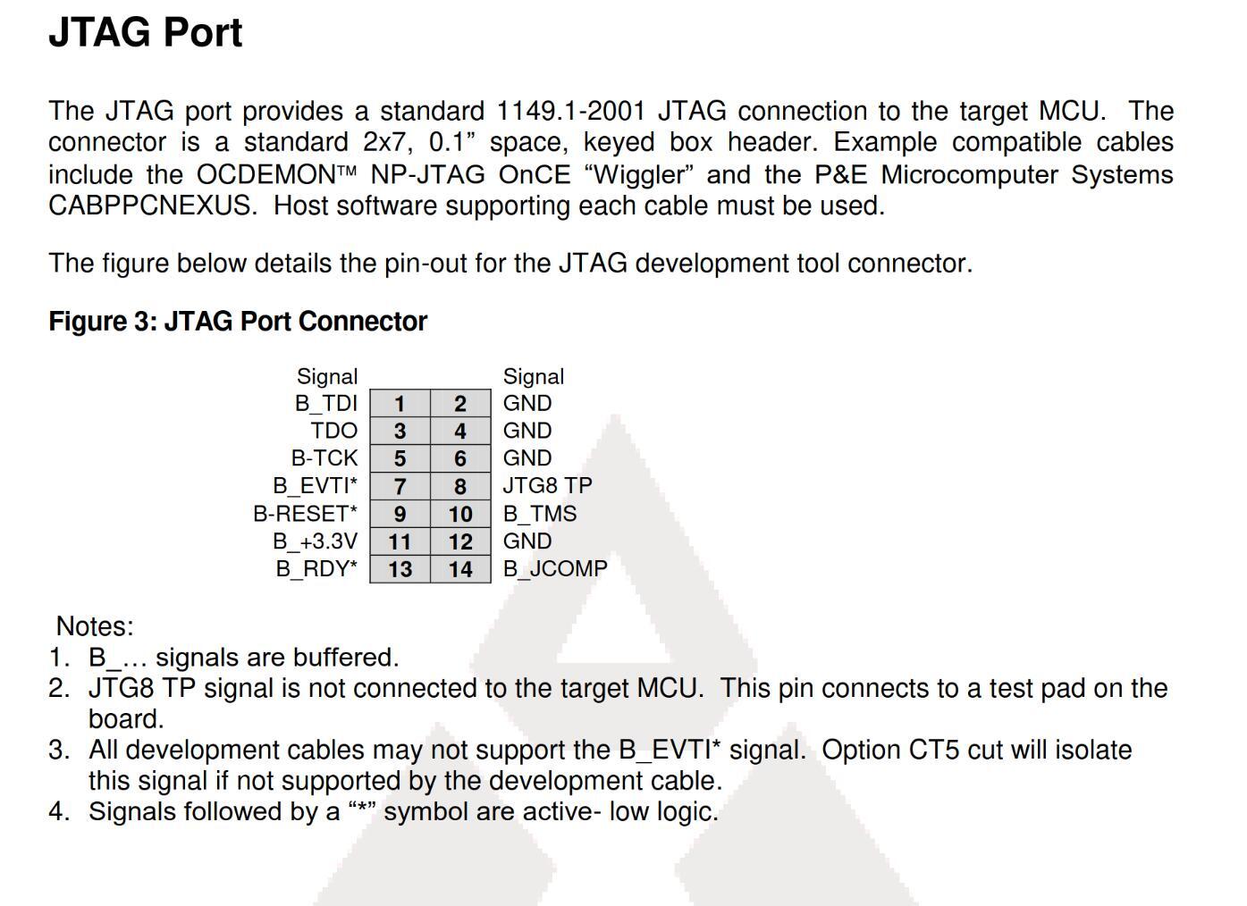

Re: Hyundai Kona CCS controller
Oh also, the microcontroller debug port CON3 on the board looks the same as the eval board debug pinout for this family of MCU:
(Source document.)
It looks like the same family of microcontrollers is used inside the Kona and Ioniq EPCU units. On some boards the exact same debug header is used, too!
There are some old-ish patch sets to add support for the "e200 Power" CPU family to openocd, for example here. I haven't looked to see if the vendor debugger software is free to download.
