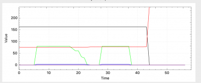

Got something to please you. I've not had chance to play it back to the heater yet, but 0x398 is in there.
0x188 and 0x207 are new IDs
0x188 would be my guess

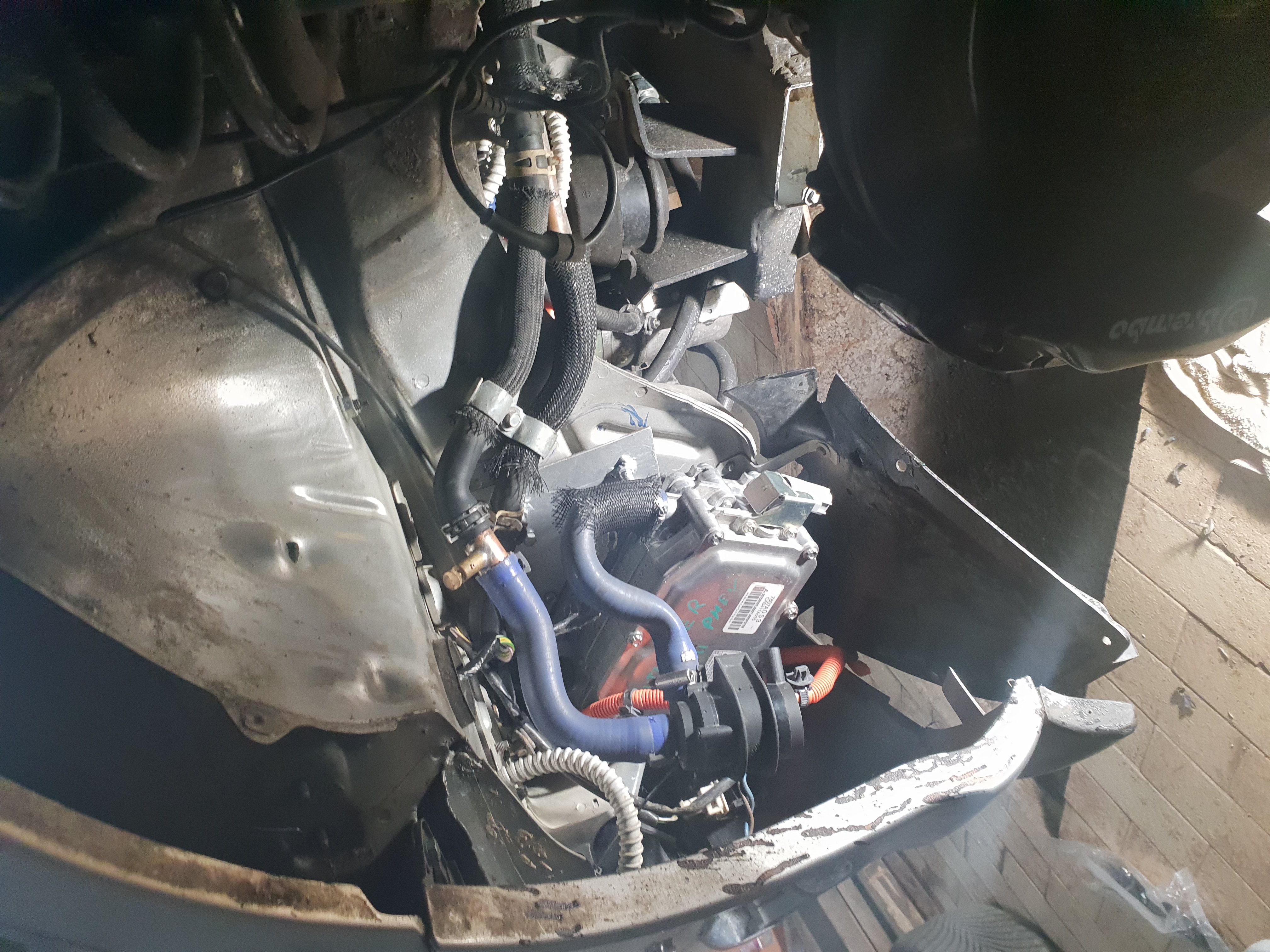

Way ahead of you :).

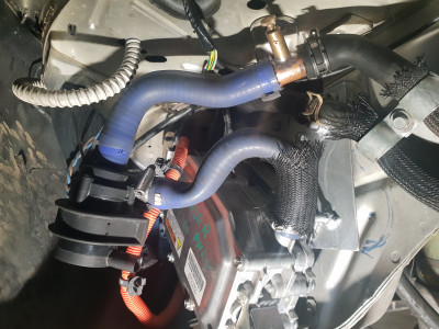

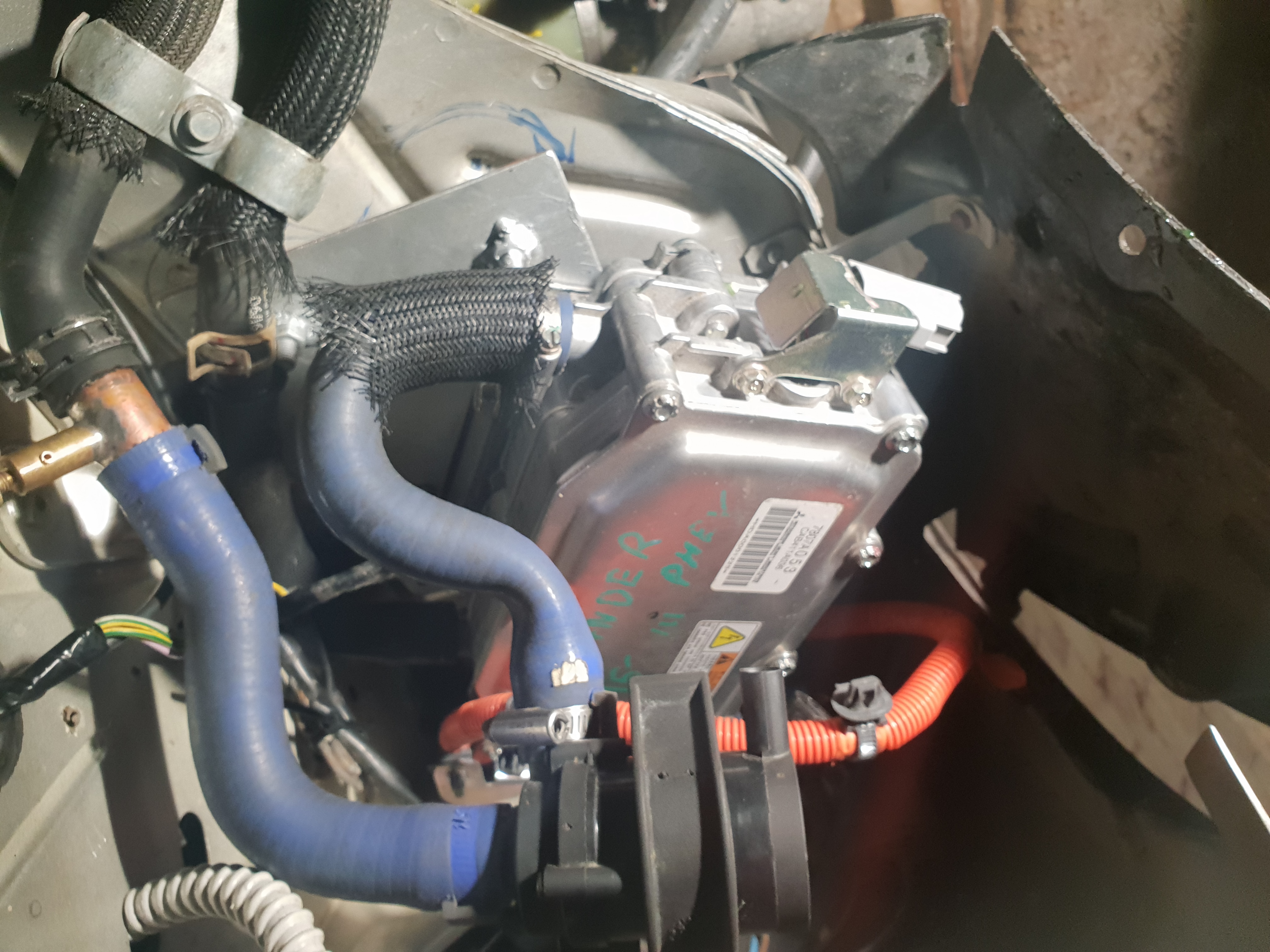

My webasto heater died on me and replacement transistors are couple of days to arrive. So i decided i will install this heater in its place.
I made a simple U mount from 2mm alu sheet and bolted it to the heater by its own bolts. To the car i bolted the mount by 3x M6 bolts, they seem to be enough. To mount the pump i needed to make separate mount so 12V pump can take the coolant in a lower level and then push it into the heater.
This means can put a simple copper tube with brass de-airing needle valve on the top.
I released air and filled the system with new coolant.

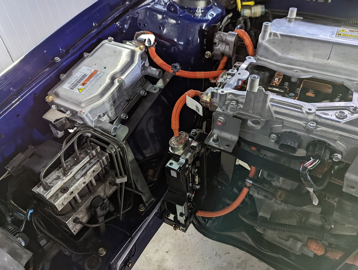

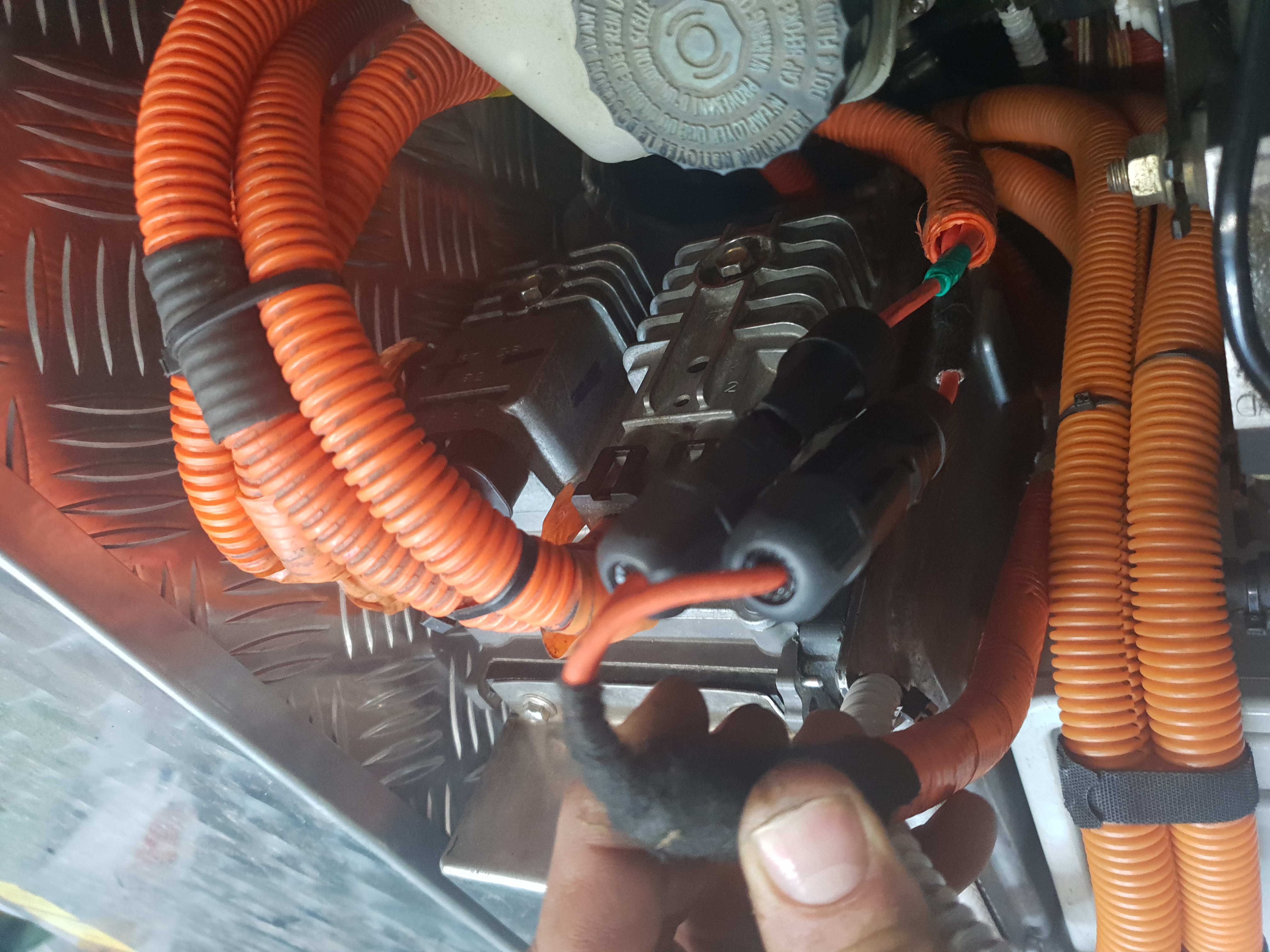

I connected the heater to HV power via the main inverters second metal connector. That originaly existed on OEM Ampera car to power the heater and AC compressor as well. To connect HV cables i used sealed solar connectors. They fit up to 5mm2 wire and are IP67 compliant. i really like them.

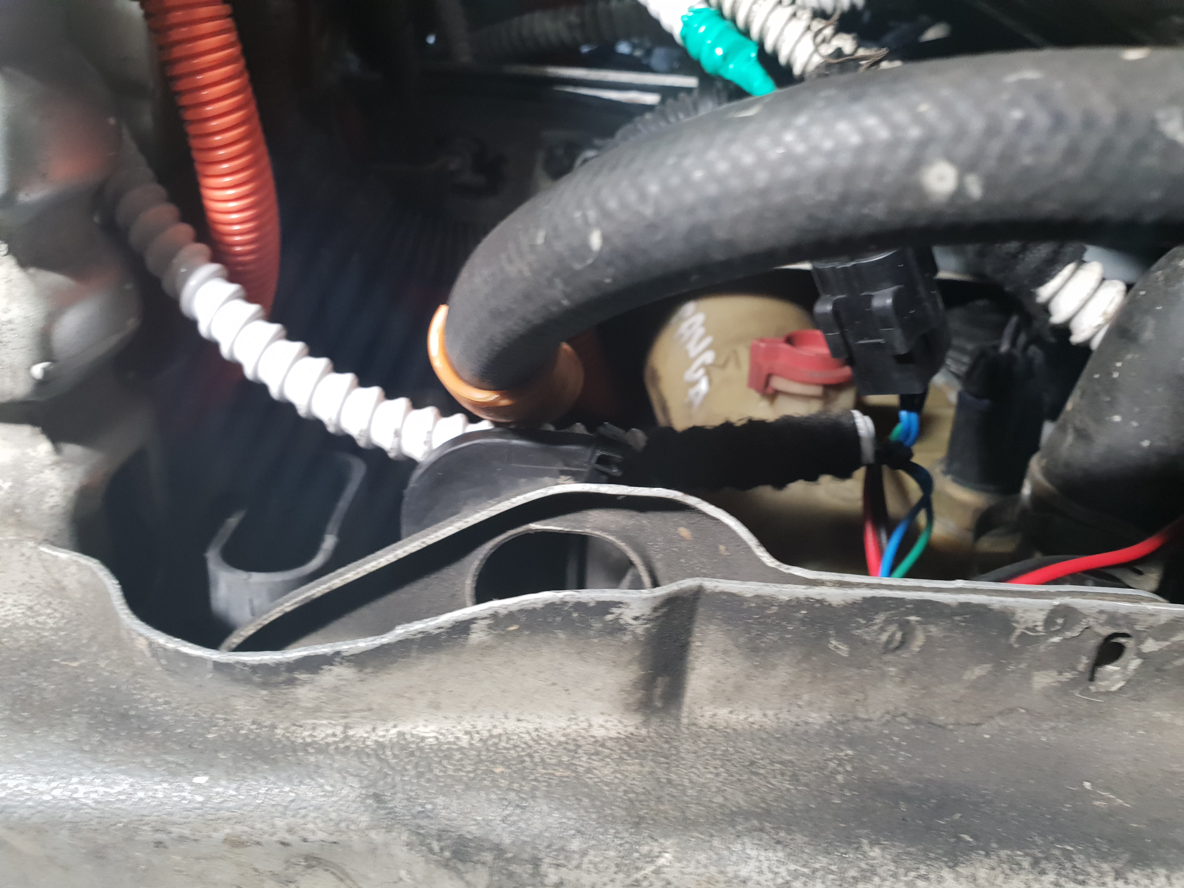

Then i connected the CAN cables to my harness from the charger. I prepared the 12V harness from coolant pump in the front to the heater and heating pump. Also there i prepared connectors for powering AC compressor and its CAN bus later on.
I figured i can wire the heater pump into the coolant pump circuit, so the system will operate if i decide to start the heater while i charge.
I have also prepared my CAN telegram to only come on if:
a) car is turned ON
b) heater button is on
This way i resolved possible precharge problems.
I started CAN bus 0x188 telegram and heater started to work with 10A!!! I still need to fit a simple switch to turn the heater on or off from the cabin. Maybe i can use the former cruise control button :).
I also want to implement a temp control into my DUE. I will do this by reading heater temp report and ammending the byte2 from A2 to 32 or 00 when some threshold will be reached.
               if(Heatertemp > 70) { // if temp is higher than 70deg
        outframe.data.bytes[2]=0x00; // when 70deg power goes to 0A
        else if(Heatertemp > 65) { // if temp is higher than 65deg
        outframe.data.bytes[2]=0x32; // seems to be current command (dec/10)
        else {
        outframe.data.bytes[2]=0xA2;

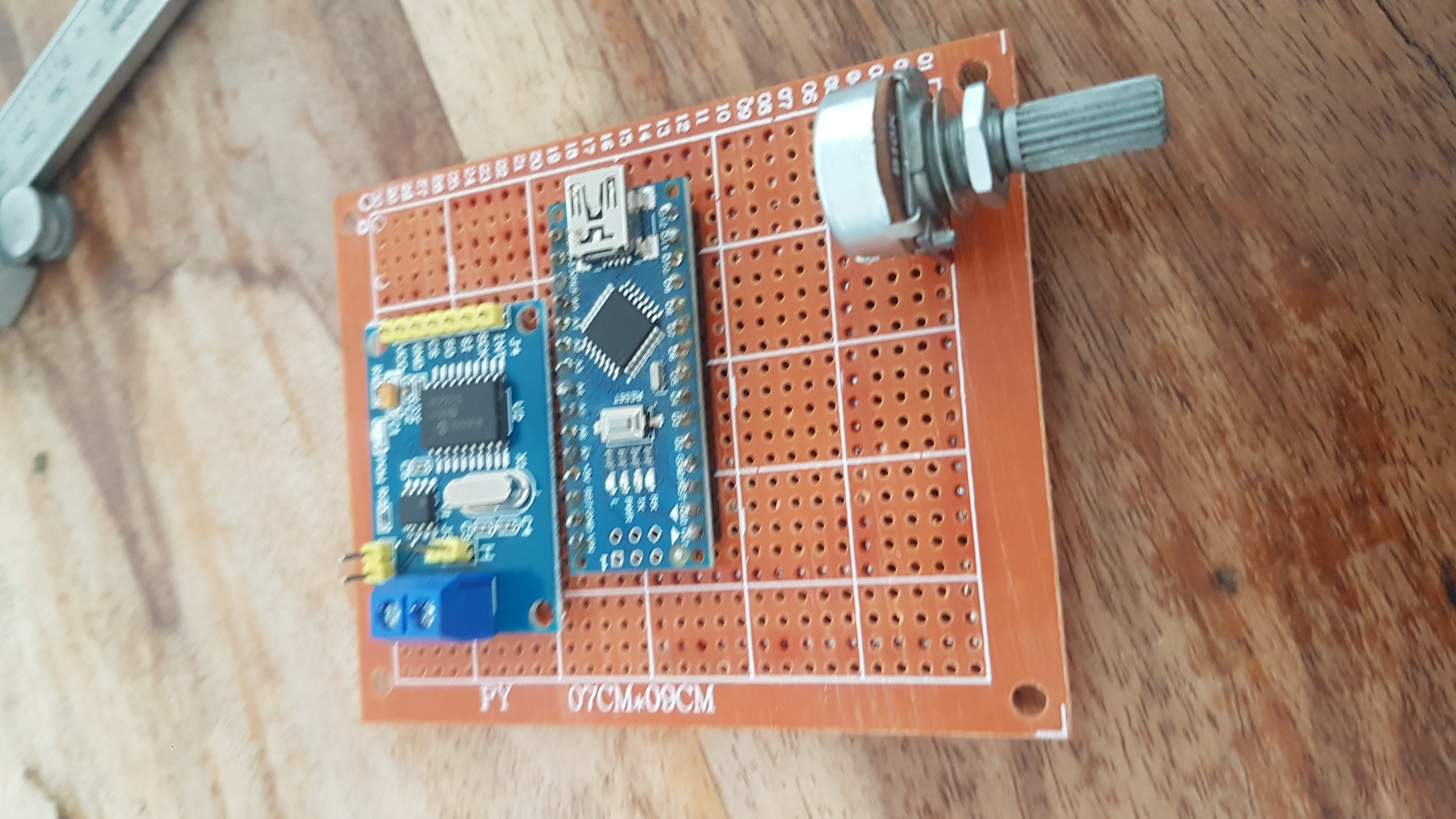

Nice. I've knocked this up, but now has and LED indicator too. First 100 ADC values are off, then the rest mapped between 55 and 80 degrees. I think I'll incorporate your value change as it approaches the desired temperature.
Started making up some brackets today, hopefully get it mounted tomorrow and start wiring it up.
I like the bleed valve idea, might have to get one.

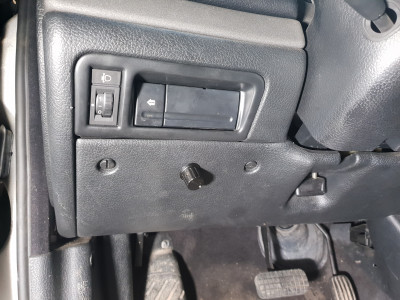

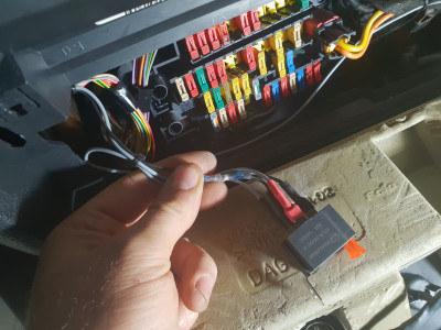

Ok i wired former cruise control button with a relay in my car to start heater function inside my code.
I deided to signal GND into my DUE where heater pin is pulled up internaly. That way i can safely interact with 12V level signals in the car.
It works really well. I have also implemented the temp control code for additional safety.
I really like this heater. It is a good form factor and easy to communicate device.
Tomorrow I will report how it works inside the car while driving. I will also see how much it taxes me with range on the road.

Zapatero
Posts: 457
Location: Germany, Ulm
Has thanked: 27 times
Been thanked: 58 times
Re: Mitsubishi Outlander PHEV heater
Post by Zapatero »
How hot does the heater get on the outside. Is it ok to mount it close to painted parts?
I'm afraid this could be too close!
