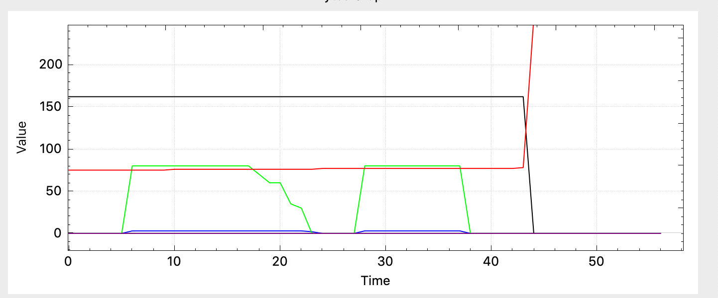

Got something to please you. I've not had chance to play it back to the heater yet, but 0x398 is in there.
0x188 and 0x207 are new IDs
0x188 would be my guess
Re: Mitsubishi Outlander PHEV heater
Posted: Tue Nov 09, 2021 5:34 pm
by Bigpie
Its 0x188 that turns it on, 0x285 is also required.
0x188
Byte 1 (0x50) could be target temperature?
Attached is the required IDs
Posted: Wed Nov 10, 2021 9:36 am
by Bigpie
byte 2 seems to control power/temperature but not sure how yet. Working on a DBC file:
https://github.com/jamiejones85/DBC-fil ... Heater.dbc

Byte 5 is status 0x00 is not heating, 0x40 is heating.

I tried to use those parameters and it worked!
0x188 03 50 A2 4D 00 00 00 00
EDIT: I found out heater will also work with 500ms signal
Also i changed byte2 from A2 into
12 and i got 0.1A
22 i got 1.8A
32 i got 3.4A
42 i got 5.6A
52 i got 5.6A
62 i got 6.8A
72 i got 6.8A
82 i got 8.5A
0x389 01 3A 1D 6E 6E 38 00 00
byte1 seem to be current report of 3A = 58, so...
current= byte1(dec)/10
byte2 could be power applied. It certainly changes fast enough with current.
at byte1 55 byte2 is 2F?
I see 8A to10A current and water temp rises quickly, it went on to 6D = 109deg? Not likely! I think the value is offset by -40deg similar to the charger and DCDC. This would mean:
Temp= byte3(dec)-40
Sure enough i measured output water at 63deg with byte3/4 at 6B which is 67deg!
I stopped at temperature 6E where heater still pulled 5.8A from the battery.
My setup got quite hot, but i am really excited with it working. Now we just need to figure out how to set the temperature.
