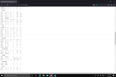

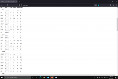

I've begun to dig into optimizing the tune for my car. I started out with Jon's updated parameters and tuning guide, and the first major change was to adjust the udcgain because it was way off and causing issues with regen, phantom spinning etc.
Since this change, I now slam into an over current fault whenever I stand on the throttle. I think I need to adjust the current limit, but I first started examining how far off the current reading was from reality. Based on comparisons to my ISA shunt, output via the CHAdeMO web interface, the LDU is reporting a calculated idc of roughly 16% of what the ISA shunt is seeing. Being that it is this far off, I'd like to get the current reading correct before playing with settings.
I assume the adjustment needs to be in the two current sensor gains, but because those are on the AC side, I don't have a good way to figure out how far off they are.
Has anyone figured out what the current gains need to be for a base LDU?

Re: LDU parameter tuning
I should probably update the parameters now that there’s been some fundamental change to the newest firmware with fweak stuff.

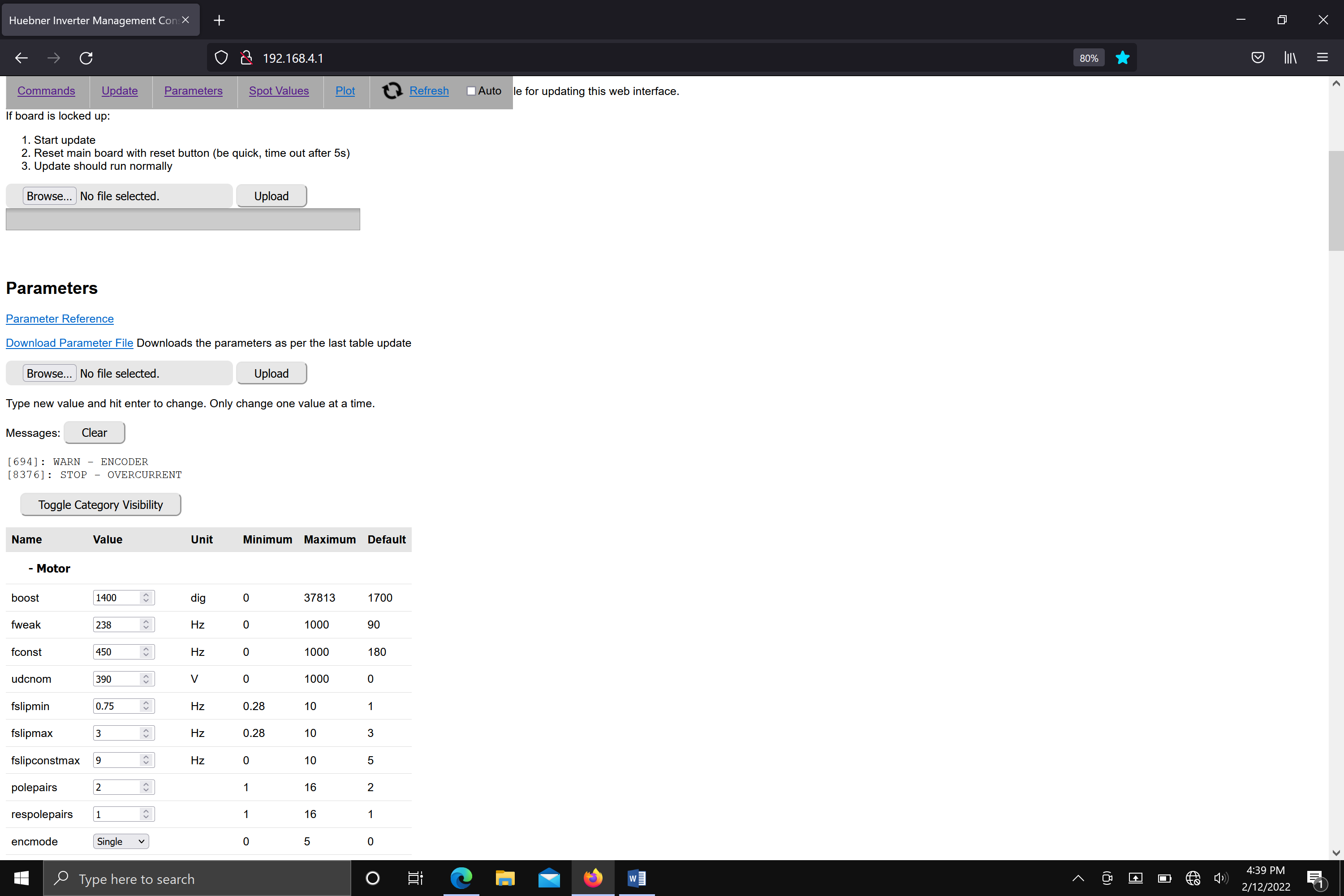

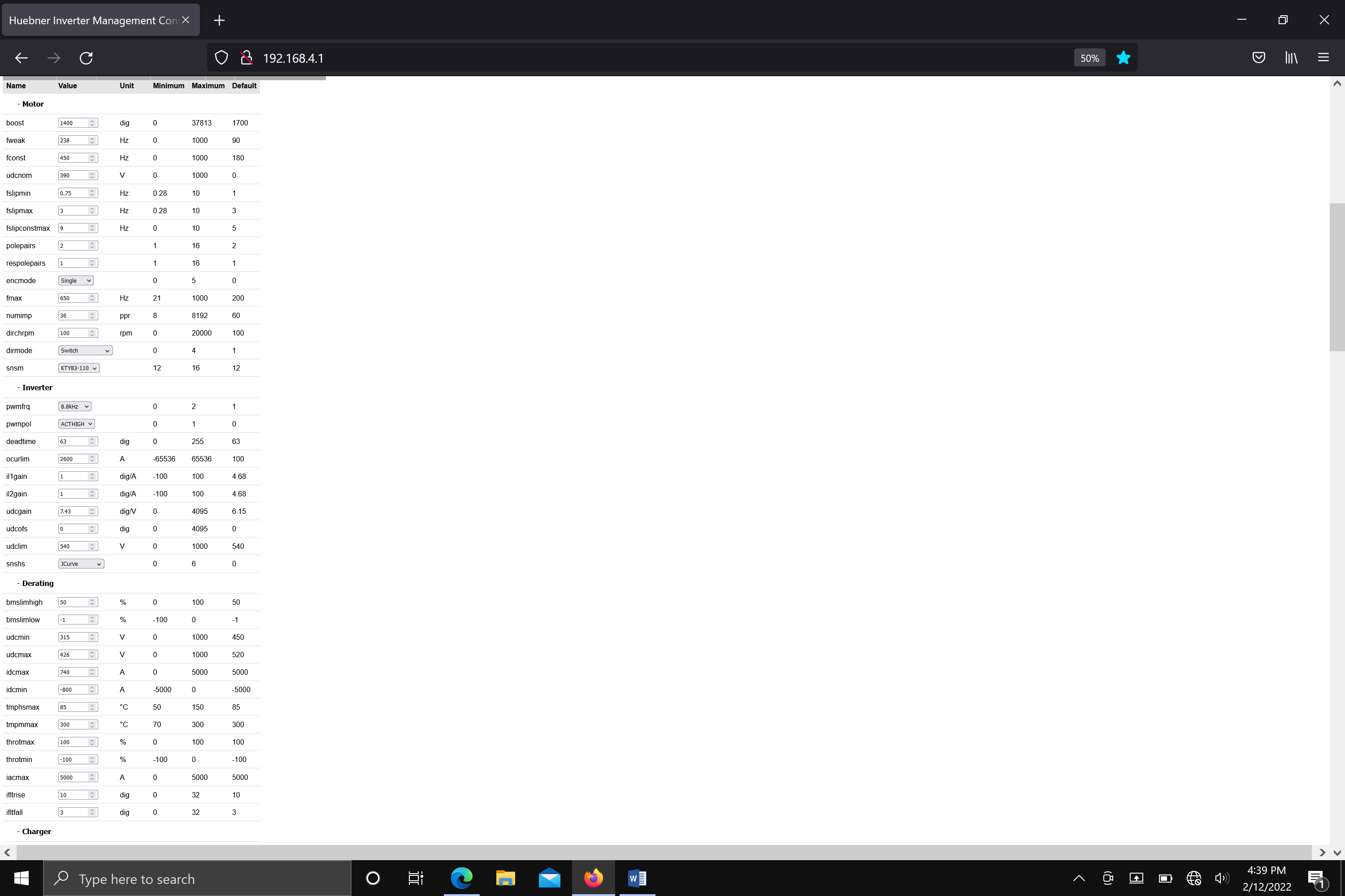

So I took the car out to make a few pulls, and tried several different settings. I continue to slam an overcurrent fault when launching hard. It feels like it is occurring right as the throttle ramp ends, i.e. when it should be delivering full power.
Oddly (to me at least), it also shows an encoder fault when it trips the overcurrent fault (see below screenshots below, yes this is from this event, I cleared the errors before the test).
The screen shots are from an attempt with idcmax of 740, but I tried as low as 700 with the same results.
Anyone see something glaringly wrong or do I just need to keep pulling back?

Isaac96
- Posts: 656
idcmax is a pretty slow limiter, probably won't prevent an OC event. It's more often used for reducing power long-term to protect batteries, and even then only works well with FOC (and thus PM motors).
Raising fweak might do the trick, as it will move power delivery further to the right on a torque curve.
Mr. Volk's modified software with the new parameters made significant driveability improvements to my SDU-powered vehicle (before the third inverter blew), it ought to improve your experience a lot.
Version 5.14.R has VolkSoft integrated. I take it that I should now ship LDU boards with udcgain 7.43?
Only other sub-optimal setting is encmode=Single which might be more sensitive to noise. ENCODER fault means it sensed an excessive slew rate between two adjacent pulses, factor three between them if I remember correctly. Usually means noise as the motor is not going to reach 3 times the speed within 1/36th of a rotation
I'll try updating the firmware next weekend and see where that gets me.
7.43 got me within a volt or two, but isn't perfect. The interface wasn't letting me do 7.41 or 7.42, which likely would have been closer. I'm not sure if this applies to all LDUs, has anyone else adjusted theirs that can confirm?
What should it be set to?johu wrote: ↑Sun Feb 13, 2022 9:40 am Only other sub-optimal setting is encmode=Single which might be more sensitive to noise. ENCODER fault means it sensed an excessive slew rate between two adjacent pulses, factor three between them if I remember correctly. Usually means noise as the motor is not going to reach 3 times the speed within 1/36th of a rotation![]()
I had been having actual encoder faults that prevented me from taking off from a stoplight (car would only lurch like there was no encoder signal), but I cleaned up the connection of the shielding and that seems to have solved it.
AB is the standard setting but with more hardware requirements:
a) A/B channels maybe swapped resulting in no movement
b) A and B must both be functional
Single uses either A or B

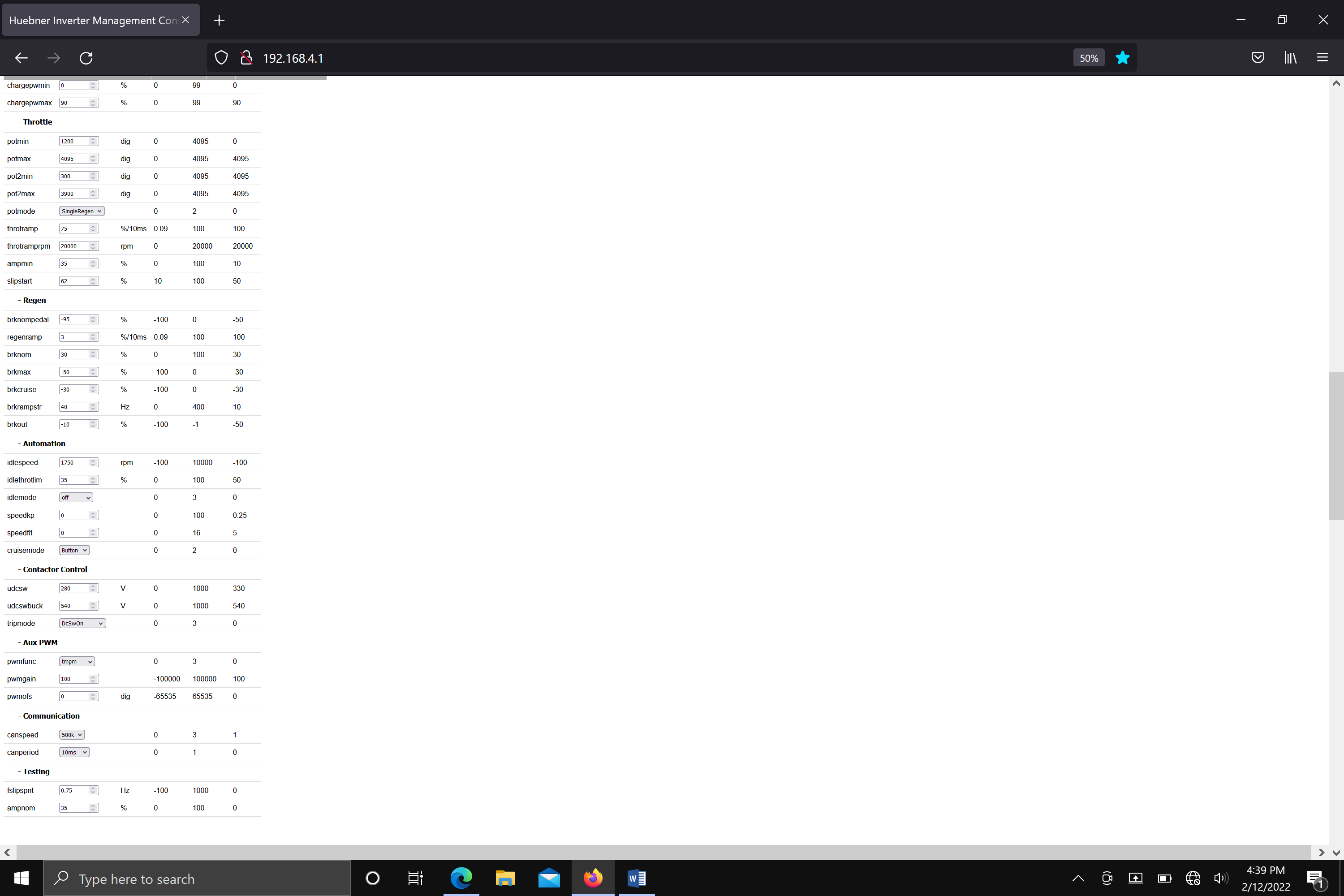

Additional update: I went back to Jon's excellent tuning guide, where he mentioned that using idcmax, he could get a bit higher fslipmax.
I went back out to my top secret testing location (a new housing development where only the roads are complete) and started by droping the IDCmax all the way to 600, then starting working the fslipmax up from 2.71. At 3.2, I would get an overcurrent, but not at 3.1. So I saved at 3.1, and began increasing the IDCmax. I was able to bring IDCMax all the way to 700, before my body decided that had been enough hard launches in a row, and I had no desire to see my lunch again.
The one caveat is that the pack was 60-70% charged during this test session. I will head out tomorrow with a full pack to confirm this set of parameters, and see if there is any more in it.
As a note, I dearly miss the low speed performance of v5.14 with VolkSoft. If anyone has ideas on how I can use that version and get good regen, please let me know.
Are you using pot2 for anything? If not, set both min and max to 4095
You can also use much more aggressive regen settings since zero throttle fweak is higher.
No, not using pot2, I'll make that adjustment.
I had on brake regen set to 90% and had absolutely no regen even with the brake full on for several seconds.
Welp, I've got good news, bad news, and worse news.
The good news, Jon was correct, setting pot 2 min and max to 4095 brought back the regen.
The bad news - all of my data regarding full throttle overcurrents is likely garbage.
The worse news - I broke an axle, and I think it has been partially broken for a while.
Some background: to adapt between the Tesla axles and GTO axles, I cut each on an angle, welded them together, and then sleeved them and welded on a sleeve. At this point, the axle has broken the sleeve. Based on the noise made during this break, I have a theory about what was occurring, and why I was having over current trips.
I believe the axle was broken but was being held together by the sleeve. This would hold together until full or near full power was achieved, where it would suddenly slip, causing the motor to suddenly change speeds, and thus triggering an overcurrent fault. I was hearing a bang during these faults, but chalked it up to sudden slack in the drivetrain. I now think it may have been the reverse: sudden slack in the drivetrain causing an overcurrent.
I'll know more once I get the axle out of the car. the only further good news is I already had a plan for upgrading the axles (ZeroEV adapter platres and then custom axles), I guess that I will have to do that now rather than this fall.
