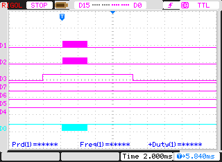

Some more testing done here this morning. Using my non-optimised code it takes 2mS to pack 80 bytes of data and about 4mS to unpack, but we can speed up the CPU and optimise the code so not too worried about that. I did a loop-back test and I can decode the data fine, so what i'm seeing coming back in on the loopback is identical to what I'm getting on the Arduino lenonardo.
I'm using the 80 byte HTM setup frame for testing here, the complete transaction (pack - send - receive - unpack) is taking 10mS, which should be fine.

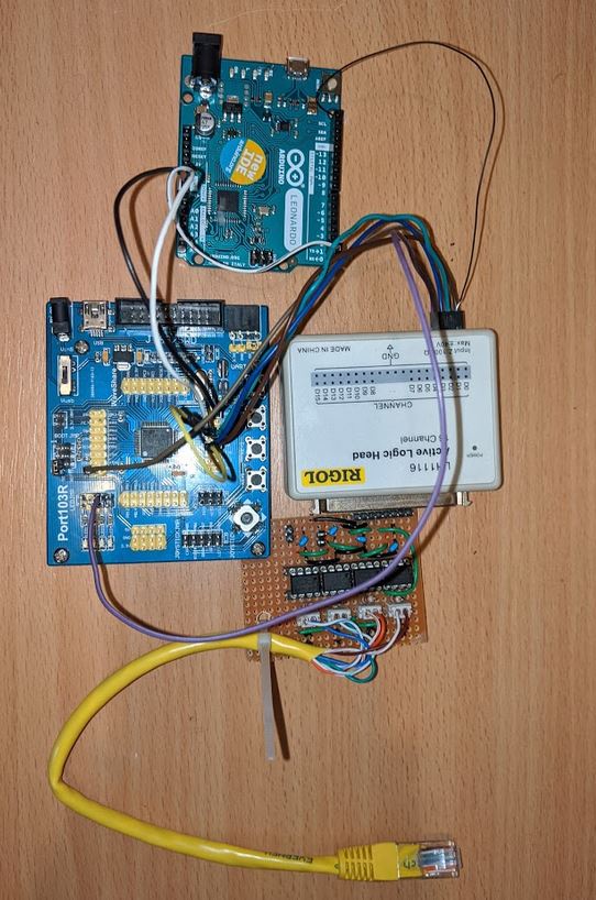

Given the tests above seem to look good, i'm going to connect on the physical layer, from my Leonardo logger i have 4 CAN Transceivers on some vero board so these will be jumpered over onto the STM32. If these look good on the scope I can plug the RJ45 into my GS450H harness and test the comms ;)

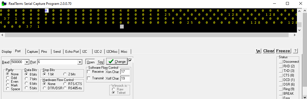

I believe I'm able to correctly do one data transfer from the GS450 inverter, the MTH checksum is correct and the data length looks good too. My only problem is the "second transfer" i do is shifted by one bit and i'm not sure why. It is like there's 1 additional clock pulse or a pulse missing, so the next transfer is out of sync.
I've tried all 4 SPI settings, so will need to figure out why this is happening, none the less, it is encouraging even to get one good transfer from the unit. Once I'm able to read the data i can experiment with sending data.
