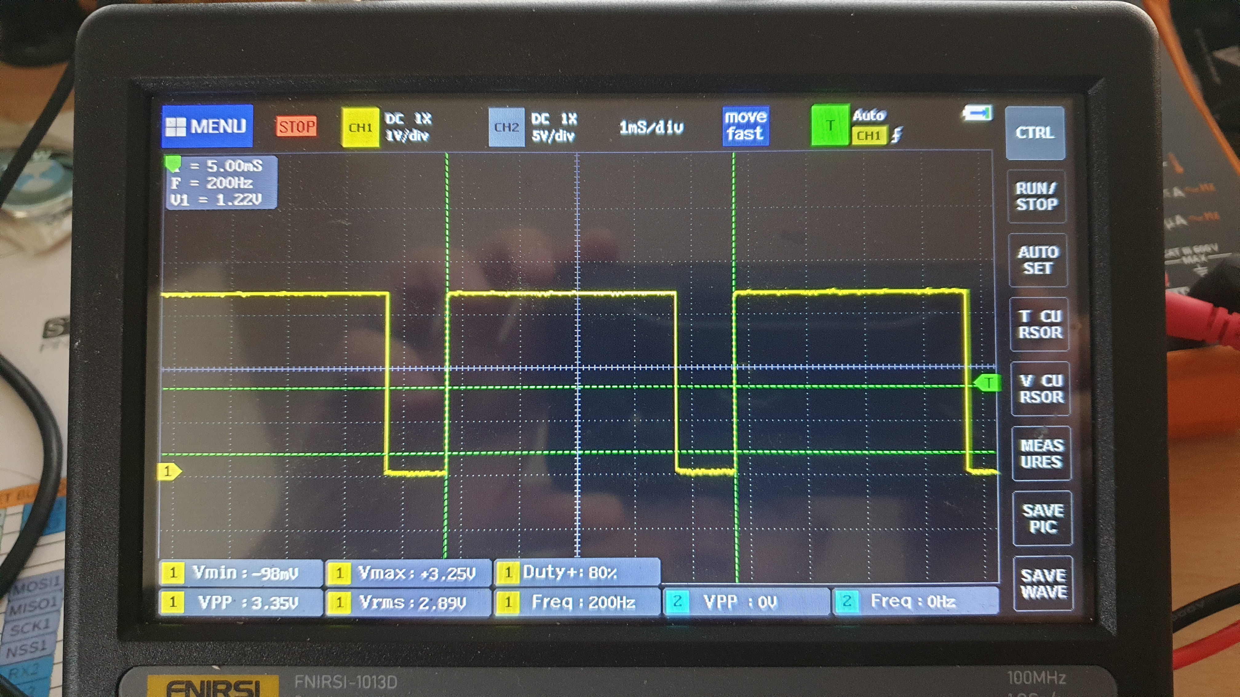

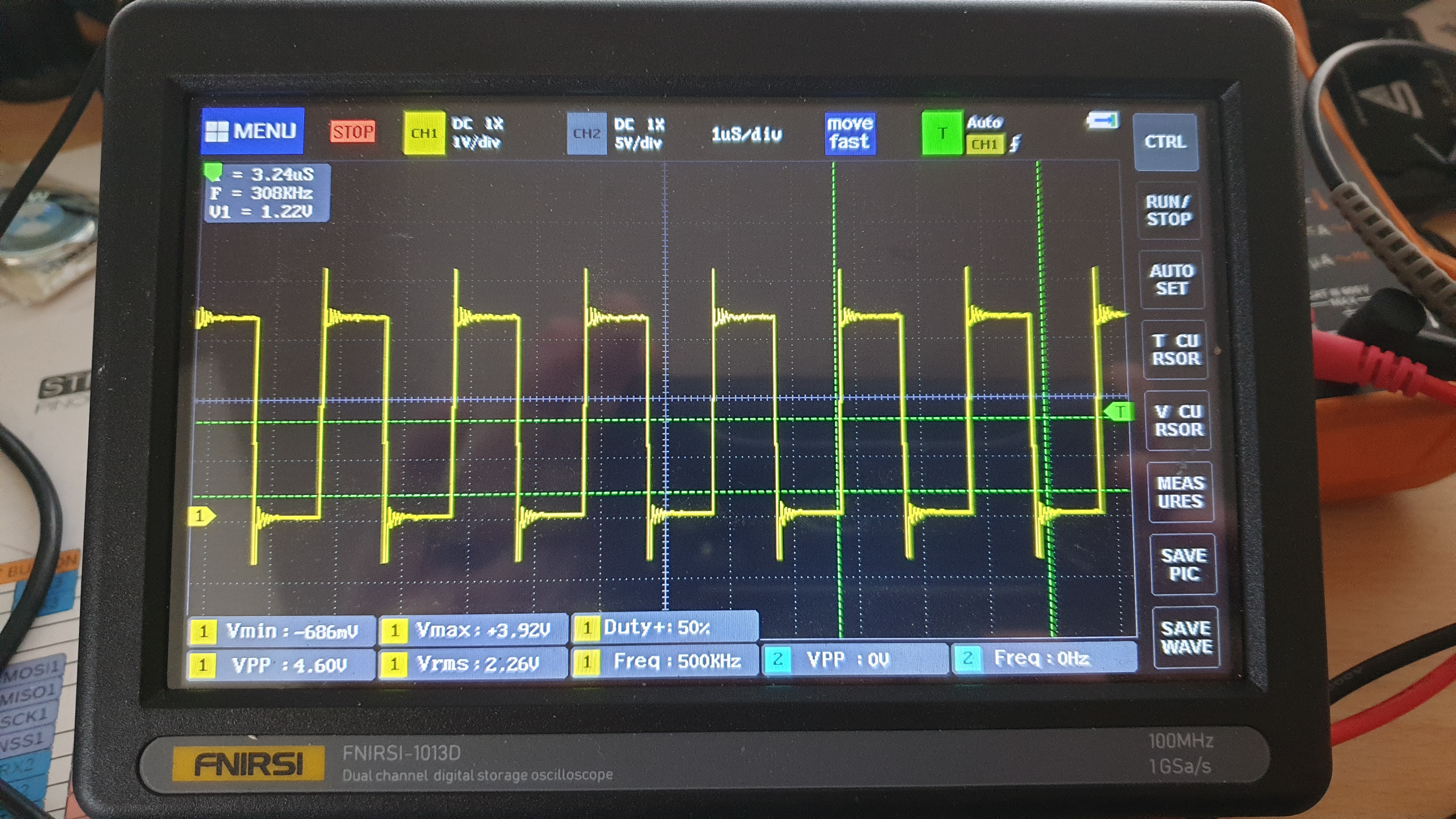

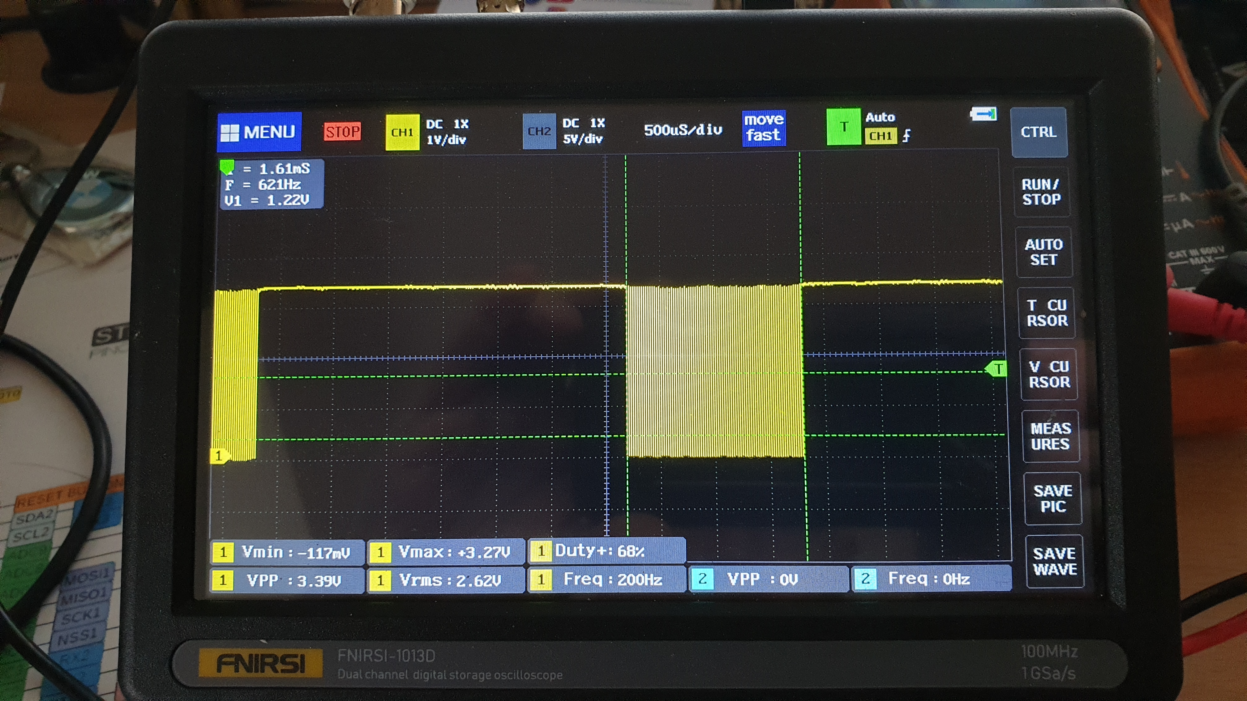

So just using a little cheap tablet scope here in the office looks like the Req pulses are happening every 5ms, clock is firing away at 500khz and one tx data packet is taking about 1.6ms. Also have the oil pump 1khz pwm on timer 1 up and running. Poor timer1, once the driver of igbts and motors now just relegated to a boring single channel fixed duty output :)
