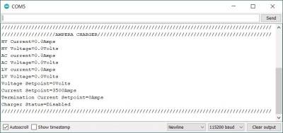

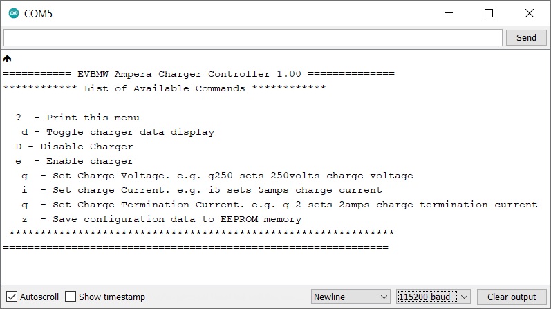

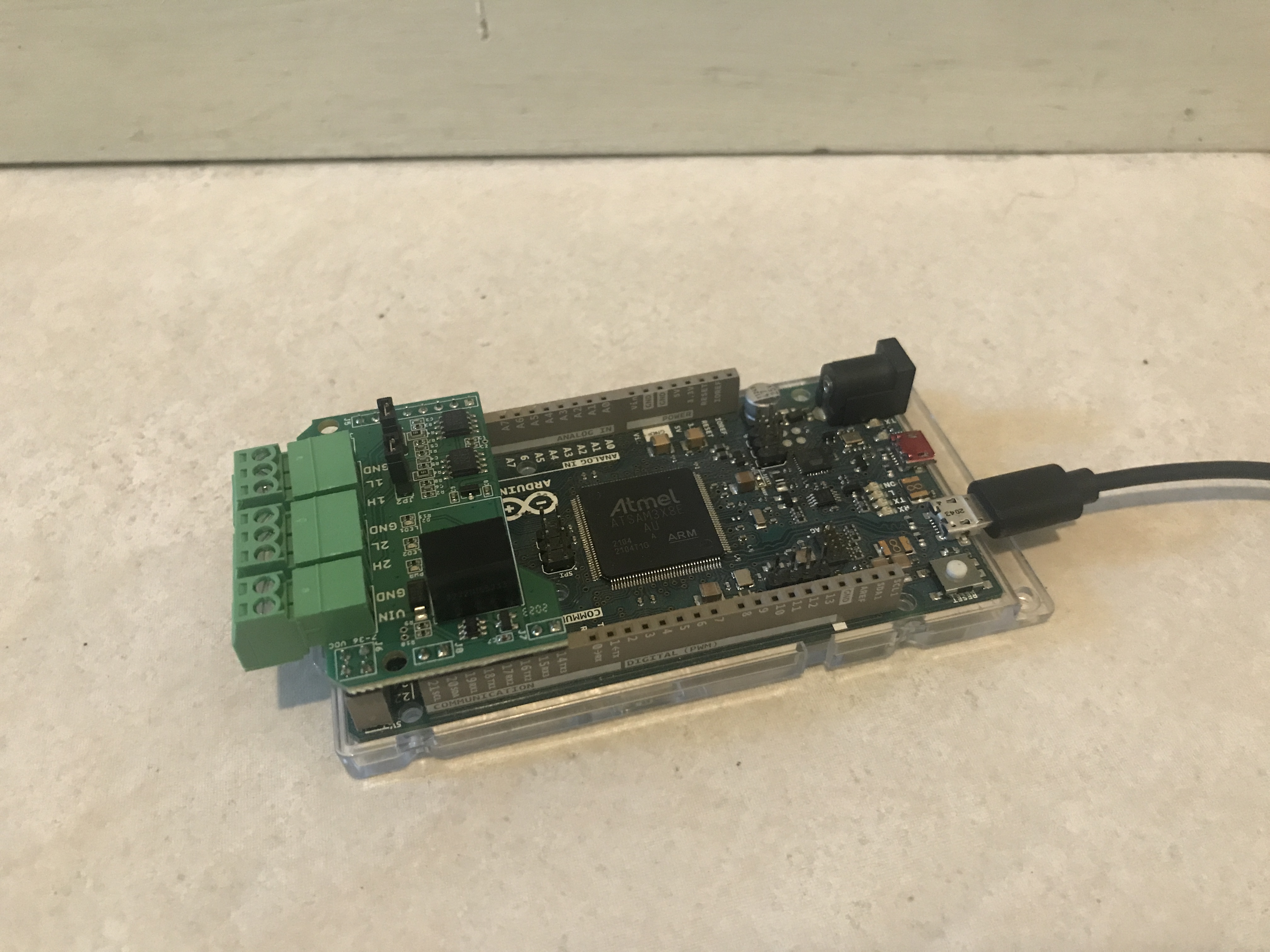

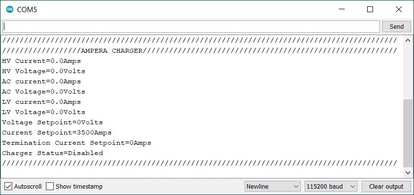

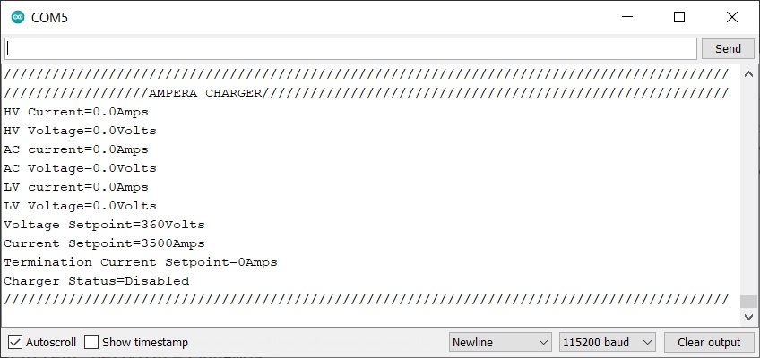

so I am successfully charging the truck using a first gen Chevy Volt charger and Damien's free Arduino sketch off of GitHub, however, I am unable to save the setpoint configuration to the EEPROM on the Arduino Due I am using
Wire.begin();
EEPROM.read(0, parameters);
if (parameters.version != EEPROM_VERSION)
parameters.version = EEPROM_VERSION;
parameters.Vol=0;
parameters.Cur=0;
parameters.Term=0;
EEPROM.write(0, parameters);
case 'z':
SerialDEBUG.println("Parameters stored to EEPROM");
break;
Posts: 3796
Been thanked: 413 times
Re: Chevy Volt Gen1 Charger
Gregski wrote: Wed Aug 09, 2023 2:59 pm lessons learned DUE.jpg
Well you could still direct your due code to those basic values you want without eeprom. But true... in the spring i managed to design a due board which didnt allow me to connect USB port...DUH! No eeprom would help as i couldnt select the values.
Didnt that can board come with eeprom chip pinout? I allways assumed so.
So do i send you one of my due boards? I think i still have one functional. I must apologise i forgot last time we discussed this...

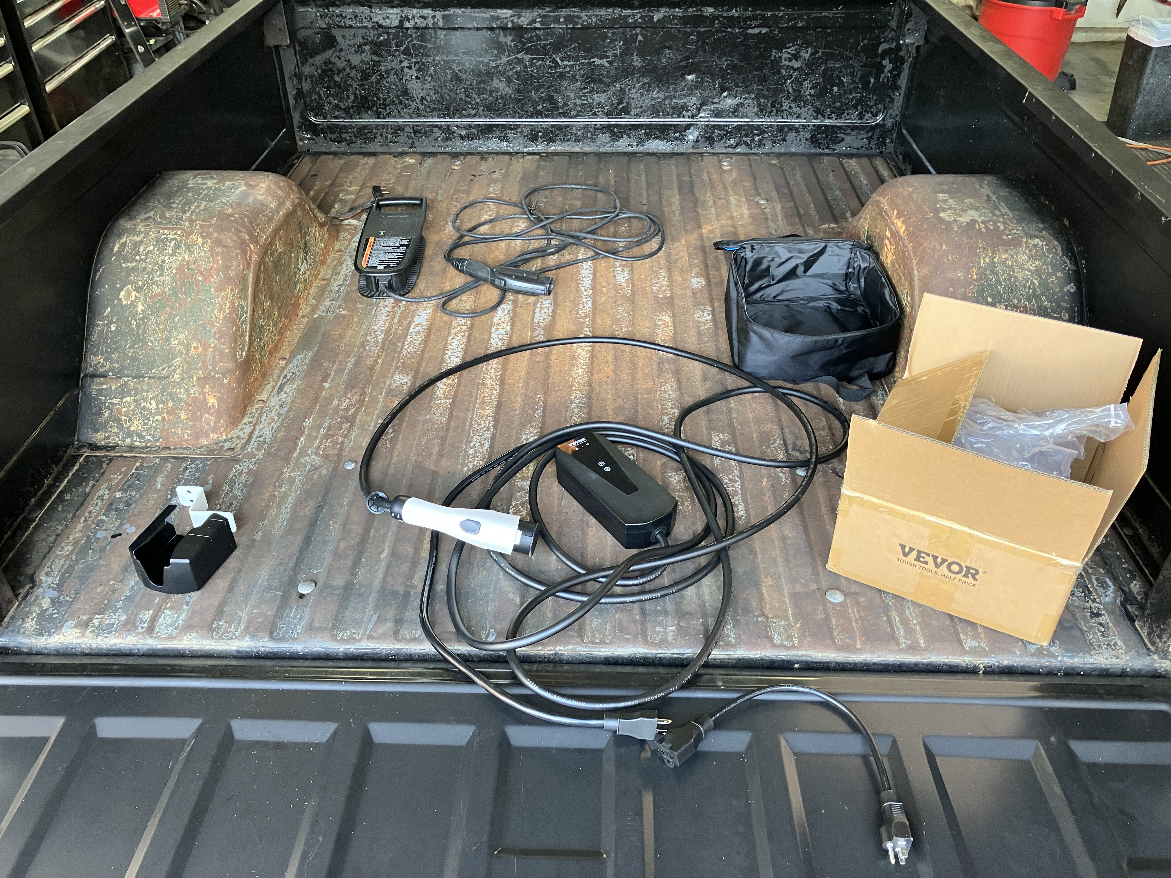

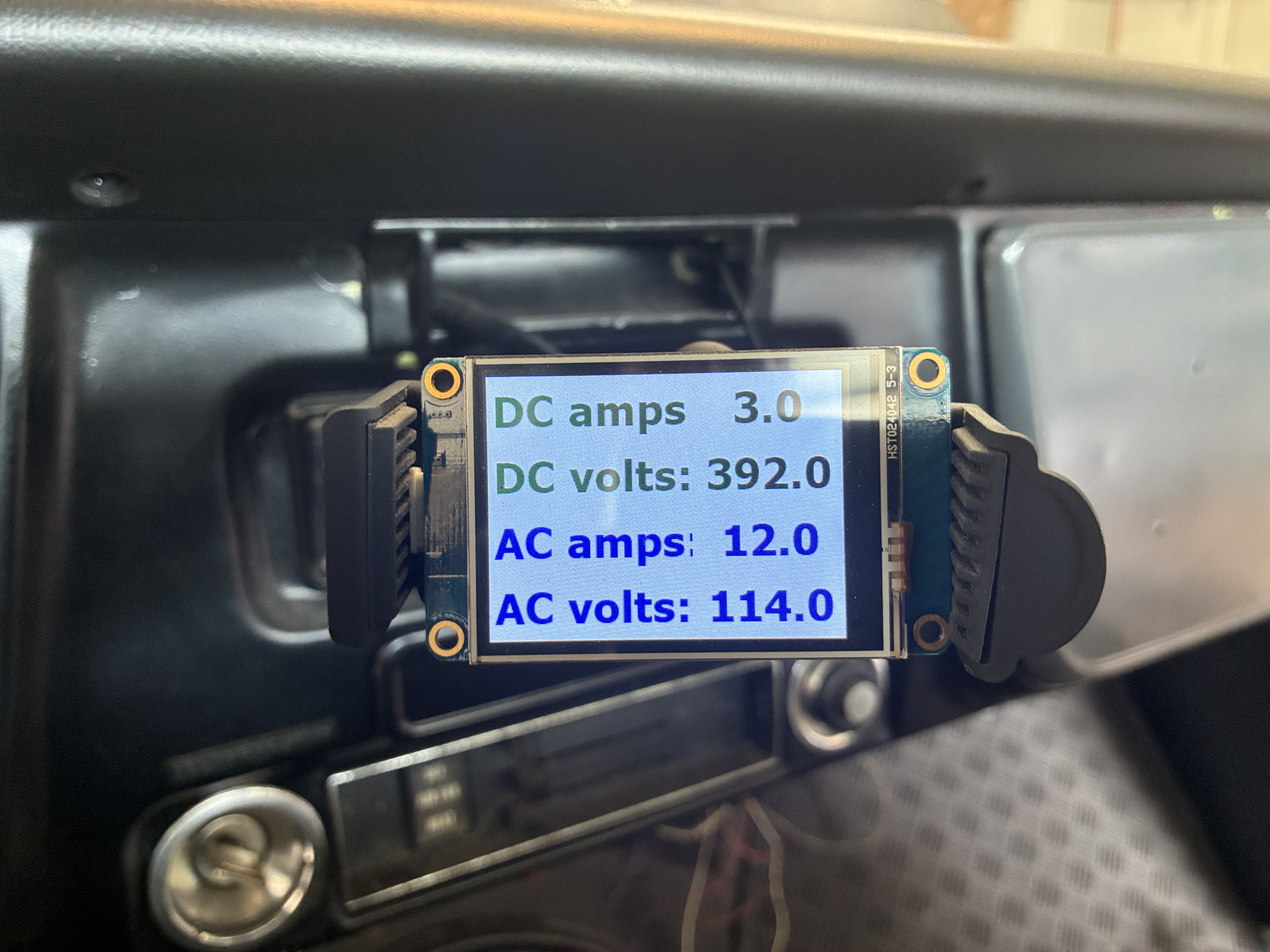

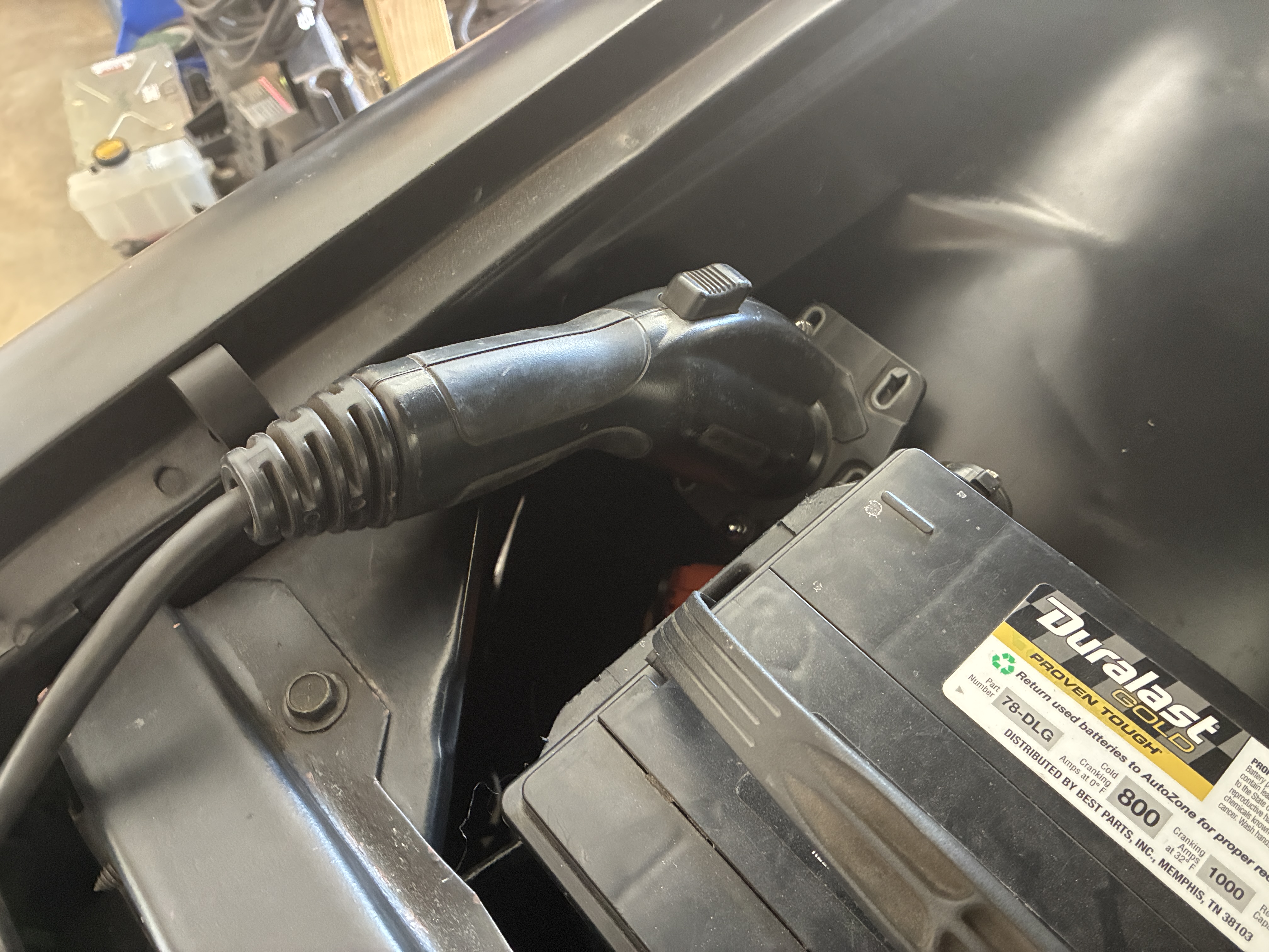

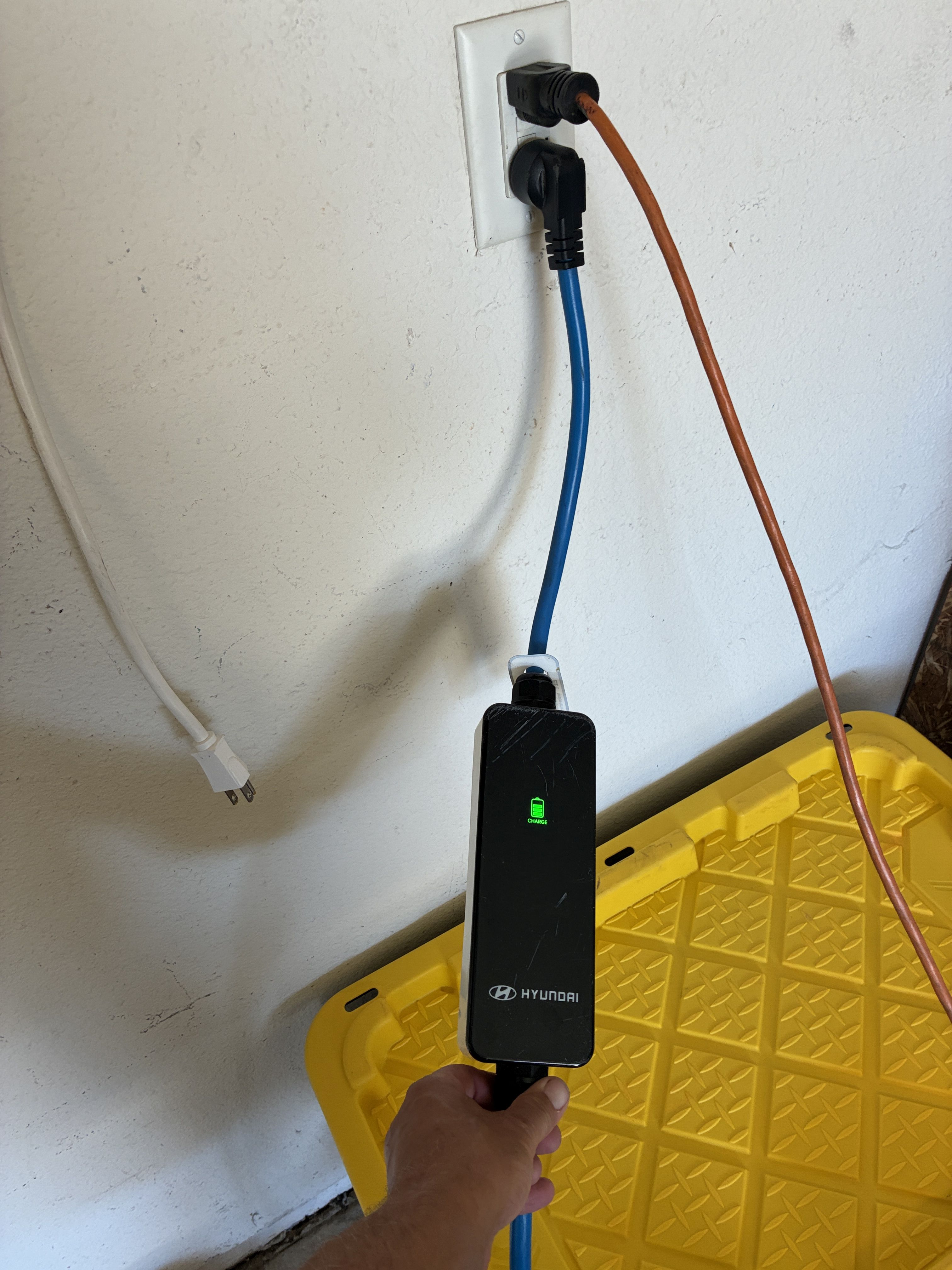

not sure if I should have started a new thread for this issue, if you think so I will, but here it goes
had a 1st gen Chevy Volt charger in my truck with the BMW PHEV 530e 9 kWh battery 6 module pack for over a year running the Legacy Lexus GS450h VCU controller and Damien's GitHub code and VEVOR Level 1+2 Portable EV Charger, 16 Amp 120V or 240V and a Active Vehicle Control Module AVC2 to charge, and things worked great during that time
recently replaced the 9 kWh battery pack with two 12 kWh packs for a total of 12 modules, I swapped the 9 kWh sBox with one of the two 12 kWh sBoxes, and now it won't start charging. I made no changes to the code.
Charging with my OEM Hyundai Ironic 5 120 volt charge cord does work, maybe that's a clue
[I will build up/add to this post more links, details, and pics if that helps]

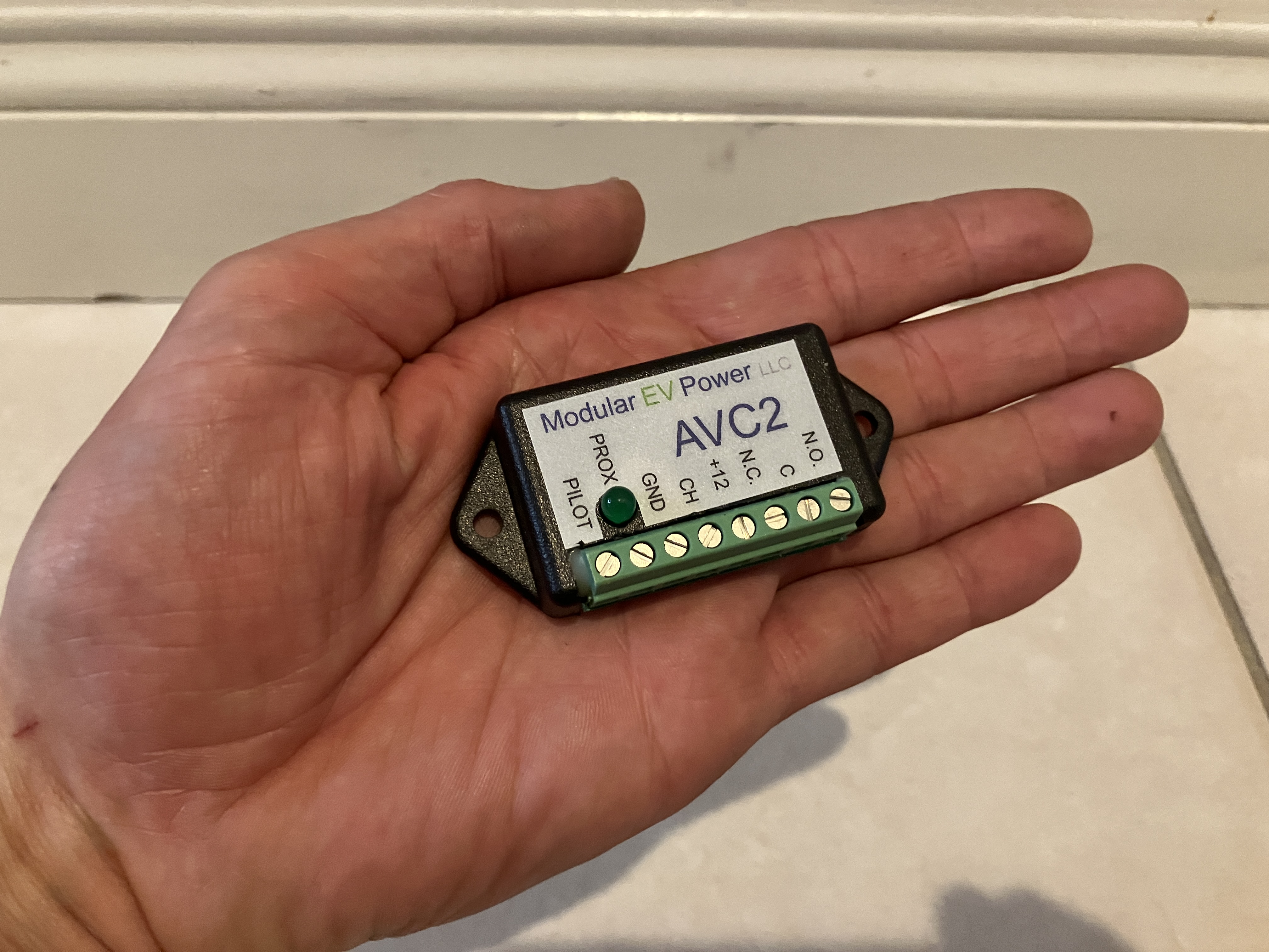

Are you sure the AVC2 is working? I've had one flake on me before.
Gregski
Posts: 3164
Has thanked: 635 times
Been thanked: 1610 times
Post by Gregski »
P.S.Mangelsdorf wrote: Wed Oct 08, 2025 4:10 pm Are you sure the AVC2 is working? I've had one flake on me before.

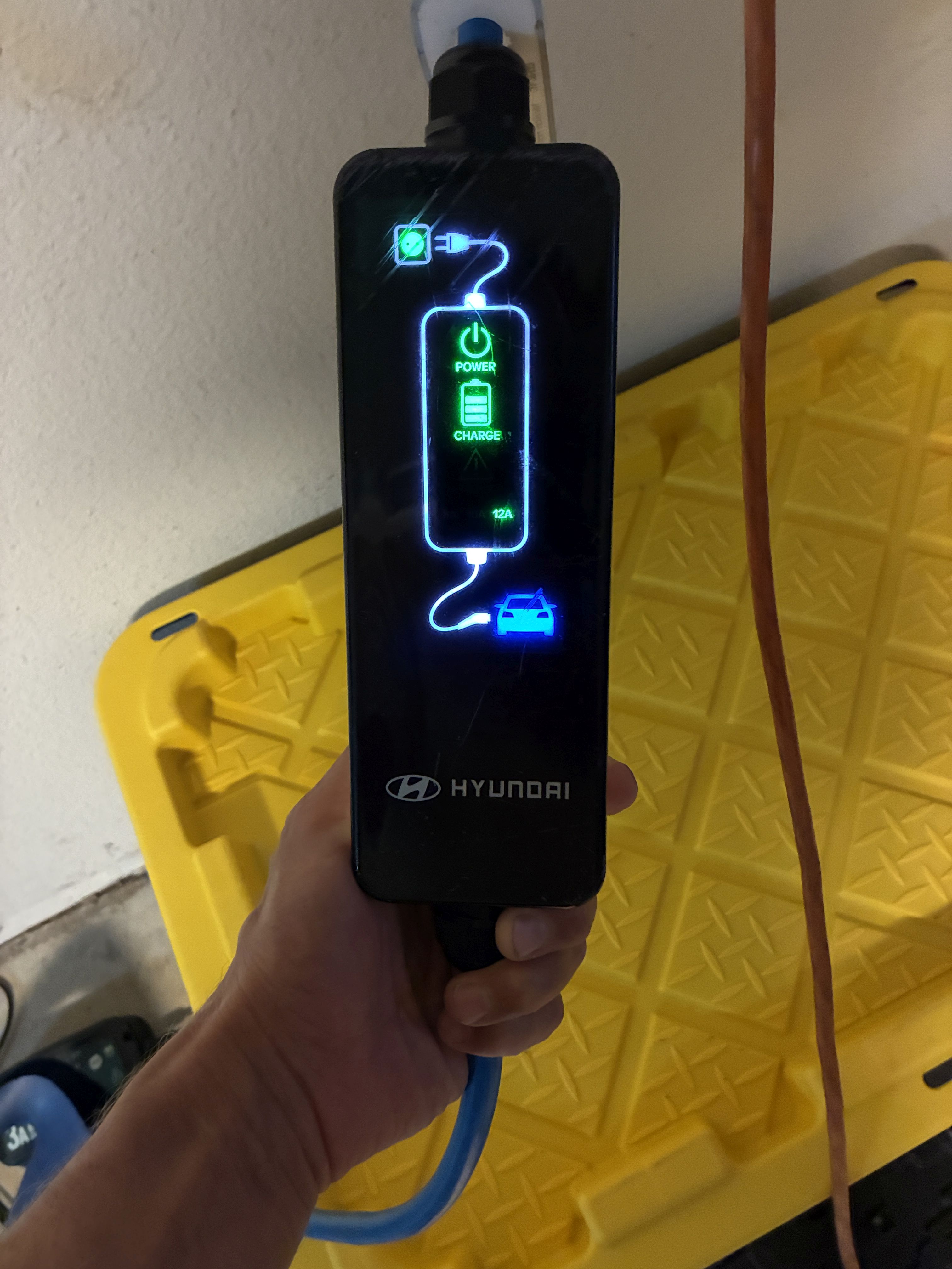

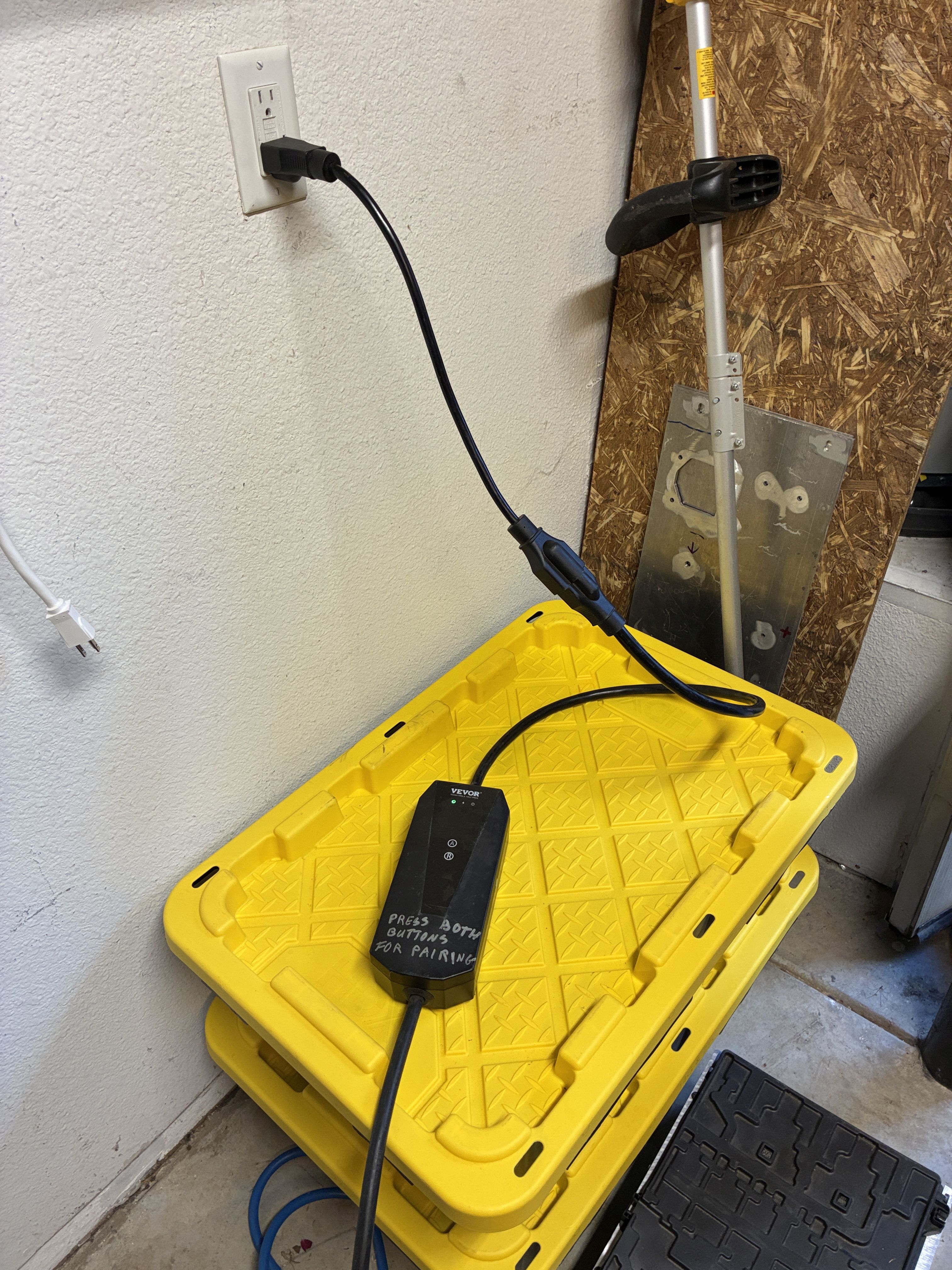

thanks for trying to help, yes it is, it is charging with the Hyundai 120 volts charger cord, but you just gave me an idea I will plug my 240 volt Vevor into my 120 volt outlet as it is a combo unit and see what happens
this is the OEM Hyundai charge cord

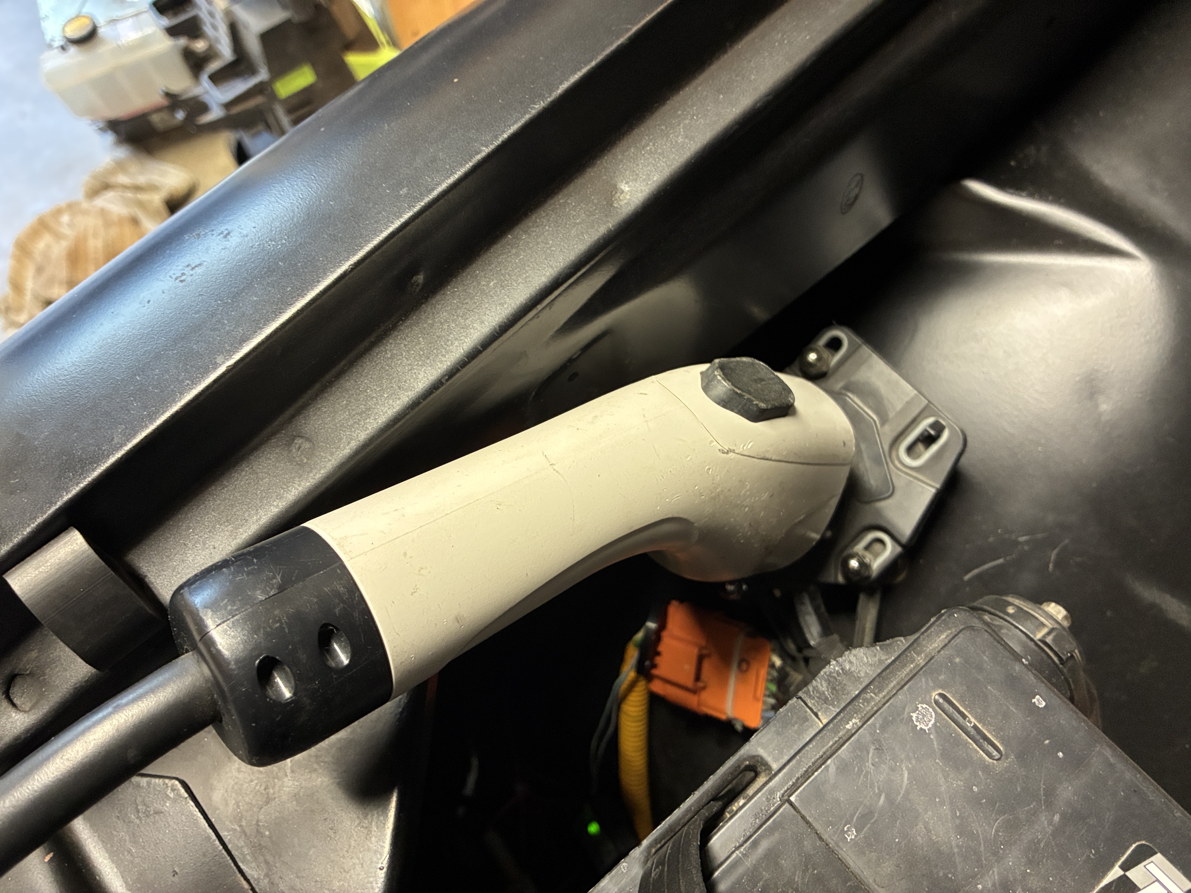

Gregski wrote: Wed Oct 08, 2025 3:56 pm Charging with my OEM Hyundai Ironic 5 120 volt charge cord does work, maybe that's a clue
Please clarify the following:
1. AVC2 turns on the 120Vac Hyundai granny lead?
2. AVC2 does not turn on your new 120/240Vac charge lead?
If both are true the issue clearly is between the charge lead and the EVC2. Possibly wiring, resistor or expected Proximity line status ect.
You only changed one variable between the 120Vac Hyundai lead working and the other lead not working.

tom91 wrote: Wed Oct 08, 2025 4:43 pm Please clarify the following:
- Yes and it charges fine
- Yes but then it seems to drop, rather strange behaviour like it tries then it quits, but it does that only once, once I reconnect and try to repeat it has no effect any longer
I apologize for not providing more detail it is a weird behavior, I thought loose wires but that can't be as the Hyundai charge cord works consistently, also the green PROX light on the AVC2 lights up with both cords

Gregski wrote: Wed Oct 08, 2025 4:51 pm - Yes but then it seems to drop, rather strange behaviour like it tries then it quits, but it does that only once, once I reconnect and try to repeat it has no effect any longer
Try this with nothing on the Vehicle AC side, does the charge cord remain on? Best to break the systems down in to chunks.
The AVC2 is the only thing that can turn on the Charge Lead, it can only turn it off if you:
1. Remove 12V
2. Press the button on the handle
The Charge lead has many things it can sense that can have it turn off. So by disconnection of AC on vehicle side it should not try to turn off, unless the AVC2 does something.

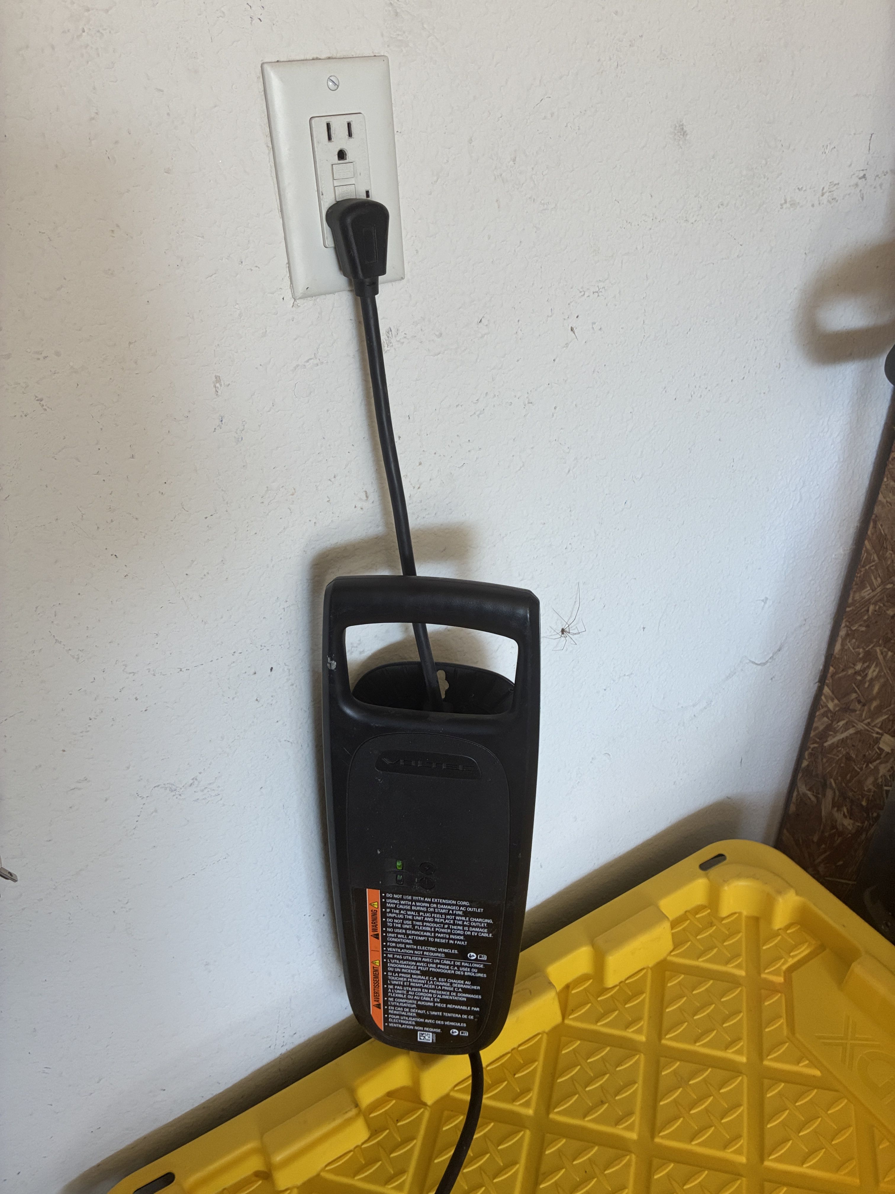

Post by Gregski »
since I was tripping over this OEM Chevy Volt Level 1 (aka 120 volts) charger cord on my garage floor I thought I would give it a try, and it works fine

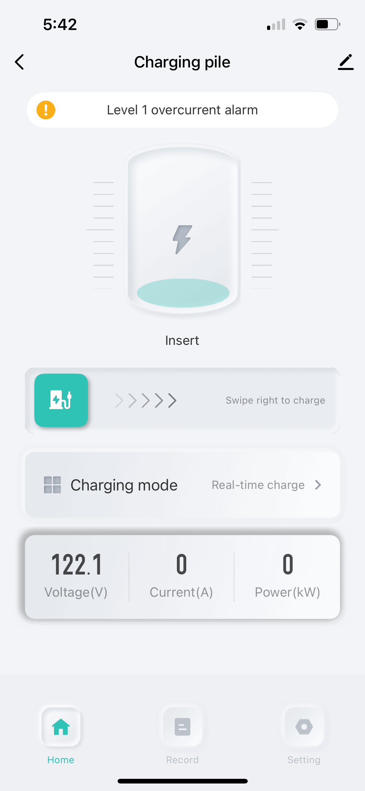

Post by Gregski »

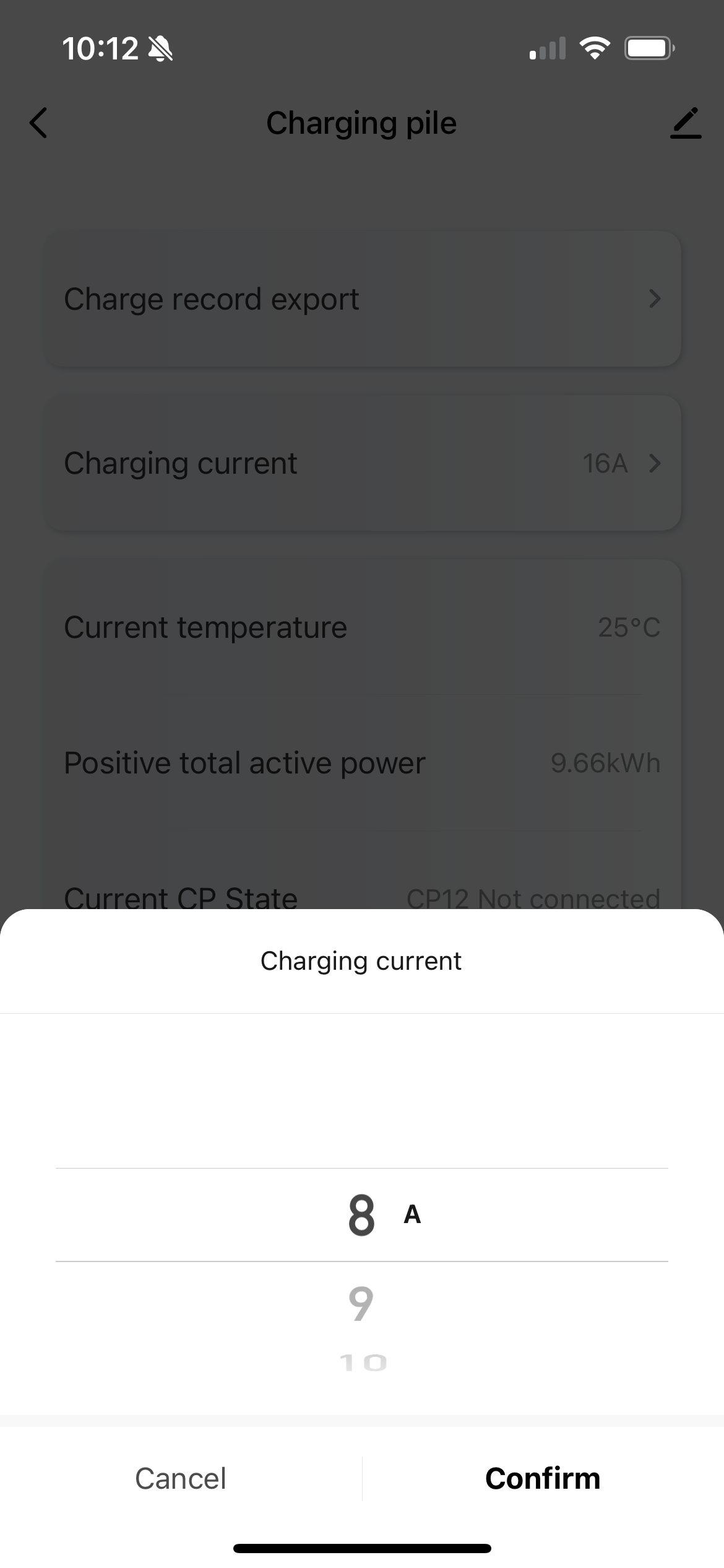

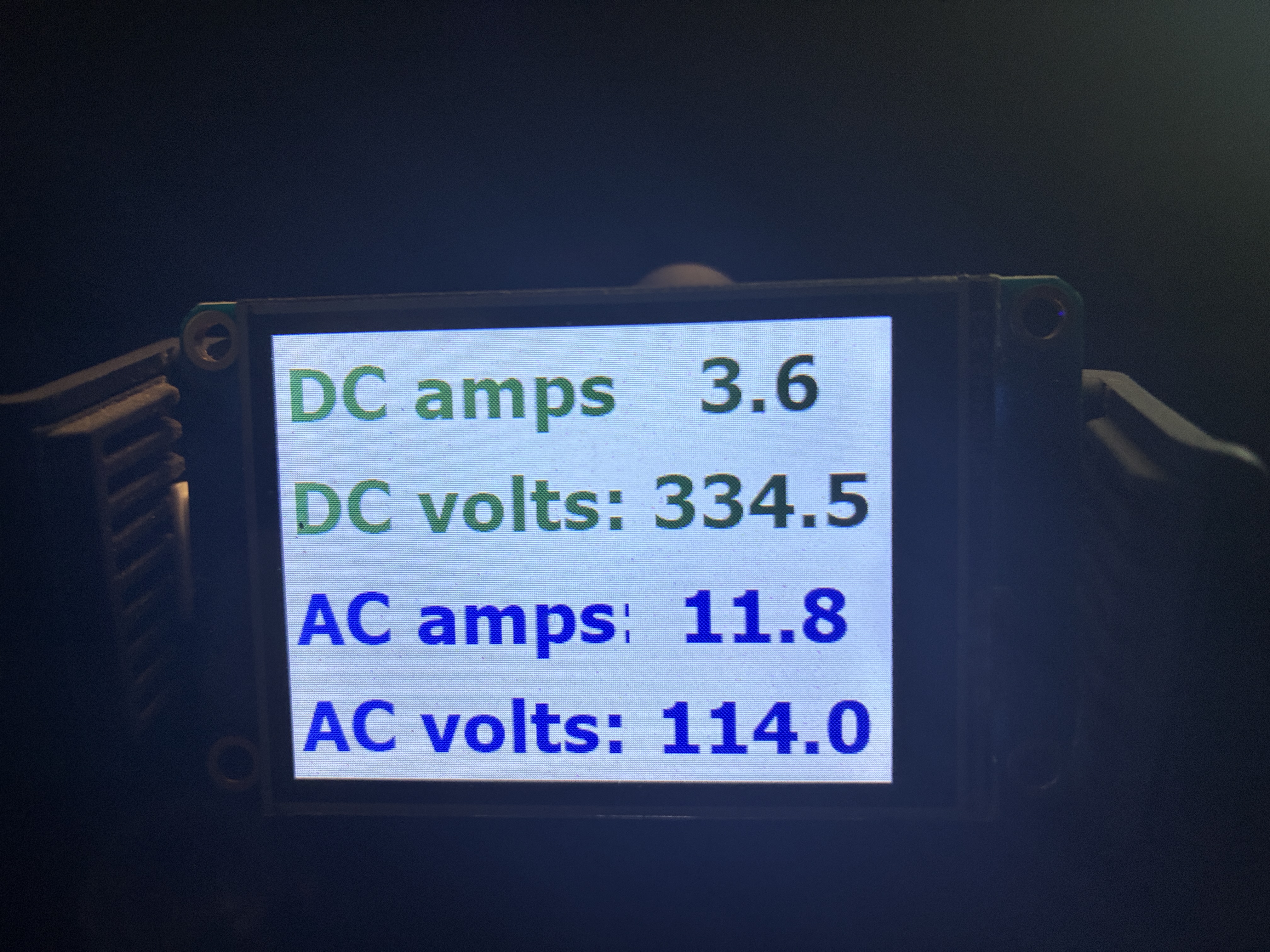

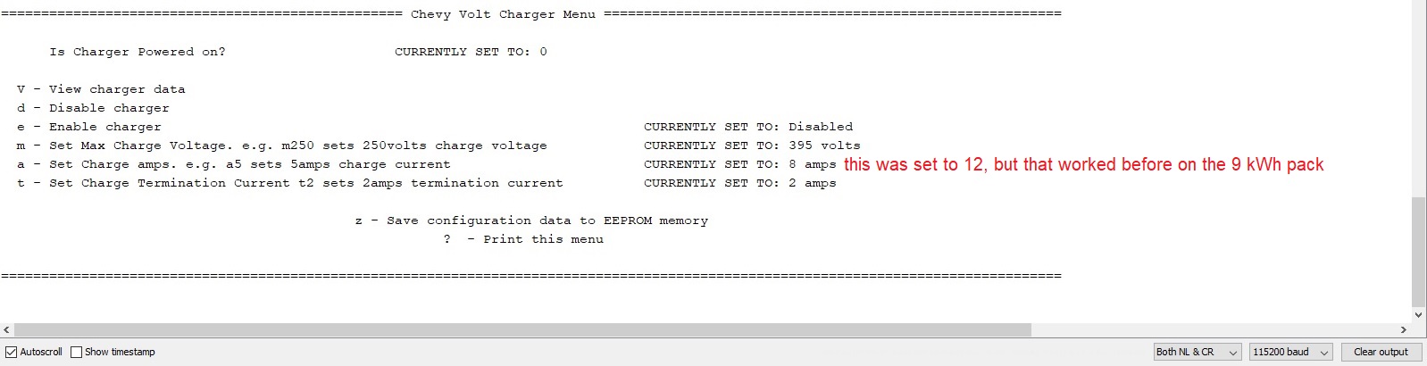

ok, we may have our first hint as to what is going on, I must admit I got a new phone (old one was lost/stolen) and I have not installed the Smart Life app for my Vevor charge cord thingie on the new phone because I really did not have to in order to charge my Hyundai Ioniq 5 with it, but I figured lets install the app and see what we can see, and I am glad I did because the app shows a: Level 1 overcurrent alarm warning something that I never got before while charging a single 9 kWh BMW PHEV battery pack, but now I see with two 12 kWh BMW PHEV battery packs joined in parallel at the pack level
it appears the lowest amps I can step this charger down to is 8
You must have changed something to allow it to draw more amps or not setup the lead to be allowed to provide enough amps. Parallel batteries would not change the power limit of the charger.
Are you not actively monitoring the Control Pilot current limit and adjusting the charger power based on that?
Post by Gregski »
tom91 wrote: Wed Oct 15, 2025 5:11 pm You must have changed something to allow it to draw more amps or not setup the lead to be allowed to provide enough amps. Parallel batteries would not change the power limit of the charger.

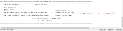

thanks Tom, so I got the Level 1 VEVOR charging working, here is the full disclosure and my Chevy Volt charger settings
Posts: 2963
Has thanked: 330 times
Been thanked: 848 times
What current limit is your Vevor lead set to?
You need to check what it shows on the AC current draw before tripping out the granny lead.
