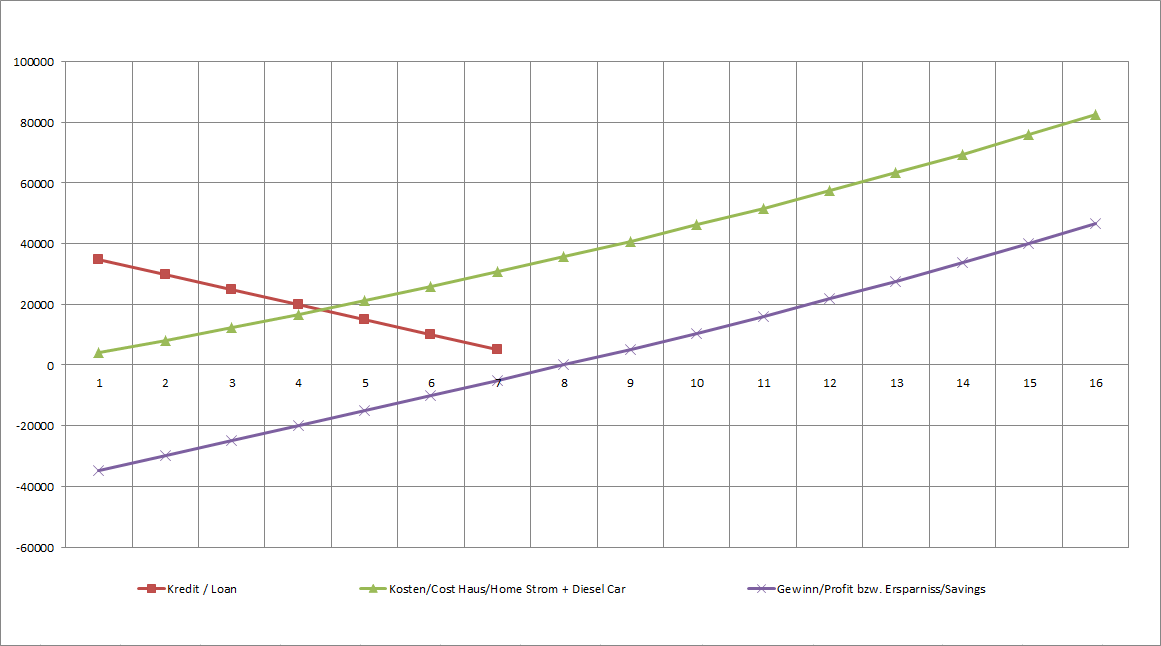

For me, this is a long-term project. I am currently doing calculations for the break even point.
For example, the operating costs of my diesel bus for an annual 15,000 km in 5 years are around 15,000 €, which corresponds to the cost of the conversion.
If I add a PV system with a hybrid inverter and 15KWh battery, that's around € 10,000, so a total of € 25,000.
So there is no diesel car maintenance and house electricity maintenance, with us about 400 € / month. If you take a standard loan for the 25K € then you have to reckon with a total of 34T € over a period of about 7-8 years.
So far, the calculation has assumed an inflation rate of 5% for diesel / Jear and 3% for electricity / year. Although that will only change by a few hundred euros in 5 years. So rather negligible.
In Germany there is also the fact that e-cars are tax-free for 10 years and then only max. 50% of the previous ones. Unfortunately, the € 9,000 electric car bonus is only available for new cars and not for conversions.
At the moment I am still unclear because of the PV system how it has to be designed if you want to generate 10-15 KWh for the car and 5KWh for the house in winter. In order to keep the self-sufficiency high and thus the savings high, you have to design the system so that you can still get the 20km to work and back with the slightest solar radiation. which is then determined 15KWh because of heating and 5KWh for the House.
And you have to be able to build the whole thing yourself or just pay more and pay longer.
After 10 years you have a profit of 10,000 € and can possibly buy a new battery if necessary or organize a big party: D
Of course, this requires a sharp pencil to make the conversion as cheap as possible.

E-Auto - Haus Berechnung.xlsx
(18.47 KiB) Downloaded 298 times

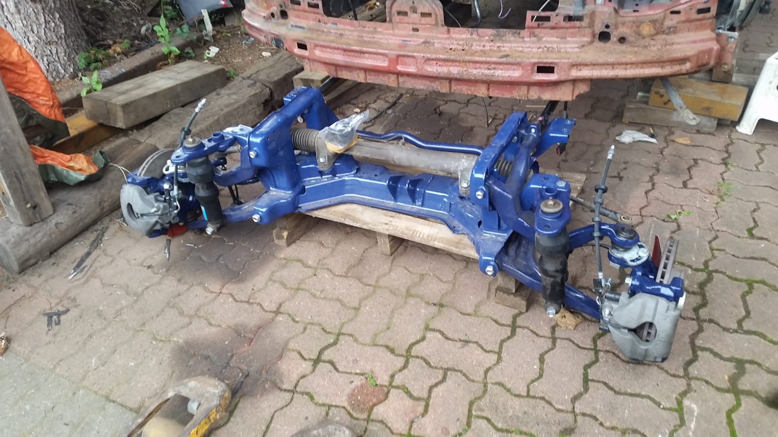

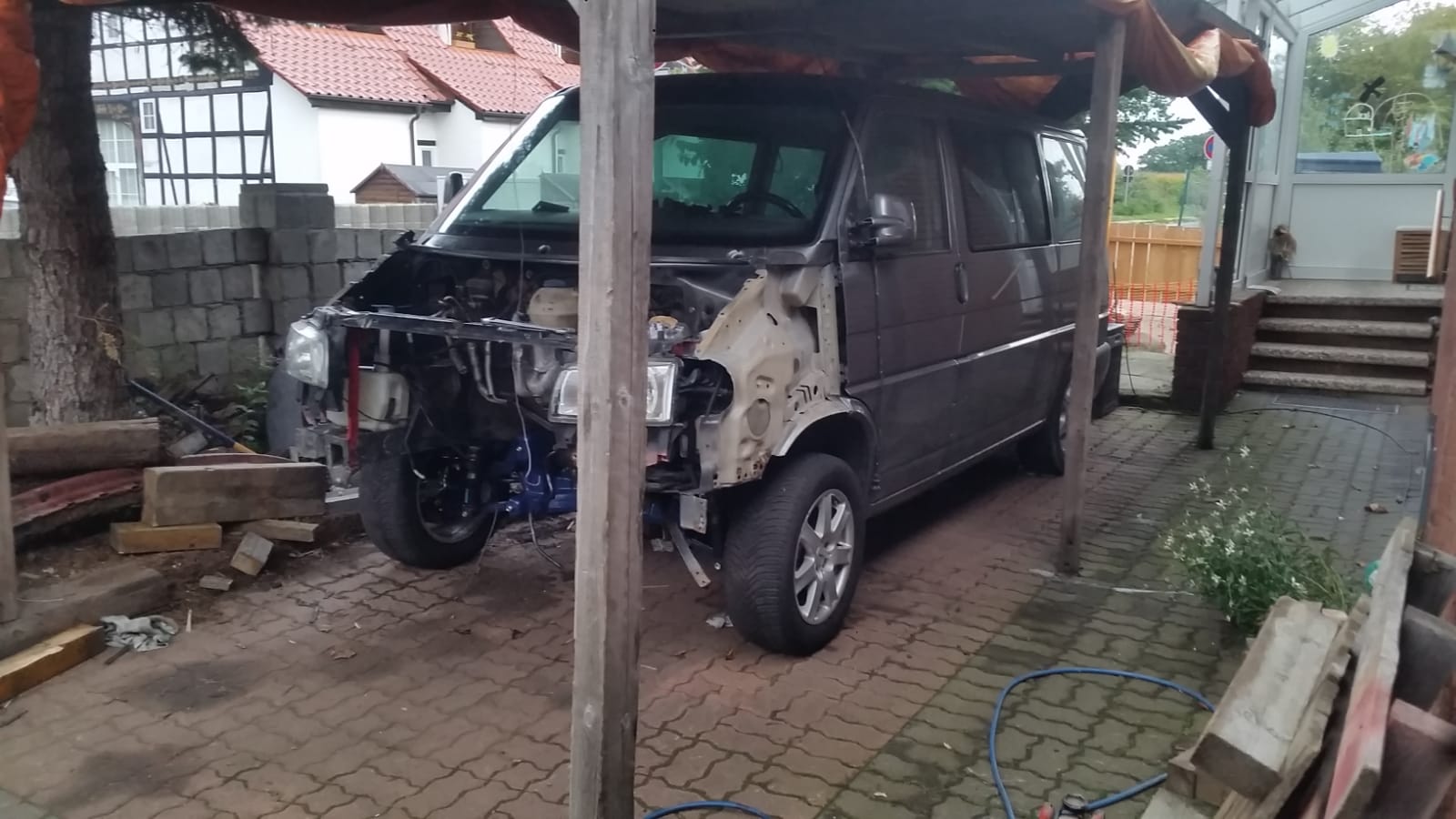

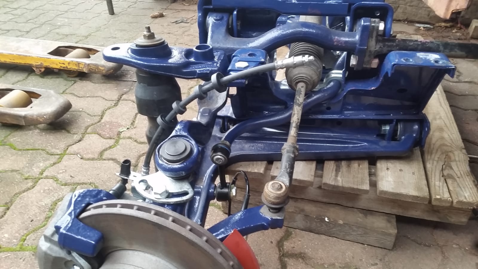

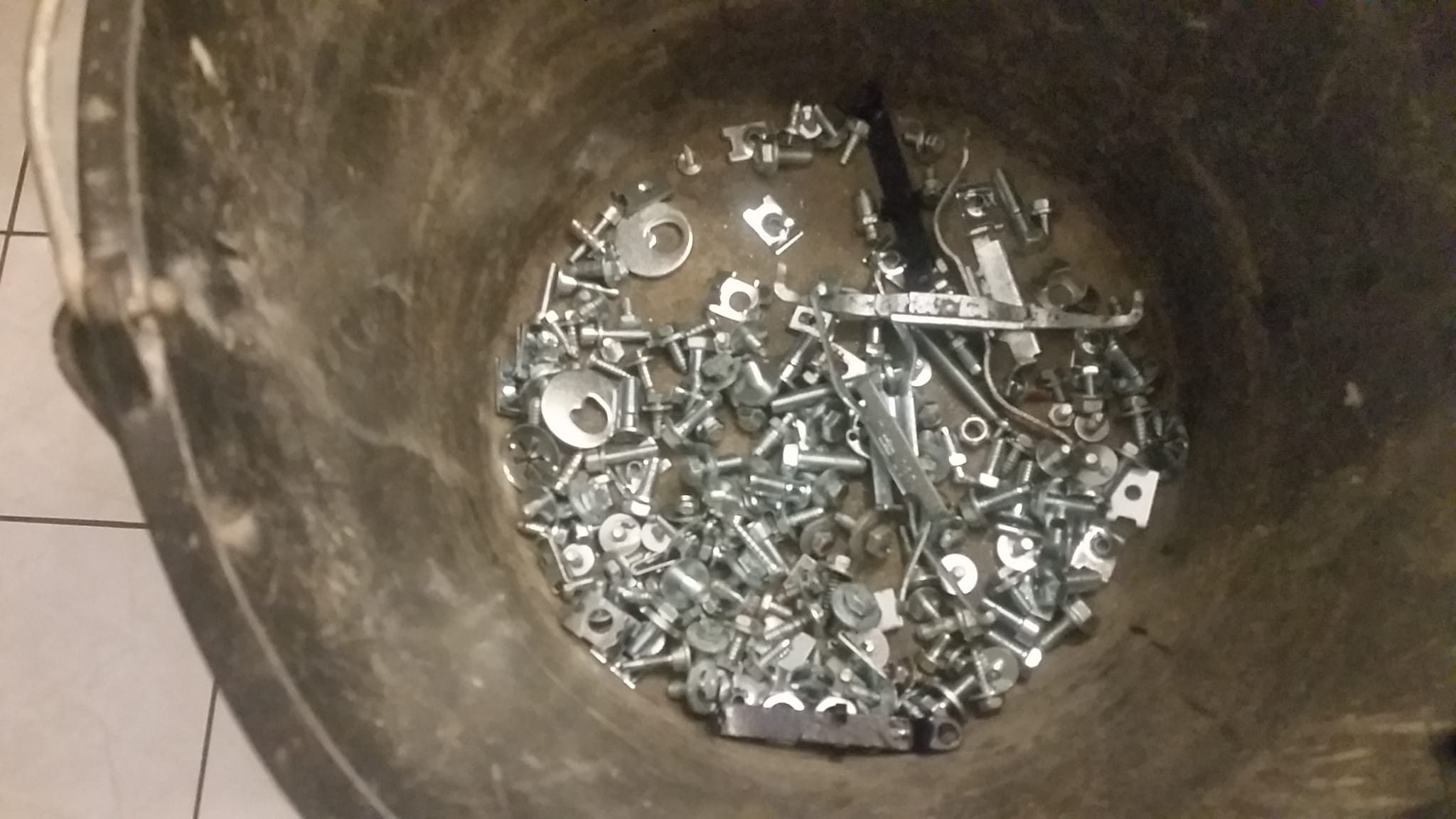

So friends of the night
it goes on: D
- Window frame painted and window installed

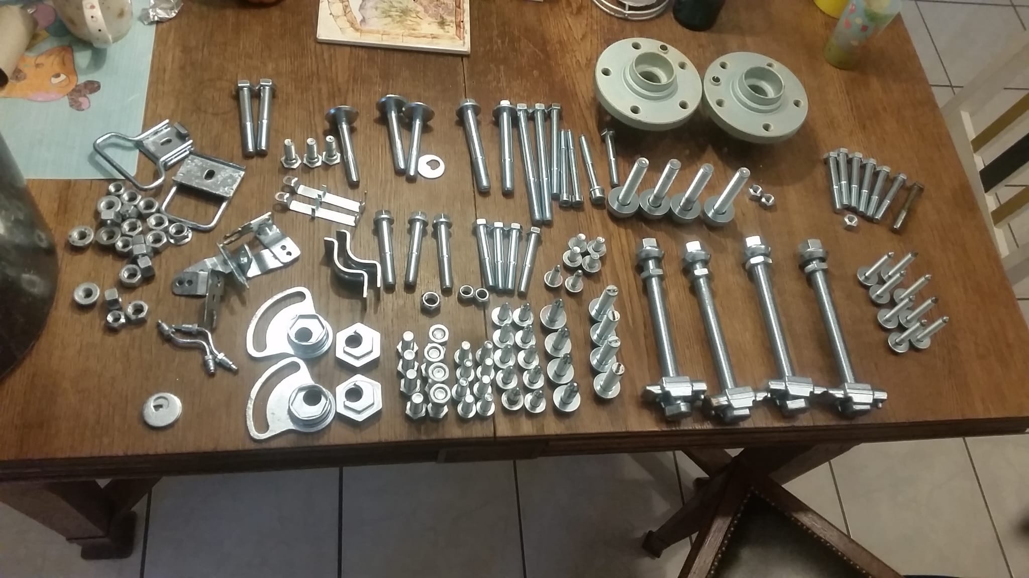

-all screws all galvanized
-Front axle assembled and installed
the next steps will be:
-weight distribution with sandbags
-Install the motor and measure the drive shafts
-rust and sheet metal work
here a few more pictures: D
Schrauben P o r n
The fun is 200km driving and 10 € for galvanizing

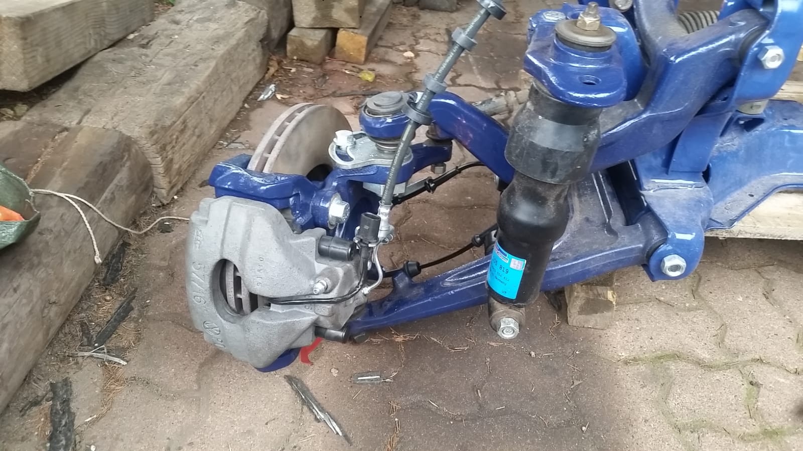

Looks delicious when everything is new and shiny
and for over a year now the bus has been on four wheels again, can be rolled and steered XD
so that's it for the moment
Many greetings Alex

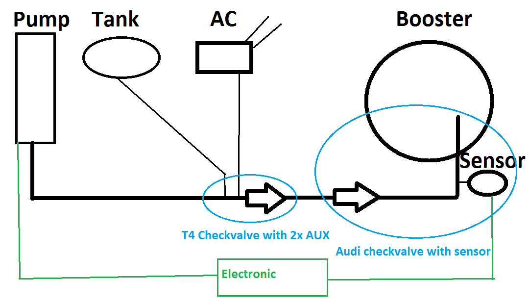

Hi, everyone
My project is progressing bit by bit...
I've finished the engine mount, I rebuilt it from 80x80 square tubing and I use the original engine mounts.

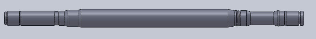

I disassembled the engine and rebuilt the oil pump, I'm still missing the gear oil. what do you take for the LDU? the old one was pretty cloudy and there was also some fine abrasion on the magnet, which I see as normal with a high mileage.
I measured the drive shafts and will make them from 42CrMo4 when the money comes again.
I weighed down the car evenly with 500kg sandbags to measure the suspension travel.
the last thing i did was complete the vacuum system, but i have the problem that the pump keeps running and gets hot.
The loss of pressure comes from the brake booster. I think there is a small hole somewhere. I have no idea how to solve this at the moment. the ATE number is 03.7757-3303.4 or 7D0612101H and is no longer manufactured by ATE under the number.
I have the circuit board from johu inside. the vacuum pump switches on immediately when the pressure drops a little with a very small hysteresis.
I think I'm not the only one with the problem.
Originally, a constantly running mechanical vacuum pump ensures continuous vacuum. there is a small leak not noticeable.
with a quiet electric car, however, I think it will quickly become annoying.
I would be interested to know how others have solved such problems?
LG Alex

Bratitude wrote: Fri Apr 29, 2022 4:58 am
I ditched vacuum brakes for electric assist, using a ibooster. Found in teslas, Hondas, chevys, etc
I've thought about electrically assisted brake boosters. However, I think that there will be problems with our car expert from TÜV if I change the brake system of the car.
How does an electric brake booster work?
Surely they need all sorts of canbus gimmicks to work, or does something like this work on its own?
I have a 10" brake booster with Double Piston.
Are there electric vacuum pumps that are designed for continuous operation?
I could wrap it in foam with a cooling water snake so that it can no longer be heard.

most electric assist brake boosters have a fail safe mode, I’m currently just running mine with that. 12v+ on a enable pin.
Volkswagen uses them in a few cars, I’m sure if you got a vw one, the bolt patterns might be the same so it might be a bolt in affair.
are you using a reservoir and a check valve with your brake booster? There should be no reason to have the vacuum pump running constantly
tollerteppich
Posts: 35
Joined: Sun Feb 07, 2021 10:39 am
Location: Hannover/Germany
Re: VW T4 with Tesla LDU
Post by tollerteppich »
Bratitude wrote: Fri Apr 29, 2022 2:28 pm are you using a reservoir and a check valve with your brake booster? There should be no reason to have the vacuum pump running constantly
I made a sketch of my system.
If I remove the brake booster and hold the hose closed, the pump stops running. So I can say with certainty that the pressure loss comes from the booster.
do you use a VW booster?
can you give me the part number of yours?

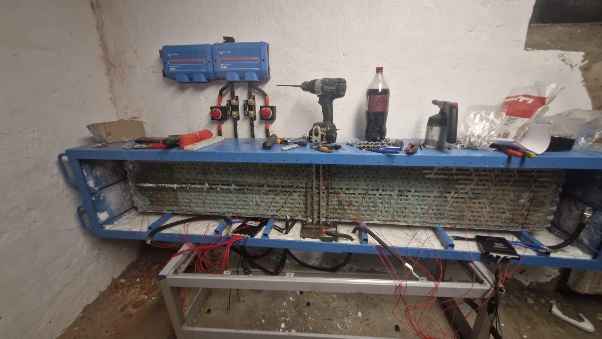

Hi, I have an update on the project.
Due to the divorce three years ago and buying my own property, I currently don’t have the budget for a battery. So I put the TDI engine back into the van.
Maybe I’ll reactivate the project in the future when I have more flexibility again. For now, it’s on hold, and the LDU is stored safely on a pallet.
I split my Tesla Model 3 25s battery into 2x 12s packs and integrated them with a Victron MultiPlus-II system for my house. I also have two electric vehicles now, an electric pallet jack and an an 8-meter 4WD scissor lift XD
