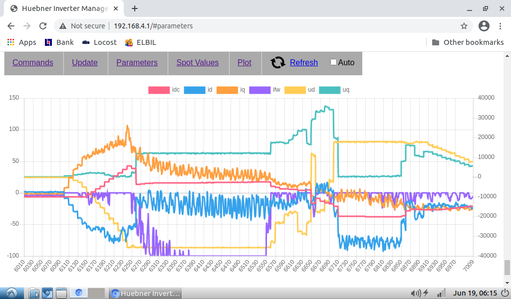

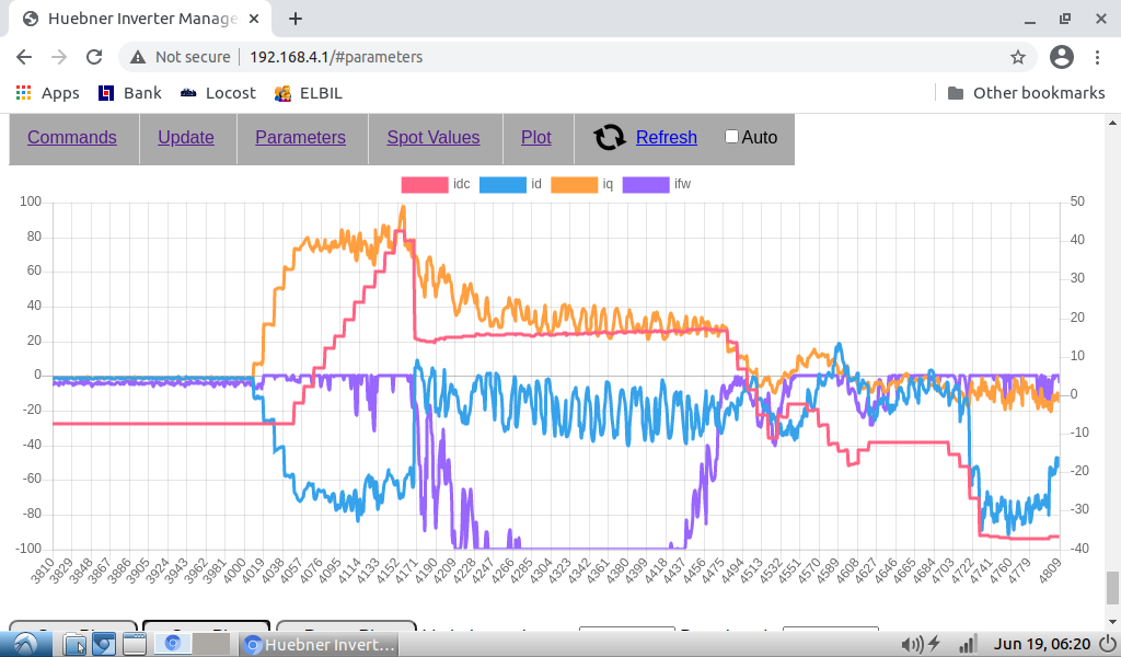

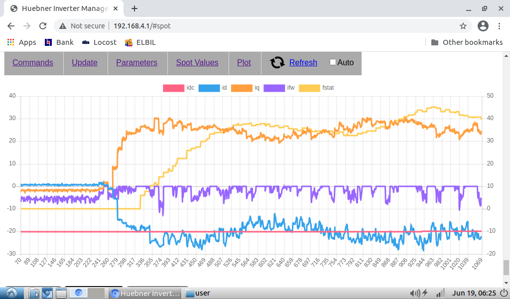

Results from test.
Currents on left axis, voltages on right axis
Id, Iq, Ifw left, idc right
No really difference. Ifw seem to not autozoom the plot axis so hard to see what its doing exactly.
johu wrote: Fri Jun 18, 2021 11:28 am
bexander wrote: Fri Jun 18, 2021 9:36 am I'm I missunderstanding, but if you calculate Id and Iq from MTPA and then if Iq isn't reached it adds further to Id, without decreasing Iq? That would result in the square sum of Iq and Id are larger than square of Is. If so it makes sens that the Id bottoms out, or runs out of voltage if you will.
Yes and no. Id request always has priority over iq request. So if we run out of voltage iq will be reduced first. That said there are probably better ways to do field weakening just not quite as universal.
Looks like Id somehow runs out first in the plot.

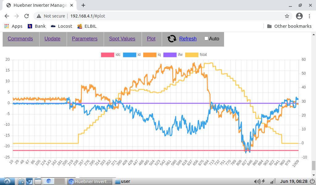

Also, a quick look what going on at low speed.
Id, Iq, Ifw left, idc, fstat right, fwkp = -100
Id, Iq, Ifw left, idc, fstat right, fwkp = 0
Ifw definitely seem to interfere at low speeds? The inverter should not be out of voltage at this point?

Looking at today test, it is a bit odd that Ud hits its limit some time before Id colapses. If the voltage limit causes this, shouldn't Id colapse at the same instance as Ud max is reached?

bexander wrote: Sat Jun 19, 2021 4:43 am No really difference. Ifw seem to not autozoom the plot axis so hard to see what its doing exactly.
Are you sure it isn't limited to -100A? It will be limited to -50% of the throtcur value. Do you have throtcur set to 200A? In that case throtcur has to be increased or this code modified to allow more FW:
   fwController.SetMinMaxY(-50 * Param::Get(Param::throtcur), 0); //allow 50% of max current for extra field weakening

Regarding this plot from yesterday.
When looking closely one can see that Ud reaches its limit before the Id colapses. On other plots in this thread also the opposite appears, Ud reaches its limit after Id colapses. However, Uq always rises the exact moment Id colapses, which I think is a bit strange.
Another question is why there are no step in Iq, but still a step in Uq. To my understanding, Uq is calculated from Iq, so this does not add up.
Changing the syncadv factor increased torque and power delivery but still shows the same behavior regarding Id colapsing and a large step in Uq.
This really is strange to me.
Would be very interesting to see similar plots from other motor/inverter combinations to find out if this only happends to the MGR or to other motors as well. The MGR does not have very much power so might be why it becomes very noticable for this motor.

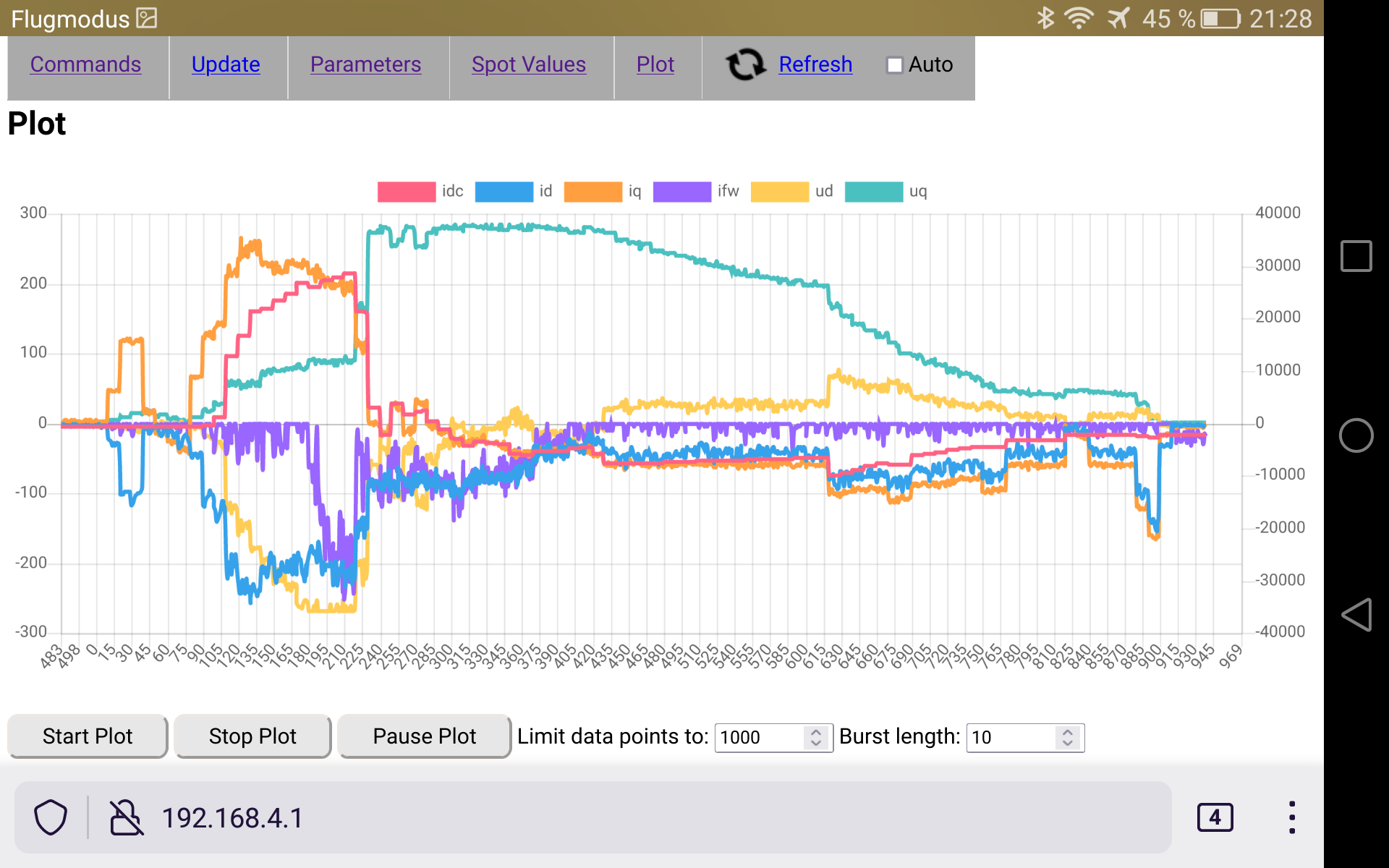

Just did a log, couldn't go full throttle as the data logger would be too slow, but still.
It's acceleration from 0-7500 rpm and regen back down. ud also maxes out, so most of the ifw command will have no effect. But certainly id can be maintained and doesn't collapse like in your log

johu: Thank you! Very good to have something "normal" to compare to.
Looks like setting fwkp to 0 should be ok for testing as both in mine and johu plots it seem to be acting to late, when Ud already is maxed out. Just to exclude things.
The more I think about it the stranger it is that Uq makes a step to hit its limit. The only input to the qController is the Iq and I can't see any step in Iq. The gains are the same for both dController and qController.
One idea is to test with decreased curkifrqgain, to see if that changes anything.

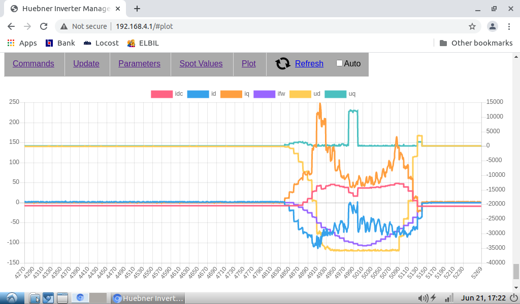

I could not resist so squeezed in a quick test but that got a bit scary... As roads are full of traffic I made a short test in the neighborhood. I think the speed was up to 50km/h when I let go but the inverter gave me more torque, not less or regen so had to brake very hard to decelerate and stop.
Currents left, voltage right
I think the collapse happend later, at around 45km/h. But it also pulled hard, resulting in some wheelspin. I set throtcur to 1 before I did the test so should be the same as with other tests but iq is a lot higher in this one.

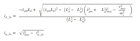

I think if this is going to work one needs to more precise measure the motor parameters.
Calculate base speed with:
Use MTPA up to base speed and then above base speed voltage and current limited maximum torque control (VCLMT).
All copied from
https://se.mathworks.com/help/mcb/ref/m ... rence.html
But this will be not at all universal but might work for the MGR. However requires programing and a couple of new parameters. I can not implement this as I lack the skills needed. Would it even be worth the trouble for one specific motor?

Yes I should have mentioned be damn sure syncofs is correct. Otherwise the change definitely gives you auto-throttle, the more the faster you go. I don't know if it otherwise might also, I don't understand the effects of for example some kind of remaining magnetic field in the rotor that effectively would offset the magnets. :twisted:
By the way, it would be nice to have frq or speed in these graphs, whichever has the value to fit some axis best. Maybe frq to the left axis. Altough, in this specific graph we can see the speed directly in ifw.
EDIT: I think the thing to attempt now is to try to go as high as possible using syncadv. At least that way when you release the throttle the motor will always stop making torque. I don't think the fanciest formulas will give that much benefit here, altough graphing them and studuying what parameters they take and what they're doing with them is definitely educational.

Regarding the fancy equations, there are only Ld and Lq that are new parameters. Lamda pm is FluxLinkage. It is all explaned in the link.

Plot in same manner as before but also add fstat to get a speed reference.
