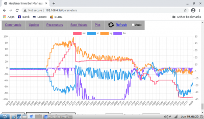

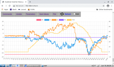

by bexander
Results from test.
Currents on left axis, voltages on right axis
Id, Iq, Ifw left, idc right
No really difference. Ifw seem to not autozoom the plot axis so hard to see what its doing exactly.
johu wrote: Fri Jun 18, 2021 11:28 am
bexander wrote: Fri Jun 18, 2021 9:36 am I'm I missunderstanding, but if you calculate Id and Iq from MTPA and then if Iq isn't reached it adds further to Id, without decreasing Iq? That would result in the square sum of Iq and Id are larger than square of Is. If so it makes sens that the Id bottoms out, or runs out of voltage if you will.
Yes and no. Id request always has priority over iq request. So if we run out of voltage iq will be reduced first. That said there are probably better ways to do field weakening just not quite as universal.
Looks like Id somehow runs out first in the plot.

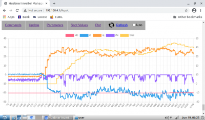

Also, a quick look what going on at low speed.
Id, Iq, Ifw left, idc, fstat right, fwkp = -100
Id, Iq, Ifw left, idc, fstat right, fwkp = 0
Ifw definitely seem to interfere at low speeds? The inverter should not be out of voltage at this point?

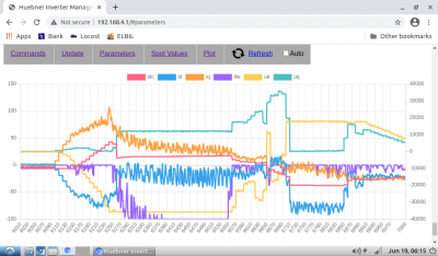

Regarding this plot from yesterday.
When looking closely one can see that Ud reaches its limit before the Id colapses. On other plots in this thread also the opposite appears, Ud reaches its limit after Id colapses. However, Uq always rises the exact moment Id colapses, which I think is a bit strange.
Another question is why there are no step in Iq, but still a step in Uq. To my understanding, Uq is calculated from Iq, so this does not add up.
Changing the syncadv factor increased torque and power delivery but still shows the same behavior regarding Id colapsing and a large step in Uq.
This really is strange to me.
Would be very interesting to see similar plots from other motor/inverter combinations to find out if this only happends to the MGR or to other motors as well. The MGR does not have very much power so might be why it becomes very noticable for this motor.

I think we should ask the question: What exactly does the field look like to the MGR before and after the tipping point with syncadv=20, compared to syncadv=10?
The motor is spinning at about 2300rpm and has 4 pole pairs. That's frq=153Hz.
This normally gives us syncadv = (frq - 20) * 10 = 1330.
In "syncadv=20" case it gives us syncadv = (frq - 20) * 20 = 2660, which is 1330 more than usual. The unit here is angles from 0...65535, meaning this is 7.3 degrees advanced. That's the only change this hack does, so it's very useful. (giving you guys aren't willing to mess with the MTPA values... yet)
Looking from bexander's 2021-06-19 graph, we can see before the collapse we have roughly the values:
idc=40
id=-50
iq=70
ifw=-10
ud=-35000
uq=3000
After collapse:
idc=15
id=-10
iq=60
ifw=-50
ud=-35000
uq=13000
This roughly matches with some of the previous graphs. However, the inverter might not be outputting the same field (in its viewpoint) when configured with syncadv=20, thus we'll look at bexander's 2021-06-12 graph. Before collapse:
idc=45
id=-60
iq=80
ud=-35000
uq=3000
After collapse:
idc=30
id=-30
iq=65
ud=-35000
uq=13000
We can see the "before collapse" values are basically the same so it doesn't matter which ones we use for this calculation.
Now, the motor is seeing this advanced by 7.5 degrees.
The current vector (id=-60, iq=80) has an angle of 126.9 degrees.
Advancing it by 7.5 degrees we get 134.4 degrees, which is vector (id=-70, iq=71). That's what the motor sees before the collapsing current in the syncadv=20 case.
The before-collapse field looking the same to the inverter with or without syncadv modification means we already calculated the field angle for syncadv=10: it's vector (id=-60, iq=80) or 126.9 degrees. Taken from the 2021-06-19 graph it's 126 degrees (id=-50, iq=70).
By this calculation we can see the motor performs better (current collapses less) with an id=iq split compared to a split with about id=71%*iq.
Can we just get testing going with the crazy MTPA values? Based on this I'm 100% sure they'll give more performance. For some reason that I don't understand it seems the motor wants more Id before it's actually needed, otherwise it's game over when the need actually comes. This is how it behaves, just cater to it.

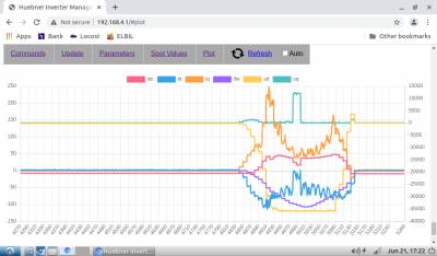

I could not resist so squeezed in a quick test but that got a bit scary... As roads are full of traffic I made a short test in the neighborhood. I think the speed was up to 50km/h when I let go but the inverter gave me more torque, not less or regen so had to brake very hard to decelerate and stop.
Currents left, voltage right
I think the collapse happend later, at around 45km/h. But it also pulled hard, resulting in some wheelspin. I set throtcur to 1 before I did the test so should be the same as with other tests but iq is a lot higher in this one.
I think if this is going to work one needs to more precise measure the motor parameters.

bexander wrote: Mon Jun 21, 2021 3:54 pm But this will be not at all universal but might work for the MGR. However requires programing and a couple of new parameters. I can not implement this as I lack the skills needed. Would it even be worth the trouble for one specific motor?
To induce wheel-spin, I would say YES! 8-)

So there definitely is more in it. With the regular firmware you should tune syncofs and syncadv. I can make it a parameter again. You need to make sure when only commanding manualid the motor coasts down. I think what we are seeing is misalignment, the controller thinks it is generating id but actually creates a considerable iq along with it.
Re: Halved current during field weakening
Posted: Mon Jun 21, 2021 6:36 pm
by celeron55
Yes I should have mentioned be damn sure syncofs is correct. Otherwise the change definitely gives you auto-throttle, the more the faster you go. I don't know if it otherwise might also, I don't understand the effects of for example some kind of remaining magnetic field in the rotor that effectively would offset the magnets. :twisted:
By the way, it would be nice to have frq or speed in these graphs, whichever has the value to fit some axis best. Maybe frq to the left axis. Altough, in this specific graph we can see the speed directly in ifw.
EDIT: I think the thing to attempt now is to try to go as high as possible using syncadv. At least that way when you release the throttle the motor will always stop making torque. I don't think the fanciest formulas will give that much benefit here, altough graphing them and studuying what parameters they take and what they're doing with them is definitely educational.
