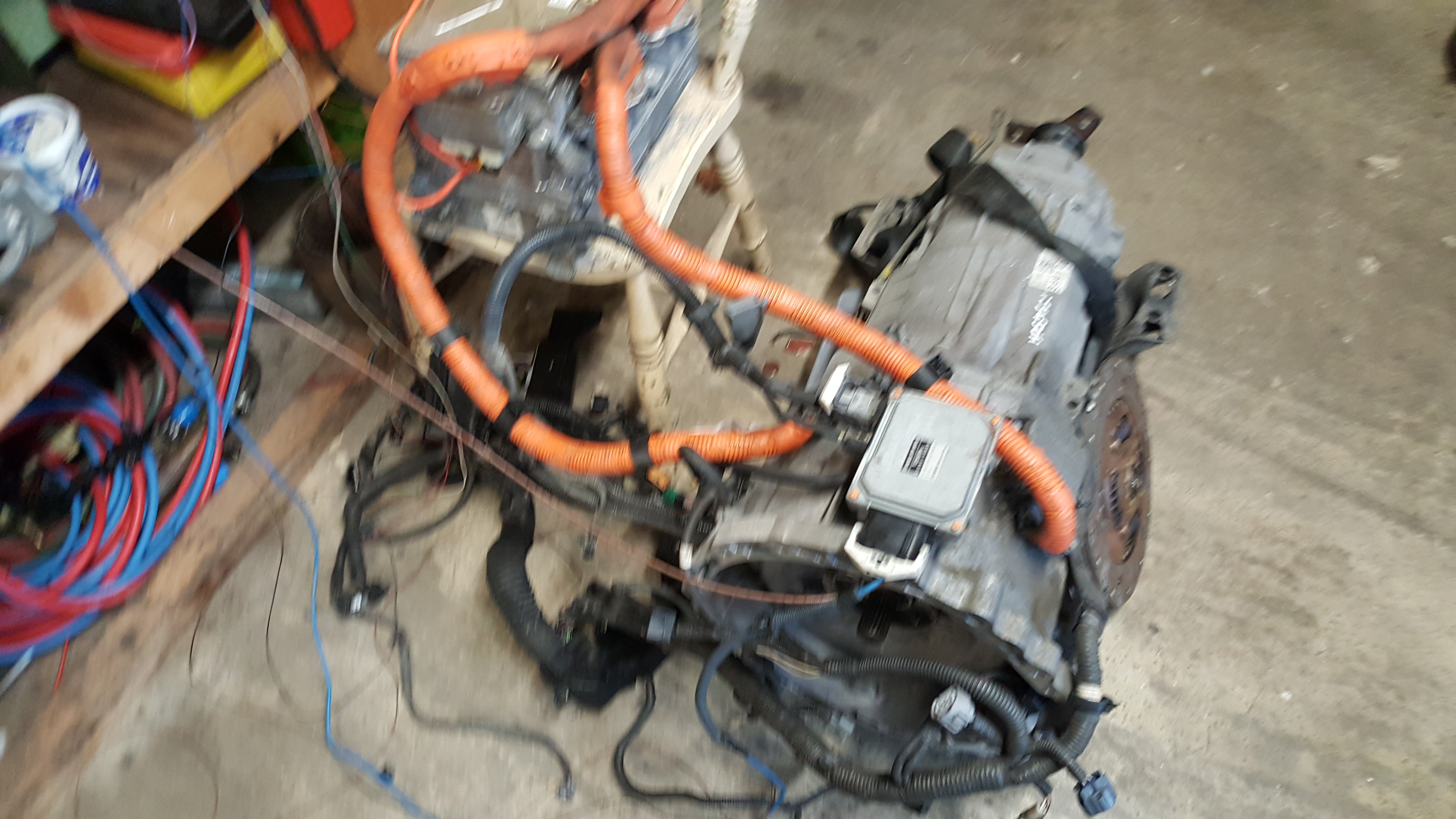

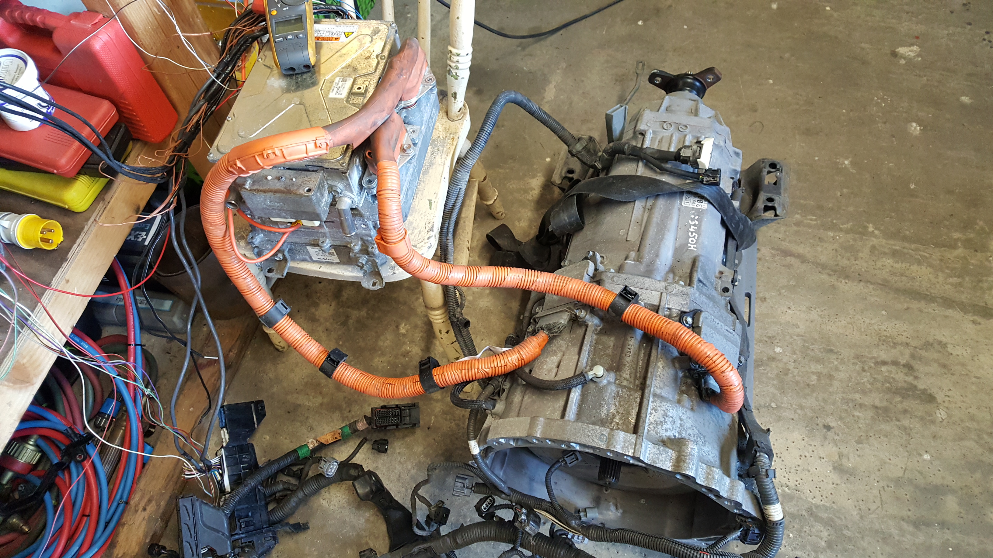

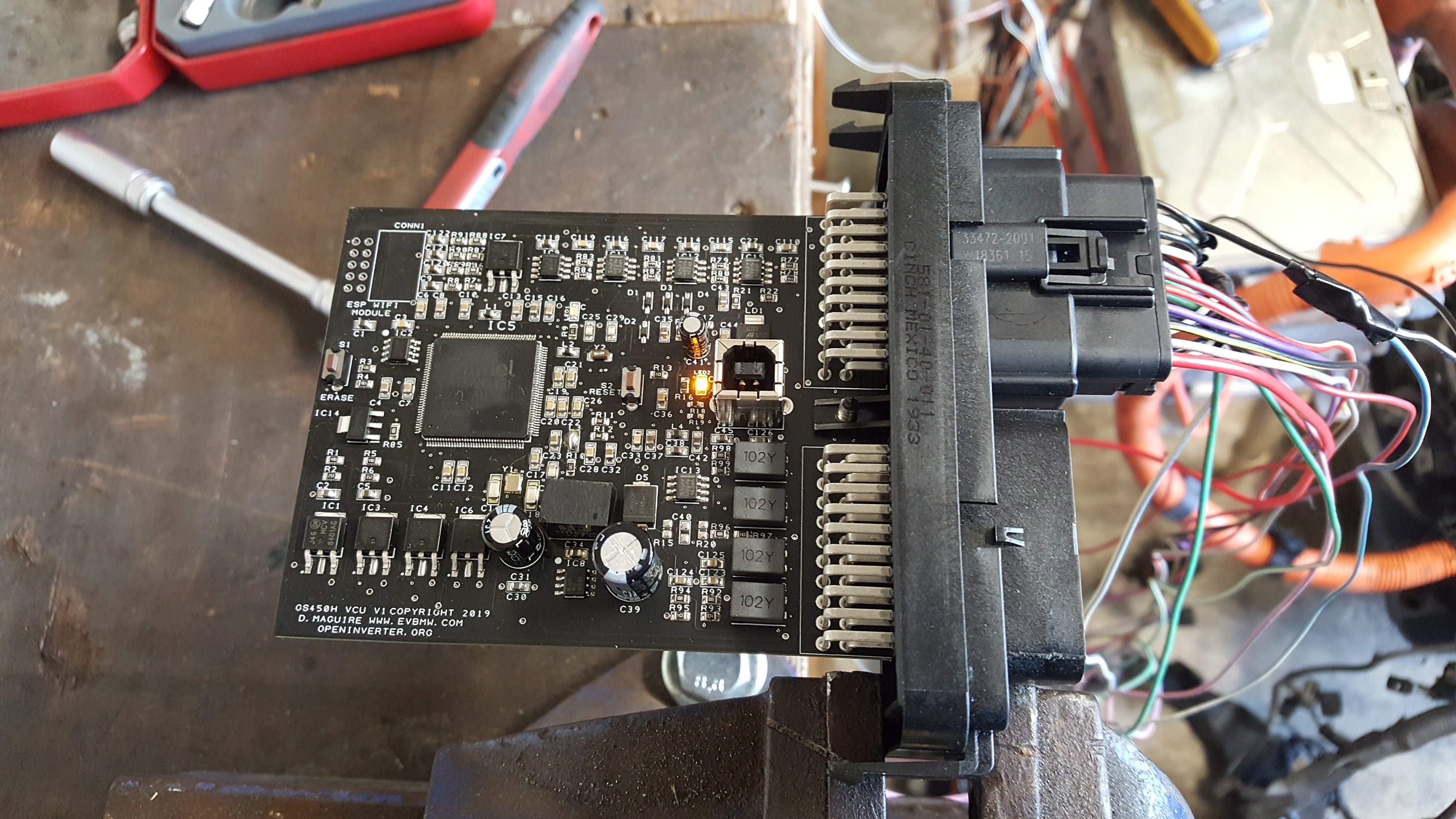

Posts: 4007
Been thanked: 1139 times

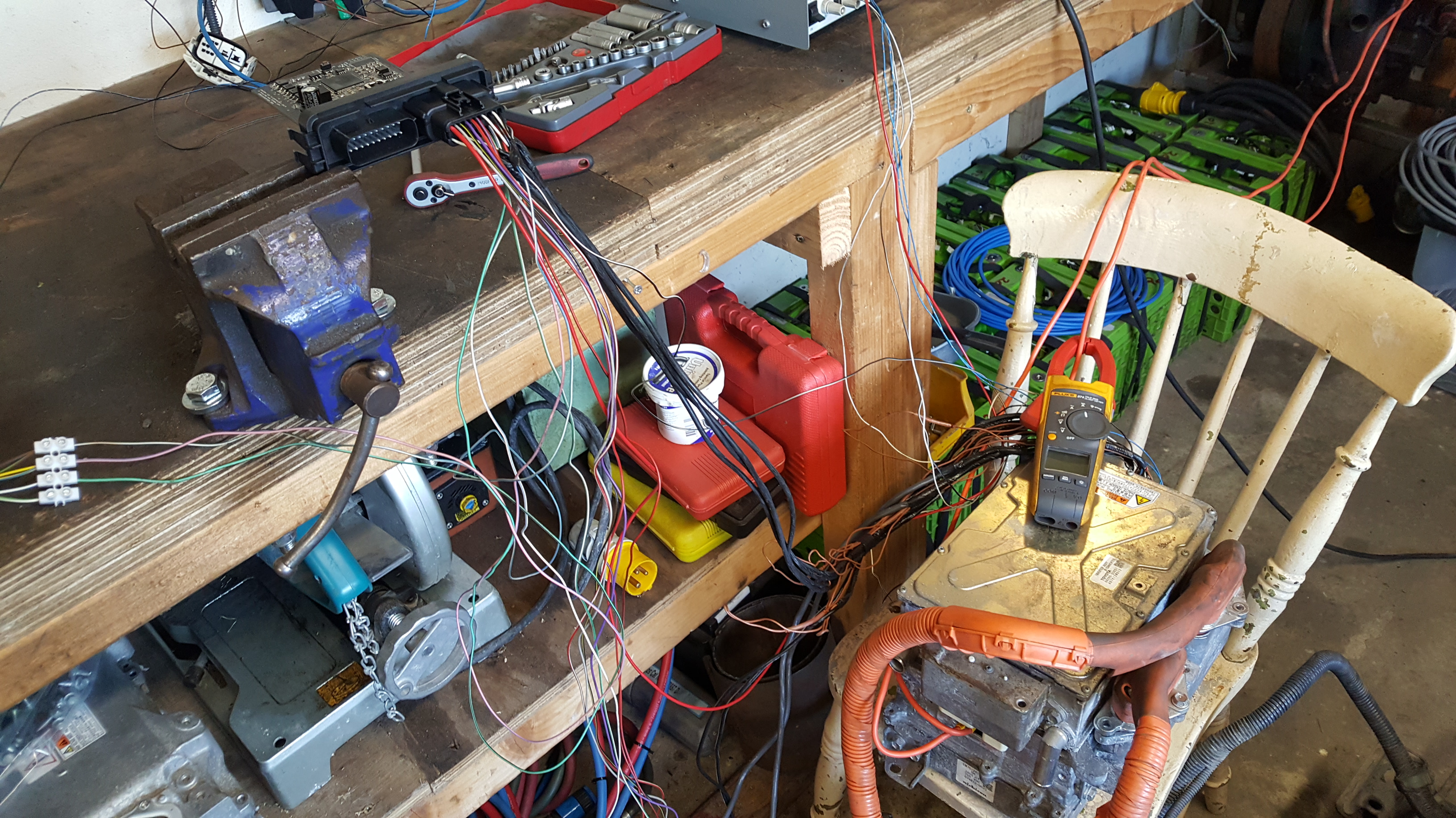

Re: Communicating with the Lexus GS450h Inverter/Converter
Pleased to announce first successful tests of the controller. Video on the way:)

xp677
Posts: 442
Location: UK
Been thanked: 15 times
Post by xp677 »
Excellent work! At this rate, you'll have it running in a car long before I get mine off the bench ;)

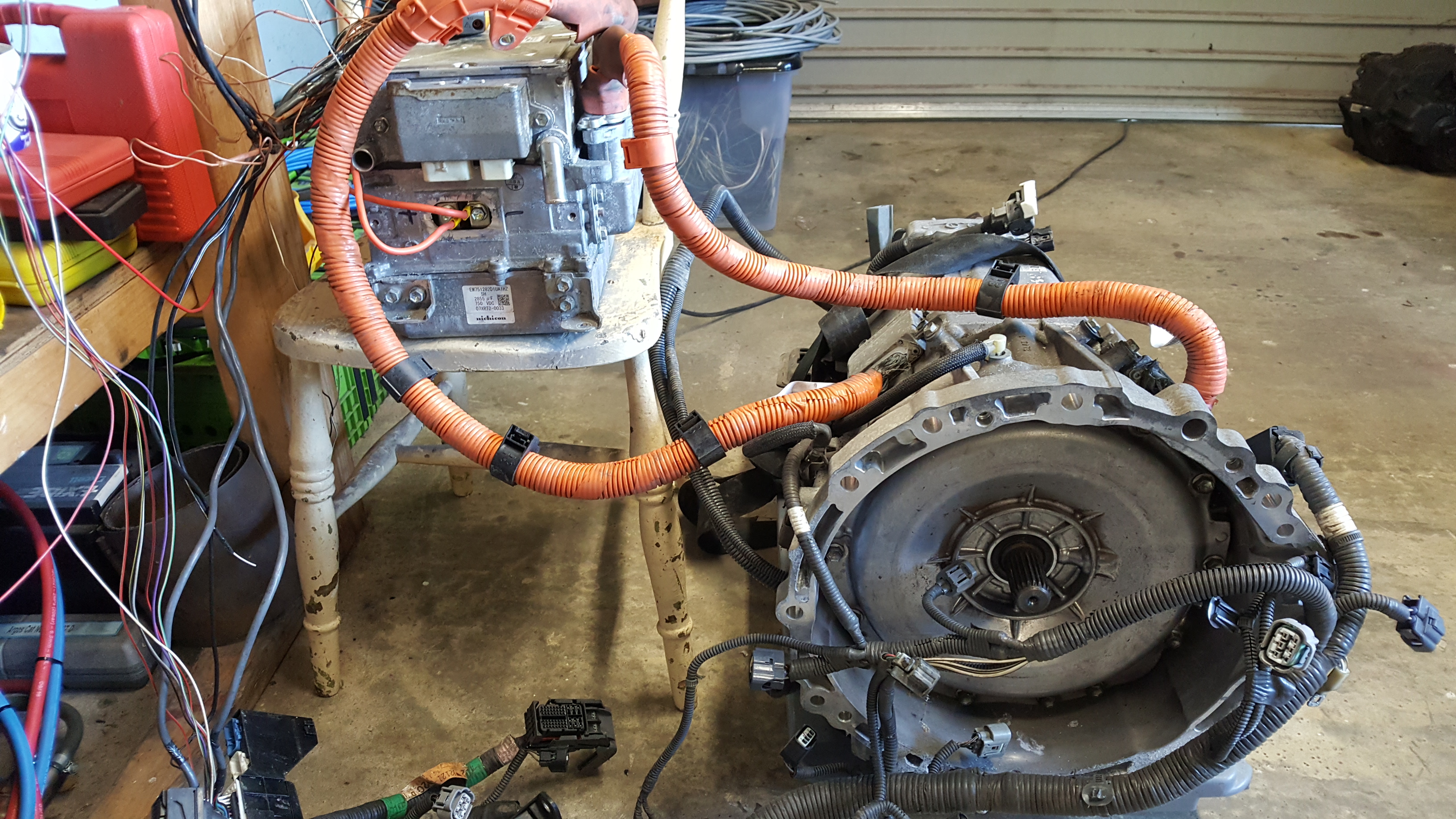

Posts: 4007
Got the pump controller fitted and now running from the main controller via pwm at 1khz. Pump speed is straight proportional to pwm duty. Needs a pullup resistor of 1k to 12v. Seems to take around 25amps at 50% speed. Last piece of the puzzle is to lock the input shaft then can start testing in the car.
