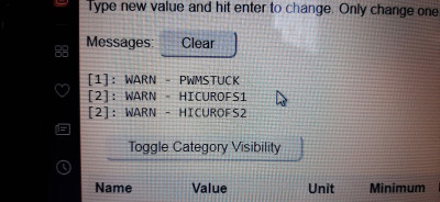

I'm new to this forum, to this inverter and to STM32/ESP8266...
Trying to use a "blue pill" and an Olimex Mod-wifi-esp8266 to do some testing.
I have programmed the ESP with arduino ide and can axcess the web interface ok.
It sends out serial data when I use the "send custom command". Basically the ascii code of what I put in to send.
I have also programmed the STM32 with the lates firmware (stm32_sine.bin (4.85)) using stm32flash but I can not get any response from it in the web interface or any PWM output.
I have tried to pull PB1, PB7 and momentarly PB6 high but no PWM.
Also tried sending "start 2", then "set fslipspnt 10" and finally "set ampnom 10". Also with the above pins high.
I do not get any response in web interface when sending the commands? Are there suppose to be any response message?
I have tried reversing the rx/tx pins from the esp with no change.
What have I missed?

Are you on correct UART? PB10, PB11.
Yes there is always a response to valid commands.

Yes, uart3.
If I flash the bootloader the stm32 sends 0x2D, as expected.
The firmware does not require the bootloader, correct? The firmware can be flashed directly on the blue pill bootloader?
I will create some simple arduino sketch to verify that the uart3 is working correctly and post when done.
- Been thanked: 1918 times
Re: Johannes in a Blue Pill
It does require the boot loader. It is started at reset and starts the actual firmware when no update is requested.
