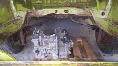

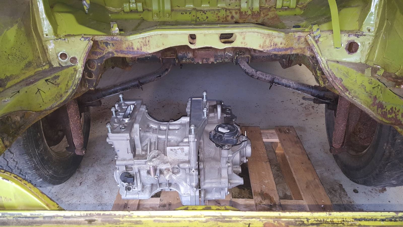

56kWh-ish short module Tesla M3 battery pack arrived! :) Final price 6000e inc. shipping etc. That puts this into roughly 107e/Wh which doesn't seem to be too bad and these flat modules will be near perfect fit for the "cargo bay false floor" idea.
One module length 1370mm and width 340mm, T2 cargo bay dimensions:
Going forward. Slow and steady... :)

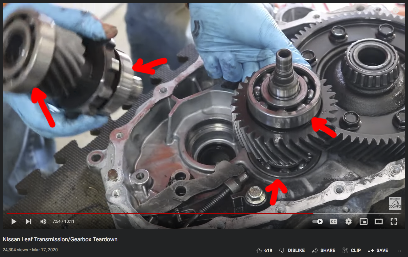

Interesting and thanks for the warning. Although I'd not think thrust to be the major issue here, I did some research on this and found that the gearbox does indeed have a splash lubrication system, where oil is circulated by the largest helical to a splash channel from which it drips onto the two smaller gears.
(screengrab from the wonderful Benjamin Nelson's teardown video)
Without finding a way to create proper lubrication to the smaller gears I do think indeed that prolonged use in reverse direction can very easily lead to bad things. Even a small oil pump would probably be sufficient though, but of course that adds uncomfortable amount of complexity. :D

It has nothing to do with lubrication, though lubrication is *also* an issue in extended backwards rotation.
The thrust vector of the gearshafts reverses 180 degrees. While that's survivable in reverse because of short time operation, prolonged operation with that vector reversed means heavy loads in the vehicle accelerating or moving at high speed are not correctly transmitted to the case. People do run in reverse with Tesla DU's, but it sounds like @romale has experienced failure with the Leaf design.
There's one way to prove or disprove that 💀

remy_martian wrote: Mon May 23, 2022 7:51 am It has nothing to do with lubrication, though lubrication is *also* an issue in extended backwards rotation.
Since the bearings look identical on the both sides and thrust is created to both directions in normal operation as well, I just don't see that as an realistic big issue though. Even if doubting it'd be, I guess one could easily just swap the bearings from one side to another (they do seem to fit) and be done with that as a possible source of trouble. I've taken mine apart briefly and they are the same on both sides.
However, running prolonged times in reverse will for sure look like it'll leave 2/3 of the gears without lubrication, which will likely lead to more heat (also carried by the gearshafts to the bearings), and eventually failure of the gearbox as DIY'ers like Romale have experienced. I have heard reports about Leaf gearbox breaking in reverse mounted orientation twice now, so it definitely doesn't like to be used that way, but I still think the main culprit is knocking out the lubrication system.
To be clear, I do not plan to mount this in reverse direction due to extra complexity I don't really need in my 1st build. :)

It's not just the bearings. It's how they are held, seated, & preloaded in the housing. I thought I made that clear:
"heavy loads in the vehicle accelerating or moving at high speed are not correctly transmitted to the case."

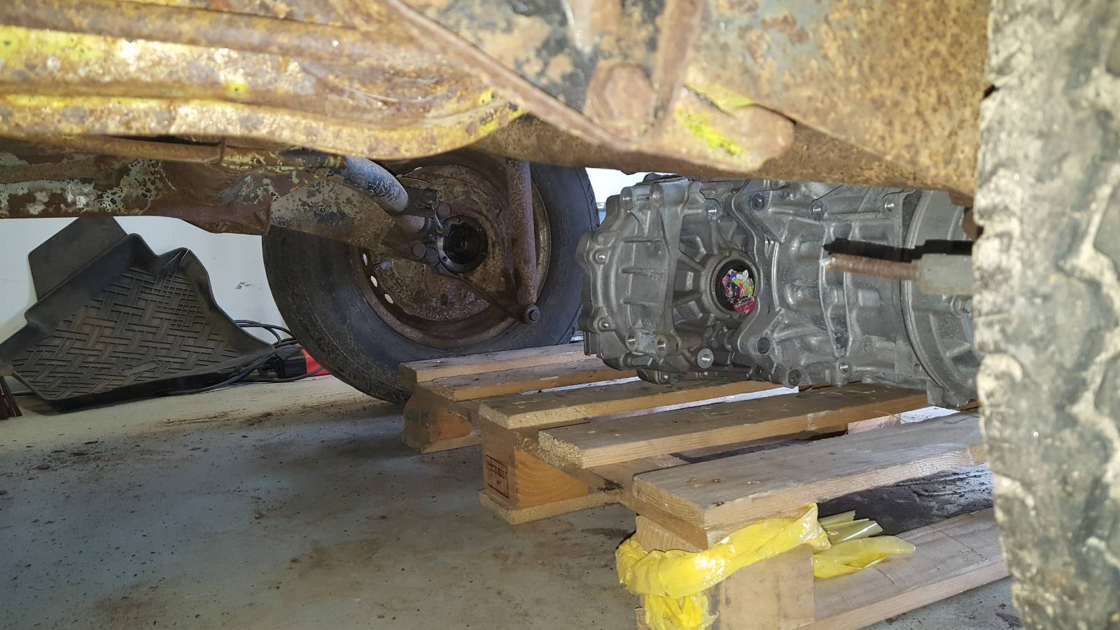

Darn it'd be tempting to use the Leaf box instead of VW transaxle :D but the question of durability when running in reverse for prolonged times is still on the table.
